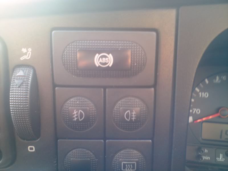

Jon_vr6 1 Posted March 10, 2011 (edited) Did a little upgrade at the weekend while i had a few moments, ive always wondered why on the later vr6 and storm models the ABS light doesnt match up with the other switches on the dash eg the fog light switch etc. Well managed to source an earlier ABS light with the ridges on so thought it would be just a case of swapping over the front covers and all would be well BUT turns out the ABS lights are totally different as in the front cover didnt fit over my existing one SO realised that a chunk of plastic near the bulb was stopping the cover going on so armed with a file i filed it down and after 10mins of filling the front cover fitted a treat and now looks spot on, Heres a before (had to use a pic from another storm but you'll notice its completely smooth) and one of mine installed. Edited March 10, 2011 by Jon_vr6 Quote Share this post Link to post Share on other sites
VWVW 1 Posted March 10, 2011 very eagled eye..never knew there was a difference until you mentioned it :) Quote Share this post Link to post Share on other sites
nsmjl02 0 Posted March 10, 2011 Jon_vr6, I like your style! Well spotted and does look better. Quote Share this post Link to post Share on other sites
Jon_vr6 1 Posted March 10, 2011 Thanks fellas looks OEM now Quote Share this post Link to post Share on other sites

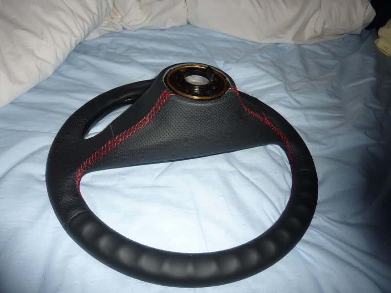

Jon_vr6 1 Posted July 8, 2011 Just thought i'd update this as it not been updated in ages. Ive been driving my brothers corrado which has been recently fully rebuilt by Graham at D&G Autotech for the past few weeks (getting 1,000 miles on it before it can be given the full beans, 3-4K rpm MAX) while mine is getting 263 cams fitted by Graham and a few odds and sods installed. Got a few things to put on it when i get mine back 1. A brand new VR6 steering wheel (well fully refurbished with red stitching direct from germany) 2. Brand new fogs and indicators Will put pics up of steering wheel to see what you lot think i think it looks ace thats all that matters Quote Share this post Link to post Share on other sites
OSV 0 Posted July 8, 2011 Would like to see pics of the wheel:afro: Quote Share this post Link to post Share on other sites

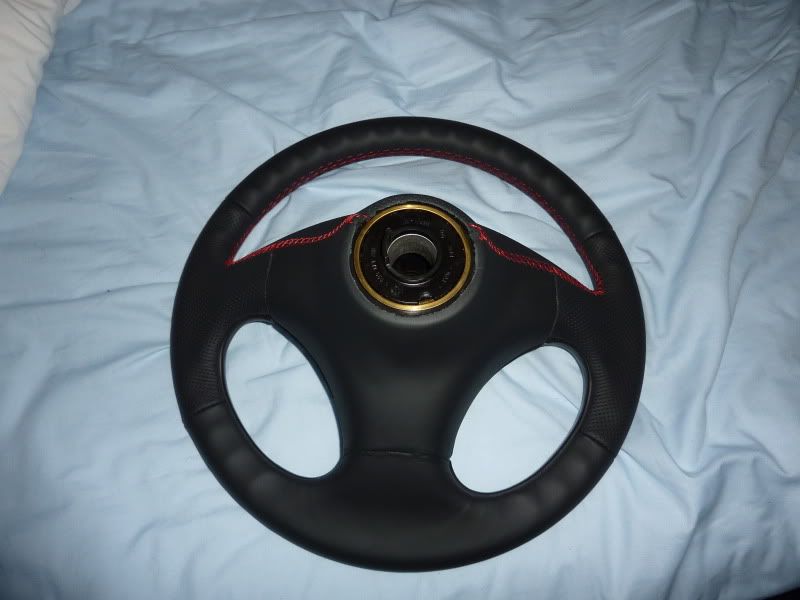

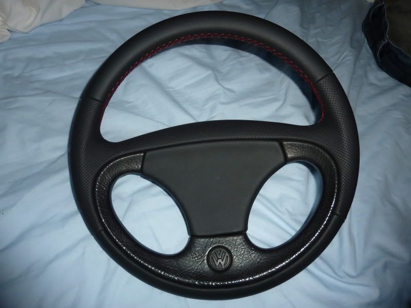

Jon_vr6 1 Posted July 8, 2011 Pics as promised what do you think?? The horn push has been leathered too but im not convinced so im putting the spare on to try and keep it looking OEM'ish Quote Share this post Link to post Share on other sites
OSV 0 Posted July 8, 2011 I think it looks great! I'm currently looking into getting a wheel retrimmed. Are you getting a remap with the cams? would love to hear your post fitment reports:thumbleft: Quote Share this post Link to post Share on other sites
Jon_vr6 1 Posted July 8, 2011 Phew was thinking it was going to get slated haha, Yeah its getting remapped at the same time the schimmel cams go in so i'm looking forward to seeing how it compares to standard. Will post up my findings fella Quote Share this post Link to post Share on other sites

Rams 0 Posted September 26, 2011 Hi mate, I might be able to help you with the horn push to keep it looking OEM. My steering wheel is with my trimmer atm and he is embossing the horn symbols at either end into the leather to keep it looking OEM. I will show you a picture when its done if it helps give you a better idea but I also had the 2 round centres trimmed as I think it looks odd without doing that bit. Otherwise, the red stiching sets off the speedo dial nicely. What bit did you file down with the early ABS switch? I got Jon Croozings early switch and I tried fitting it when I was replacing the dash and thought, 'well, that wont work'. It's a nice mod. Looks like its meant to be. Wonder why they changed the switch? Quote Share this post Link to post Share on other sites
Jon_vr6 1 Posted September 27, 2011 Hi mate on the early abs light if you remove the front plastic with abs on it you'll see that behind that around the bulb is pretty flat now take off the front on your late light and you'll see that it sticks out more promenantly around the bulb and its that, that causes the early front not fitting the late. So i filled that down and hey presto it fits a treat. Havnt a clue why they changed them but i know that the connector end on the early light doesnt fit the connector block on our storms. Thats a good idea with the horn push i'd be interested in seeing that. Quote Share this post Link to post Share on other sites

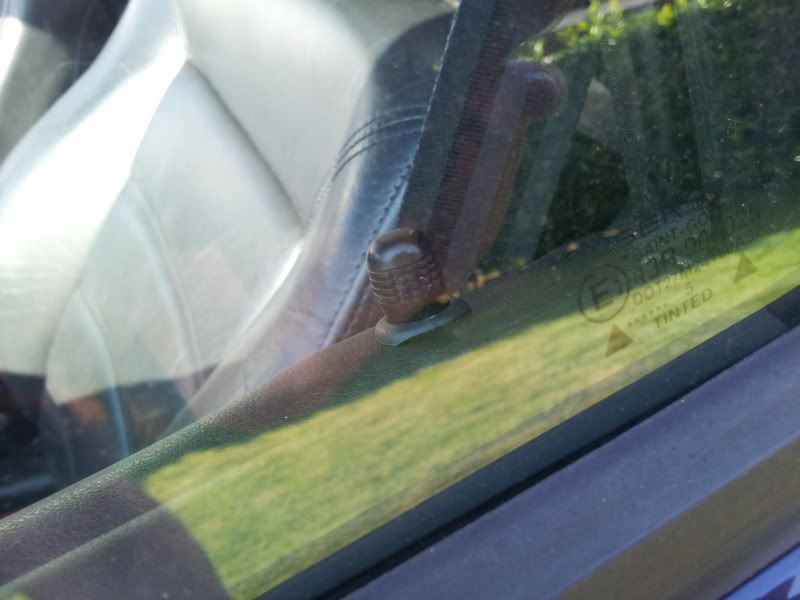

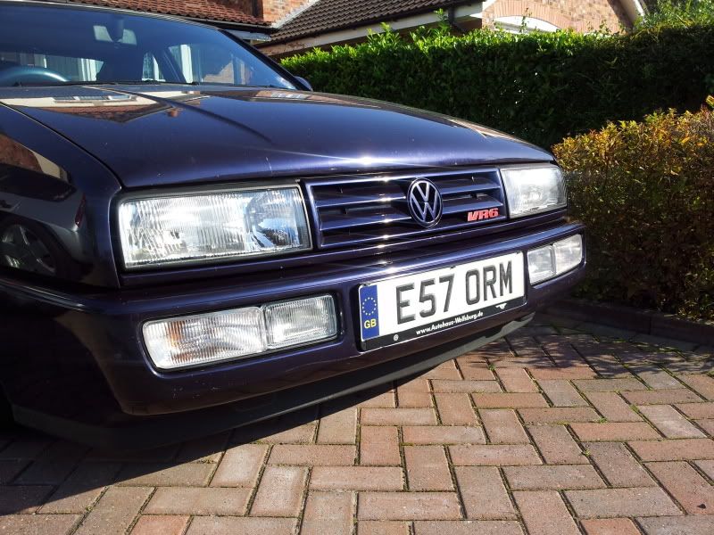

Jon_vr6 1 Posted September 29, 2011 Well heres pics of the few things ive done over the past few days 1. New aerial base not genuine but fits a treat Old New 2. Removed all the seats and gave them a good old clean and reconditioned the leather nice and soft/supple now also hoovered all the carpets while the fronts were out found £1 in change too 3. Fitted a replacement interior door card plastic the old one had a big crack down it also i fitted a spare passenger door handle ive been meaning to fit so i can now lock the car from the passenger side and while i was there fitted dave16v's famous door repair kit feels lovely now and doesnt feel like its going to fall off 4. Finally fitted my new fogs and indicators, i Lamin-xed them first before taking the old ones off, fitted nice new stainless steel screws aswell as the old ones were well crusty makes it easy if they ever have to come off again 5. Just a small one ive now removed the bullet door pins and gone back to standard looks far better Whats left to door well New steering wheel to fit New Varta Battery - Just for piece of mind Want to do a full coolant flush Oh yeah and wash it lol Jon Quote Share this post Link to post Share on other sites
