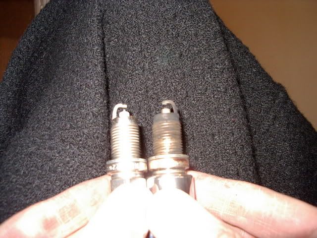

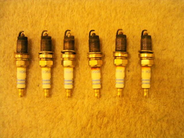

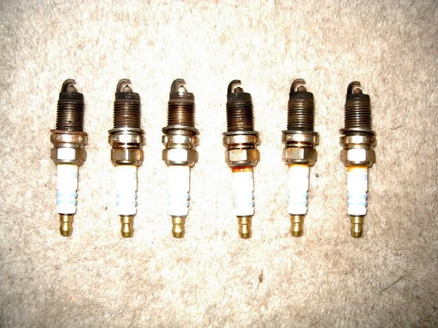

Stan 24v 0 Posted March 1, 2007 Well I sealed the coil pack, and it improved it but it still wasnt right. Today I bought some new plugs and leads, and it seems to be fine now. have a look at the plugs. The car has 130k, I wonder if theyve ever been changed????!!!! Quote Share this post Link to post Share on other sites
Supercharged 2 Posted March 1, 2007 If it's cracked replace it - water will only get trapped inside... Plugs look ok but you may as well change em as they're out... Quote Share this post Link to post Share on other sites
rado-steve 0 Posted March 1, 2007 Mmm Proper Fooked them like! Quote Share this post Link to post Share on other sites
Stan 24v 0 Posted March 1, 2007 Ive changed them already, theyre fooked!!! Running loads better now. Supercharged I dried the coil pack out for a couple of days then sealed it with silicone and its fine. Quote Share this post Link to post Share on other sites
