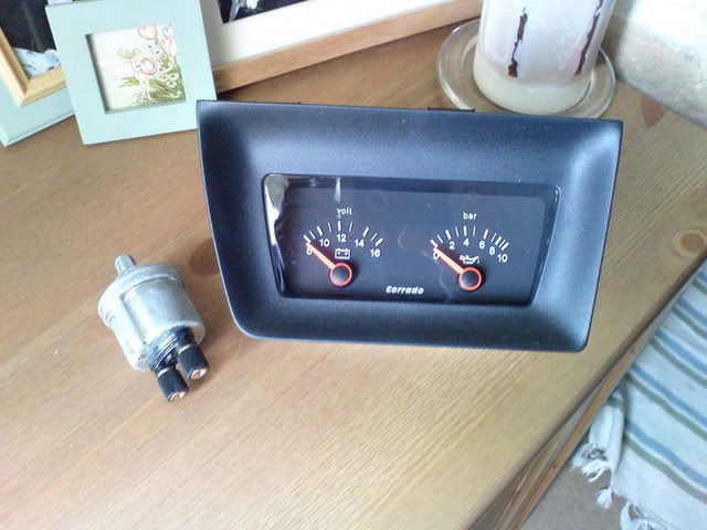

Well more treats for the car this weekend, not that it deserves it! :lol:
As I've not really got enough to worry about when out for a drive I thought I'd get myself a gauge pod so that I've got some extra things to show faults up. Purchased from xbones and I'm really impressed with them, very OEM+ and the moving needles are quite entertaining on a drive......
Anyway, PICS! 8)
Before install
After Install
And a nice one showing the back lighting

That looks great. Job done.
I had mine fitted by a :cowboy: , when the pressure needle went off the scale (and where it currently resides) and I remarked on the wrongness of it, he said 'it's 'cause the engine's so good'.
Mug. :(
I've always thought the Corrado script should have been in the original style, same with the dash. :geek:
What's the thingies on the thingy area-never seen that before?.. :lol:
Mug. :(
Have you checked to make sure he's but the right wires on the right poles of the sender? Could be giving a dodgy reading. And what thingy on the thingy area? :? :lol:

vdo guages go straight off the scale if they are connected to voltage without the sender wire being connected or as said on the switch side of the sender not the guage side

Cheers mate, I'm really impressed with them and I think they are fairly accurate. Getting about 4 bar oil pressure at cold idle and just under 2 bar at warm idle so about what I'd expect.
Now if only I can sort everything else! :lol:
thats really nice top job :)
thats about right i get a little more but i am running silkolene pro s 10w/50, very envious they even light up really nice,they look back lit if they are why did they not do the dash like that looks so much better
I'm so clueless with these things that that means nothing at all to me! I will get it sorted one day.
Thanks anyway though.
It's the red thingy and the jack socket next to the coin holder that's stumped me. :scratch:
Glad to hear thats what others are getting. And yes they are back lit, which looks a lot better than the dash and I have no idea why they didn't do them both that way. Guess it was a case of VW just sending bin parts over to Karmann and we're stuck with it now! :lol:
The red led just flashes when me alarm/immobiliser is on, and the jack socket is for a manual override of the alarm system. just in case I lose a key fob i guess.
If you unscrew and pull out your gauges, check that none of the wires going into the pod are touching at the connectors. If not, I would get a torch and make sure the sender is wiring correctly. when you're look at the sender (on top of the oil filter housing) the gauge wire should be connected to the left pole (marked with a G. If you can't see the sender very well, I'd swap them over and just see if that makes a difference.
Hope that helps, and if all else fails and you want to post the pod to me I'll wire it up with a few fitting instructions?
