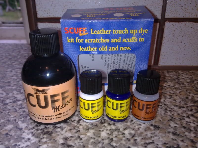

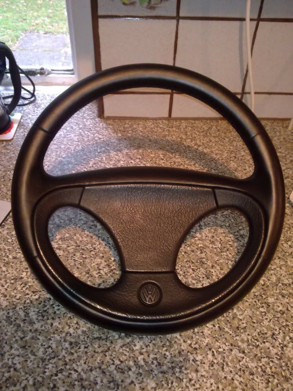

KADVR6 0 Posted August 17, 2011 (edited) well getting all my parts together for when the new engine gets put in, which will be very soon :-) but on sunday my bro went to a bmw show and bought me a leather touch up kit as i was complaining about the state of mt steering wheel, the kit cost £15 and the guy selling them swore they are excellent kits. so £15 and about an hours work my original steering which has covered 127k looks like this and here is the kit still got enough left to do about another 12 steering wheels also lol karl Edited August 17, 2011 by KADVR6 blonde Quote Share this post Link to post Share on other sites
OSV 0 Posted August 17, 2011 Excellent results Quote Share this post Link to post Share on other sites
KIPVW 0 Posted August 17, 2011 That does look rather damn good Karl! Nice work ;) Quote Share this post Link to post Share on other sites
KADVR6 0 Posted August 17, 2011 yeh not bad really, plus seeing one £15 will do at least 6 steering wheels (cottage industry lol) Quote Share this post Link to post Share on other sites
Jim 1 Posted August 17, 2011 Great results, Karl! Quote Share this post Link to post Share on other sites
KADVR6 0 Posted August 17, 2011 well i think after re-dying approx 6 full interiors i have got used to this dying lark, but its sooooo easy anyone can do it, just read the instructions to the letter. Quote Share this post Link to post Share on other sites
OSV 0 Posted August 17, 2011 Do you have the 65ml kit which is listed here Karl? Seeing your excellent results i'm tempted to give it a go. http://www.liquidleather.com/scuffs.htm Quote Share this post Link to post Share on other sites
KADVR6 0 Posted August 18, 2011 Do you have the 65ml kit which is listed here Karl? Seeing your excellent results i'm tempted to give it a go. http://www.liquidleather.com/scuffs.htm yeh gareth thats the stuff i used but dont forget what they say here 'ScuffMaster Colourwash" is a treatment NOT a product, to carry out a "colourwash treatment" you should order 1 x GT12, 1 x GT11 and 1 x Scuffmaster kit' personally you can get away with just ordering some off the GT12 to get your steering wheel 100% clean, and then do the dying, GT11 is a conditioner which you dont need on a steering wheel but you do on the seats. also get some 2500 grade wet and dry paper to smooth the finish down, but only use it dry before the last coat containing the gloss finish, and it will look mint. Quote Share this post Link to post Share on other sites
OSV 0 Posted August 18, 2011 Thanks so the process required is Clean with G12 Apply colour with Scuff master kit 2500 grade wet and dry (dry) for smooth finish Gloss finishing coat And if if follow that process, its all I need to get these results? Quote Share this post Link to post Share on other sites

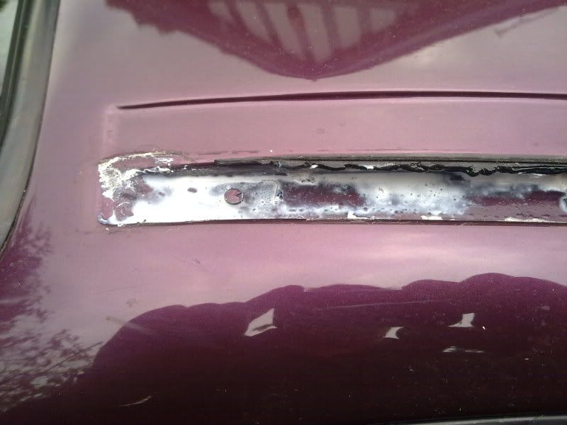

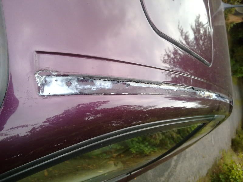

KADVR6 0 Posted August 18, 2011 Thanks so the process required is Clean with G12 Apply colour with Scuff master kit 2500 grade wet and dry (dry) for smooth finish Gloss finishing coat And if if follow that process, its all I need to get these results? yeh that will do it all very nicely Gareth, you may not need the wet 'n' dry if you can find a very soft foam sponge, its just when you use a dense foam sponge you can see the drag marks that are left, but a very soft foam pad will not leave any marks. and you add the gloss coat with the dye on the last coating, i did a 3ml of dye and 1ml of gloss top coat and i was happy with that, but if you want it glossier just put more gloss in with the dye. ---------- Post added at 07:13 PM ---------- Previous post was at 07:05 PM ---------- heres a weird one for you all!!! yesterday i noticed a white sticky substance (get your mind out the gutters) at the top of my winscreen, and down the A pillar, thought nothing of it really so just wiped it off the car, this morning its back again but also down the back panel, and had dribbled down onto the bumper!! it looked like it had come from the roof strip?? so took it off very carefully, and was greeted to this f*****g mess, anyone got any idea what the hell it is?? i have never touched the roof strips since i have had the car. confused.com lol Quote Share this post Link to post Share on other sites
dragon green 4 Posted August 18, 2011 it looks like your roof strip was put on with "no more nails" thats what it looks like when it get wets ! Quote Share this post Link to post Share on other sites
KADVR6 0 Posted August 18, 2011 it looks like your roof strip was put on with "no more nails" thats what it looks like when it get wets ! yeh true but i had owned the car for a few months and its never done this before??? Quote Share this post Link to post Share on other sites
robrado974 1 Posted August 18, 2011 jesus what a mess !. can see you goin off to tps for some new roof rubbers soon , just replaced mine . Would meths destroy the gooey mess ?, as above all the rain we have had must have taken its toll on what ever they were stuck down with . Quote Share this post Link to post Share on other sites
KADVR6 0 Posted August 18, 2011 well left it to soak overnight with some very soapy water, then yeh looks like its down to TPS to spend some more money lol Quote Share this post Link to post Share on other sites
Jim 1 Posted August 18, 2011 WTF! New roof trims needed me thinks!! Quote Share this post Link to post Share on other sites
