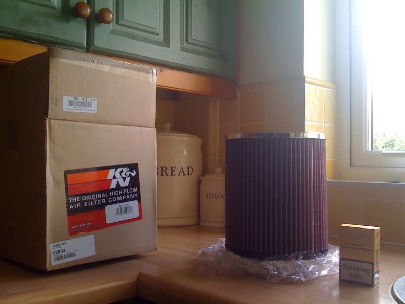

jamminvr6storm 0 Posted July 7, 2010 Here is a pic of my air filter, next to my bread bin so you can get a sense of scale :lol: I was tempted to use a stock air box but I have a 4" intake pipe Quote Share this post Link to post Share on other sites
Kevin Bacon 5 Posted July 7, 2010 I think with the power you're making, that size air filter is appropriate :lol: Quote Share this post Link to post Share on other sites
