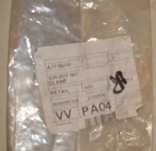

Pickard1 0 Posted April 9, 2008 Here is the spare S shaped clip that I bought from smith knight fay Stockport about 2 yrs ago. Part number was 535 823 567. I brought it separately for about 80p i think. I would recommend the mod suggested above using a bike brake cable part, although I haven't seen it, I would imagine that anything that prevents you from having to remove the old cable is a good thing. I replaced mine by: 1. slackening the nut at the far end of the cable (battery side of engine bay) and then withdrawing the cable. 2. Threading the S shaped clip to the end of the wire. 3. re threading the wire through the cable sheath (quite difficult if the wire is frayed :D ) 4. re tightening the nut - its best to check that the bonnet pull is working both mechanisms before slamming the bonnet..... :D Cnut - do you still want this. Quote Share this post Link to post Share on other sites
