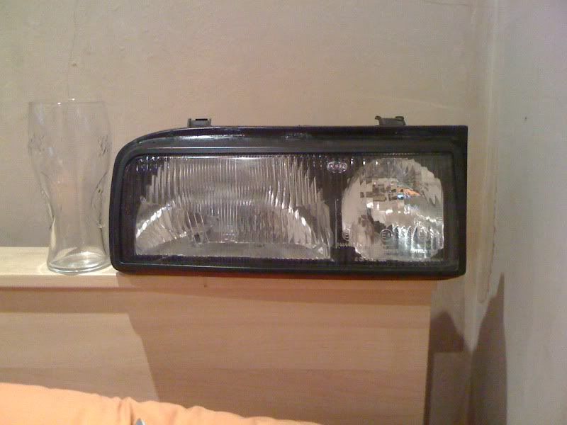

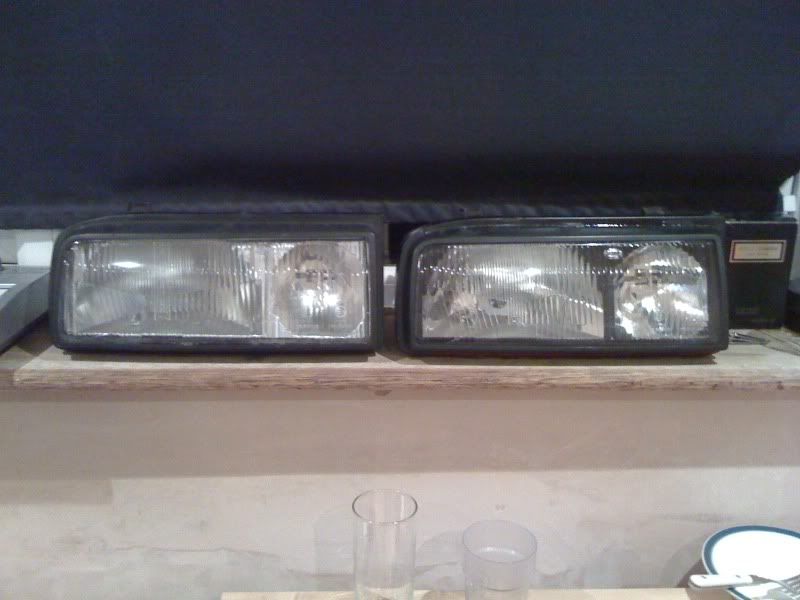

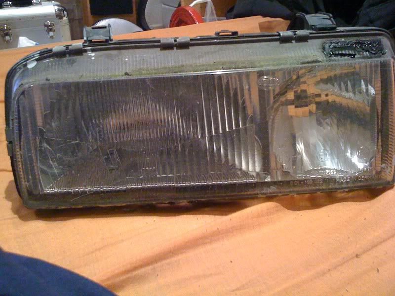

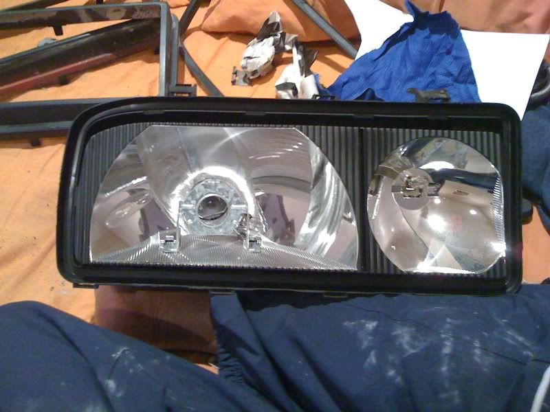

waynos 0 Posted August 12, 2010 right seeing as the lights were off the car i thought id paint the insides light un painted old next to new Quote Share this post Link to post Share on other sites

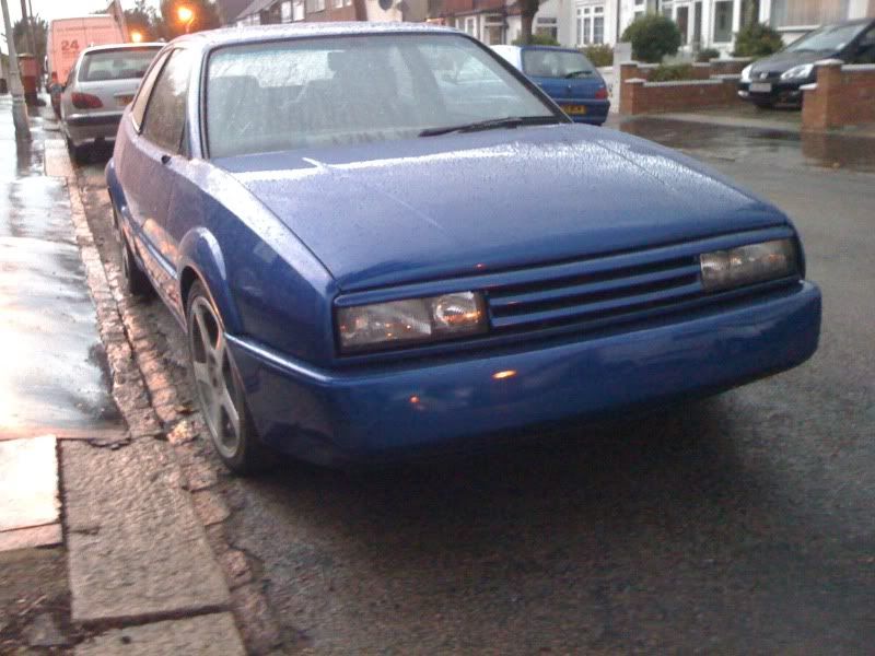

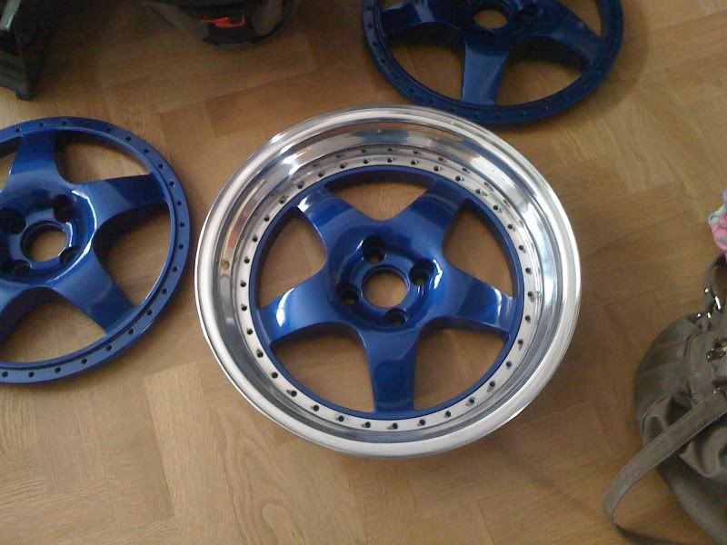

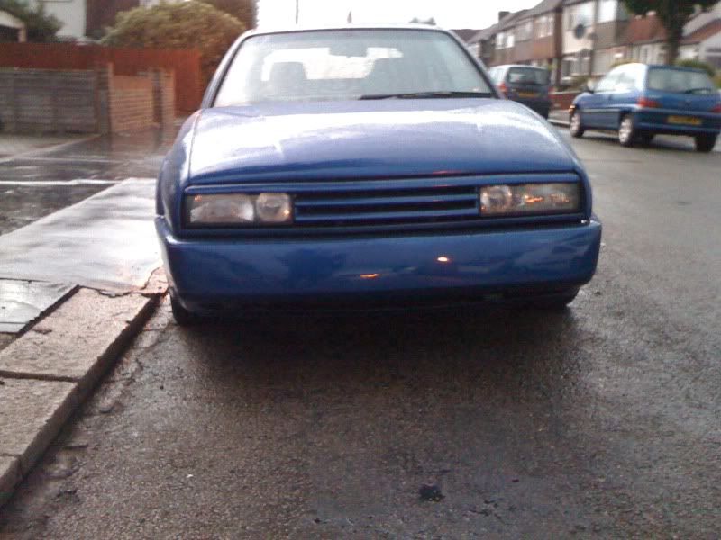

waynos 0 Posted August 14, 2010 got the lights and grill on and picked my wheel centres up this morning oooo la la Quote Share this post Link to post Share on other sites
n3p 3 Posted August 15, 2010 :shock: What a difference! Looking good mate, I'll have to keep my eyes peeled for you although i think now it will be easier to notice :norty: Nick Quote Share this post Link to post Share on other sites
waynos 0 Posted August 15, 2010 long time no see my man!. unfortunatly its going back to the shop tommorow as there are some bits im not quite happy with. but on a whole im pleased. i need to come and check out that vr of yours sometime Quote Share this post Link to post Share on other sites
n3p 3 Posted August 16, 2010 I must say the finish looks good, and probably better value than a certain local bodyshop to me (JD). You're welcome to check out the VR anytime! valver now sold so it's bittersweet lol Nick Quote Share this post Link to post Share on other sites

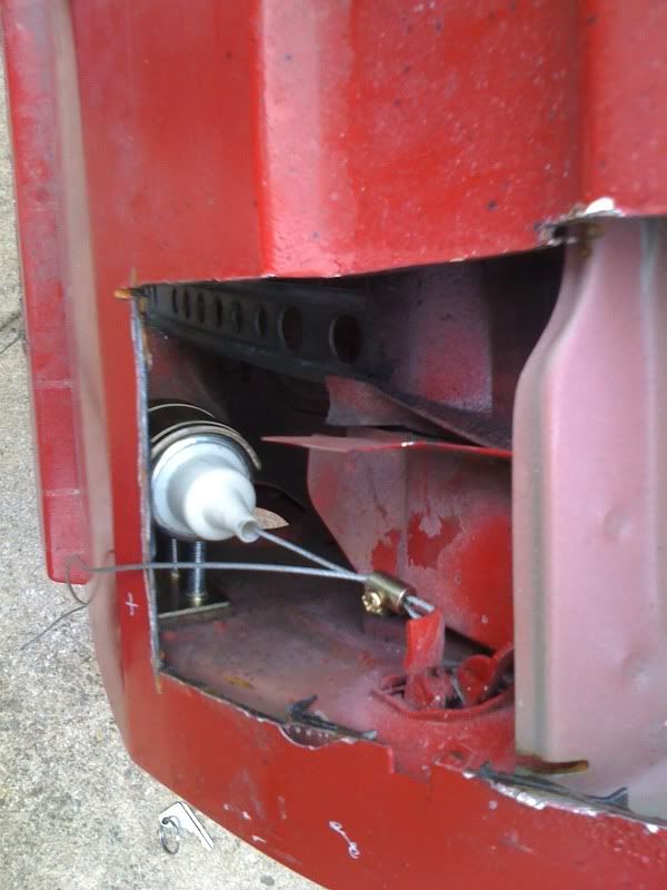

waynos 0 Posted August 17, 2010 cool i shall pop over once its complete as i had i scrap door i though id do a test fit of a solenoid for the door poppers. Was a right fiddle but ive positioned it in a way so i can get the thing mounted easily ( i wont have the big gaping hole to stick it through)also so its easy to adjust the slack on the wire Quote Share this post Link to post Share on other sites
dan 0 Posted August 17, 2010 That's good to see how a solenoid works,no reason why that set up wouldn't work for years. If I were you Wayne I'd red tint the rear lights, I think the all red rears would really suit the more modern colour as well. Quote Share this post Link to post Share on other sites
Kempy 0 Posted August 17, 2010 I got the same solenoid in my boot, works fine. Sometimes ( I dont know why) it takes 2 or more button pushes on the fob to pop open the boot Quote Share this post Link to post Share on other sites
Rams 0 Posted August 18, 2010 Looking very good Wayne...... You must be chuffed! I know what you mean about the solinoid being fiddly, lol I changed the buttons in the end for some slimmer ones which are water proof, 7.99 from Maplins Keep up the good work and looking forward to seeing a picture of it all back together Quote Share this post Link to post Share on other sites
waynos 0 Posted August 18, 2010 Dan i was thinkin of all reds but i dunno how id get the reverse lights to shine white still? Rams ive also changed the switches for weather proof ones from maplins. Think i paid 3 or 4 quid for two. The silly green ones they supply with the solenoids look poo Kempy maybe yourd jus needs a little adjustment? Quote Share this post Link to post Share on other sites

Rams 0 Posted August 18, 2010 Wayne, im struggling a bit..... Can you help? I need to connect the wiring up for the button to open the door, so far, I have the door opening but dont want the door to open when the alarm is on , onbiously so no creatures can get in! Can you help with wiring? I need to secure the car now as a fair few travellers - being polite have come to bmth. It might just be my meter playing up which determines who I wire it!! Quote Share this post Link to post Share on other sites
waynos 0 Posted August 18, 2010 thanx for the comment coullstar! I havent even got round to the wiring lol. Does ur alarm trigger the central locking?if so once those locks are down pressin the solenoid button wont make a difference. So do your doors open nicely i was thinking i may need to use a spring to push the door out once the solenoid button is pressed so it clears the latch Quote Share this post Link to post Share on other sites

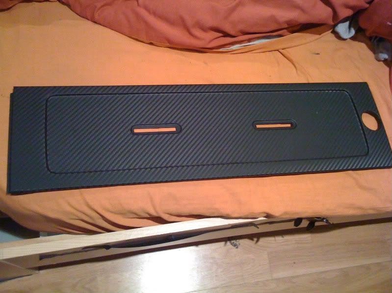

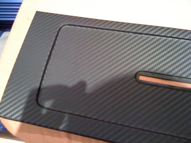

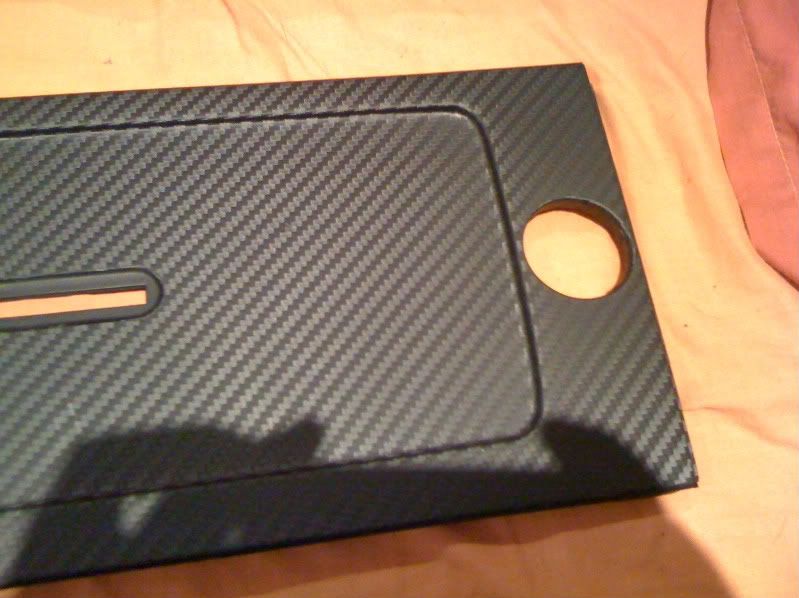

waynos 0 Posted August 18, 2010 got busy covering the number plate plinth in 3m carbon wrap, cheers dan!!! pics Quote Share this post Link to post Share on other sites
dan 0 Posted August 18, 2010 Well done mate, that looks like it was done by a Pro :salute: The best thing about using the vinyl is the low maintenance from now on :D Regarding your back lights, just mask off the reverse lights before you tint them & all will look 8) . You can either mask off the whole block of the reverse light or use 5mm horizontal strips for that OEM look :D Quote Share this post Link to post Share on other sites
waynos 0 Posted August 18, 2010 cheers mate, it was suprisingly easy to work into the corners! as for the lights im not sure if it would would work as ive got the inpro lights , so i dont have the little blocks where the reverse light goes - the whole section is the reverse ight if that makes any sense? Quote Share this post Link to post Share on other sites
Kempy 0 Posted August 18, 2010 looks good that plinth, I just got a replacement new one in the post was gonna colour code it, put that looks good to, when its on the car can you stick a pic up :grin: Quote Share this post Link to post Share on other sites

swiftkid 1 Posted August 19, 2010 Can i Just make you aware of something for the solenoid. I had a problem when I put a boot popper in my old car. The bracket was pretty crap so when i tightened up the solenoid it actually bent the bracket around the curve (where the solenoid sits), which meant that once i had set up the solenoid and pressed it a couple of times it had moved and slackened off. Got a mate to weld a piece of strengthening around the curve thinking that would resolve it but the bracket just bent somewhere else. Its a really crappy design so maybe consider making a proper full loop bracket to stop the solenoid slipping to avoid having to reposition it every 5 minutes! Hope that makes sense, oh and car is looking very nice! Quote Share this post Link to post Share on other sites
Rams 0 Posted August 19, 2010 Doors are opening fine at present.... The problem with the wiring is that we need a switchable live, as when the alarm is on or off, theres still a permant live.... Tried alarming the car, car locks but switch solinoid switch still poping the door open. Can you suggest another idea? Maybe the vacum pump - relay? Unless we can do it via a relay or earth somehow?? I might need an auto electrician? Quote Share this post Link to post Share on other sites
waynos 0 Posted August 19, 2010 thanks for the heads up swift kid thats something ill definatly look into! rams what is making the dor pop when its locked? :scratch: perhaps a solution could be to use a relay off one of the imobiliser circuits on the alarm? that way the solenoid would only become active once the imob is off Quote Share this post Link to post Share on other sites
