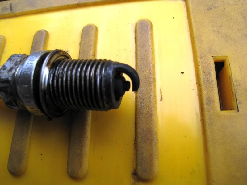

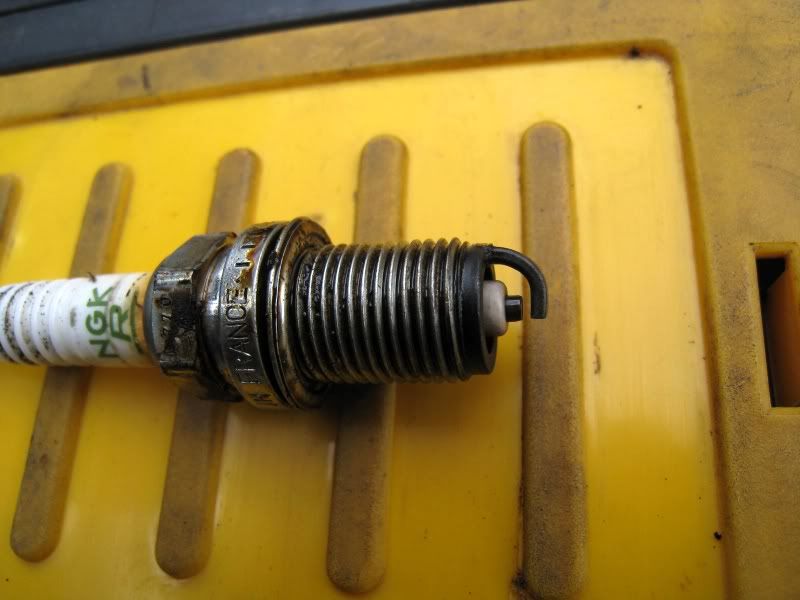

zak 0 Posted July 20, 2008 The problem with injector 3 was my fault the connector was not plugged in properly from yesterday when i had the fuel rail off to swap the injectors around. I checked the wiring for injector 5 and i could not find any issues with it, i checked the supply wire for continuity from the engine harness plug on the right hand side of the cylinder head to the connector that connects to the injector and it showed continuity. I also checked the common earth for the injector wiring and that was fine too. I removed the engine ecu to check if there were any corroded terminals and all looked okay so i refitted it. Before refitting i rubbed the terinals down with emery paper and sprayed switch cleaner in to the ecu wiring loom plug. Not sure where to go now, i would like to reseolve the error codes before tackling the head gasket if i even need to. I think it might be worth trying a another ecu, my ecu is part number 021 906 258AG if anyone has one? heres the pics of my plugs Cylinder 1 Cylinder 2 Cylinder 3 Cylinder 4 Cylinder 5 Cylinder 6 Quote Share this post Link to post Share on other sites

coullstar 0 Posted July 21, 2008 Plugs seem a bit "wet" to me or a tad oily. Should be a grey/brown finish. Quote Share this post Link to post Share on other sites
CorradoVR6-Turbo 0 Posted July 21, 2008 No 5 is well steamed clean.... Quote Share this post Link to post Share on other sites
zak 0 Posted July 21, 2008 James i think you are right, as its the only plug which is white under the electrode. It's hard to see but plug 5 was wet with petrol too. Quote Share this post Link to post Share on other sites
