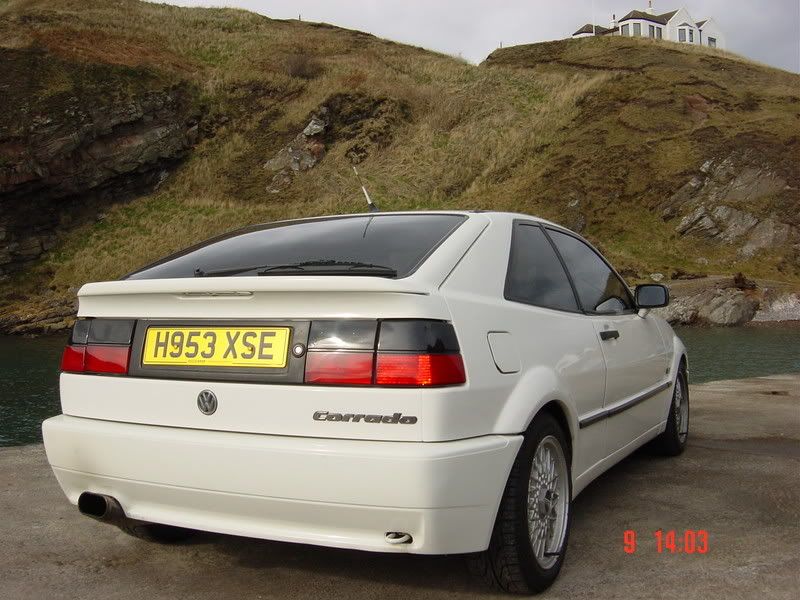

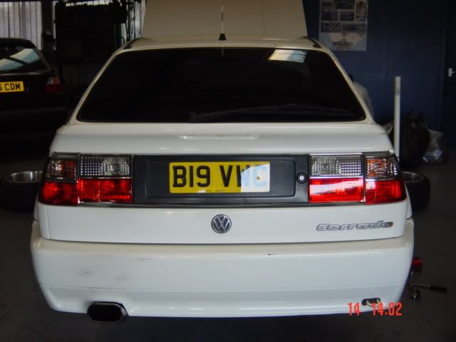

BigTartanJudge 0 Posted October 16, 2008 Here's my white rado with DIY half-tinted rear lights, I think they look ace ;-) and here with FK smoked rears Going to try and turn these bottom ones into proper crystal top-tints with black tinting spray. Quote Share this post Link to post Share on other sites
Flexso 0 Posted October 16, 2008 Thanks for the photo. It looks real nice with smoked. Where did you get the spray from. It seems as if smoked finish seems to be more of a rarity. Quote Share this post Link to post Share on other sites
BigTartanJudge 0 Posted October 16, 2008 I bought the Foliatec tinting spray from a local car accessory shop but you can also find it on eBay. The key is good preparation if you are doing it DIY. There are a couple of very good DIY tinting guides available. I also bought these recently below, which were FK crystals done with red tint spray. Quote Share this post Link to post Share on other sites
