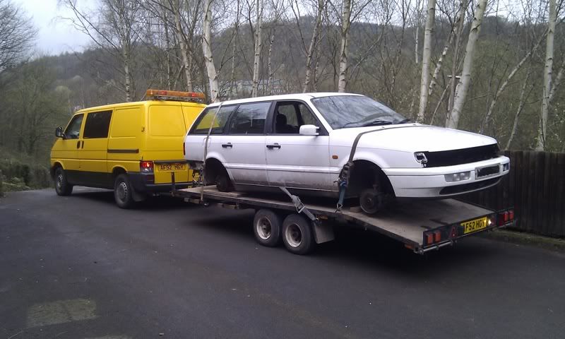

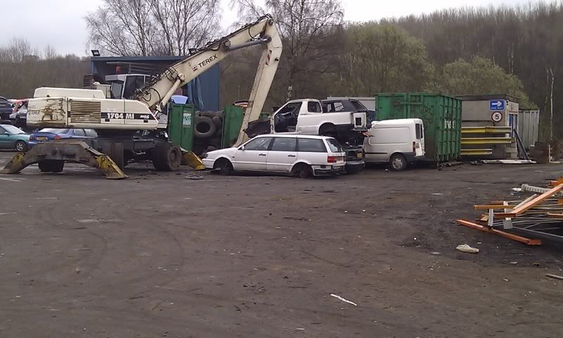

Purple Tom 0 Posted April 2, 2011 Passat gone, Corrado home ;) Getting a bit excited now!! Quote Share this post Link to post Share on other sites
Andy-H 0 Posted April 2, 2011 Is that the Pettsy wagon I see there? Did the passat have a sunroof in it Tom? not sure if I asked you that when I was there. Quote Share this post Link to post Share on other sites
Laser Mark 0 Posted April 2, 2011 Nice progress Tom. I'm just wondering how far you'll have got by 12 tomorrow, as your not hanging about! Quote Share this post Link to post Share on other sites

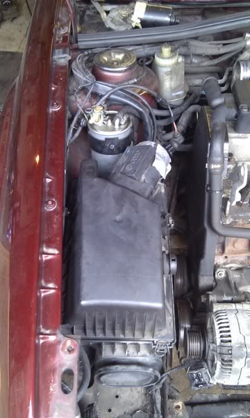

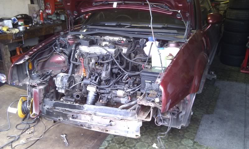

Purple Tom 0 Posted April 4, 2011 (edited) Day 1 of the project proper today. It doesn't look like I've got a lot done but I actually have. Got the Corrado up onto axle stands, wheels off etc, then got the front end off, exposing the radiator, engine etc: Everything came off easily which was nice, I was expecting the nightmare that I had with the VR6 breaker but there was none of that. It's all in fairly good condition under there, and its the same as the rest of the car - totally untampered with so everything is nice and original. I measured up the space between the radiator and slam panel before them completely and have determined that I have room for a front mount intercooler of approximately 800mm x 200mm x 80mm before I have to start doing too much in the way of modifications - that should give me plenty of scope for something aftermarket to slot in in front of the rad. I then turned my attention to the airbox situation, which has been bugging me for a while because I've been unsure of how to mount the TDi MAF. Other people have used the Mk2 GTD airbox (which is rare and expensive second hand and unavailable new) or gone for a cone filter arrangement. I didn't fancy searching for a GTD airbox and I don't like cone filters so I thought I'd see what I could do with what I've got. Handily the TDi MAF bolts straight onto the 8V airbox, which was nice :) All I need to do is fit a small union for one of the vacuum hoses to attach to and that's that job sorted. I trial fitted it into the inner wing along with the diesel fuel filter and it all looks good: I then tried to suss out the alternator arrangement. The TDi donor car came with A/C which meant that the main serpentine belt drove the A/C pump and alternator only (via a plastic tensioner pulley). The smaller V-belt drove the PAS pump and water pump. However on the 8V there is no A/C and the water pump is driven by the serpentine belt, not the V-belt (see the airbox pic above). I'm not fitting the Passat A/C to the Corrado so I needed to figure out what to do with the pulleys in terms of making sure they're all driven. I'm fortunate to have the Ibiza as a reference which doesn't have A/C and I discovered that on the non-A/C TDi's the water pump is also driven by the serpentine belt, as on the 8V Corrado. A bit of investigation later and I discovered that the alternator mounting bracket from the 8V will bolt straight onto the TDi engine (the block and water pump are essentially the same) and allow me to use the 8V alternator. All I need to do is swap the 8V water pump pulley onto the TDi pump and then I basically have the same drive belt system as the 8V originally had without having to buy any new parts - although I am fitting a new water pump as a matter of course. Pretty chuffed with that really to be honest, that pulley situation had been bothering me for a while. The engine should be out first thing tomorrow morning and then I can begin the task of removing the looms, cleaning the bay etc. I'm aiming to have it in and running for Sunday this week. Cheers Tom Edited April 4, 2011 by Purple Tom Quote Share this post Link to post Share on other sites

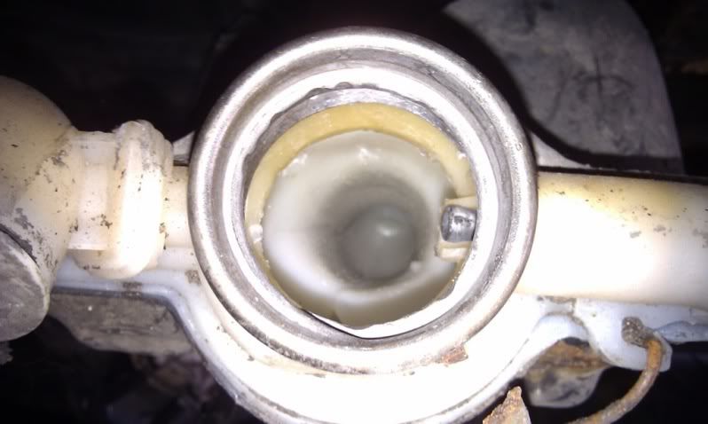

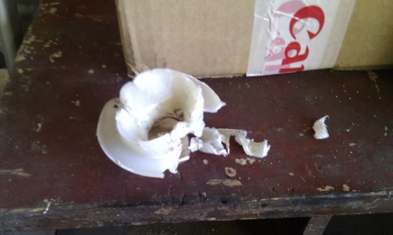

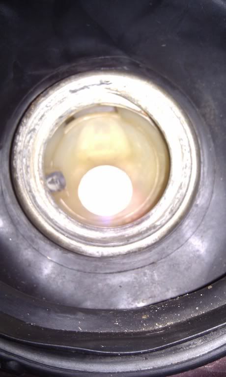

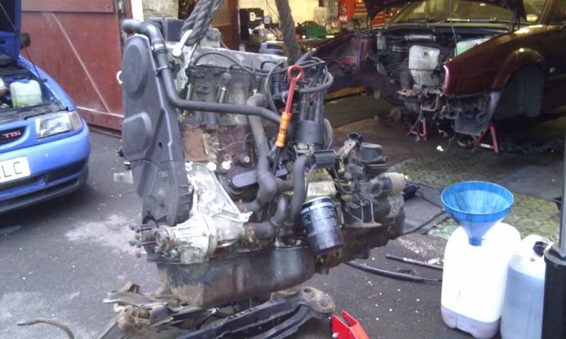

Purple Tom 0 Posted April 5, 2011 Day 2 over and done with, got the engine, front suspension (including subframe etc) and most of the interior out of the Corrado, just the carpet to go really. Mark (Laser Mark) came round this evening and picked up a few more bits to be blasted and powdercoated, he also stayed while I removed the interior and helped out quite a lot, cheers dude :) As well as removing parts today I also modified the filler neck on the spare fuel tank that I have (the one from the VR). I basically totally removed the restrictor from the neck by means of a hammer, chisel, screwdriver and long nosed pliers. Sounds brutal and I half expected to cause some damage (hence using the spare tank as a trial run), but it turns out the restrictor is only very lightly glued into place and I soon had it totally off, leaving a smooth filler neck with plenty of room for a diesel fuel nozzle, well pleased with that! I also degreased the engine bay just before finishing for the night so it'll be ready for a good clean in the morning. Hopefully tomorrow I can get the majority of the wiring looms swapped over, as well as installing the Passat pedal box, servo, ABS unit and clutch master cylinder. It'll be nice to be finally bolting bits on rather than taking them off :lol: Thanks Tom Quote Share this post Link to post Share on other sites

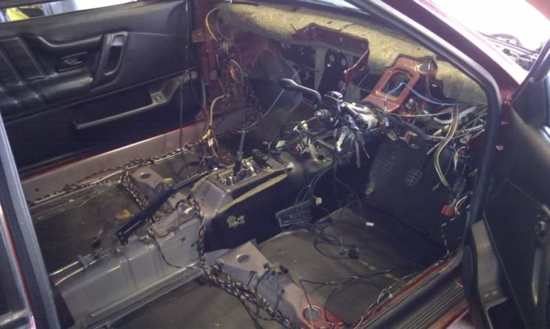

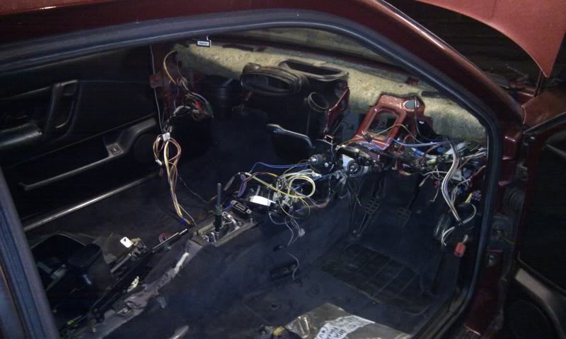

Purple Tom 0 Posted April 6, 2011 Day 3 - fairly productive and I got quite a lot done, again visually it doesn't look like much but I'm a good step closer to getting the engine in now. Firstly I spent about 3 hours sorting out and rewrapping the majority of the interior wiring loom. I removed, rerouted and reinstalled an alarm that I had fitted in 2009 because I wasn't happy with the way it was fitted (nothing to do with the quality, just the routing more than anything else). Another thing is that I've removed all of the horrible sponge wrapping the VW fit as standard. While I'm sure it helps with a bit of sound deadening it does make it really awkward to route the wires and is generally messy as it starts to deteriorate with age, so I thought I'd remove it altogether. As well as checking the loom out I've rewrapped it with rayon cloth loom tape which allows the wiring to maintain its flexibility but also improves the look of it over standard insulation tape (in my opinion). I removed the heater box and repaired the heater controls, which never adjusted before. I found the problem to be the lower gearing for the face/feet flap, it had skipped a few teeth so I removed it, repositioned it, regreased the mechanism and cleaned/greased the bowden cables. The control panel itself was fine so I should have functioning heater controls again :) I've also totally removed the ABS system now, including the ECU and loom. I'm happy because compared to the new loom the old one is very complicated with it series of relays and fuses. As the new system is much more modern it doesn't rely on relays as much as as such the loom is much smaller which'll help to reduce the rats nest effect up near the heater blower motor on the left hand side of the car. Here's some pictures of the progress, including a couple of the modification to the filler neck, which as described in my previous post, was very easy :) It doesn't sound like I've done a lot today, but it took a good long while to sort everything out and I'm glad because things are clearer in my head now! Standard filler neck (with restrictor): Modified filler neck (restrictor removed): Restrictor: Tomorrow should see some looms going in (engine loom and ABS loom) and the pedal box, steering column back on etc :) ---------- Post added at 10:21 PM ---------- Previous post was at 10:18 PM ---------- Abdul - I agree, I'm sure more power will be something I crave quite quickly but as I've mentioned before, I just want to get it running and reliable and then go on the hunt for more. I'll just enjoy driving the car without constantly looking at the MFA and worrying about the fuel consumption! Diesel Junior - those seats look great, good job :) I wish I was at the stage of feeding my leather, a few more weeks before I get to that point I reckon! Quote Share this post Link to post Share on other sites

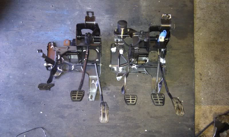

Purple Tom 0 Posted April 8, 2011 (edited) Day 4 - a bit of an up and down day really! Firstly, I think the Ibiza is a bit jealous of all the attention that the Corrado's getting so it decided to both get a puncture and break its exhaust clean in half on the way to the garage this morning. Luckily the puncture was repairable and I repaired the exhaust by using a section from the B4 donor so it wasn't too expensive, but it took about 3 hours in total to sort out which knocked me back quite a bit for today. Still, the exhaust is better than it ever has been now and I knew it needed doing so I'm pleased in a way. Finally managed to start work on the Corrado and got the pedal box, steering column, servo etc off. Everything seems ok and I was able to compare the Corrado and Passat pedal boxes side by side....completely identical in every way that matters, the Passat box obviously has the DBW throttle linkage and clutch/brake switches etc, but it mounts in exactly the same way (Corrado is on the left) As well as that I extracted the 8V engine loom and compared it with the Passat loom. While the Passat is better than the Golf as a donor vehicle because it has seperate headlamp and engine looms, I found that on the Passat the wiper loom is integrated into the headlight loom, whereas on the Corrado it is part of the engine loom. Also, the outside temperature sensor on the Passat takes a very convoluted route to the front of the car rather than directly like on the Corrado so I spent an hour or so sorting those little things out. I also had to repair the reverse light switch wiring on the Passat loom as it had lost its plug at some point in its life. I then totally rewrapped the loom using rayon cloth tape and it looks pretty good now. The rest of the evening I spent getting my head around the rest of the wiring. The 1Z engine from the Passat has a factory immobiliser which I need to include, but unfortunately so does my Corrado so its a case of removing the Corrado immob and installing the Passat system. However, trust it to be that the Corrado uses totally different wiring to the Passat, even the diagnostic plug is wired differently so its been a bit of a bugger getting that sorted. However its nearly there and I was able to actually fit something to the car - the cluster wiring! It might not be much but its on the car so there's a little milestone right there :) I'll update this again tomorrow as hopefully I'll be doing something more exciting than wiring! Cheers Tom Edited April 8, 2011 by Purple Tom Quote Share this post Link to post Share on other sites
