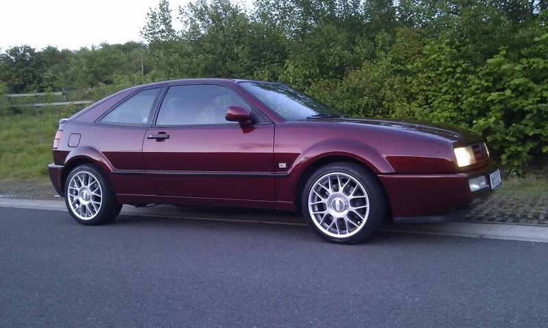

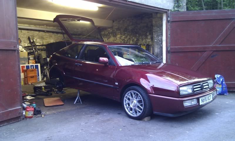

Purple Tom 0 Posted May 11, 2011 Thanks for the positive replies everyone, I'm glad you all like :) I haven't been ignoring this thread, just been a bit busy, but I'm in the middle of working out how much the conversion cost altogether so I'll have that figure fairly soon. I don't know if I mentioned about the ride height issues - once it was all back together it was sitting very low at the back - I've fitted Eibach springs with a -25mm drop all round so it shouldn't have sat tail down. It looked more like the rear was -40mm and it was making the car a bit crashy and horrible to drive as it's running standard shocks and obviously they don't like being -40mm. So I contacted C&R (who supplied the springs) who contacted Eibach on my behalf. The guy at Eibach said that some Corrado's, for some reason, sit lower at the back even with their standard -25mm rear springs on. He said Eibach had developed a spring specifically to solve this problem and that he'd send a set out to me straight away. Whether thats a load of old cobblers I don't know, it could be that they've had some QC issues and some kits have had -25mm fronts and -40mm rears but either way I didn't mind. The new springs arrived yesterday so I set about fitting them last night: I took the opportunity to check all of the fixings at the back, everything looks good so I'm happy with that. Once I got the car lowered back onto its wheels I was much happier with how it sits: It might not be very 'scene', in that its not slammed into the ground, but it drives really REALLY nicely. The ride is firm without being at all crashy, and the car rides over the bumps very nicely indeed. I think that manufacturers put cars at a certain height for a reason and I can't help but think that the Corrado drives best when its not lowered into the ground. Either way I'm happy with it, its a nice compromise on looks over ride comfort/driving pleasure. I also took a quick picture of the MPG on MFA 2 after 469.7 miles. That has been mixed driving, not just motorway or pottering about, quite a bit of everything. I'm well chuffed with it :) More updates to come as I get to know it more! Cheers Tom Quote Share this post Link to post Share on other sites
Laser Mark 0 Posted May 11, 2011 Looks loads better now Tom. None of my bolts come undone? :) I bet the garage is looking a little empty without a car in there in pieces? Quote Share this post Link to post Share on other sites

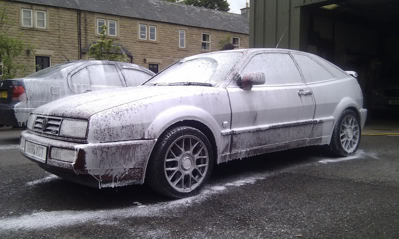

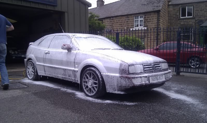

OllieVR6 0 Posted June 3, 2011 lol, the Passat got half a wash. Lovely car dude, an inspiration! Quote Share this post Link to post Share on other sites
Kevin Bacon 5 Posted June 3, 2011 Been meaning to look at this thread for ages and I'm not dissapointed! What a brilliant job you've done of that sir, looks factory! Thanks again for all your info / advice on the MK3 ABS conversion mate :thumbleft: Quote Share this post Link to post Share on other sites
dalhalvaig 0 Posted June 4, 2011 lol, the Passat got half a wash. Lovely car dude, an inspiration! LOL it's a Bora...stay back for some detention and the I spy books ---------- Post added at 09:55 AM ---------- Previous post was at 09:44 AM ---------- Thanks for the updates. Clearly exceeding your expectations. It's a long way off but I feel something like this coming on. Driving a TD is so different to a petrol. My wife's got a 2.0 16v TDI Touran - loads of toque low down and can accel well in virtually any gear as a result - just runs out of steam too soon above 4000rpm. But makes for a very lazy/easy drive. In most driving conditions that speed cameras etc permit, that is often more than enough Quote Share this post Link to post Share on other sites
