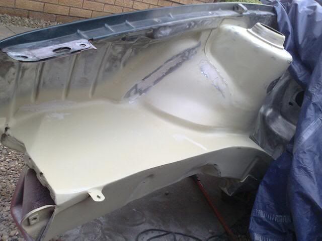

mrbeige 0 Posted April 9, 2009 What type of paint are you using dude? It looks like you've got cellulose and water based mixed together to get a reaction like that?? Maybe?? Quote Share this post Link to post Share on other sites
20vtvw 0 Posted April 10, 2009 i read it on an other thread that agu s have forge pistons and rods and many poeple agreed so going with that????at the power i want to run its not really that important anyway .. i used u-pol but then the halfords filler primer didnt dry so think thats were my problem was.. ive done a test piece with u-pol etch then u-pol filler and u-pol primer with halfords top coat and lacker and all was good so going to stick with that way as i dont have a big enougth compresor or paint gun to spray 2k stuff., Quote Share this post Link to post Share on other sites
SerialDUB 0 Posted April 10, 2009 i used u-pol but then the halfords filler primer didnt dry so think thats were my problem was.. ive done a test piece with u-pol etch then u-pol filler and u-pol primer with halfords top coat and lacker and all was good so going to stick with that way as i dont have a big enougth compresor or paint gun to spray 2k stuff., I've had a similar issue with the paint. The problem with working on a car in this weather, as you've probably come to realise, is drying time. Try leaving as much time as possible in between stages and you should have a much better finish. If the filler and/or primer is not 100% dry the paint will react with the excess moisture. I had to re-do mine after getting the same result :( . You'll find much better quality materials than halfords at a trade paint/automotive refinishing shop local to you. The u-pol filler is too hard in my opinion and is more susceptible to cracking. Great work so far. :) Quote Share this post Link to post Share on other sites

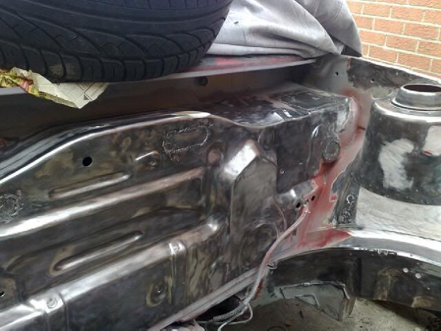

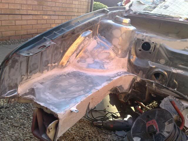

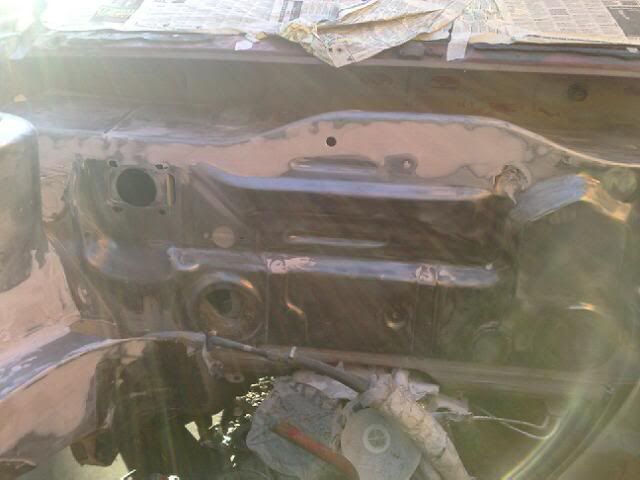

20vtvw 0 Posted April 19, 2009 heres just a couple of pics from this weekend,. welded up the remaining holes and started to fill,. Quote Share this post Link to post Share on other sites
tim20vt 0 Posted April 19, 2009 still goin at it top effort mate thats dedication :D its gunna be smooth! Quote Share this post Link to post Share on other sites
20vtvw 0 Posted April 19, 2009 thanks mate ,, if it doesnt go right this time i will have to scrapp it and use my paint money for another rado and forget the smooth idea, this is how it used to look., Quote Share this post Link to post Share on other sites

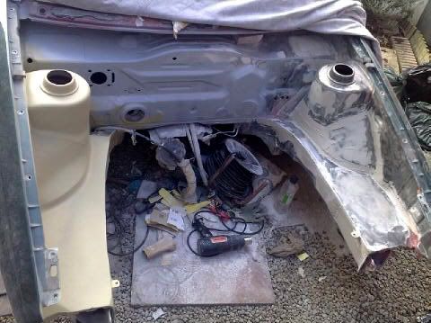

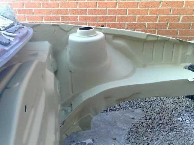

20vtvw 0 Posted April 21, 2009 one side done., just need to finnish firewall and other side now., Quote Share this post Link to post Share on other sites
Emkayvr6 0 Posted April 21, 2009 Nice work matey :salute: Quote Share this post Link to post Share on other sites

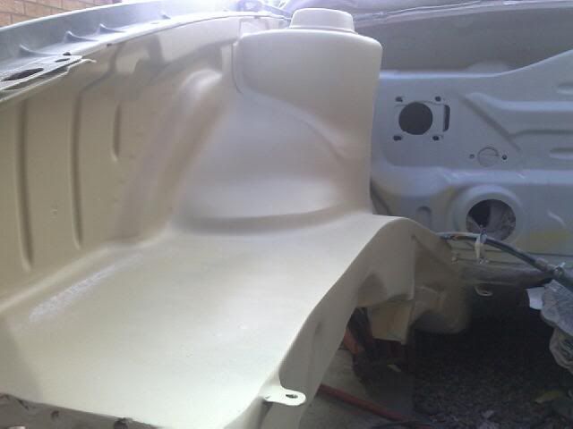

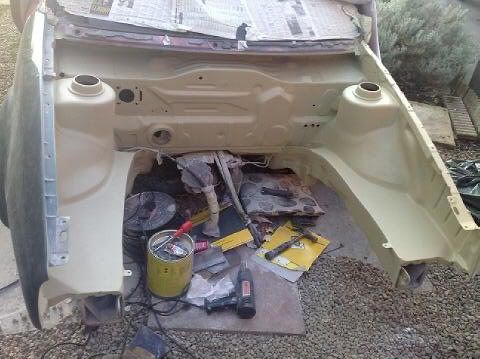

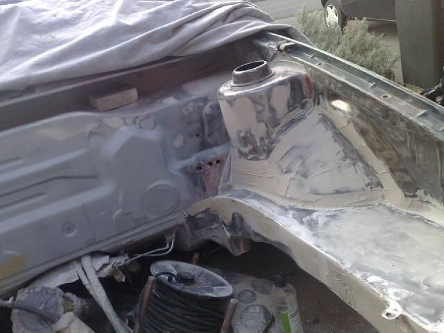

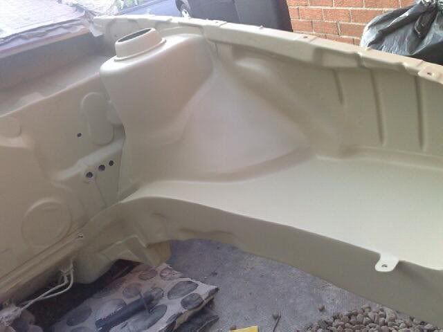

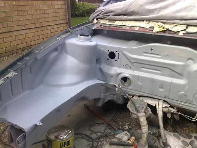

20vtvw 0 Posted April 28, 2009 just a couple of pics nearlly done now !! in etch and filler primer and started the other side and full shot cant wait to finnish this now but had to stop because of the weather :( Quote Share this post Link to post Share on other sites
Adski 0 Posted April 28, 2009 Wow! Looks really good!! Quote Share this post Link to post Share on other sites

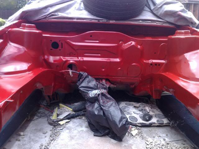

20vtvw 0 Posted May 4, 2009 couple more pics all in shape now just needs to flat and paint but weather forcast showing lots of rain on its way so wont be in paint for a wile., :( will have to get in the shed and paint the servo and start stipping the subframe until the weather gets better., Quote Share this post Link to post Share on other sites

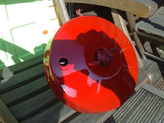

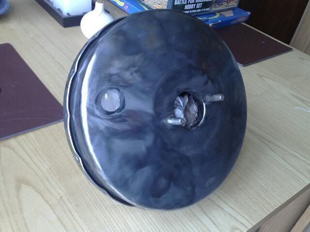

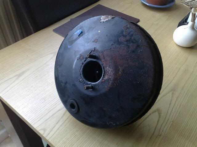

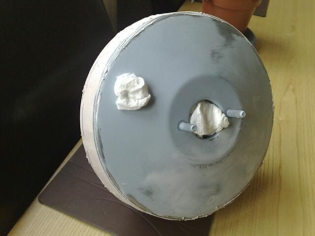

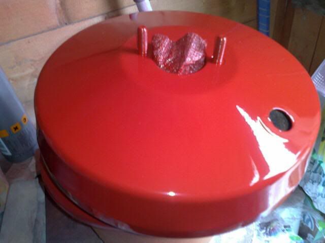

20vtvw 0 Posted May 6, 2009 i managed to smooth the servo now and get some paint on., B4 stipped smoothed., then after lots of sanding etch primer ,filler primer, gray and then red primer finnally got some paint on., :D Quote Share this post Link to post Share on other sites

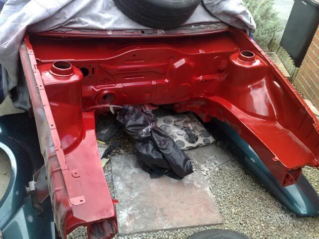

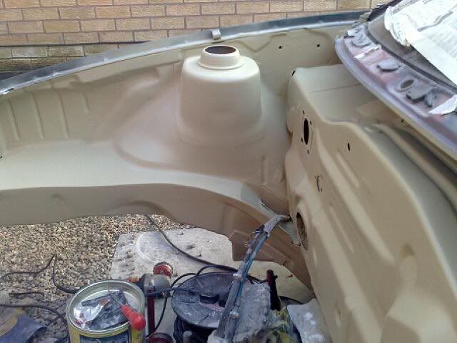

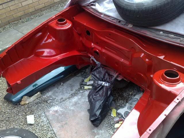

20vtvw 0 Posted May 7, 2009 started painting the bay now just need to wet sand and add some lacker., Quote Share this post Link to post Share on other sites
