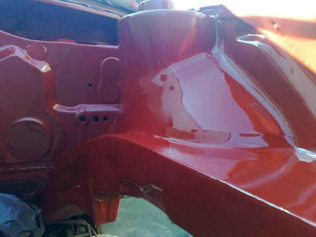

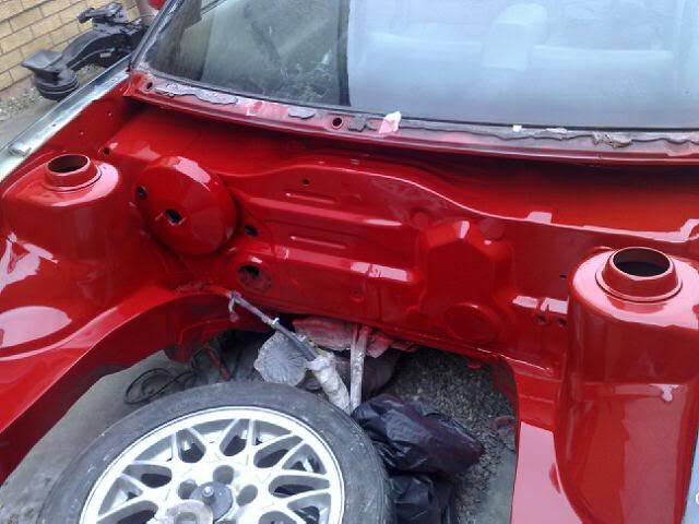

Emkayvr6 0 Posted May 11, 2009 looking good man, why grey and red primer??? Quote Share this post Link to post Share on other sites
-Neil- 0 Posted May 11, 2009 looking good man, why grey and red primer??? I can only asume its because some colours require certain coloured primers to make the colour the propper shade, if i understand right, depending what primer you use, ie, white/black light/dark, it affects the final shade? I once had a pearlesant colour on my old car when having a full respray, and when i brought the paint i had to get a certain primer/base coat before the top coat. Neil Quote Share this post Link to post Share on other sites
voo51 0 Posted May 12, 2009 Love the bay!!!!! That is what I want to do next year. Looks great as does the servo. :D Quote Share this post Link to post Share on other sites
Emkayvr6 0 Posted May 12, 2009 looking good man, why grey and red primer??? I can only asume its because some colours require certain coloured primers to make the colour the propper shade, if i understand right, depending what primer you use, ie, white/black light/dark, it affects the final shade? I once had a pearlesant colour on my old car when having a full respray, and when i brought the paint i had to get a certain primer/base coat before the top coat. Neil Yeah the red primer would have been needed as the top coat was red and like u say it effects the final colour i just wondered why spray grey before it, was wondering if i'm missing something thats all Quote Share this post Link to post Share on other sites
20vtvw 0 Posted May 12, 2009 Thanks for the comments, i sprayed the gray primer then realised i needed red primer to get the correct shade but then found it was too dark so gave it a quick coat of flash red then tornado red over that and some clear coat , :scratch: now its spot on and very shiney!!(will put some pics up later.,) my painter came to see the car on saturday to give me a quote and said hes going away in mid june (when i wanted it painting)so has to be done b4 he goes.,so now have a bit of a rush on to get the engine and wirering done b4 then., will put some progress pics as and when ,,now on with my subframe then clean up the engine and ask a friend to hide the wires for me., wile the car is away for paint i plan to get the wheels re-built ,get the dash A,BandC pillers and centre console done in cream flock(will be re done in leather at some point ) so it can all be reasembled when it comes back., Quote Share this post Link to post Share on other sites
Emkayvr6 0 Posted May 12, 2009 ah cool, u using a gun or cans? at work(on super yachts) we've been putting 3 coats of primer before top coat, white, grey then white, reason being so we can see if when break through a layer when sanding but never heard of it being done on cars, and was wondering if u did it for a similar reason. Anyway top work mate, looking forward to seeing it all finished :) Quote Share this post Link to post Share on other sites

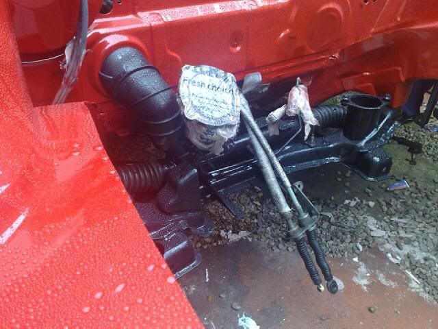

20vtvw 0 Posted May 13, 2009 :shrug: only has so many layers as 1st was etch to protect then filler primer to fill scratch marks then got the wrong colour ect.,all done with rattle cans.,very happy with the finnish., couple of pics with lacquer and servo now fitted., me and my mate will be checking the looms on friday and seeing were to run them ., im tring to sort out someone to powdercoat my subframe at moment, and im going to have to get a new windscreen as ive burnt mine with welding splatter :epicfail: Quote Share this post Link to post Share on other sites
CorradoVR6-Turbo 0 Posted May 13, 2009 fuc*king good job with rattle cans! :shock: 8) Quote Share this post Link to post Share on other sites
Emkayvr6 0 Posted May 13, 2009 Yeah agree good job with cans, ever since i started using guns i hate using cans now, such a small fan pattern out of a can,but top marks to ya bud :salute: gonna be good to see this finished, gonna look sweet i reckon Quote Share this post Link to post Share on other sites
-Neil- 0 Posted May 13, 2009 awsome finish mate! How many rattle cans did it take of each different type? and i see you've taken the air intake for the interior heaters out, how will that work now? Quote Share this post Link to post Share on other sites
20vtvw 0 Posted May 13, 2009 thanks for the comments, it took 4 cans of primer and about 7 red then 2 clear would probably cost less to get it done in paint shop but i like to do as much as possible myself,and the finnish looks better than in the pics.. i have removed the heater matrix and pipes so wont have any worm air ,but will keep the motor and ducts with holes drilled just above the motor to recirc air from inside .,the car gets pretty worm inside anyway and wont be driven when its really cold outside but might look into an electric heater at a later date., its just a shame to have to put an engine in there and clutter it up but cant wait to drive it again,. Quote Share this post Link to post Share on other sites

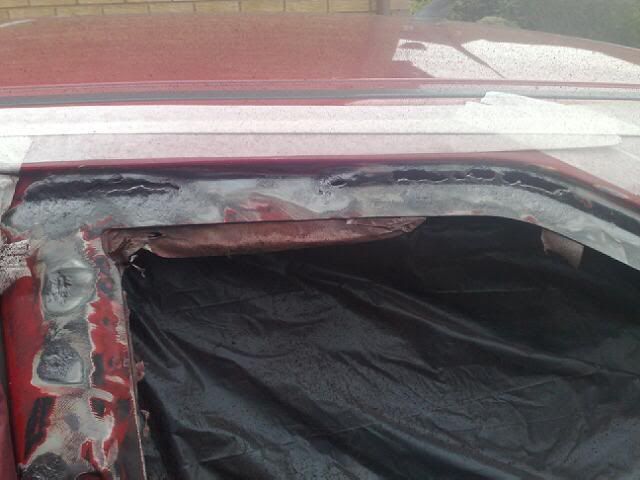

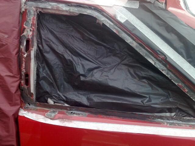

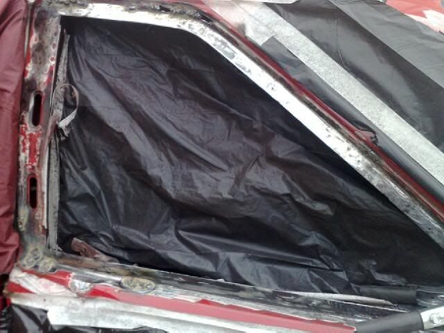

20vtvw 0 Posted May 14, 2009 found a bit more work to do behind rear quarter window., :censored: started to weld up the holes didnt get chance remove the other side just hope its better than this.,but at least the window was easy to remove :lol: Quote Share this post Link to post Share on other sites
tim20vt 0 Posted May 14, 2009 bay is looking realy good now,top job,shame ya found the rust under the window how did ya get it out in the end with a wire? Quote Share this post Link to post Share on other sites
20vtvw 0 Posted May 14, 2009 this side was sitting on rust so near enough fell out,.but did run round it with stanley nife then cut round with normal wire,the seal looks perfect so shouldnt be a problem putting it back in after paint ., only have a couple of weeks left to prep everything ,might have to fit engine after its done (with great care) hows yours coming along? Quote Share this post Link to post Share on other sites

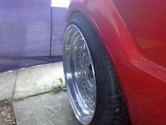

20vtvw 0 Posted May 23, 2009 i got some fk highsport coilovers the other day and have fitted the rears to see how the wheels will sit., i need to get some 5x112 rear discs made up so i can fit them properly but this gives an idea of the finnished look., thats with 215 40 16 tyres but im thinking of running 205 40s to give just a little more clearence., :norty: Quote Share this post Link to post Share on other sites

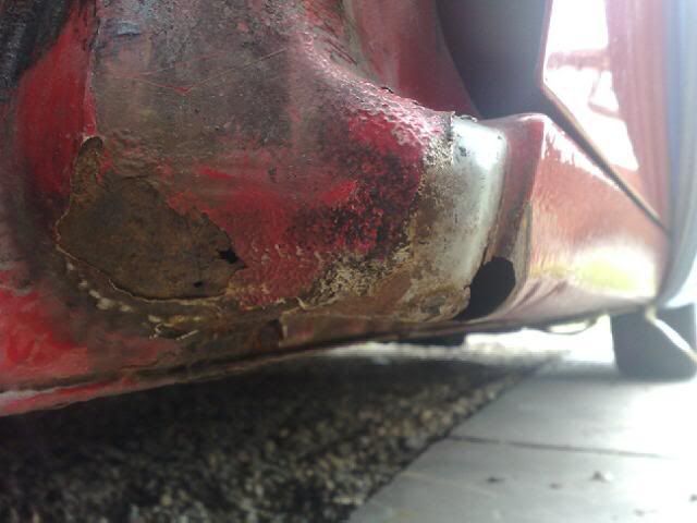

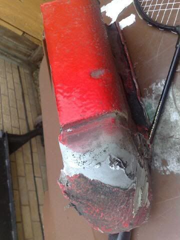

20vtvw 0 Posted June 9, 2009 well its still not in for paint as i found some hidden rust and a large dent that was just hidden with masses of filler., :nono: so it wont be painted now until my painter is back from holls in july .,but i have found a corrado breaking near were im working so im off to cut out all the bits i need from that to replace my bent and rusty bits., Quote Share this post Link to post Share on other sites

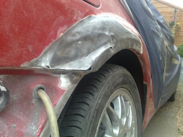

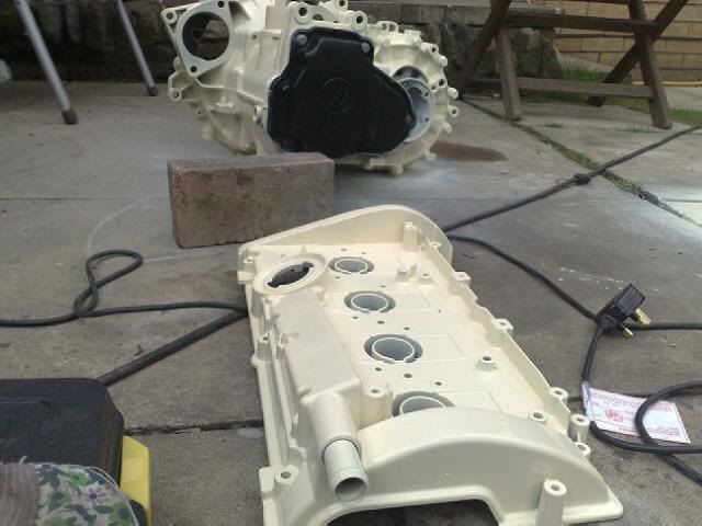

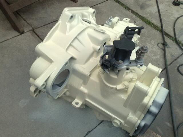

20vtvw 0 Posted June 27, 2009 thanks ,well ive been busy cleaning all engine bits and got a td passat gearbox cleaned that and painted it,got a section of sill to replace my rusty bit but havent welded it in yet .,im hoping to have the engine all back in b4 it goes into paint on the 11th july then just a case of rebiulding it back up ,i have a list as long as my arm of things still to do but mainly small things., Quote Share this post Link to post Share on other sites
CorradoVR6-Turbo 0 Posted June 27, 2009 making good progress bud,not sure on engine colour? cream with red? :wink: Quote Share this post Link to post Share on other sites
20vtvw 0 Posted June 27, 2009 hopefully will all blend in as leather is cream and looked great against the red imo,like srawberrys and cream :luvlove: Quote Share this post Link to post Share on other sites
