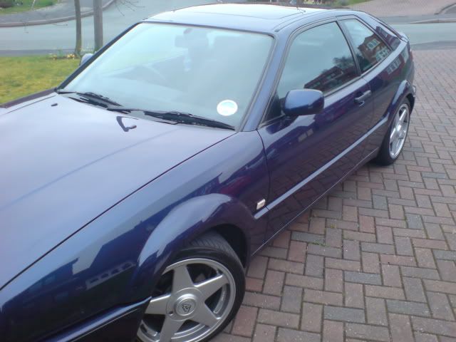

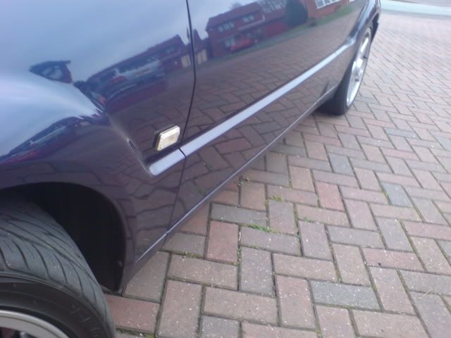

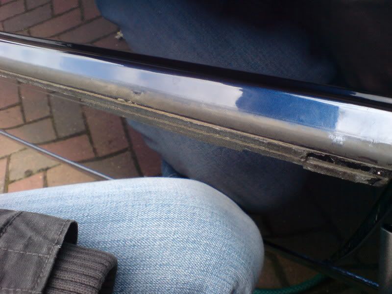

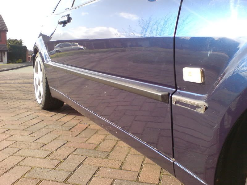

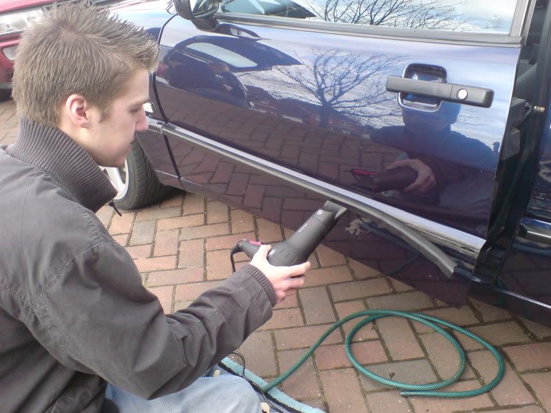

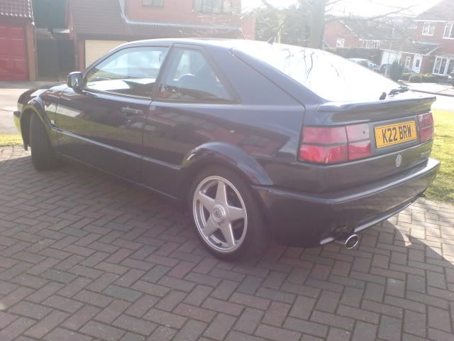

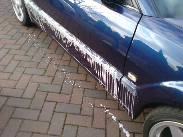

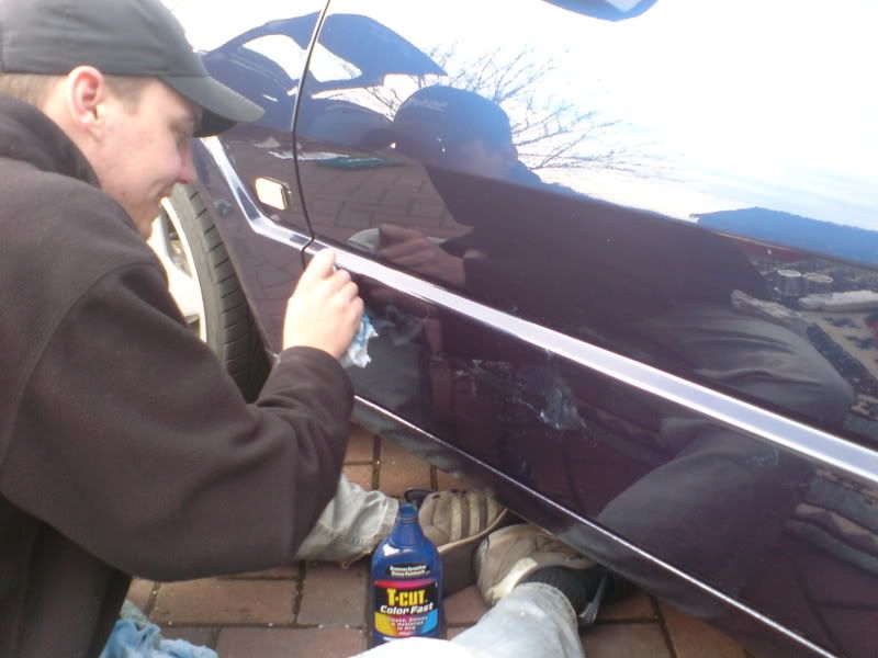

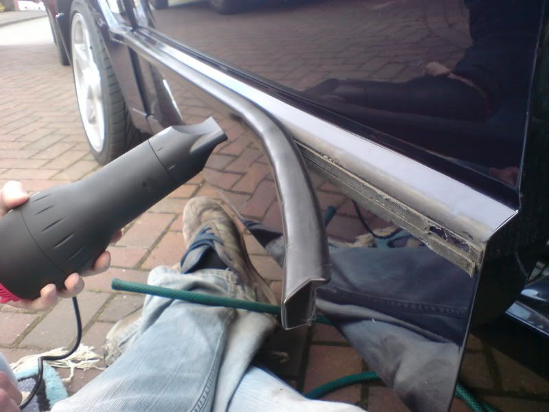

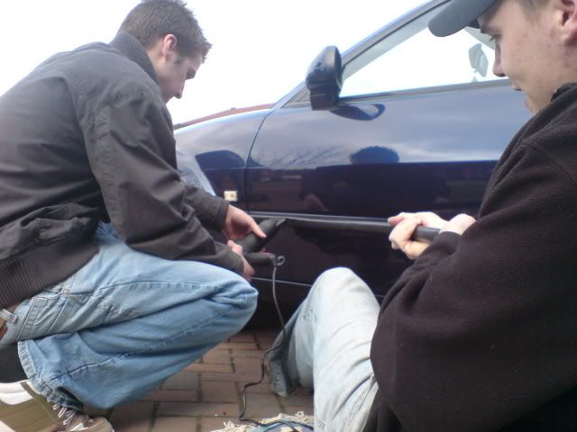

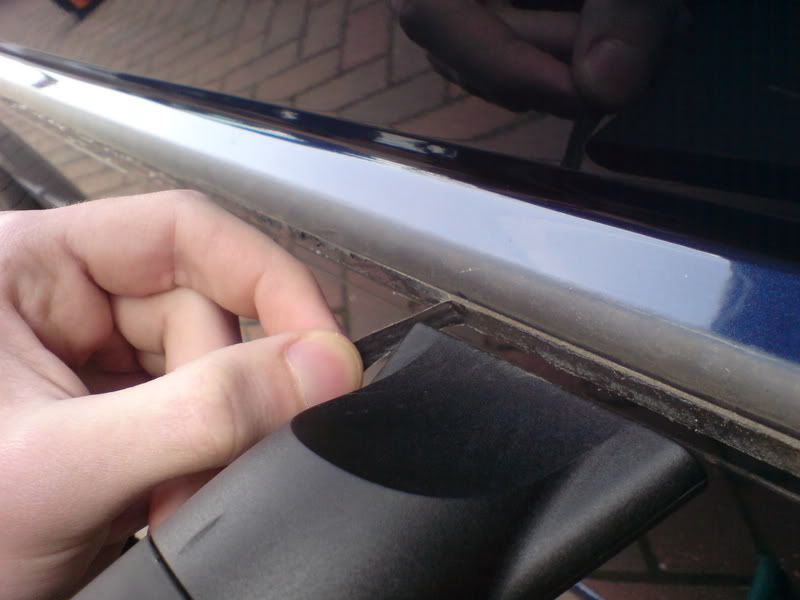

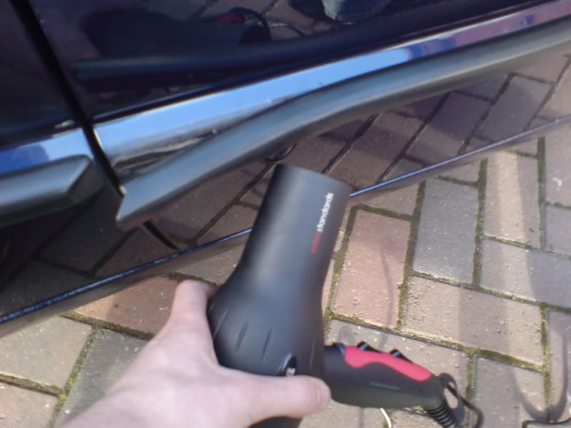

ben_wooduk 0 Posted March 16, 2009 I gave this a go at the weekend, It took ages!! There is loads of useful info on here, some horror stories and some not so useful info. I was a tad nervous about ruining my paint to say the least, so thought I'd post how i did it in pics and hopefully help others! Sorry in advance if this thread is useless, it kept me occupied for at least 10 minutes :D I found the best way was to heat up the rubber trim as much as possible. Gently pull it away from the sticky foam leaving the foam on the car. Then heat up the foam and pull that away. I was then left with er.. crap all over my door. Spent hours with Autoglym Tar remover removing every last little bit. You could probably do it quite quickly if you wern't so picky, otherwise you will spend hours making it perfect(trust me, Hours!!). To finish off i needed to T cut (horrible stuff) the entire revealed section. Then give it a dam good clean and polish. I chose my weapon (thanks to the missis :)) Every one knows what they look like attached! Started with the front wing piece, didn't take long at all to remove. Its the doors that took ages for me, depends how brave you are i suppose, i took it really slow! Extra set of hands is very useful! Finishing touches! Not the best pics, but i don't think its looks that different in the pics. Looks alot better in person. This took me soooooooooooo long its untrue! but its definitly worth it. Just make sure you get the kettle ready, and the biscuits :lol: Quote Share this post Link to post Share on other sites

paddy26 3 Posted March 17, 2009 I did this on a spare door which I'm about to paint. I wasn't worried about paint coming off. I just used a kettle of hot (not boiling) water to soften the glue and the trim came off pretty easy. No paint came off either and most of the glue came off with the trim. Longest part of the job was waiting for the water to boil! Hope this helps. Paddy Quote Share this post Link to post Share on other sites
Leonard 0 Posted March 17, 2009 Agreed boiling water worked best for me. Have to say though unless you are considering a repaint Im not sure I would even attempt this! Matt Quote Share this post Link to post Share on other sites
ben_wooduk 0 Posted March 17, 2009 Never thought of boiling water to be honest, seems a good idea though. Didn't want to knacker the paint up either. Its took 2 corrados and about 3 years of ownership to pluck up the courage :lol: I just thought if it goes pear shaped, i'll just attach the side trim back on. Whats the worst you can do with a hair dryer :shrug: To be honest now its done, its the best paint on the car :lol: and it cleans the side of the car up perfect. As long as you heat the hell out of the trim, and go very very slow you should be ok, or was i just lucky :cheers: Quote Share this post Link to post Share on other sites
