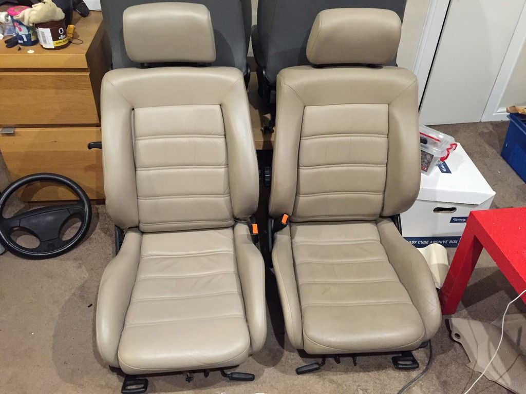

easypops 8 Posted March 25, 2016 I can't really take that much credit on the joint venture as I've been in and out the area a lot since these cars arrived.. Im chuffed to bits that the worst car, that has now gone, has provided loads of panel cut outs to help Martin with the Storm so it has more than paid for itself... The red one needs an inspection underneath to determine the best plan.. If its rotten then it may end up stripped but with the ultimate Corrado Womble it might not be easy to convince him.. Im not as emotionally attached as Martin... Top work on the leather by the way mate... Thanks mate :lol: I can't believe how well the leather is turning out, I've only done the bits in the pics with 2 coats so far and already they look magic 8) Quote Share this post Link to post Share on other sites

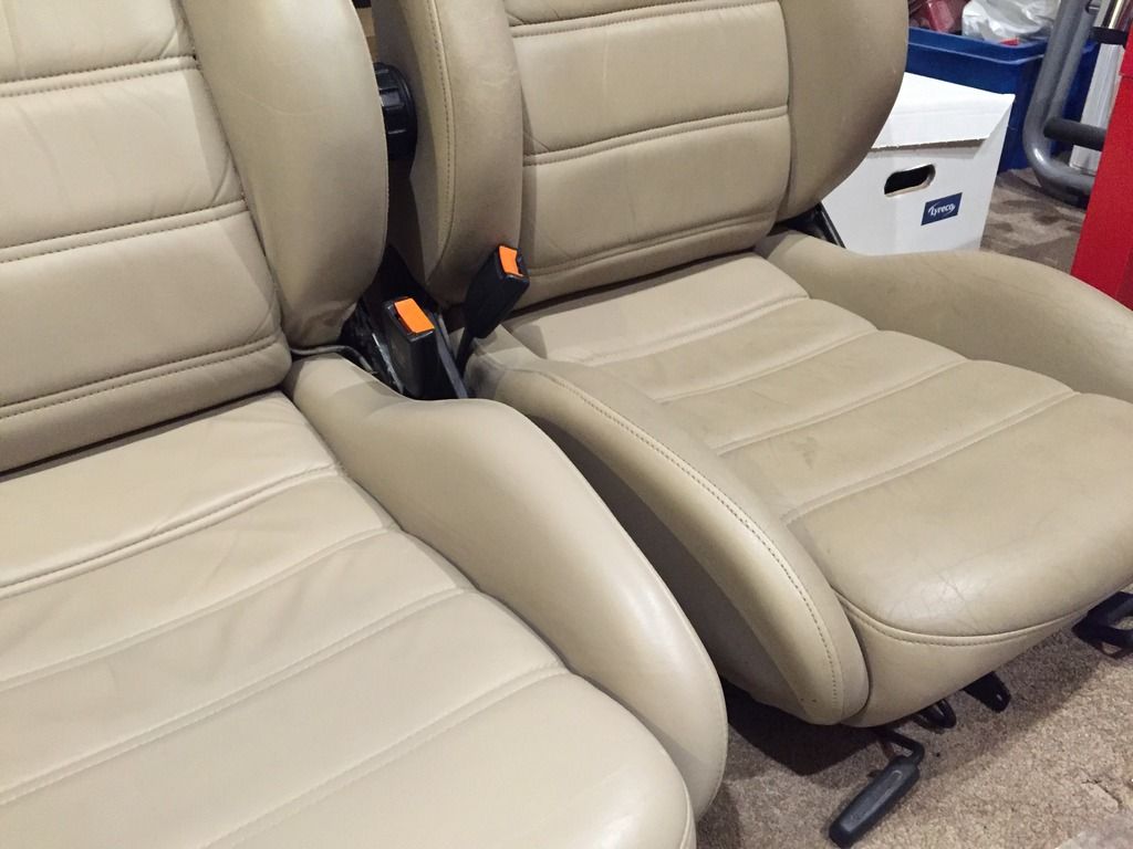

easypops 8 Posted April 30, 2016 (edited) Another small update, after I changed the fuel rail on the red one it leaked on start up, so that was abandoned until I got some new injector seals, which I got last week, I also removed the fuel rail from the breaker so I could take my time sorting out the situation away from the car. Got it done quite quickly.....repetition makes it easy :lol: It fired up fine and without any leaks as far as I could tell but the idle was all over the place, left it like that as life got in the way again, next step will be to change the ISV and then the MAF, fairly sure it's the ISV but time will tell. Also been dying the storm leather a little bit at a time, drivers seat done and it's looking nice with the passenger seat as a comparison Edited April 30, 2016 by easypops Quote Share this post Link to post Share on other sites

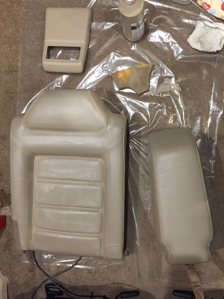

easypops 8 Posted April 30, 2016 Some other bits under way, had a spare sunroof switch surround that was badly marked and that I couldn't get clean.....the dye works on that too.....wonder how it would take to a headlining? Might give it a wee try on one of the spares :) These bits are wet btw and not nearly as blotchy as the picture suggests Quote Share this post Link to post Share on other sites

easypops 8 Posted May 1, 2016 Is that from http://www.liquidleather.com/en/ ? It is mate, I opted for the scuffmaster dye as it has built in sealants, which I've obviously not tested yet but it does dry in very well and when the time comes I'll be happy to sit on them without worrying about it coming off Quote Share this post Link to post Share on other sites

easypops 8 Posted June 11, 2016 They look great, does the scruffmaster hide small cracks? Reasonably easy to use? Sorry, just spotted this, yes it hides the small cracks well, I've done 3 coats and I'm happy so far, very easy to use, I'm using a thin sponge. You just need to be careful that you don't let it pool in the corners/side of bolster area. Quote Share this post Link to post Share on other sites

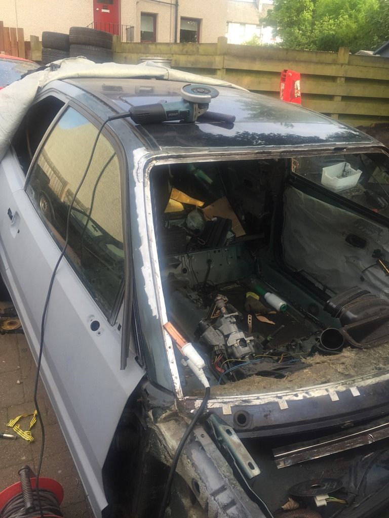

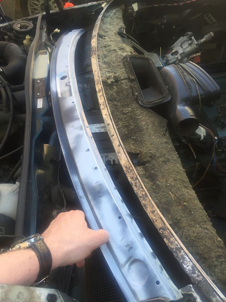

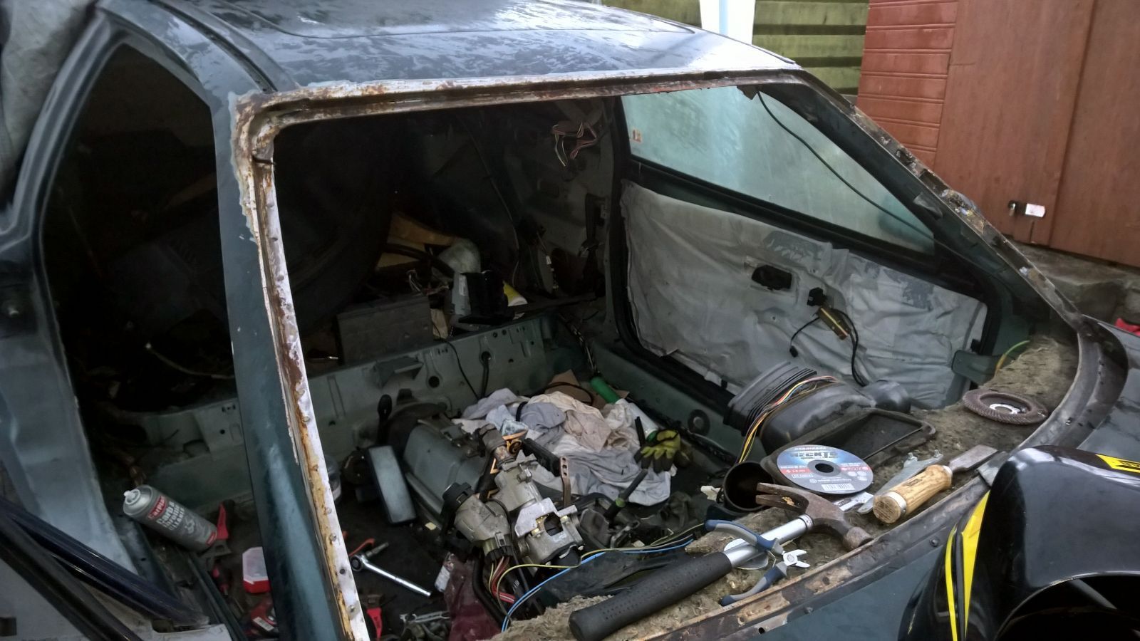

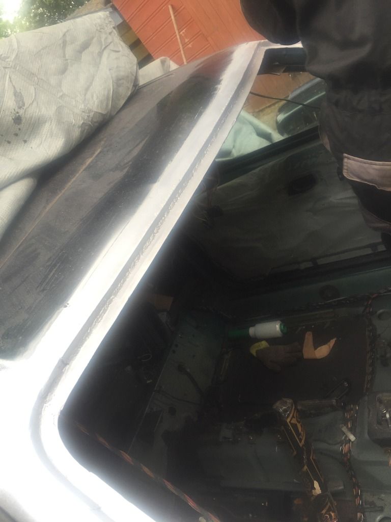

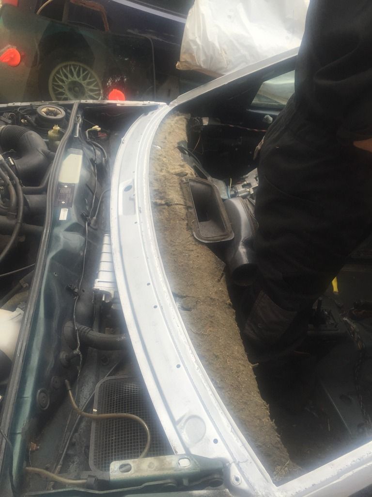

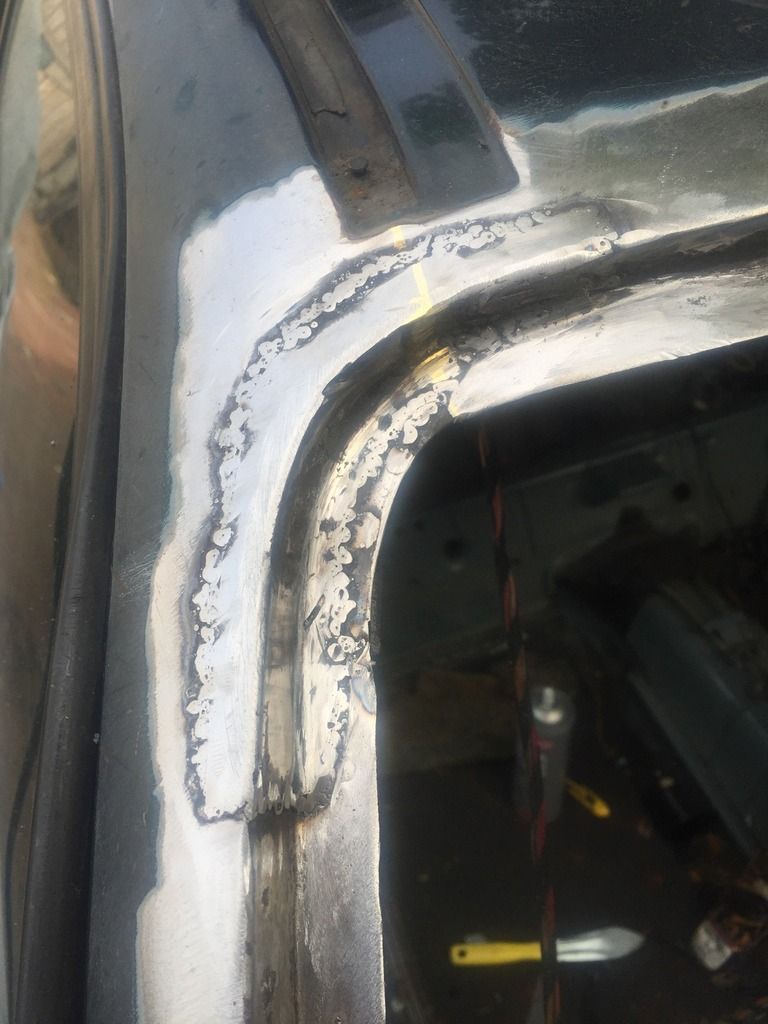

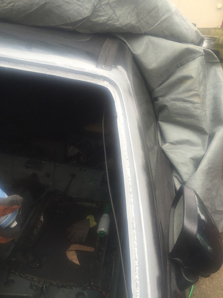

easypops 8 Posted June 11, 2016 Wee bit of progress on the Storm, as the weather has been good recently, my welder friend at long last surfaced from hibernation:lol: How the windscreen area looked after the screen came out The bottom section needed replaced The start of the repair New metal in at various places and bottom section replaced Still some grinding/sanding needed but it's solid again, painted with galvanising paint to keep it happy until then. Couple of small repairs on the n/s sill , out with the n/s rear window and the tailgate glass and barring a few wee fiddly bits it should be ready for painting :) Quote Share this post Link to post Share on other sites

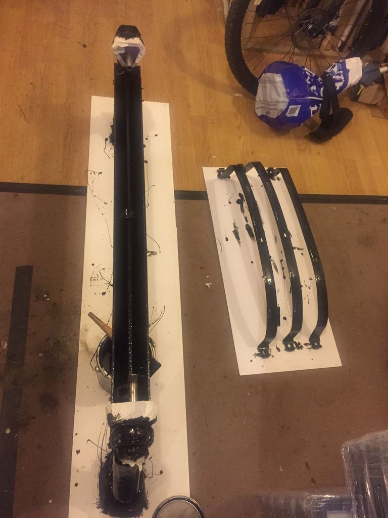

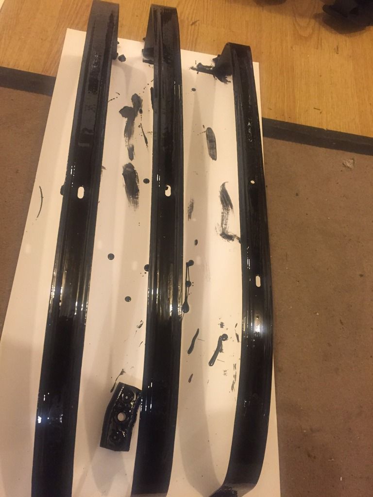

easypops 8 Posted June 11, 2016 Did a bit of painting tonight......rear beam off the Twilight and a set of tank straps for the Red one as I'll be dropping the fuel tank soon to access the filler area for a wee repair, no point putting the old rusty straps back on Beam was blasted a while back and has been in my workshop to keep it dry/warm and I went over the straps earlier with a wire brush on the grinder Quote Share this post Link to post Share on other sites
