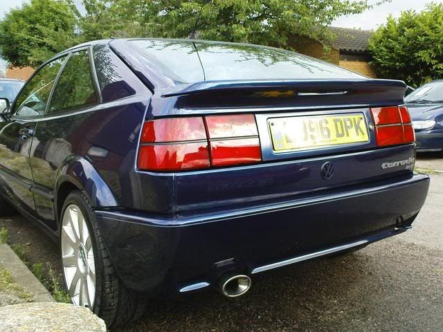

GaVR6in 0 Posted June 20, 2009 Finished my red rears today, done a proper job on them, rub all the writing off and put the final coat of lacuer on today what do you think. Quote Share this post Link to post Share on other sites
__Andy__ 0 Posted June 20, 2009 looks good, was that using the guide on the wiki? Quote Share this post Link to post Share on other sites
Kempy 0 Posted June 20, 2009 very good effort, I done mine but mistakingly bought some black tint, didnt realise untill I was actually spraying it on the lens :cuckoo: but it looked quite good as its red smoked :D what are you doing for coloured bulbs as they will all be red now Quote Share this post Link to post Share on other sites
dgtvr6 0 Posted June 20, 2009 Looks sweet.. How do you get round MOT though? I' have thought you would need the white reverse and orange indicator lights to pass?? Quote Share this post Link to post Share on other sites
GaVR6in 0 Posted June 20, 2009 You are probably right but I will worry about that nearer the time. But I do no someone quite close and I am hoping he might lend me his when I need them :wave: O and I didn't use the wiki (didnt know there was one :shrug: ) but I did get my tips off of the site tho Quote Share this post Link to post Share on other sites

young dub 0 Posted June 20, 2009 look great, what lacquer did you use? Quote Share this post Link to post Share on other sites
Anton Sobriquet 0 Posted June 21, 2009 Looks really nice! 8) I bought some cheapo crystal/reds but don't like 'em - look a bit naff, really. Inspired to do mine like yours now. Does it mean you've got red reversing lights, tho'? Quote Share this post Link to post Share on other sites
GaVR6in 0 Posted June 21, 2009 How did you guess dale lol. I used halfords lacuer and yes I now have red reversing lights :nono: Quote Share this post Link to post Share on other sites

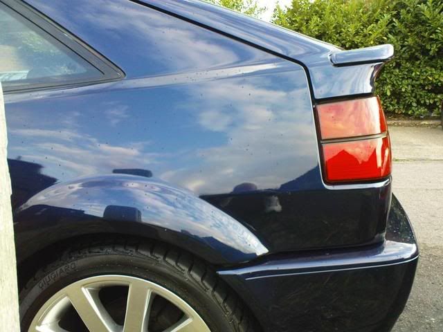

borarob 0 Posted June 22, 2009 i finished mine yesterday also - yours look great. what if anything did you use to give them a final polish up? i have a few duller patches on mine where the lacquer misted on - i'm thinking some T-Cut or SRP should sort it.. Quote Share this post Link to post Share on other sites
zak 0 Posted June 22, 2009 great finish, what tint spray did you use? Quote Share this post Link to post Share on other sites
Leonard 0 Posted June 22, 2009 Looking good mate. Look a lot shinier than mine. Sure mine used to be like yours..... may try another coat of laquer and see if it brings them back. Have my MOT today and just took them off to be on the safe side. Only takes 5 mins a side to do so no biggie. Matt Quote Share this post Link to post Share on other sites
CazzaVR 0 Posted June 22, 2009 Would think MOT should be fine? I've had a couple of sets of lights smoked (really dark) in the past and they've gone through fine. Didn't think it was something you could fail on :shrug: To get the laquer good, rub down with 1500+ wet and dry and then a cutting compound ;) Quote Share this post Link to post Share on other sites
GaVR6in 0 Posted June 22, 2009 The tint spray I used was called savage tail light tinting spray. I did them about 3 of 4 weeks ago and they were a bit dull so I gave them a new coat on saturday. Quote Share this post Link to post Share on other sites

borarob 0 Posted June 23, 2009 Would think MOT should be fine? I've had a couple of sets of lights smoked (really dark) in the past and they've gone through fine. Didn't think it was something you could fail on :shrug: To get the laquer good, rub down with 1500+ wet and dry and then a cutting compound ;) will T cut then SRP do the job? I've got some G3 but that stuff scares me. Quote Share this post Link to post Share on other sites
CazzaVR 0 Posted June 23, 2009 Should be fine :) Quote Share this post Link to post Share on other sites
borarob 0 Posted June 23, 2009 Should be fine :) ok just to be sure cos i wasn't clear I mean should 1500 then T cut then SRP restore the shine taken away by the wet sanding ? :lol: mine look fine but if i can get them even better then i'll have a go! Quote Share this post Link to post Share on other sites
CazzaVR 0 Posted June 23, 2009 When I did my last set, they were perfect after just the wet sand & T-Cut. Have also used AG Paint restorer/renovator before instead of T-Cut and it works really well. Quote Share this post Link to post Share on other sites
