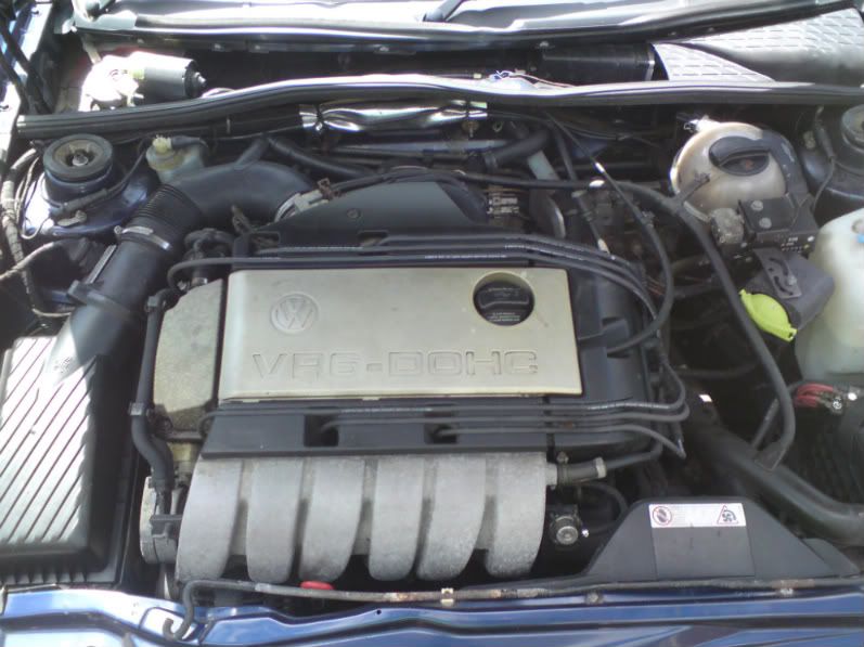

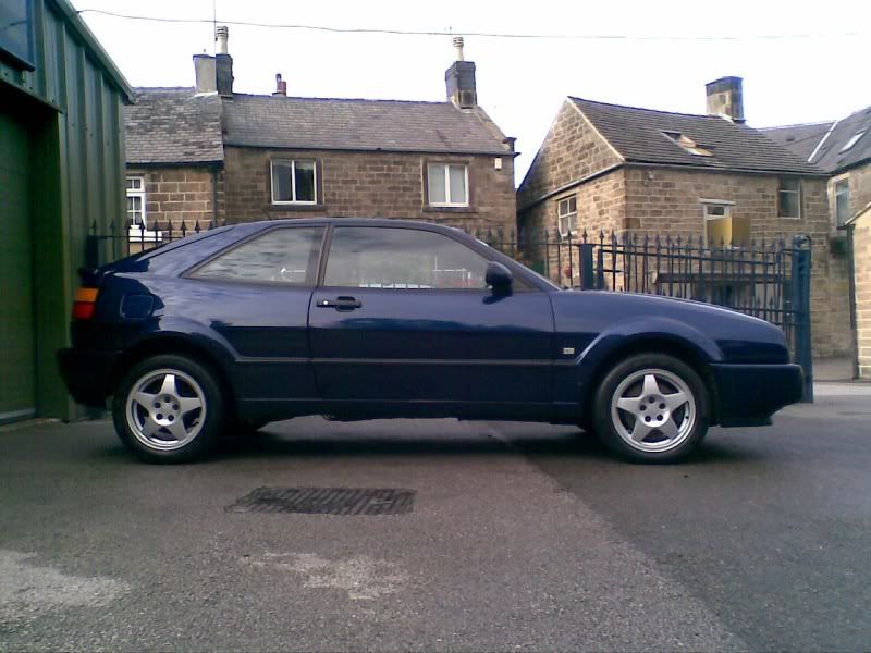

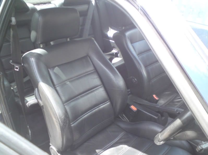

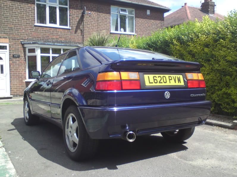

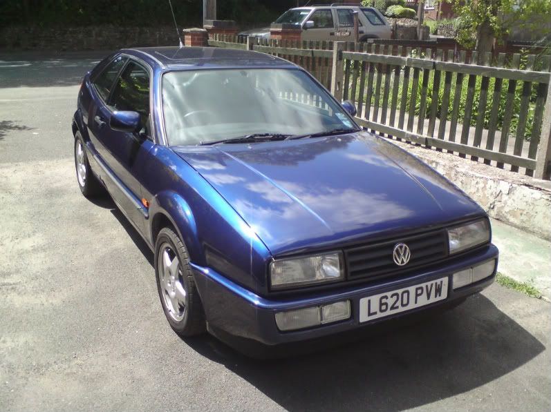

Purple Tom 0 Posted July 29, 2009 (edited) Hey everyone, On sunday I picked up my new VR! I haven't managed to get any pictures yet so here's some taken from the advert of pretty much how it looks at the moment: The car is pretty straight and honest, but by no means perfect. It has a few bodywork blemishes such as a couple of parking dents on the passenger door, scratches and scuffs in places and by the looks of it someone couldn't judge where the front was as the bumper has some stonewall rash! Nothing that can't be sorted though. Mechanically it seems pretty good. Its done 126k and has no evidence of the chains being done, so I'll get those sorted over the winter, along with doing the clutch for peace of mind. The gearbox has an issue where it crunches into first when engaging from stationary which is obviously a worn baulk ring or similar, so while I've got the 'box off to do the clutch I'll get the gearbox reconditioned too. The interior is full black heated leather and is in very good condition, and all the other electrics work which is great, so I've got no worries there. It has a Toad Ai606 alarm but I think I'm going to remove that and fit a Cobra unit as the Toad was fitted in 2001 and I'm not sure how much I want to trust an 8-year old alarm! Other than that it drives really nicely with no smoke, and pulls well in every gear. The car was advertised with a misfire from cold which I sorted by clearing a couple of very old faults from the ECU. It turns out this car used to live roughly 500 yards up the road from my house up until the end of last year! The previous owner spend £100's at my local stealers (Parkway in Derby) on small bits and pieces, and looking back at the history it hasn't really wanted for much in its life! I'm 25 at the end of August so the car is staying off the road until then, and I'm going to use the time to get it ready for its MOT which expires at the start of September. Leonard said thats a bit like having a supermodel girlfriend and not being able to take her clothes off, which is pretty accurate :lol: Last year it went through the MOT but had advisories on both front top mounts, all the rear flexi hoses and one of the front-rear brake pipes. I'm going to replace these as a matter of course, and I have a set of Mk4 rear calipers to go on to sort out a pretty poor handbrake. I'll also have a gander at the front suspension and see if it might be time for new ball joints etc, but as long as it gets through the MOT I'll worry about the rest of it as I come to it! Here's a couple of pictures of it in the background with my 8V - I'll update this thread as and when I can :) Thanks for reading! Tom Edited February 18, 2012 by Purple Tom Quote Share this post Link to post Share on other sites

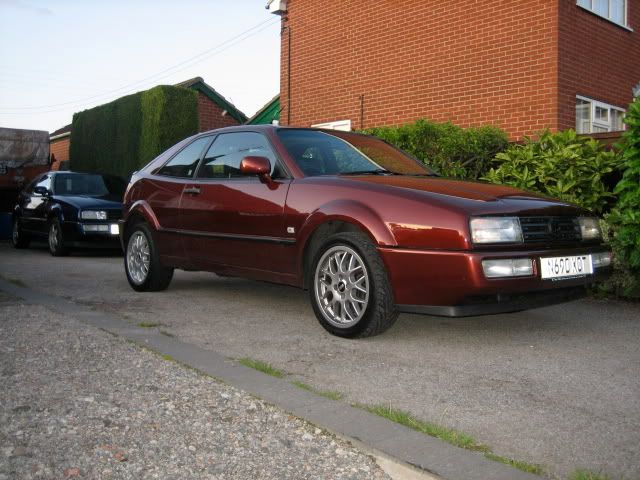

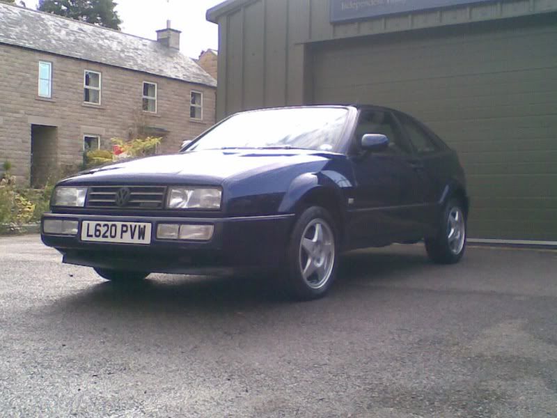

Purple Tom 0 Posted September 23, 2009 Few more pics of how it looks at the moment...just washed it after work so I thought I'd take the opportunity! :D Quote Share this post Link to post Share on other sites

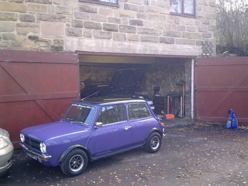

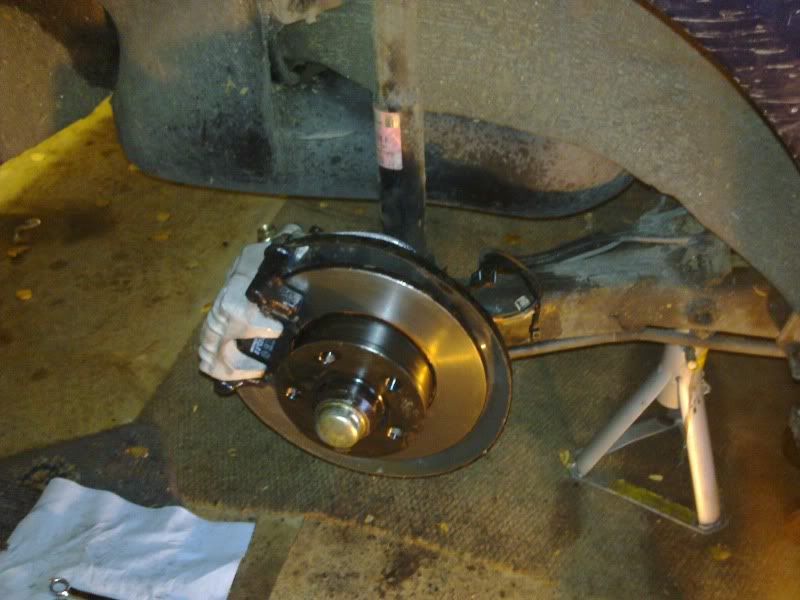

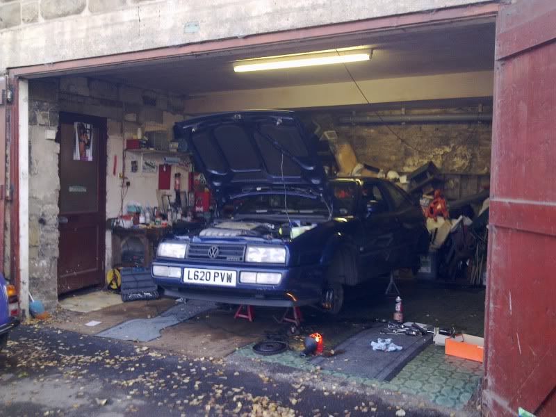

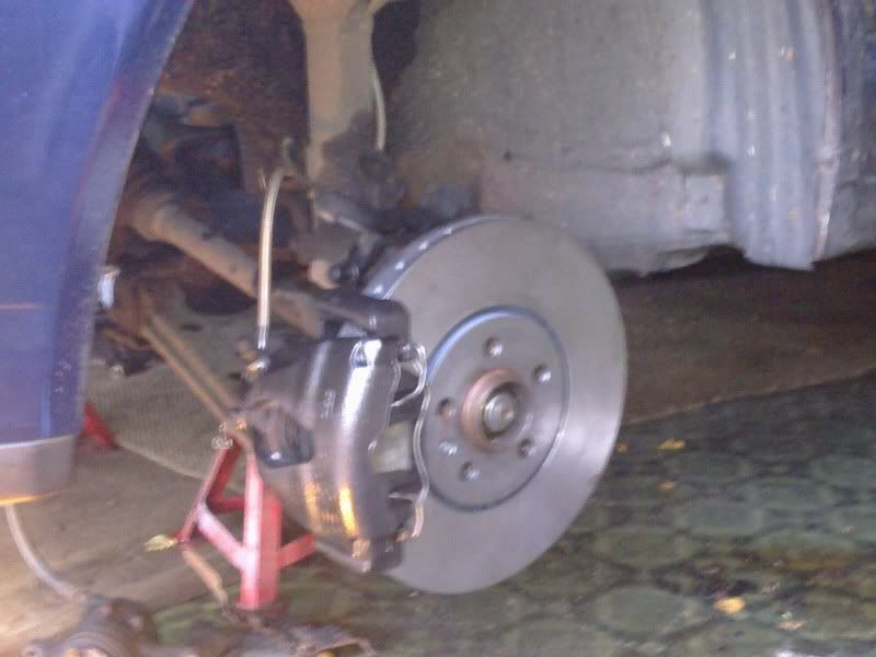

Purple Tom 0 Posted November 16, 2009 The next lot of upgrades are now complete. Spent about 8 hours on sunday working on it and fitted: - Genuine VAG 288mm front discs and pads - Refurbished carriers and calipers - DG Autotech front stainless braided hoses - Genuine VAG rear discs and pads - Genuine VAG rear wheel bearings - Refurbished Mk4 calipers and carriers - Goodridge MK4 conversion hoses It was a fun day with the usual repairs of previous bodges, had to make up a couple of new brake pipes due to poorly made flares, and the only way to get one of the rear carrier bolts out was with lots of heat and by hammering a multi-hex socket over it (someone had previously rounded it off!). Apart from that it all went well and the brakes bled up lovely after all the work, although they still feel understandably vague because of the new pads etc. I've done around 40 miles and they're improving all the time :) Here's a couple of pics, nothing very exciting but gives an idea: And here's my Mini with the Corrado in the background - its bizarre because it's usually the Mini thats up on axle stands with the Corrado outside :lol: Quote Share this post Link to post Share on other sites
