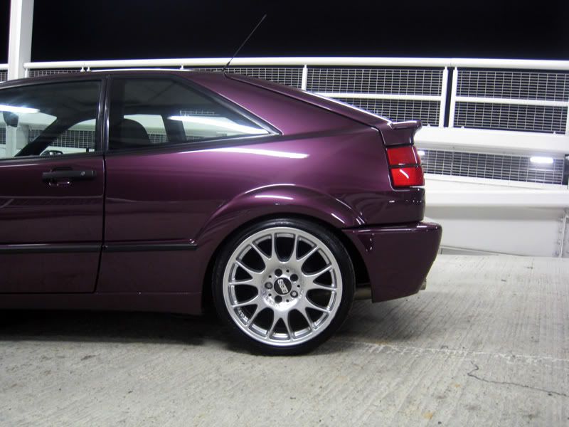

zak 0 Posted October 27, 2009 You have to be really low to benefit from these as at a moderate drop they will push the wheel too far back in the arch. If you are low enough then you have to be equally low or even lower at the front which won't be easy or may not possible. Quote Share this post Link to post Share on other sites

OSV 0 Posted August 14, 2010 As you lower the car the wheel swings forward in the arch, these move the wheel further back in the arch by moving the axle mounting point. so that on a lowered car the wheel will be centred. The car must be lowered for them to work Quote Share this post Link to post Share on other sites
emu 0 Posted August 14, 2010 OSV said: As you lower the car the wheel swings forward in the arch, these move the wheel further back in the arch by moving the axle mounting point. so that on a lowered car the wheel will be centred. The car must be lowered for them to work THX. To be honest never notice that, had a few lowered corrado, will have a closer look today how my wheel looks in the arch. Quote Share this post Link to post Share on other sites
OSV 0 Posted August 14, 2010 Any excuse to show Zaks stunning car, to help demonstrate how wheel moves in arch when lowered Quote Share this post Link to post Share on other sites
