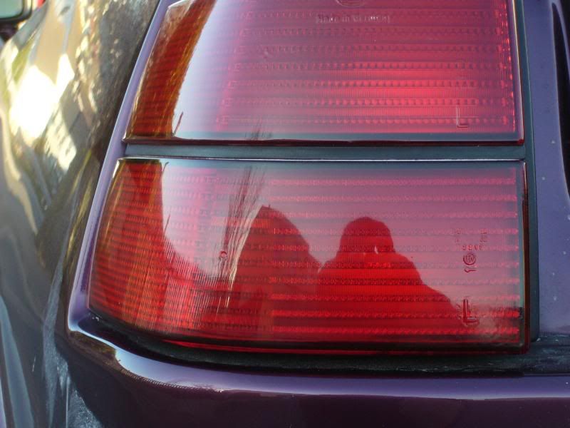

C488ADO 0 Posted March 5, 2010 in the quest for the old skool stereo i want to install i have landed a couple of these beauties!! had these the first time round and they were awesome back then! i know in car hifi has come along in leaps and bounds but im so far out of touch with all the new stuff im going to stick with what i know!! lol rockford fosgate punch 40 and a punch 60 the real deal american made ones not the cheapy shite far eastern crap they come out with now... id like to get my hands on some coils for the sub/s and some other nice trick bits.... always on the look out for phoenix gold stuff but it must be the white series.... sanded down the rear lights yesterday i wasnt happy with the finish i had , real hard to take decent pics with a crap camera but i took them anyway!! very pleased with results nice and shiney i wanted to try a new tool out on this and it was pretty good i rekkon with some different grades of paper i can get a nice finish!! pity i cant use anymore though!! lol only other update is i have started to replace all of the nuts etc under the bonnet starting with the slam panel , with stainless steel hexagon heads (allen key bolts) they look a little smarter than some of the tierd ol shit i have in there at the mo plus these wont tarnish!! il get pics later... Quote Share this post Link to post Share on other sites

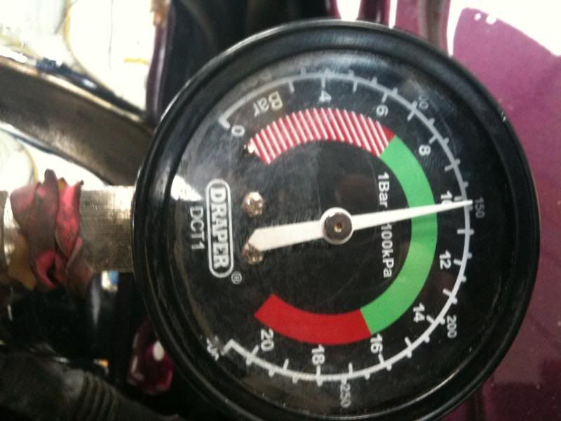

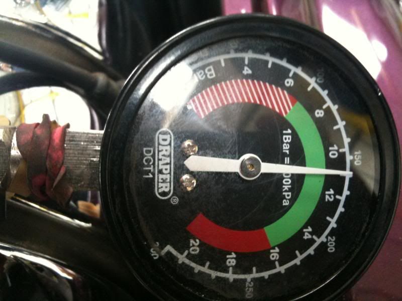

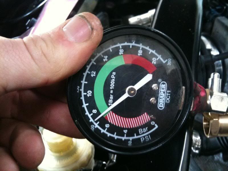

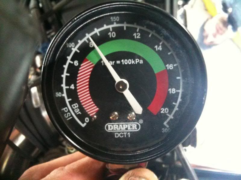

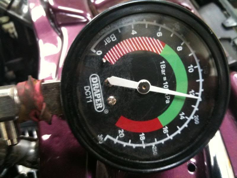

C488ADO 0 Posted March 6, 2010 got a few issues with the trusty old vr6 at the moment....now do i look at other options of engine...1.8t or r32? or should i fix up what i have??? seems i have a few faults all at once...i have a coolant leak which is almost impossible to detect but as of yesterday im pretty sure its the matrix :( im also smoking on overrun....down hill coasting but it seem to be getting worse?? maybe as i have changed the oil pump recently and given it a service???? better pressure etc etc ?? so ive had a compression test done and the results were a bit weird...i guess the only real way to be sure is to strip down what i have and check it out but in the back of my mind im thinking is it worth it? after all its just old shit really.... i can not afford to re-bore as the pistons are so expensive that would right it off for me ... piston 2 piston 4 piston 6 piston 1 (first attempt) piston 3 piston 5 piston 1 (second attempt) piston 1 (third attempt) i took all the plugs out to do this test i tried piston 1 3 times i thought maybe the fuel pumping into the chamber was probably helping the test by the 3rd attempt.... so head off while its off chains and tensioners etc its starting to look like big bucks with out looking at rings etc what do you do?? its on 113k at the moment just wondering if this lot is going to cost me say ???? £800 give or take £200 then shoiuld i be looking at alternative routes??? thing is it might not be so sinister until i get the head off i dont know whats going on.....but then there is the bill of the tensioners!!! arrrgggghhhhh i need this to get me round europe next month im thinking do the trip get it back then strip it down all of it and re build??? as i then will have a second car (i dont at present) i can then spend time and money on doing the right thing... shit i just need some advice and direction! cheers Quote Share this post Link to post Share on other sites
Chris Langdon 0 Posted March 6, 2010 Corrrrrrrr your not wrong Nath :( IMO Piston 1 is low, did you put a drop of oil down the bores? if the compression goes up then u are looking at piston rings, did you do the test hot or cold? I think they should all be around 11-13 bar on all cylinders for a VR6. does it use a lot of oil? litre/per 1000miles? the coolant leak,does it smell in the interior? have check the electric water pump? chris Quote Share this post Link to post Share on other sites

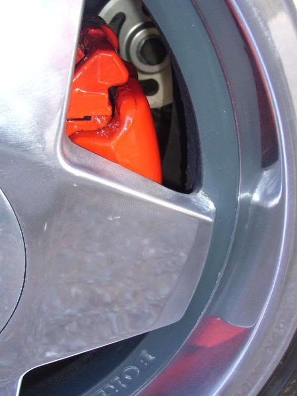

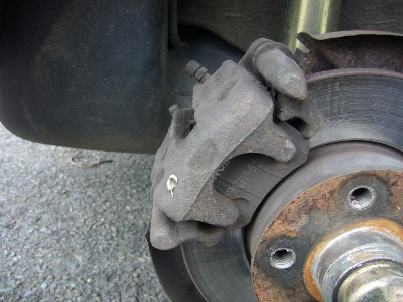

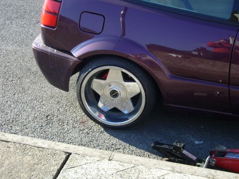

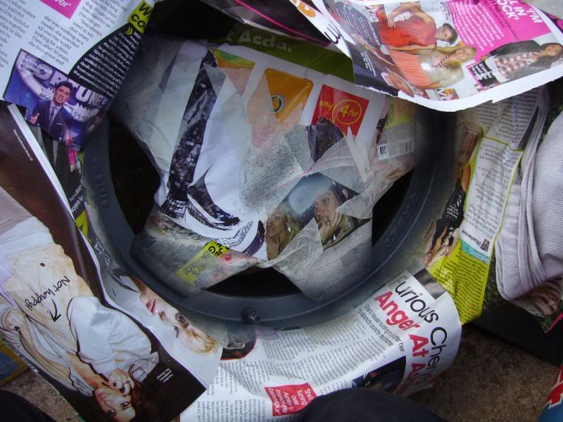

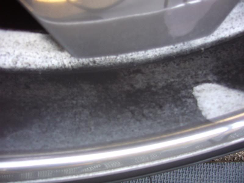

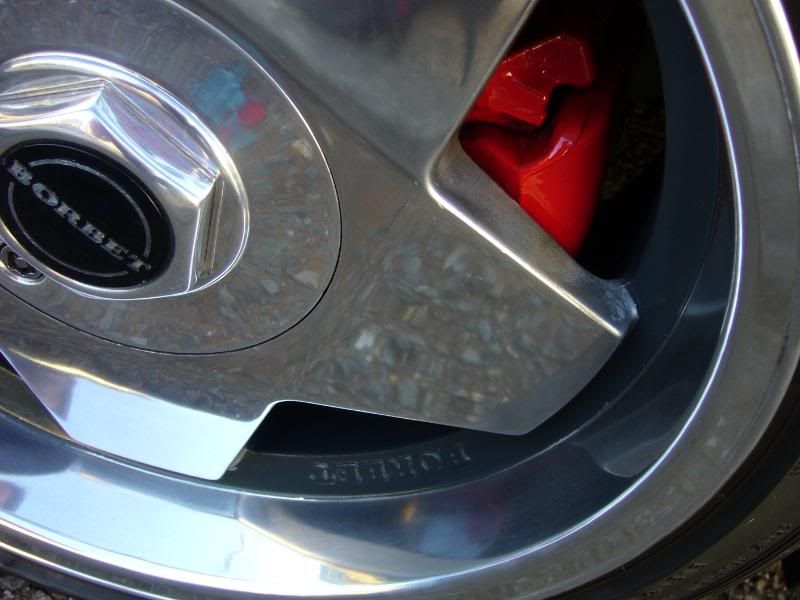

C488ADO 0 Posted March 7, 2010 well today i got on it and tried to polish my wheels! while i was at it i decided to paint the calipers....as they look a bit rubbish wheels were bad again must keep on top of them! been toying with the idea for a while about painting the band around my rims nimbus grey , i had the paint mixed up a while ago and as i do ,thought bugger it il try it and see what happens.... lol the wheels polished up alright! calipers look ok too.. now all i have to do is the other side!!! Quote Share this post Link to post Share on other sites

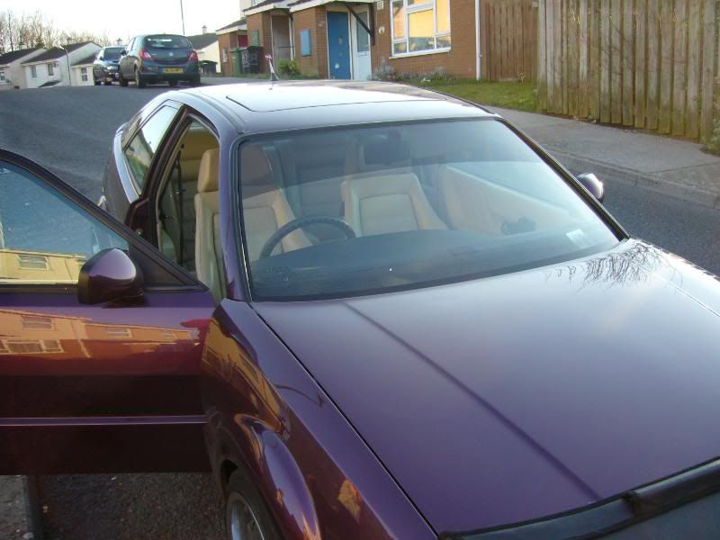

C488ADO 0 Posted March 7, 2010 also got rid of the front window tint! looks a lot better now... Quote Share this post Link to post Share on other sites
