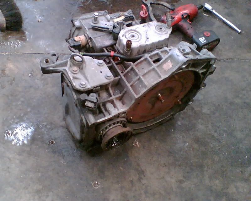

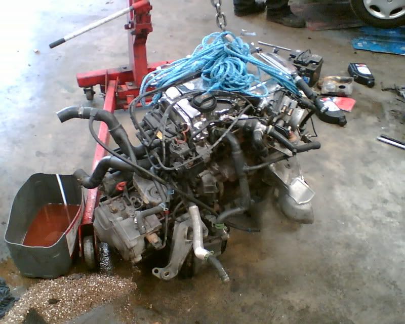

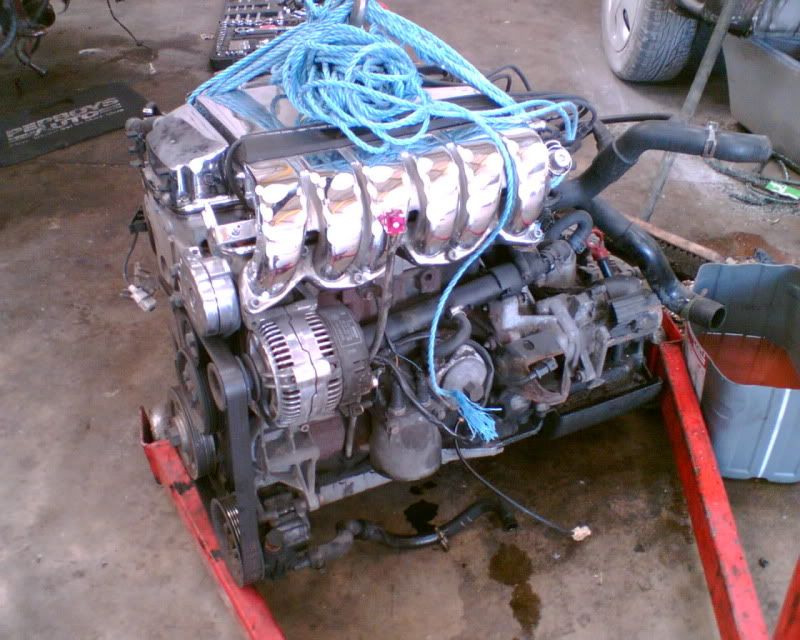

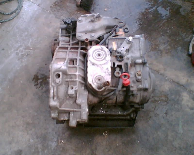

taken the rado off the road for the winter, been wanting to do the manual conversion for a while and just havent got round to it ...so last monday i took the engine out! never doen it before but als well so far.... probably made more work for me than nessacary but hey its all in the learning curve.....

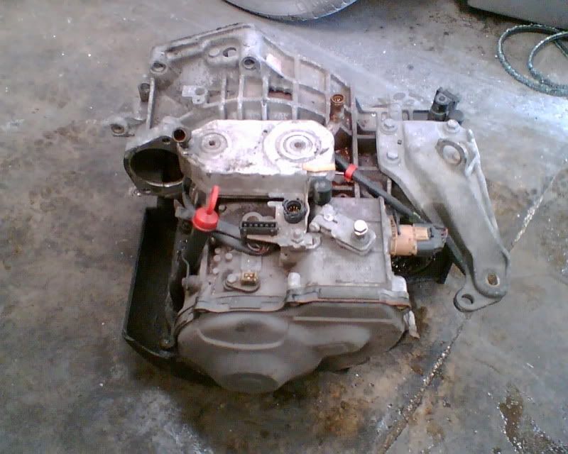

auto gearbox off!!

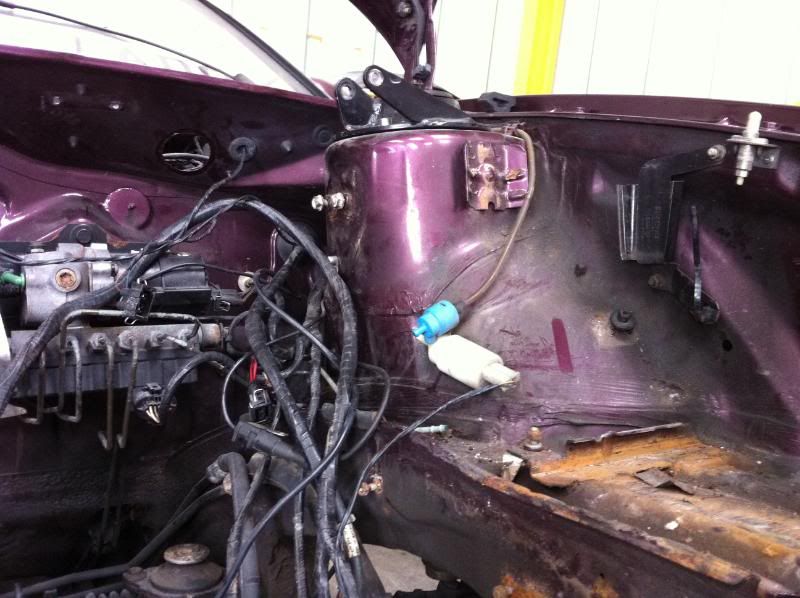

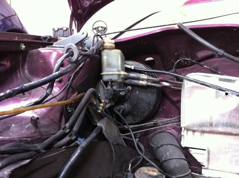

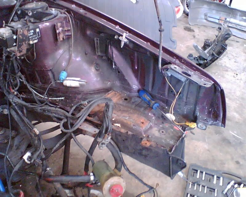

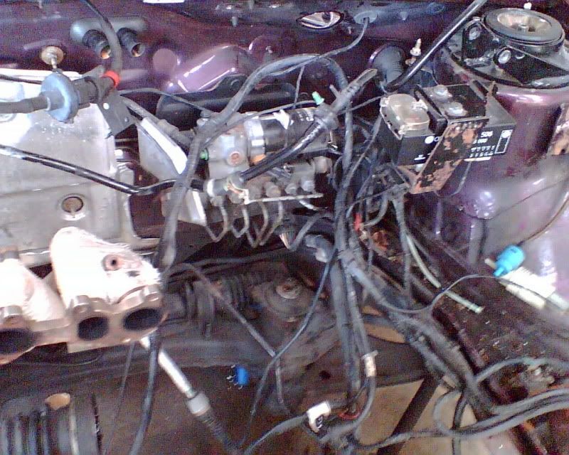

as if that wasnt enough i started to strip back the loom so i can start to try and tidy things up under the bay....
wish i never started the job believe me ...

kinda just making this shit up as i go ......worried yes want it done yes can i do it ....not sure lol
even if i have to extend the loom in places so it hides a lot of the wires i will!!! lol
def going to change the engine mounts though as they are wanked...
I'm not a pro mechanic by any means, always learning though, and i found the mechanics suprisingly simple for the conversion, so satisfying removing auto parts and fitting the manual equivalent.
I struggled a bit with the wiring, reverse lights etc.....but took my time and i got there in the end. Dont think you'll have a problem with this, seems like you have a lot of willing helpers too.......more heads are better than one.
lol wiring is ok for me how to do this though im not sure... i just want to be able to hide eveything in the legs etc maybe even relocate the batery, the powersteering resivoir, fuse box thingy etc ??

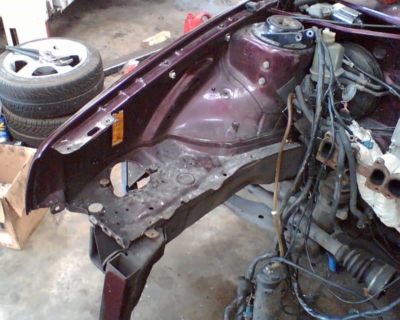

so about 3 weeks ago i took the engine out , havent touched it since due to family and work commitments....
today i had a brief few minuets to spare so i thought id better try and get some more done..

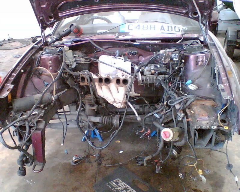

started like this again...i just hate looking at it

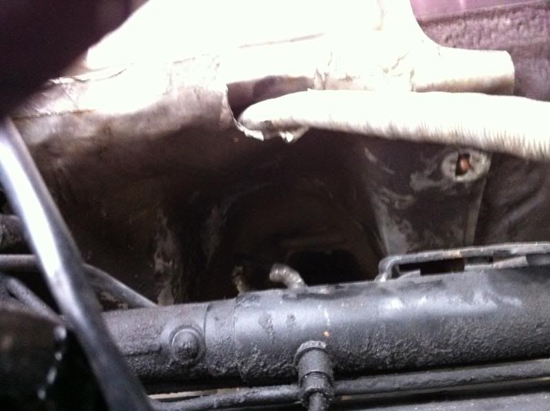

i think im going to have to remove this so i can tidy the wires properly....but it might also mean im going to have to remove the dashboard too for full benifit of this....???
il get round to cleaning this out and sorting the orange bits..

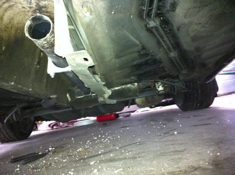

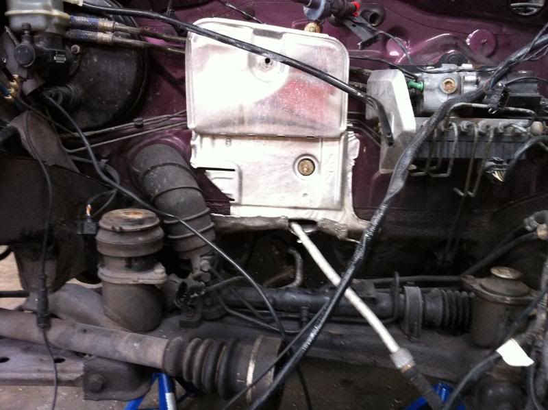

first job remove the exhaust manifold and then the heatshield in the tunnel

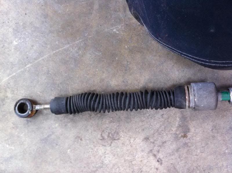

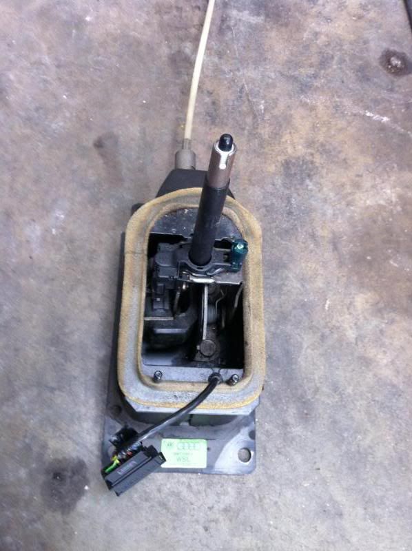

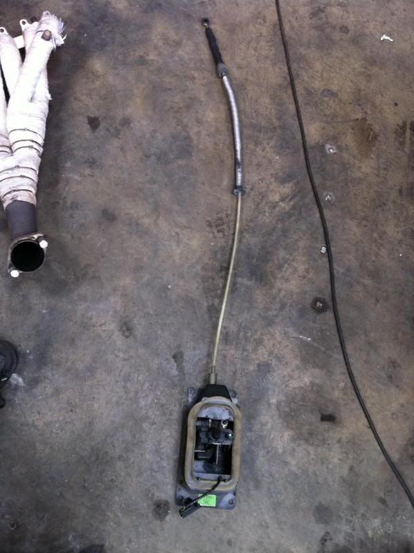

removed the heatshield and removed the auto shifterbox...
autobox shifter box removed!! hurray!

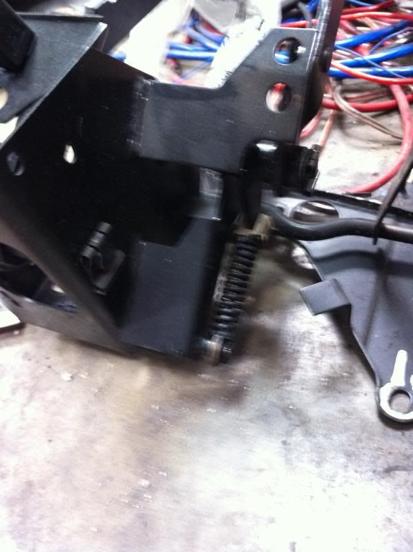

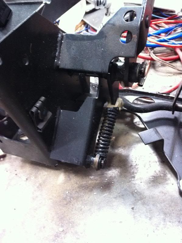

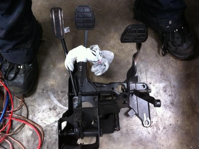

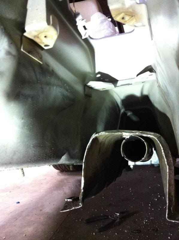

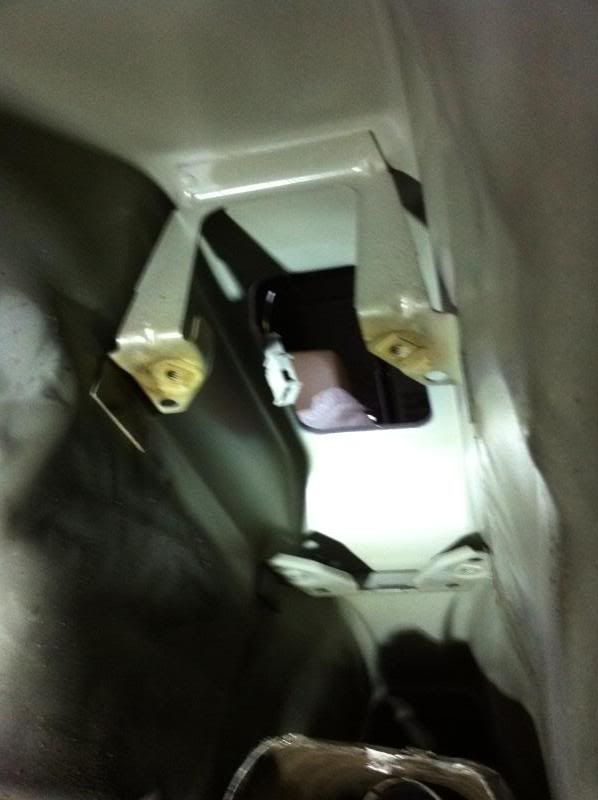

next up the manual pedal box

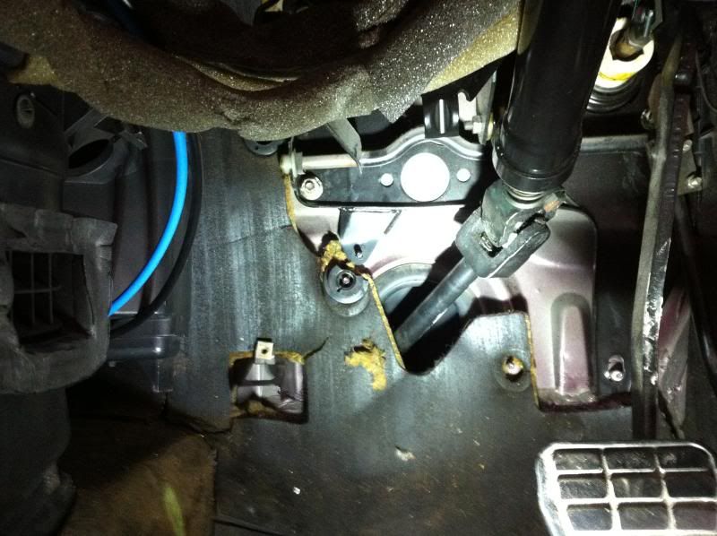

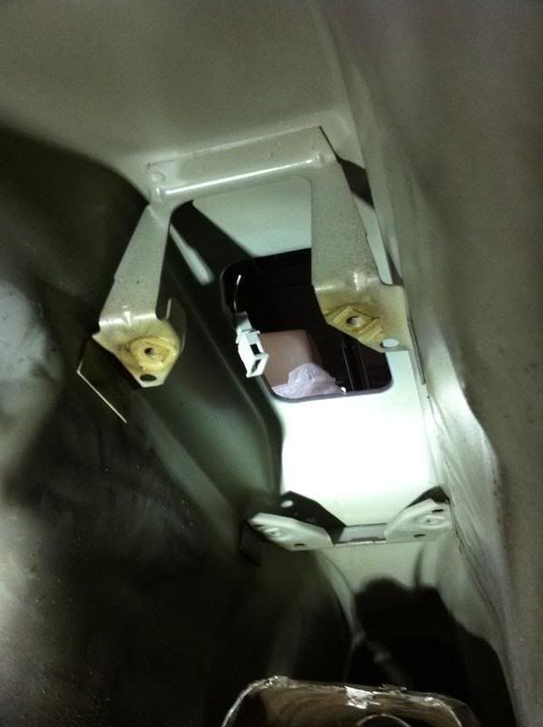

the box is almost identical.....but there is always a snag... this part is missing on the auto pedal box hence needing the manual one ....its not like i can even convert the old one....
the part pictured in the last two shots are completly missing from the manal box...
lucky that the old pedal box has got a template so i can cut out for the slave cylinder...

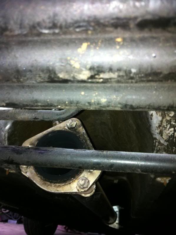

Nathan, a little off topic mate. I notice on your 6 branch that the bolts are facing away from the engine bay. Was it fitted to the car with the bolts that way round - where you able to tighten them up with them that way? On mine the bolts are put in from the engine bay side and are a bugger to tighten up.
good on you for doing it yourself. Have a look at my thread if its of any use from when Zak & I did my auto to manual conversion
Gaz hello!
Yes I've fitted re fitted and fitted some more in the end I just put them on the way it worked for me u got a good seal and that's all I was worried about! Lol was a real pain in the ass and I'm not looking forward to re fitting it at all.... Hate it when you get a tiny blow!!
The big main bolts face the rear of the car and they are a struggle as one of them almost fouls the exhaust itself!! As you probably know!

Know exactly what you mean about a good seal. Mine is blowing at the mo, Ive adjusted it twice already. Having to do it again as its blowing a little. Its really frustrating, ive never been able to get it to seal correctly. Going to buy a new donut seal (metal wire seal thingy :lol: ) and try the bolts the way round you've done, see if that works better.
Can you do me a favour and measure the inside and outside diameters of the metal donut seal that goes in the 6 branch? Just so i can buy the right size.
Cheers dude!
I never had the size bud , i just took the old one to the local factors and offerd them all up, funnily enough wasn't a vw item that replaced it , it was from a Citroën Picasso from memory!!
Shen it blew again I just blamed it on the French shit holding the exhaust together lol
