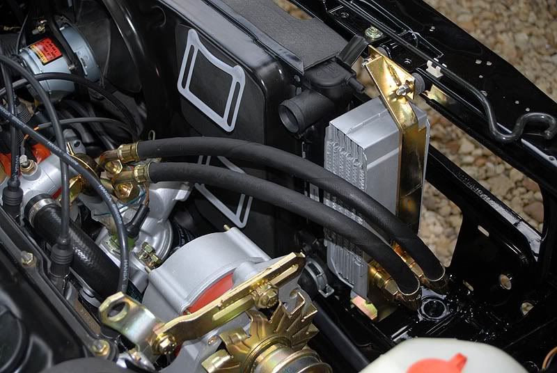

RW1 0 Posted December 2, 2010 Ah, so it's adjustable. I know this is not a Corrado but a Sciroco Mk2. It gives you an idea of a well prepared engine bay. Note the shade of zinc on it. They are original. Also, the coolant pipe clips on the cylinder head to radiator in grey are the shade I refer to in the previous post. Door pins will fascinate me cos how are you getting the white plastic anti-rattle linings on???? Wouldn't be easier to buy two new door pins? . Quote Share this post Link to post Share on other sites

OSV 0 Posted December 2, 2010 Ah, so it's adjustable. I know this is not a Corrado but a Sciroco Mk2. It gives you an idea of a well prepared engine bay. Note the shade of zinc on it. They are original. Also, the coolant pipe clips on the cylinder head to radiator in grey are the shade I refer to in the previous post. Door pins will fascinate me cos how are you getting the white plastic anti-rattle linings on???? Wouldn't be easier to buy two new door pins? . Thats the ticket, just as it should be, the MK1 Cabriolet resoration thread seen recently was lovely work and not custom in the usual sense but in reality it looked a little Walt Disney, just everything over restored created a strange fantasy look standard finish Quote Share this post Link to post Share on other sites
