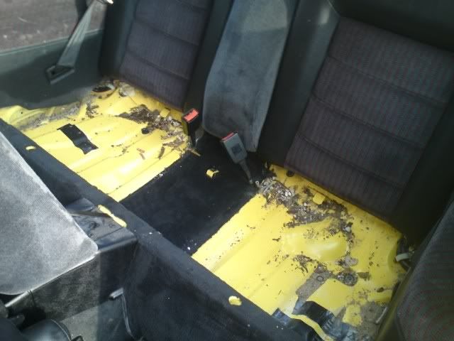

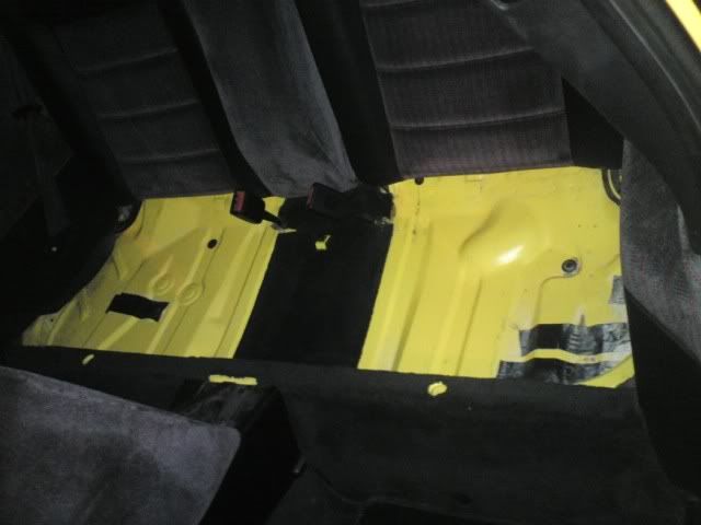

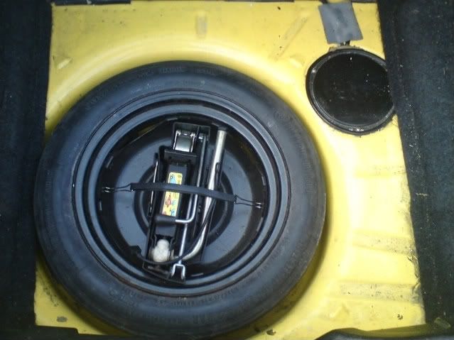

been doing some more cleaning this evening - beggining to get carried away but feel its worth it.

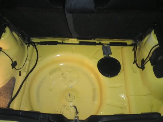

So, i tackled the rear of the interior and the boot area as the boot was full of a billion leafs and the remains of a last years christmas tree and all sorts.
after plenty of washing, drying and polishing the results
yes the boot floor really is that much brighter yellow after being polished.
and i bit if the overall interior.
Really happy with how its looking now, just got to put the knee bar and lower dash trim back on the drivers side after removing them to do the ignition switch - a job i will never learn to enjoy.
next task is moving onto cleaning the underside of the car - my goal is a yellow underside covered in clear waxoil to keep it sweeeeeet but that is likely to be a job for october time when the car comes off the road.

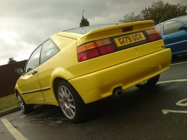

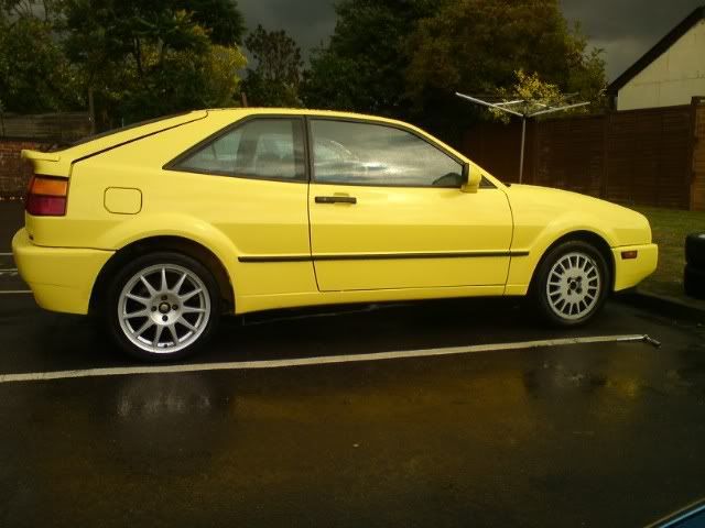

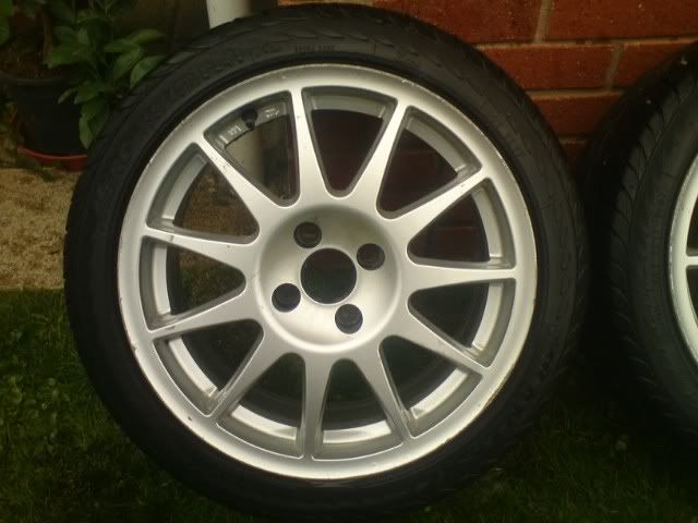

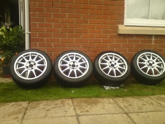

well the scrap yard turned up a little gem today... a set of of 16x7 speedline turinis in pretty dam good condition with 195/45 tyres.
Personally i think they are a good modernisation of the sebring style.
The problem now is they really do highlight the rather high suspension so something will have to be done about this, im also thinking about trying my BBS RZs on it to as my brother has just done this to his mk2!!
DAVE

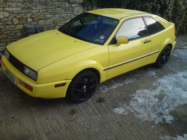

right, now i have a real problem. At the moment the car has the speedline alloys on, which i like but are not perfect -id like to refurb them. So today whilst massively hung over from having had far too much beers at a local beer fest i decided to start painting...
The set of Sebrings i had on the corrado originally are now BWM grey mettalic
and a set of BBS RZ 15x7 BMW fitment have also arrived (£23 bargain on ebay) should have them finished painted by thurs/fri but missing a centre gap:cry:

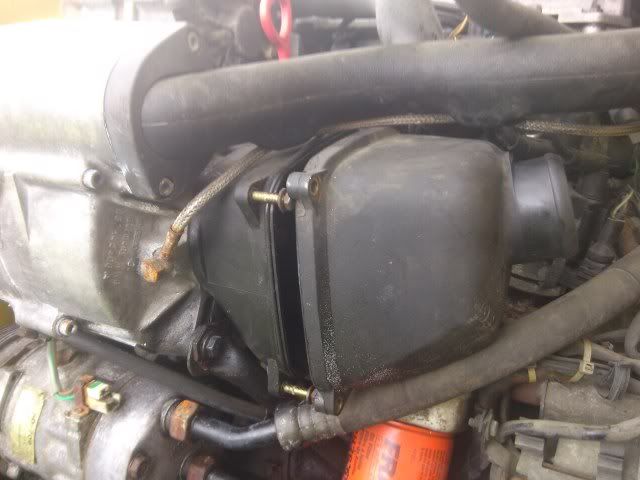

"cant wait to get rid of carbon canister and all the associated pipes etc that go with it. Should neaten the bay up a bit and allow me to run a cold air feed directly into the bottom of the box."
Is this cold air feed something you need to buy or Bodge ?
yo,
the cold air feed is just a rather large diametre section of flexible piping that will go from behind the bumper/inside the inner wing (havent decided yet) and the feed up into the large hole that the carbon canister lives in at the moment - imagine this hole empty

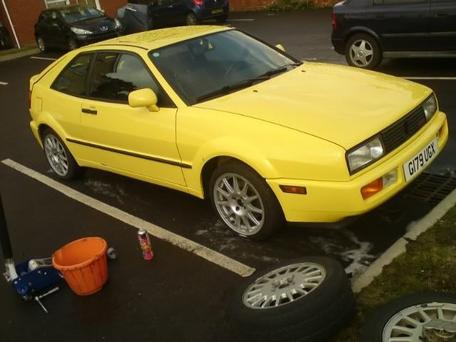

here it is with it current BBS RZ wheels, they are a shadow chrome so look dark with only have a slight sparkle to them. On Friday the car was treated to a full wash wax an polish as part of my efforts to ensure my paint survives the winter but by the time id taken these pics id covered 350miles. Hopefully tomorrow i can scan in the high res pics i took + the pre respray pictures with the white wing mirrors lol
The sun was just starting to set so there were some rather unusual lighting conditions..

Going back a few Posts, i have just taken the charcoal filter out of my G60 to do a Cold air Feed, :clap:

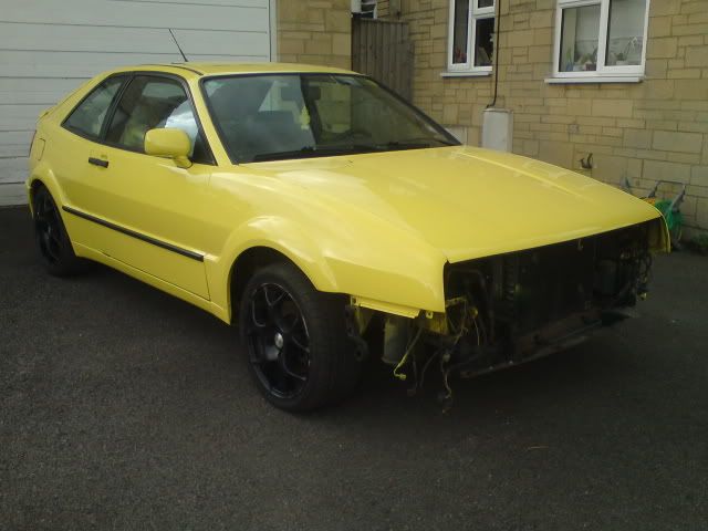

Hi, not had many updates recently mostly as the car has been off the road. I wasn't 100% happy with the original respray as it didnt include the front slam panel, behind the rear lights and inner doors so i have had those done now. Next plan is to begin giving the engine bay an overhaul especially since the front end is already off an i need to buy a new air conditioning condensor.

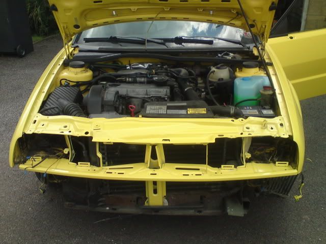

got a new slam panel which has been resprayed and looks a million times better than the original one which wasn't painted during the first respray.
new panel "resting" in place to check colour match
and then i fell into the trap of whilst im here lets do.......
1) re route the wiring harness through the chassis leg and prepare the inner wings for a repaint
now im going to go all out and have the inner wings repaint, the cross member + rad support, subframe, driveshafts powder coated and then start on the engine which will be repainted as per factory colour scheme.
hopefully the real progress will start being made one i get the Air Conditioning condensor removed which is being a PITA right now as one of the bolts is so mangled it needs to be chopped out but i only have a few Cms to work in
dave
Well it's been a while since i have done any updates mostly because there hasn't been much to report but now there is. After having the car resprayed i was never completely happy with the front end so it's all come apart.
now im going to go all out and have the inner wings repaint, the cross member + rad support, subframe, driveshafts powder coated and then start on the engine which will be repainted in silver except the block.
hopefully the real progress will start being made one i get the Air Conditioning condensor removed which is being a PITA right now as one of the bolts is so mangled it needs to be chopped out but i only have a few Cms to work in :(
dave

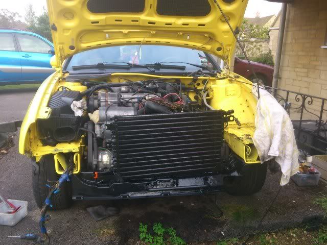

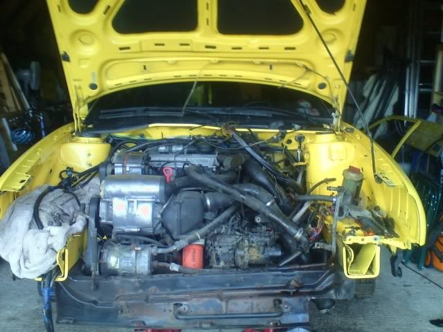

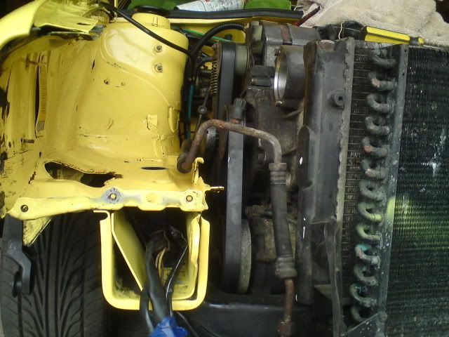

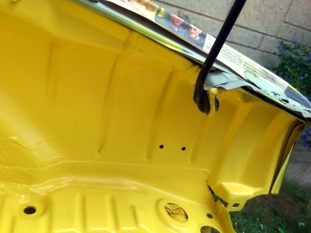

Did a bit more work over the weekend. It doesn't look like a massive amount has changed as i've spent a fair bit of time organising the parts i remove into BIN, REFURB and REPLACE and lets just say the shopping list is getting longer - mostly due to me bing a fussy bugger an wanting it spot on.

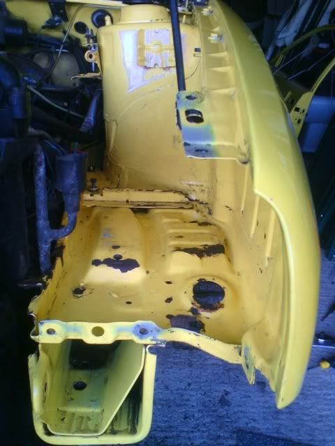

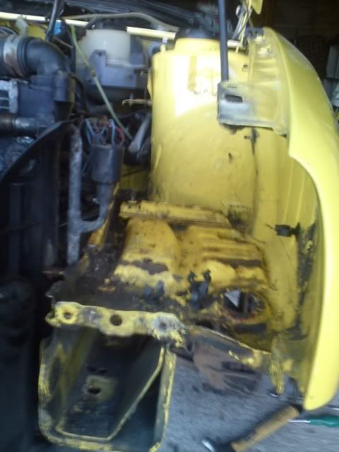

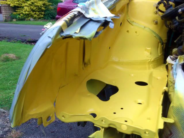

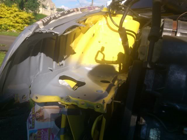

So, last update was preping passenger side chassis leg an reroute wiring, now it's time for the drivers.
before
after

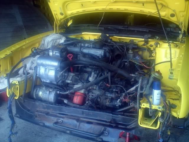

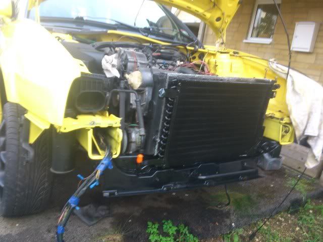

Finally managed to get the air conditioning condensor off and radiator in order to drop the cross member tomorrow as its being powder coated.
next job tomorrow is to strip all the wiring loom with the plan being,
1) route the headlight loom through the chassis leg and out the front like on other side.
2) route the live/earth cables for the battery halfway through chassis leg so they come out of chassis leg up behind the battery mostly out of view.
3) route the radiator/fan/Air Con looms through chassis out the side near where a PAS bottle would be on a MK2
4) extend starter/alternator wiring so it can be run closer to the block out of view
Then when i've had enough of wiring, I want to test fit a 1.5L washer fluid bottle from a Seat and start thinking about a bracket to relocate the air condition control box.
Once the wiring is hidden im going to begin prepping the chassis legs for painting work and remove the inlet manifold/rocker cover an everything metal to be polished.
Dave

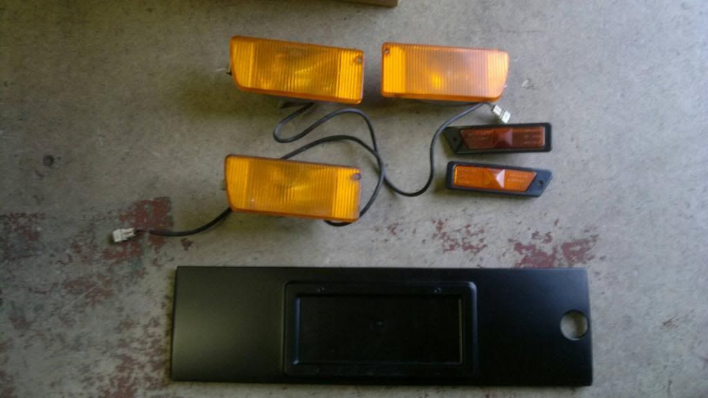

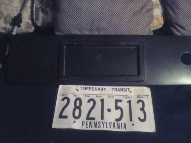

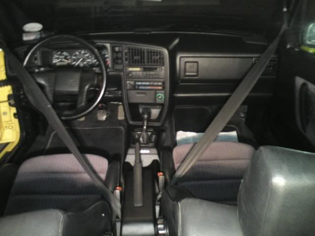

Well Edition38 proved to be a very worthwhile trip as i finally have myself a genuine USA specification rear number plate holder - after over a year of trying.
Here it is with my cars original dealer transit plate from when my uncle bought the car new.
All i need now is a custom made USA Pennsylvania style plate but with my UK number plate on it which I can use at show/events

I just love those seat belts sorry lol
There are a LOT of parts linked to the electric seat belts so buying it new bit by bit would be a nightmare. To be honest you could be better off asking on VWVortex if someone in the US wants to trade as there seem to be a lot of yanks who want Euro spec

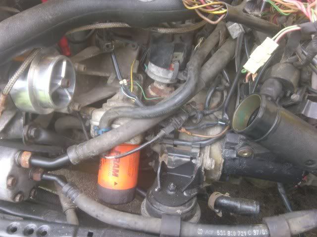

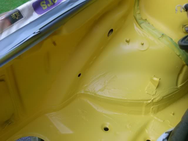

The corrado was put on hold for aaaages whilst I waited for a brand new air conditioning condenser and pipework to be made - it all had to come from the USA. So I mocked up the front end with the radiator as well to ensure it all fits.

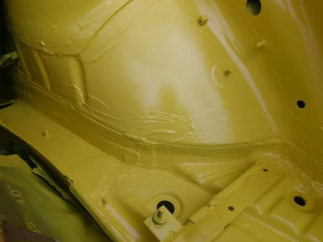

I was going to leave it like this and continue putting the front end on. However there is surface rust on the battery tray and a few scabs on the other side as well so for now I am doing some touch ups so that the car should be finished for the mk2 national meet....
Yesterday I sanded/prepped/primered the chassis leg areas that had some surface rust , then it began raining :-(

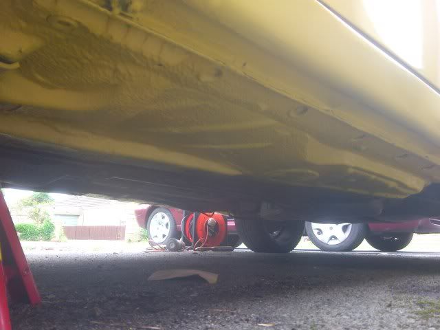

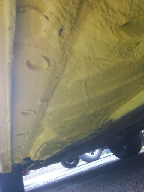

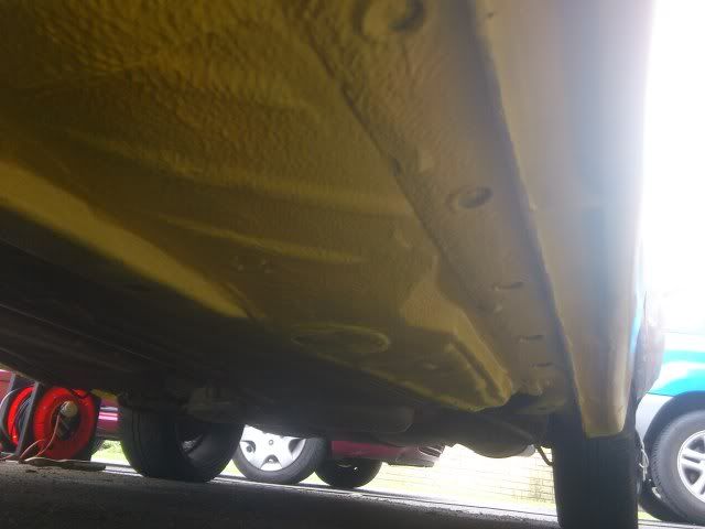

So I worked on the underside, no before pics but everyone knows the underside of a 20year old car is black and dirty.... well after many hours with the wire brush, more hours applying sealer and more prep i was able to get the first of several coats of paint on today!!! The plan is, another couple of coats of yellow followed by clear wax oil.

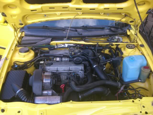

I also did a few more jobs on the bay,
DItched this horrible plastic box
Replaced with custom alloy outlet
Now i just need a silicone hose to link the charger and intercooler
once that is in place, the chassis legs painted it is time for the freshly painted front end :D
The final jobs now are:
1) continue finishing the underside, remove exhaust and paint centre of the car.
2) repaint the back axle - il cheat and paint it on the car this time.
3) replace front suspension struts/springs inc lower arms, anti roll bar bushes, steering rack bushes, track rod ends etc
4) refit drivers side doorcard after fixing the electric window
5) MOT & TAX
Dave

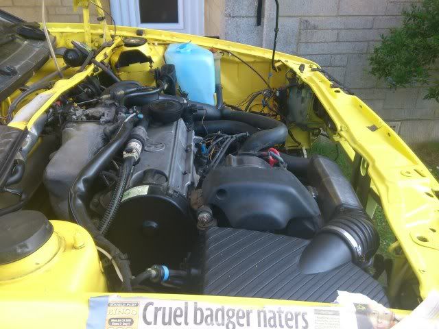

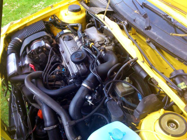

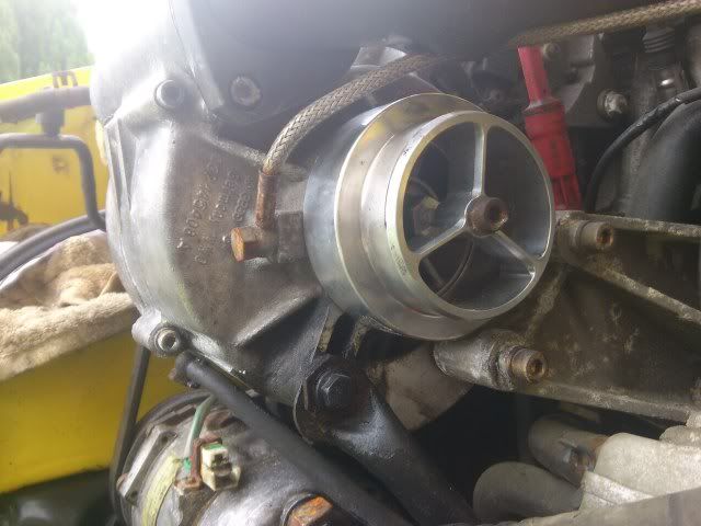

Here is the engine bay after a lot of cleaning. The rocker cover and other components have now been polished.
I still need to sort a piece of pipe to link the charger outlet to the intercooler but im hoping Forge can help me out there. In the meantime I will keep it stock in order to run the engine for the MOT.

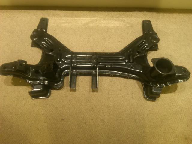

After the huge disappointment of not having the car ready last year and the last minute crap with having the wrong headlights and not being able to MOT the car i have now sourced a perfect set of headlights and all the other lights so that i have a full set of unchipped/cracked lights for the front end.

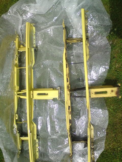

Got rather lucky on Ebay an found a unused Corrado G60 subframe for less than what i was going to pay to have mine powder coated. It will also have all new bushes and new engine mounts prior to fitting and will be joined by the new suspension components already purchased.
Hopefully if everything works out i should have a rather nice looking stainless steel exhaust and decat and a rear axle (which will be rebuilt) this weekend.

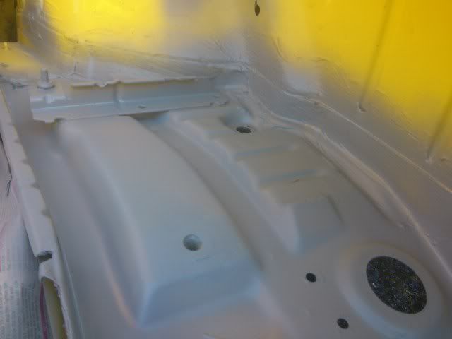

Then a rather large box from a well known VW parts specialist with new discs & pads plus flexis all round.

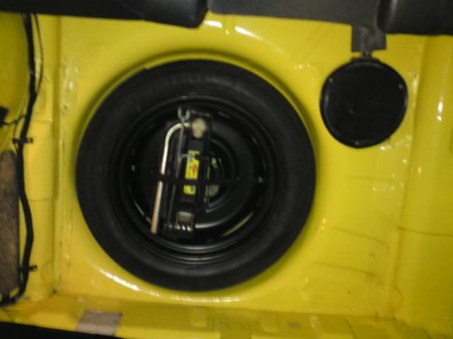

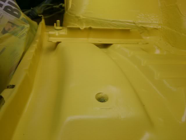

Last on the list is to repaint the boot floor/spare wheel well, remove and paint all the heat shields for the exhaust and repaint the fuel pump housing and do a fuel filter and the underside ought to be as good as new.
Fingers crossed it should be ready soon.... so long as i dont get shafted like last week when i booked a couple of days off and it snowed :-(
