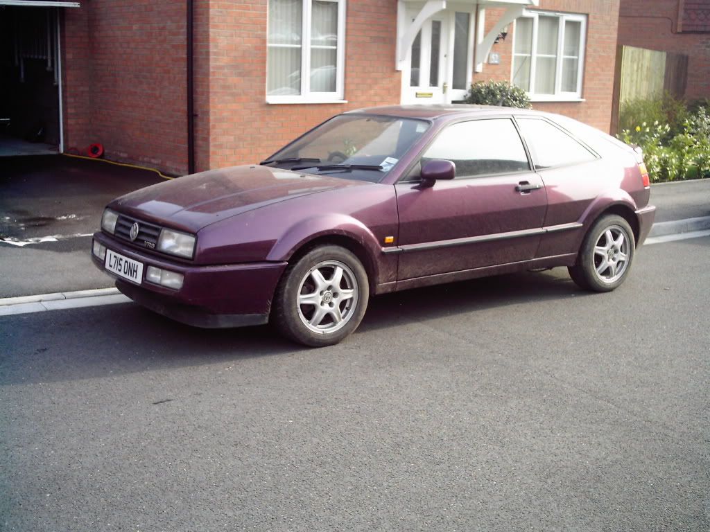

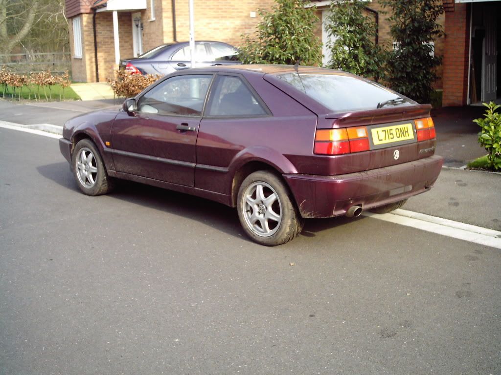

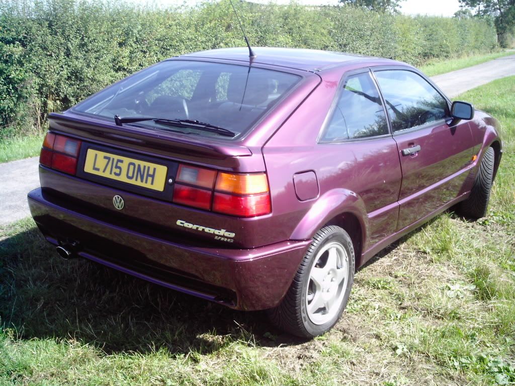

little andrew 0 Posted August 19, 2010 (edited) Hello all, my name is Andrew and this is my Corrado. Bought it back in April this year, done a few bits to it in that time so feel I now qualify to put a post in here. Bought it from a previous corrado forum member, few pics below how it looked when I got it home - Bought as a project, little rough round the edges but mechanically sound. known faults were abs light permanently on, sunroof tilts but doesn't slide, central locking not working, heater not working on position 1 and the bodywork wasn't great. few scratches here and there and finished in various shades of blackberry in varying quality. Also had the remains of a gearbox lock fitted i.e. just the metal bracket that attached to the transmission tunnel. My plans for the car are just to restore it and keep it original. All excited first thing I did was give it a good wash and hover. Then I found my first problem, carpet in front and back on drivers side was very very wet (little puddle in back). Not a problem I thought I’ve had old Volkswagens before that have leaked after heavy rain, must be the membrane/plastic on the back of the door card not stuck to the door properly. After further investigations found it to be three things, plastic on back of door card not stuck properly, weather/rubber seal that sits on top of door against glass (huge gap between the two) and lastly the door itself had a crack were the frame from the window meets the door bottom = door knackered. Wasn't too bothered as door was very rusty along the bottom and was going to give the car a full re-spray at some point anyway. Later sourced myself a blue door off of e-bay. In the mean time decided to take interior out to give it all a good shampoo, the smell that greeted me when I took the carpets and sound proofing out was NOT pleasant!! Must have been leaking years as it smelt real bad, the foam bit under the rubber sound proofing had started to decompose. The rubber was alright so used a scrapper to scrap the foam off (have put carpet under lay under rubber now) Next I booked the car in for full re-spray ahead of schedule, as the car wasn't waterproof I couldn't use it or put the interior back in till it was water tight. In the mean time started sourcing few bits that needing replacing or were just missing. Mended the heater not working on position 1 and petrol leak when cold (replaced an old clip with new jubilee clip - silly but simple) thanks to posts in this forum. Removed remainder of gearbox lock. Sourced some original speedlines locally, few scratches on them but there like new. Given it a full service and after reading posts in here elected for a k&n panel filter. Bought new bumper grill as mine was badly damaged £48.18 + vat from vw and not many left. Picked car up couple of weeks ago after re-spray - looks pretty amazing to be fair especially after its techno colour blackberry paint job. And most importantly its now water tight! Gave the car inside a good wash before I put the freshly shampooed carpets back in, put some carpet underlay down under my sound proofing first. Also managed to source a black leather interior for it, gave it a good clean and leather care at the weekend and put that in (after I replaced the started motor). unfortunately it came with early door cards, put the rears cards in but stuck with my cloth front door cards for the time being. Also fitted new badges all round from arz tuning in Germany not cheap but worth it. That’s it so far, very pleased with it and myself at the minute, took some pics of it this morning Edited March 19, 2011 by little andrew Quote Share this post Link to post Share on other sites
big ben 10 Posted August 19, 2010 new paint 8) good work!! Quote Share this post Link to post Share on other sites
tandino 0 Posted August 19, 2010 Looks great Andrew, my favourite corrado colour too 8) Cheers Pete. Quote Share this post Link to post Share on other sites
Purgatori 1 Posted August 19, 2010 Very nice car mate, Blackberry is the best colour :wink: The new paint looks awesome. Hope mine will look that spingly when it's done. Quote Share this post Link to post Share on other sites
