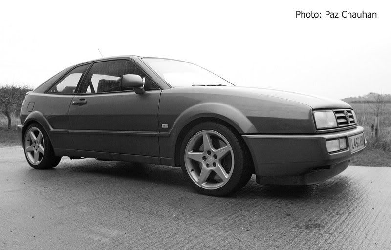

4eyes2wheels 0 Posted September 27, 2010 kevhaywire said: 7.5 x 16 Speedlines My favourite - 16 inch Speedlines :luvlove: Quote Share this post Link to post Share on other sites

Jim Bowen 1 Posted September 27, 2010 looks really good in this pic i think. Wheels really suit it 8) am i correct in saying you use this as a daily drive too? Quote Share this post Link to post Share on other sites
-=Kris=- 0 Posted September 27, 2010 3corsameal said: looks really good in this pic i think. Wheels really suit it 8) am i correct in saying you use this as a daily drive too? Those are the speedlines i want! Quote Share this post Link to post Share on other sites
CazzaVR 0 Posted September 27, 2010 Agreed! Love the Vento Cups- think they're just about my fav wheels on the Corrado. It's finding some that's the prob :( The MOs are very, very nice too though. As Jim said- love the techie stuff too (just no budget to do it myself), so keep it coming! 8) Quote Share this post Link to post Share on other sites

Kevin Bacon 5 Posted September 28, 2010 I would have kept the 16" speedlines if I was able to fit decent size brakes behind them! Gearbox and driveshafts are the originals, which are almost 200K old now. The box had it's bearings and syncro rings replaced 5 or 6 years ago when the Quaife was fitted, but that's it. No strengthened gear sets or anything :D. All 4 CVs were replaced with GKN jobbies from GSF round about the same time too. As yet, none of it is showing any sign of being troubled by turbo torque. I'm either just lucky or the VAG kit is just bloody strong :D There is also the small matter of turbo sizing, not getting greedy with the power and showing some mechanical sympathy :wink: With the short runner, that was standard 10:1 Compression, standard cams and standard OBD2 management. It was converted to OBD2 during the Supercharger stages and after taking the charger off, I just left the Schimmel intake in place and moved the MAF over. It was like that for a month or so whilst I ordered the turbo stuff over from the Schimmeliser. It drove great. No loss of torque at all and pulled hard at the top end. Obviously the standard induction note was lost, but instead it had a more intense, guttural roar. I really liked it. I wish I put some cams on it and remapped it, it would have been quite special I reckon! Quote Share this post Link to post Share on other sites
