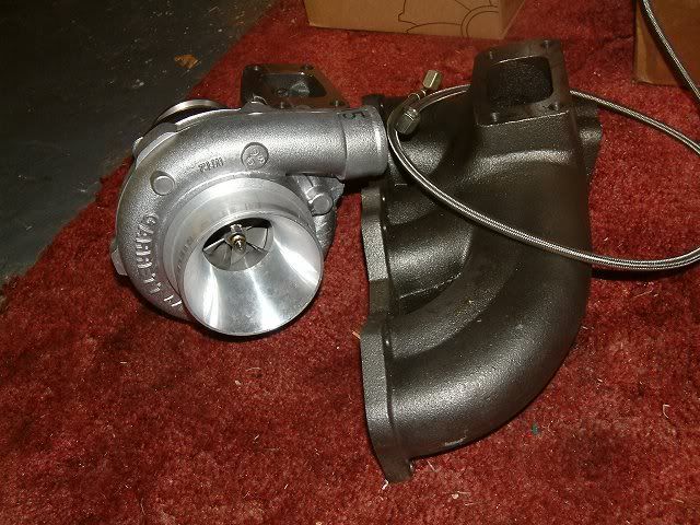

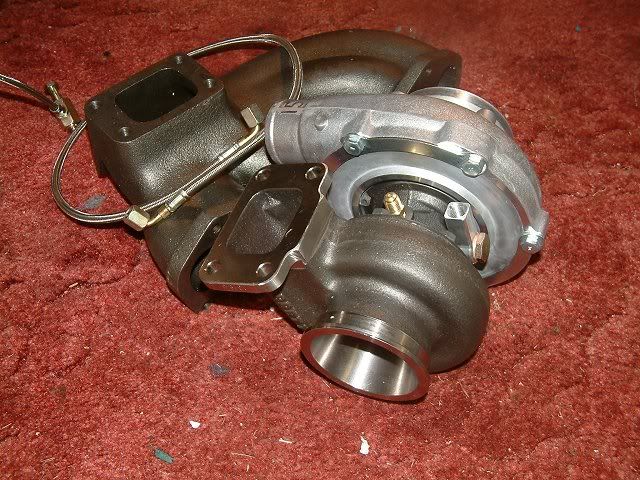

And these babies, ibiVR manifold and Garrett GT30R turbo:-
Could have gone for a GT35R, but the 30R is good enough for the kind of power delivery I want.

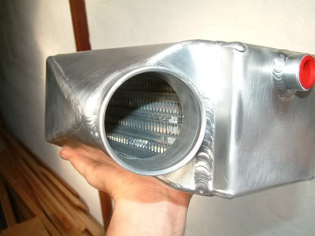

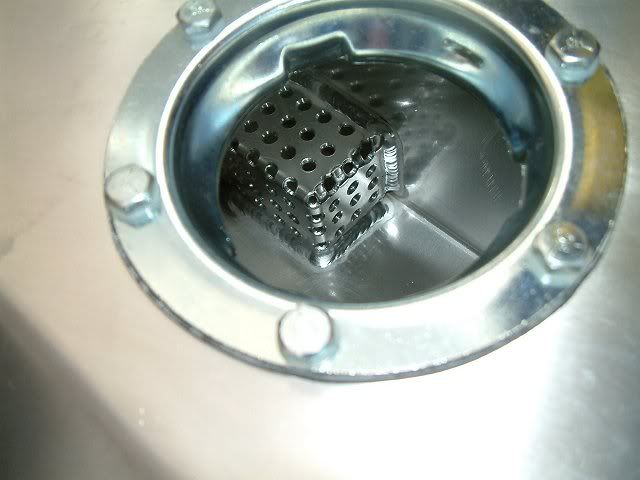

Here's the inside of the chargecooler, check the welding quality...and it weighs almost nothing! 0.25psi boost loss, and that is a major anti-lag factor, and superb cooling performance.
The key to the Schimmel's chargecooler performance is the size of the tank (3 gallons), huge water pump and the big old prerad. The system supports up to 700hp. The tank even has a cage around the pump output to stop the ice cubes being sucked in!! Yes, ice cubes! Popular addition to chargecoolers in the states to get the best from the 1/4 runs!

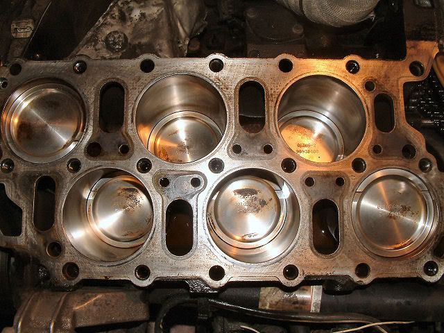

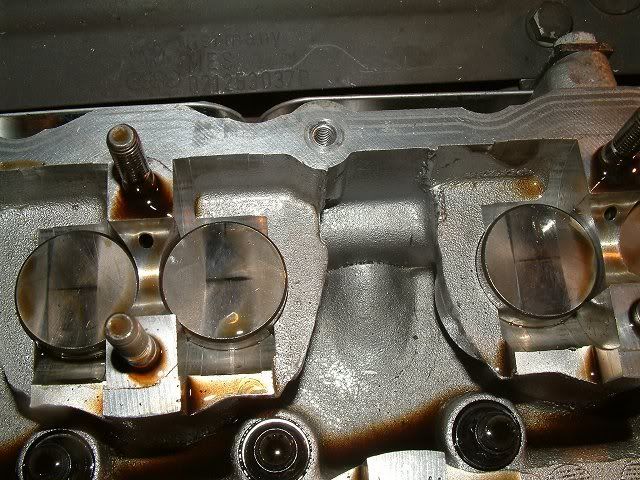

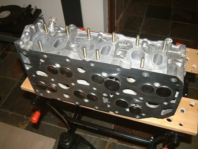

Unfortunately, during these steps I noticed my block and head are pretty shabby. But every cloud has a silver lining, so I now have a 2967cc engine (83.5mm JE forged pistons) under way. The current lump will be used for setup and testing.
Looking tired, but to be fair I've seen a lot worse!!!
Head is not bad, but it's showing bad guide wear already after a rebuild 50K ago!! Oh well, I guess that's on the list then too.

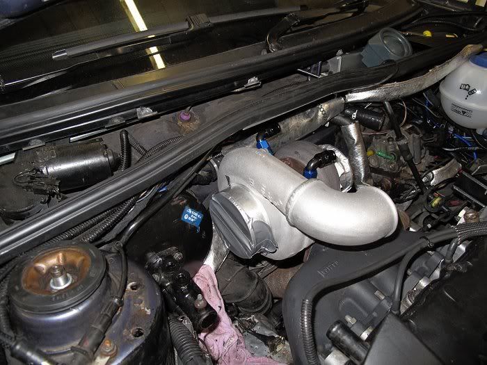

And she's in. It's a heavy assembly, so take care when offering it up to the studs as you can easily bend them, which will make fitment a pain in the butt. It's pretty tight down there, but just enough room ;-)

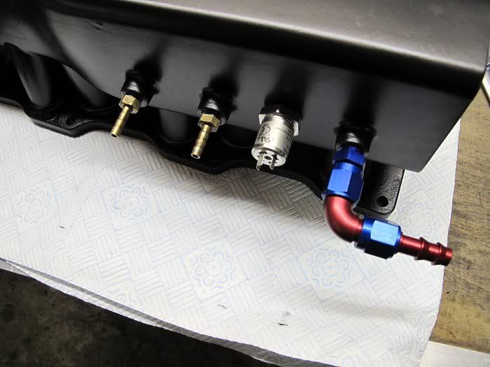

Before you put the inlet manifold on, don't forget to plumb in the oil feed adapter. I got this tiny one from Schimmel, most are a lot bigger, but you get the idea. Screw it into the filter housing in place of the temp sender, then screw both the temp sender and feed line into the adapter and then fasten the other end to the turbo.

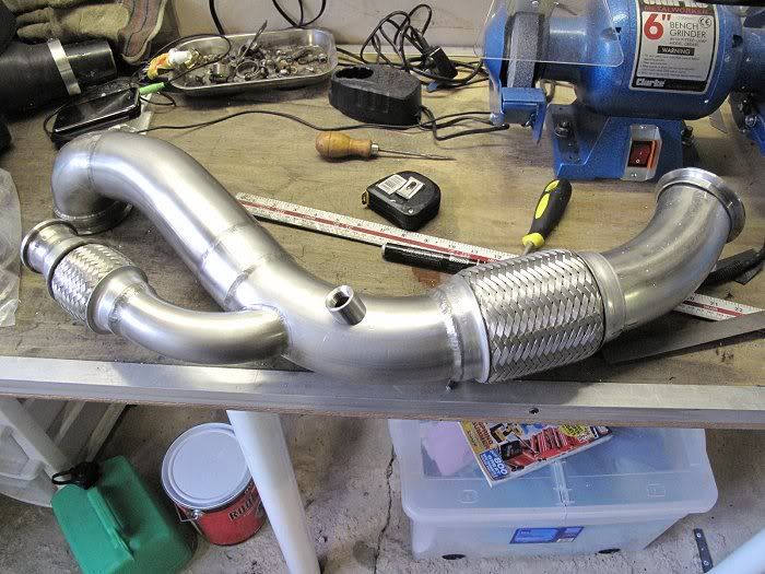

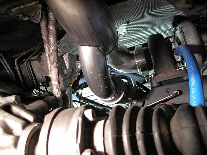

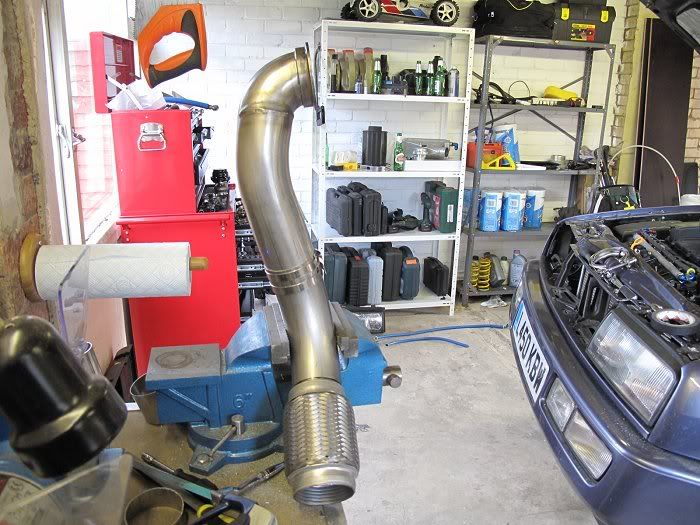

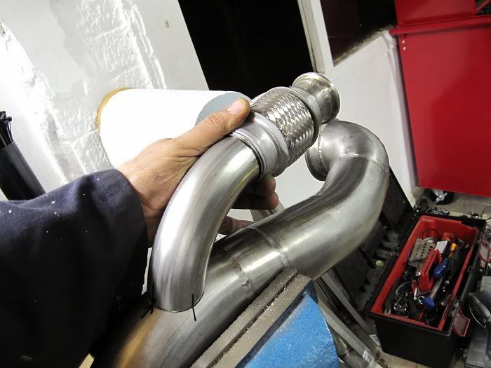

Here is the front pipe shape. Taped up in this pic, but is now welded up. Just the 3" flex to weld on and it's pretty much done.
It's made from 2 x 1D tight 90s and a 30 degree elbow, all from Jetex.
Loads of clearance
A shot of the angles required off the turbo

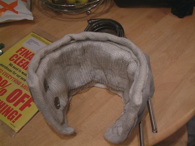

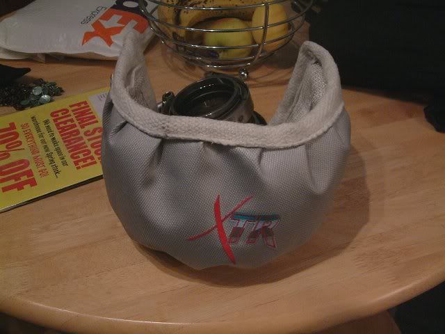

This is the most expensive nappy in history. One GT30R blanket. Helps reduce under bonnet temps considerably. It's basically the same stuff used to lag nucleur reactors!!!

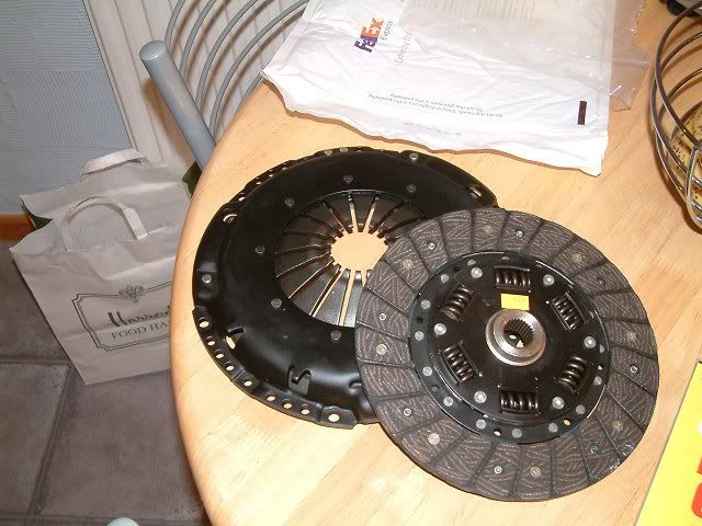

Schimmel stage 1 organic clutch. Good for 350whp. Always good to under clutch to hp to allow a little slip rather than shredding 3rd gear!

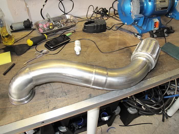

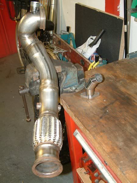

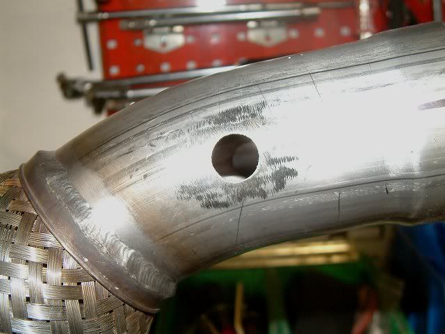

The down pipe is almost done. Just the lambda bosses and wastegate pipes to do and that's pretty much it.

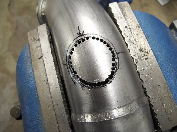

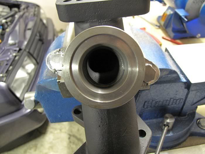

With the Lambdas (one for ECU, one for Wideband A/F) I've moved them 20" away from the turbo to prevent them from overheating. 12" is the minimum really, but you can get lambda heatsinks if you can't move them away far enough. I've basically done one on each side of the pipe.
To help my welder and keep the boss in the right place, I shaped the bosses to the pipe shape.
More of the downpipe....

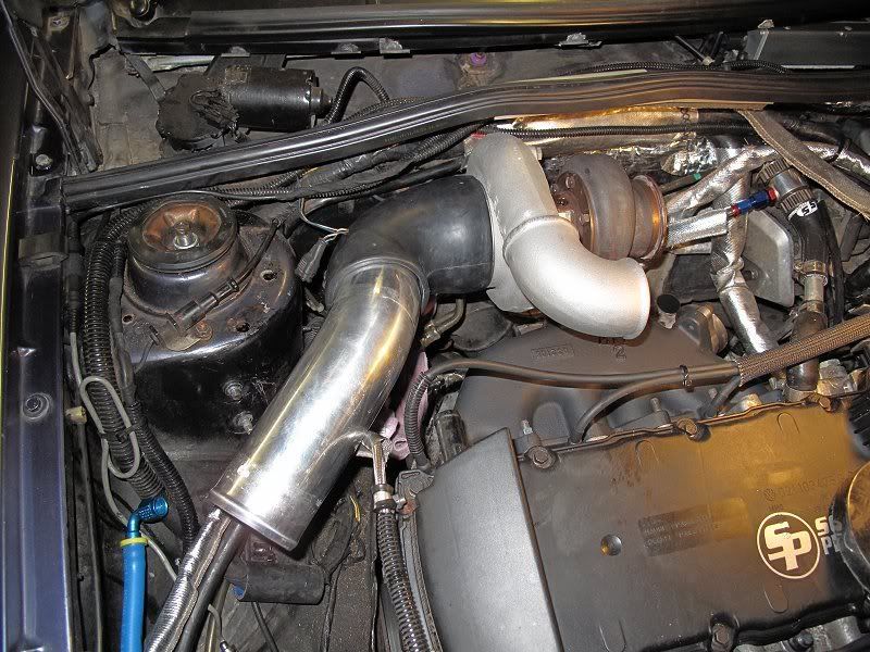

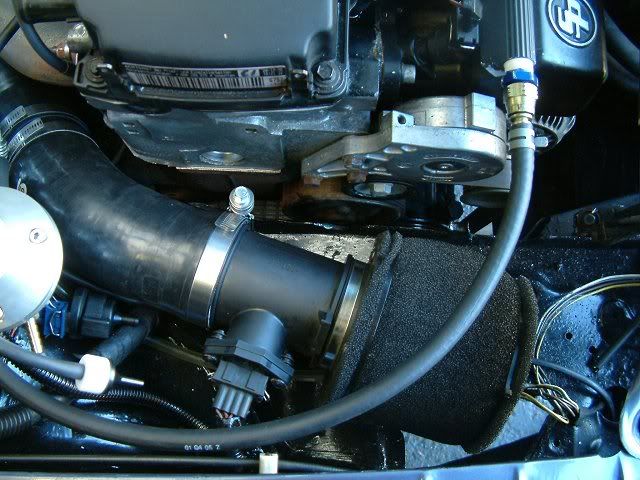

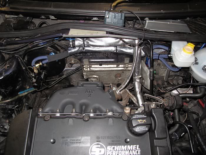

I've also sorted the intake. I used a 45 degree 4" elbow and then a 4" to 3" reducer to mate up the stock MAF etc. I will only be running 8psi initially during testing, so the standard MAF should cope.
As you can see, the intake hose is damn close to the manifold....
So I made this....
To wrap around it....
It's easily removable thanks to the snap fasteners. You can get those from sewing shops for £4 including the fitting tool.

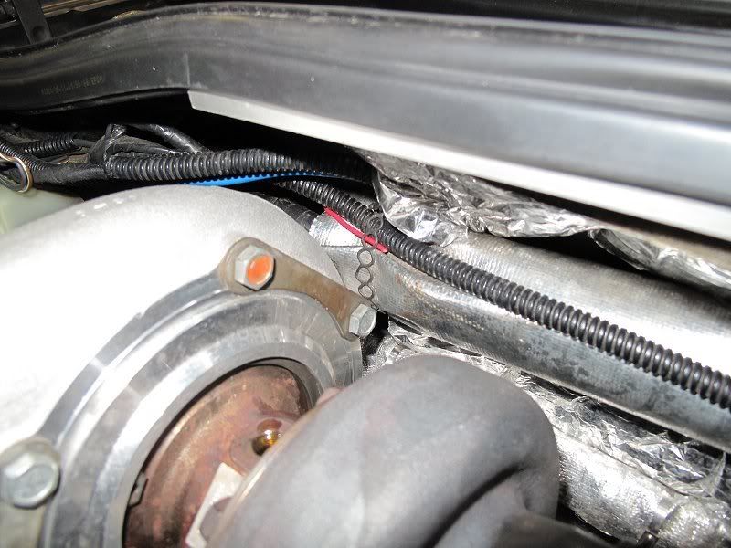

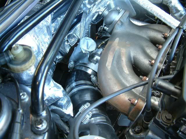

You can't help but notice I've probably gone a bit OTT with the heat sheilding, but I'm not taking any chances!!
Intake clearance is pretty good overall. I don't like abrasion related issues!!
Good clearance here too, at least an inch.

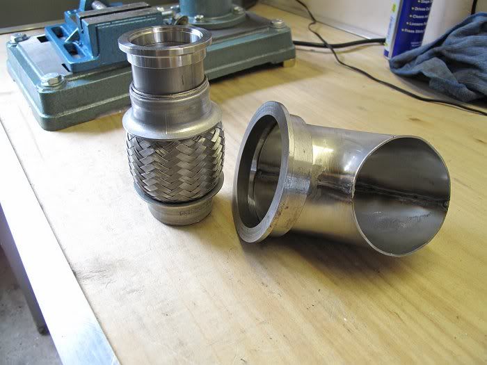

The wastegate dump is figured out. I know what you're thinking and I agree, it's less than ideal, but it's the best I could do for the time being. That's now gone off to the welder and that's it for the exhaust. I'll lag it up this week and mate it up to the exhaust.

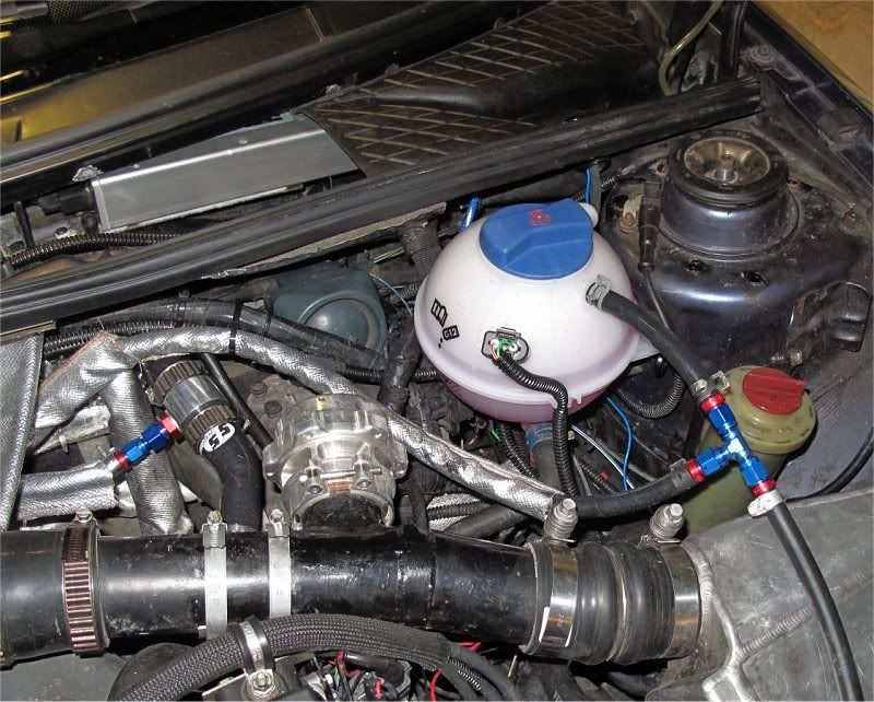

The intercooler is in. It just hangs there to allow movement as the engine rocks. I've popped a bit of spare samco under it just in case. Plenty of fore and aft rocking space. Boost loss through that intercooler is 0.25 psi and with such a short path and the SRI aswell, it's going to have a pretty good throttle response.

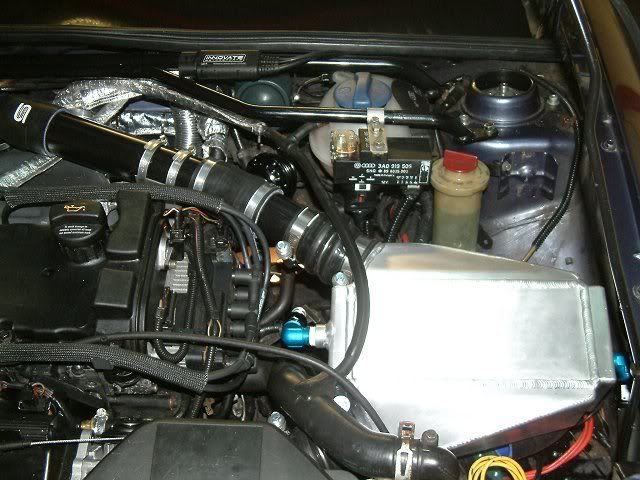

I've relocated the fan controller and PAS bottle. The screen wash tank is going in the boot with the intercooler tank and battery. When it's running how I want, I will get the boost pipes made up in one peice to reduce the amount of connections, but it's solid enough now.
Next to the fan controller is a twin piston BOV, but I'm changing that for a recirc as I don't want jerky gearchanges. When I eventually go to a MAP sensor, I can then reinstate the BOV.

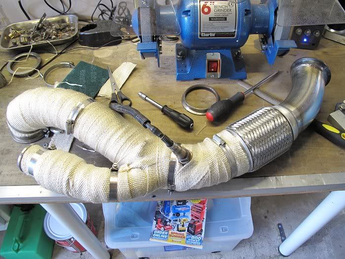

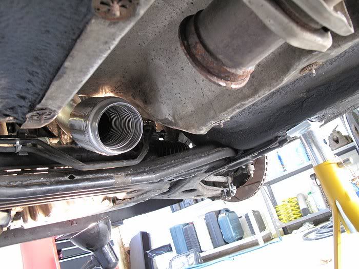

The exhaust got finished off OK in the end, so that's all lagged and fitted. The turbo nappy is on too and both lambdas in and hooked up.
Here's the view from under the car. It's in sections deliberately to allow the addition of a 3" cat a later date, which is the V banded one. The other one is the 3" - 2.5" - 2.25" reducer to mate up to the SuperSprint. That will all be replaced with 2.5" soon.

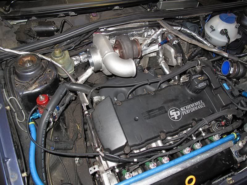

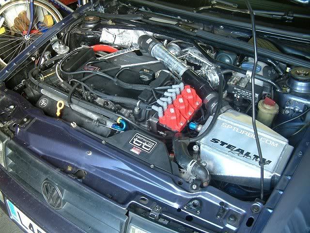

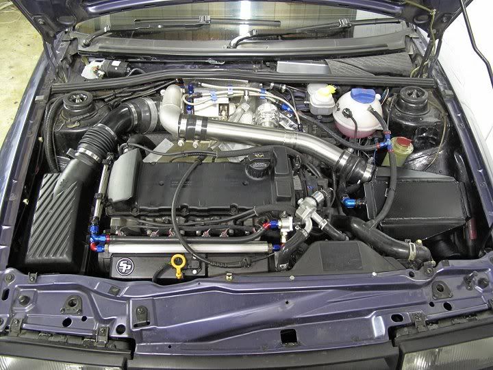

So my little project is complete and currently running 8 psi for testing. It's superb, pulls as smooth as you like all the way round and the boost is instaneous and completely addictive. Even with 8psi it would destroy my old Supercharger, such is the immediate and chunky torque......god only knows what it's going to be like 3.0 running 15-20psi, sweet jesus! :-)
The reason it's so lag free is partly due to the Schimmel intercooler, it only drops 0.25psi, and the Schimmel short intake. I've not experienced throttle response like it! The boost just whips round from seeminlgy no revs to 8psi instantly, then the WG opens and poops the party. The intercooler is madness, after 30 mins blasting, there was condensation on the casing and it was stone cold to touch, as was the intake, thanks to the oversized rad and mahooosive pump from a US V8.
So here it is, a bit starship enterprise under there, but it paid off because underbonnet temps are negligable, thanks also to the nappy which is very effective.

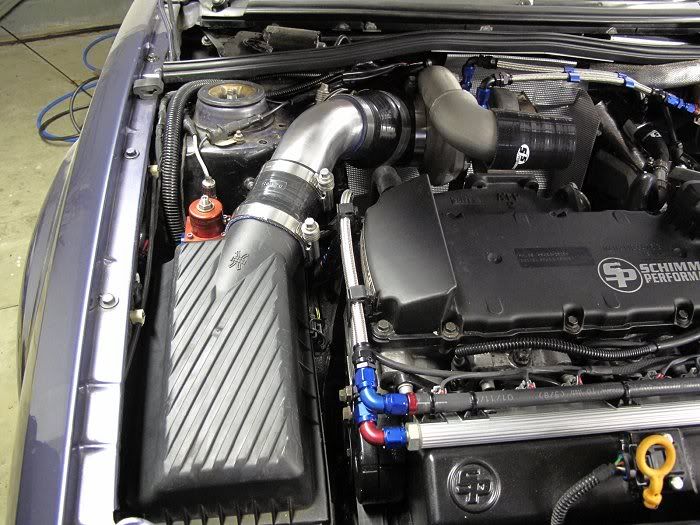

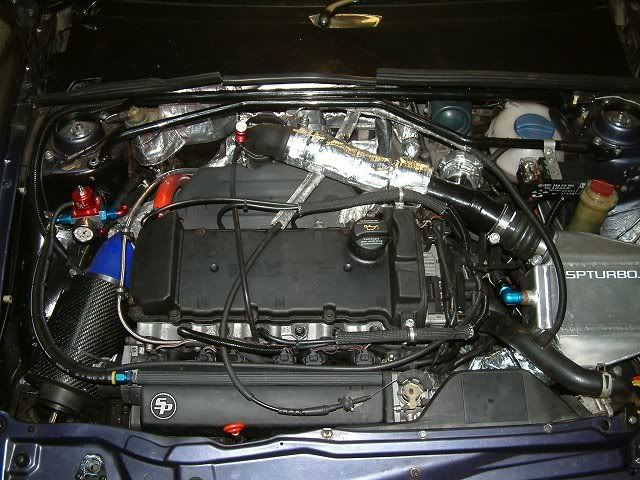

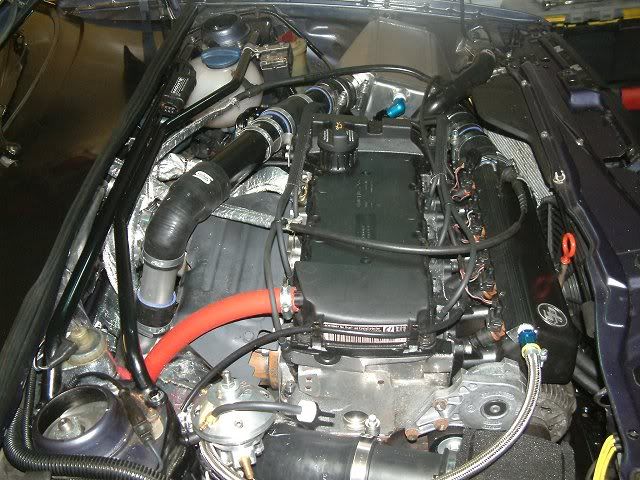

Few updates...

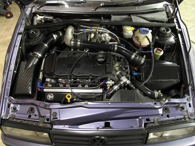

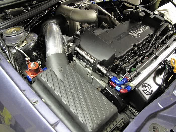

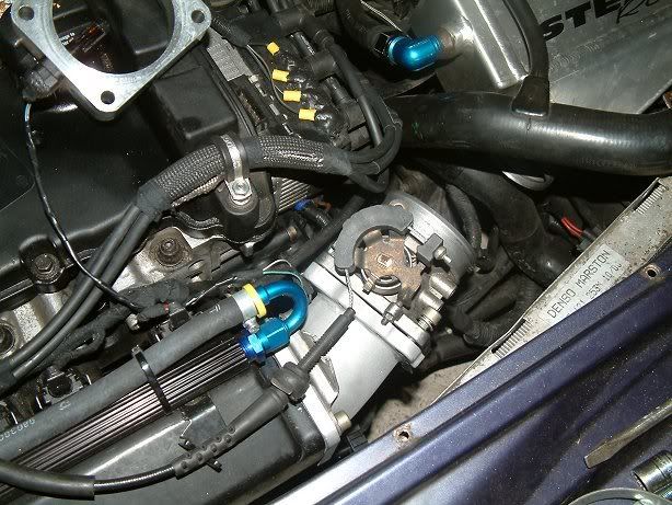

3.0 in, but obviously doesn't look any different to the 2.9, LOL! There are few changes to spot though....
TIAL 50.5mm BOV replaces 25mm Forge Motorsport one.

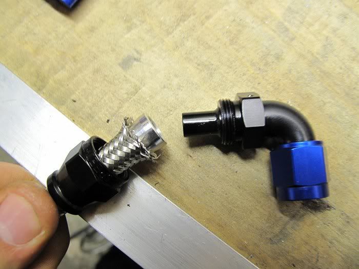

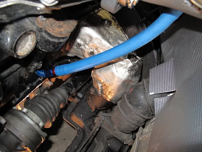

New custom made oil line rerouted to avoid another fire!

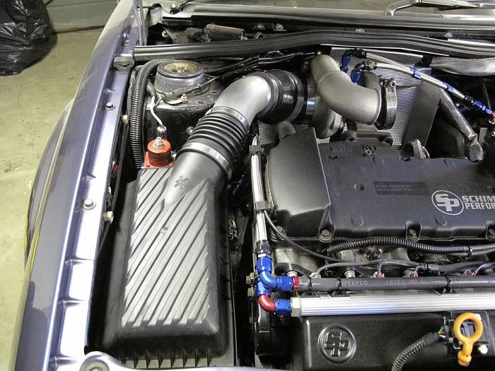

BMC in place of K&N filter

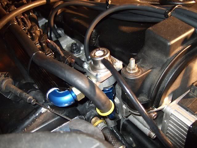

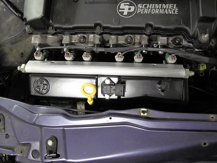

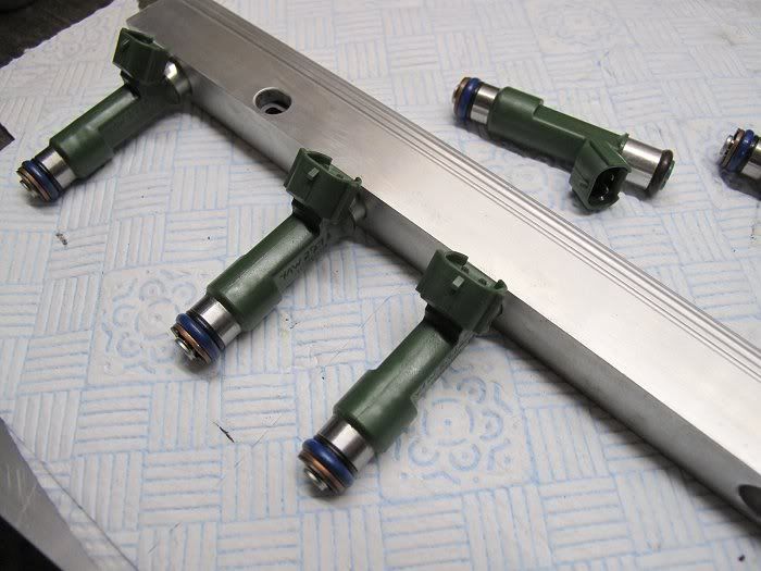

BEGI FRP gone and replaced with SX 1:1 fuel riser
MAF deleted

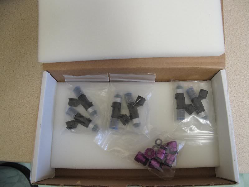

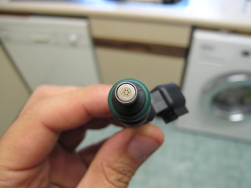

440cc genesis injectors in
Turbosmart boost control valve in and locked to 11psi

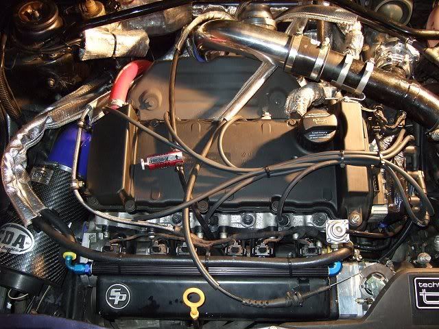

I'm sure it'll change many times over but for now, it's like this....messy, but functional ;-)

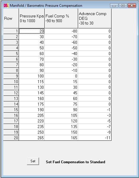

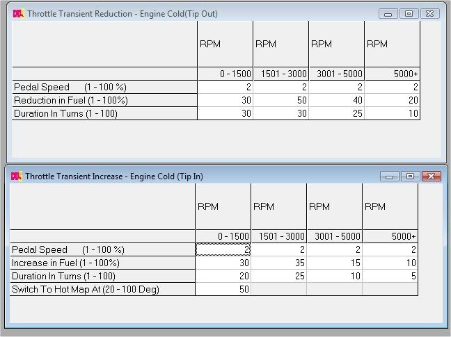

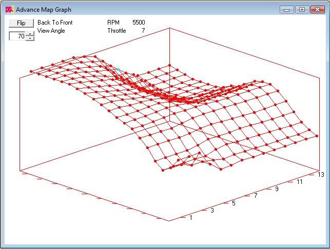

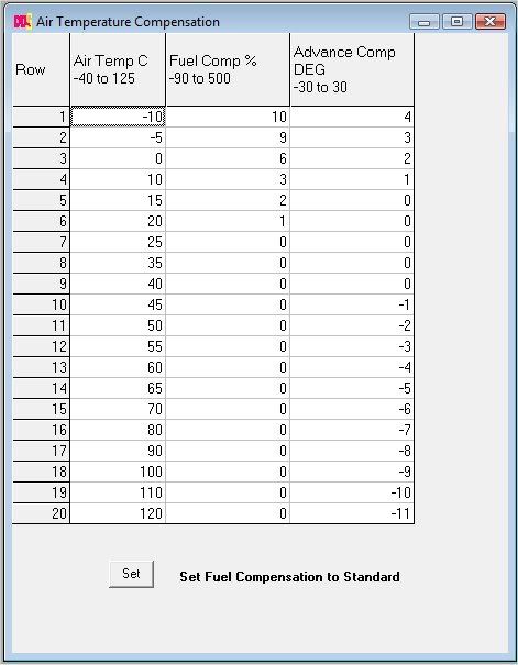

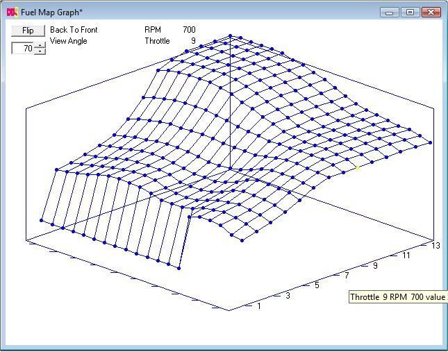

DTA tucked up in the Glovebox. Currently tuned at a really basic level, not even running lambda. Need to start getting my money's worth out of this box and use some of it's tricks.

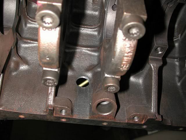

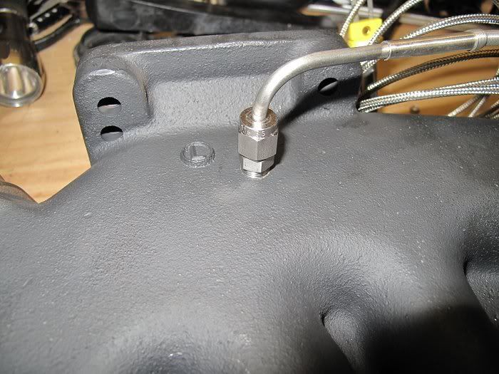

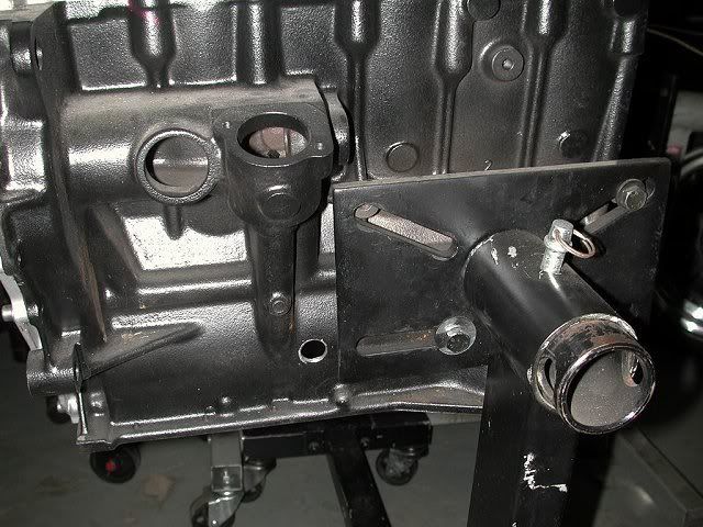

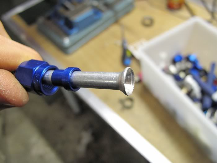

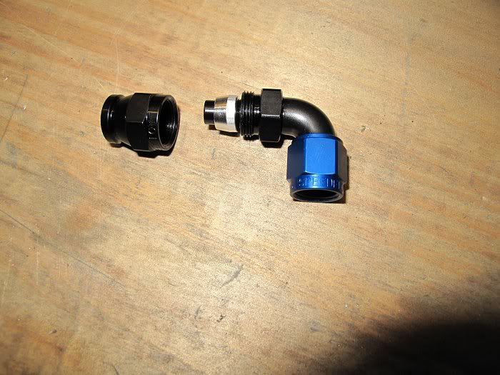

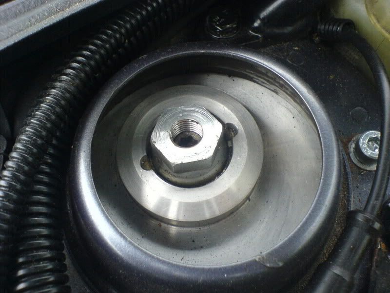

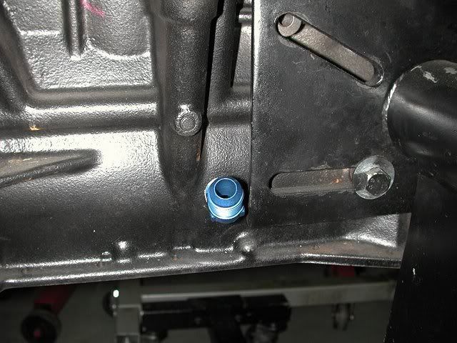

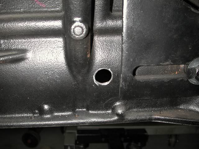

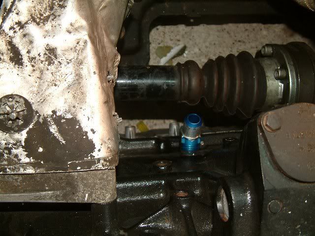

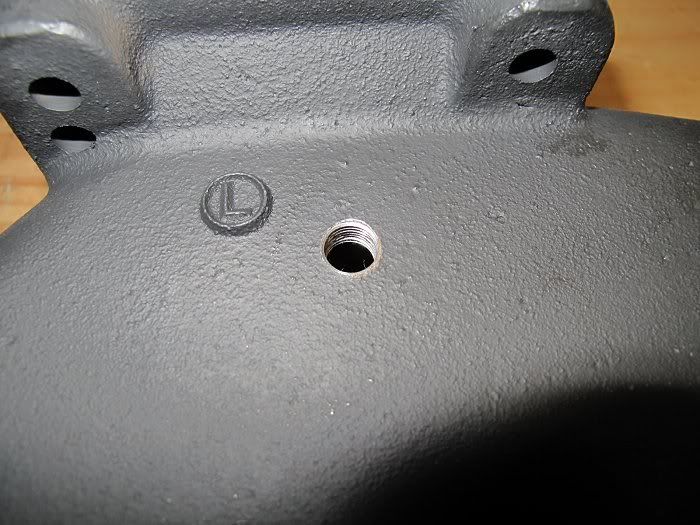

When my 2.9 and a bit block was built, I decided to return the oil to the block, rather than the sump. It's a more direct, shorter path back and is above the driveshaft level, so acres of clearance.
Here's how you do it. Start of with a 23/32" drill and you'll need a 1/2" pipe tap to cut the thread. The fitting is a 1/2" NPT to -10 JIC/AN 45 degree.

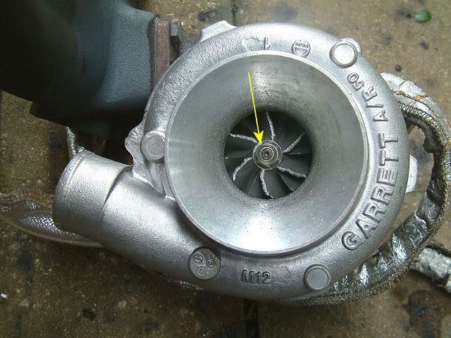

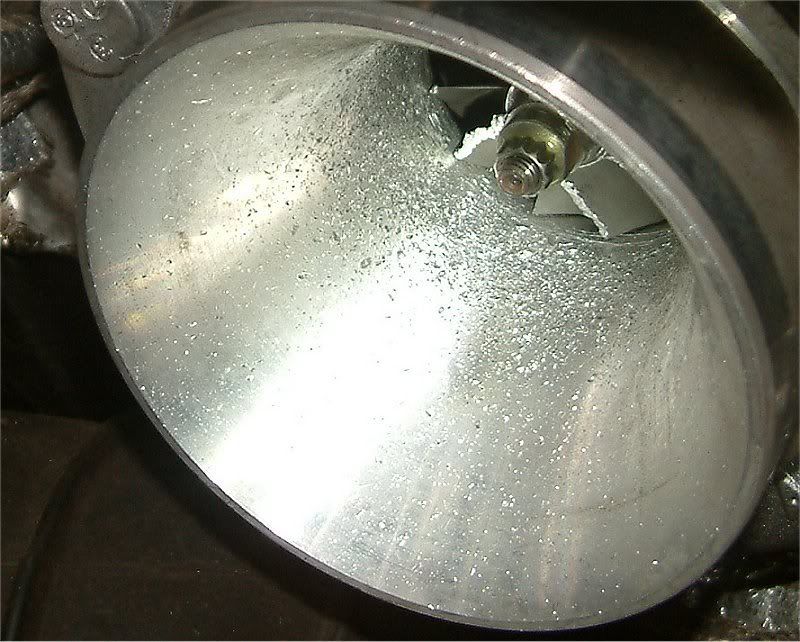

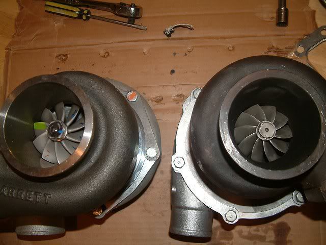

Second casualty was the turbo. The original GT30 I started out with ingested some debris and damaged the compressor wheel. What and how is still a mystery to this day.
Good excuse to upgrade to a GT35R though :-) Mr 35 on the left, and Mr 30 on the right for comparison....

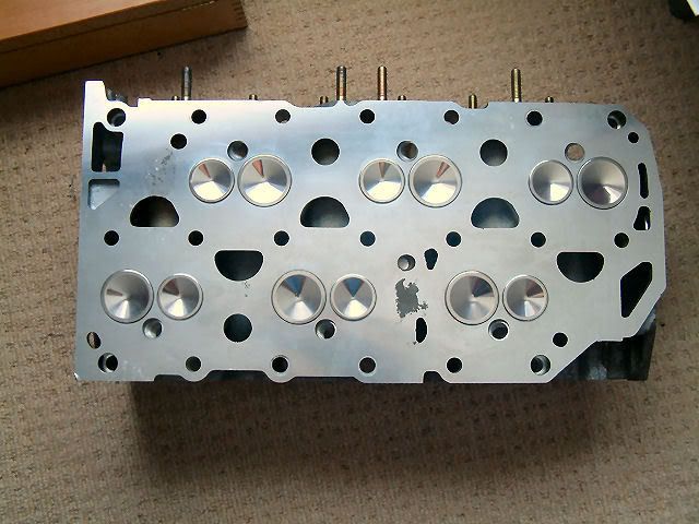

Still, nevermind, good excuse for more upgrades.... Schimmel big valve head and 263 cams :-)
The cams on their own are superb, but together with the head, bloomin awesome!! Highly recommended. Mpre torque and power everywhere.

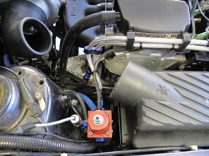

Stock regulator holder.....

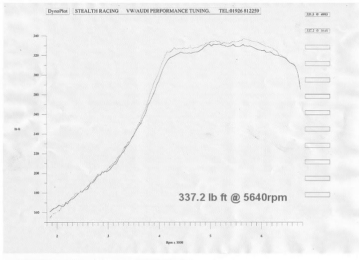

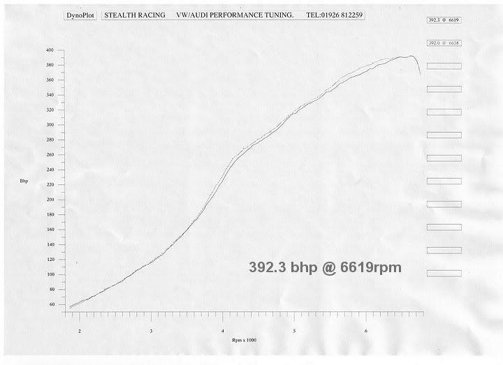

And the most recent dyno plots from December 07....
Power....
Torque...

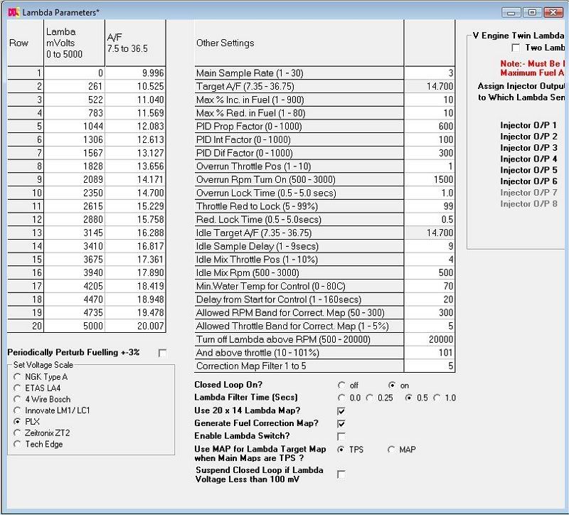

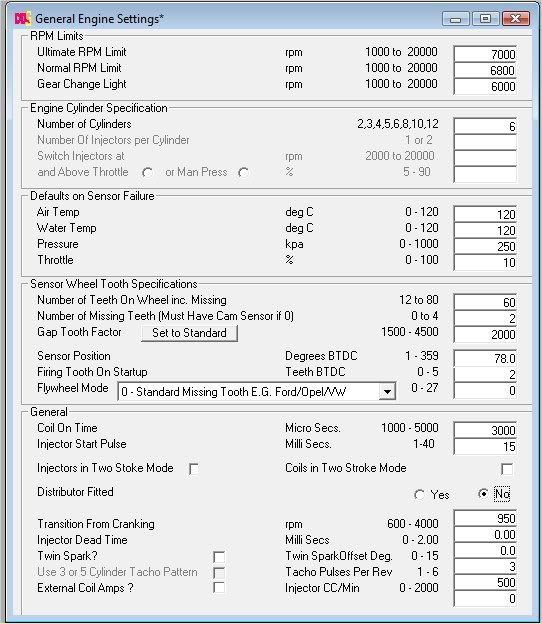

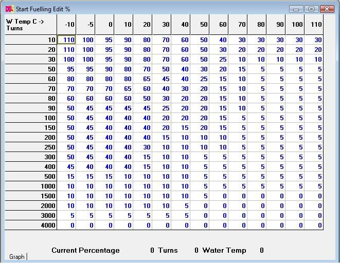

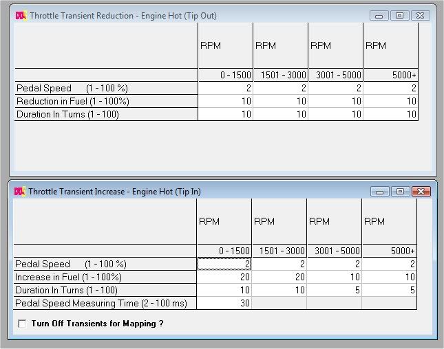

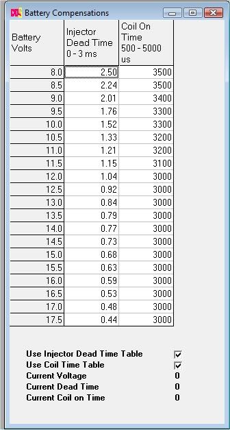

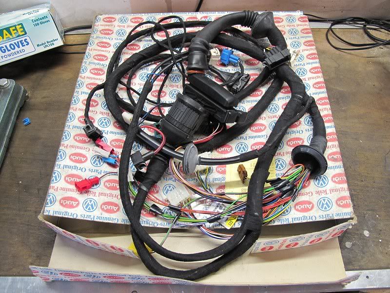

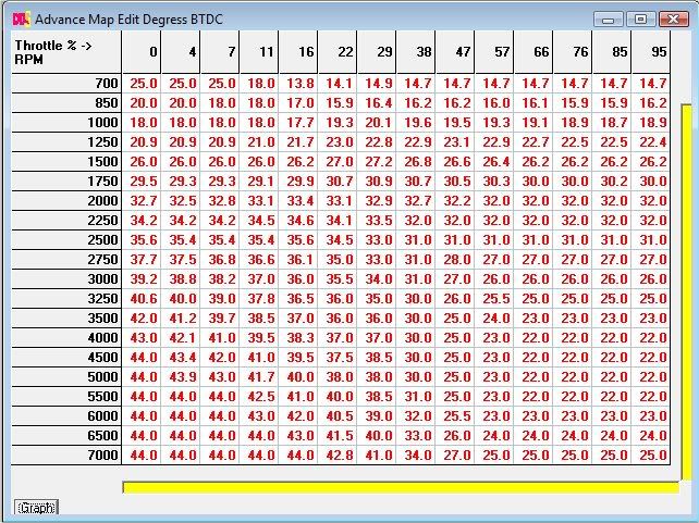

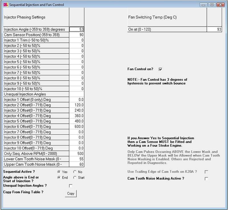

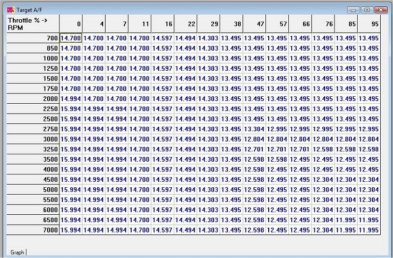

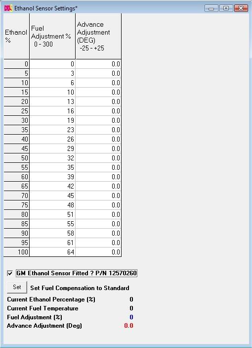

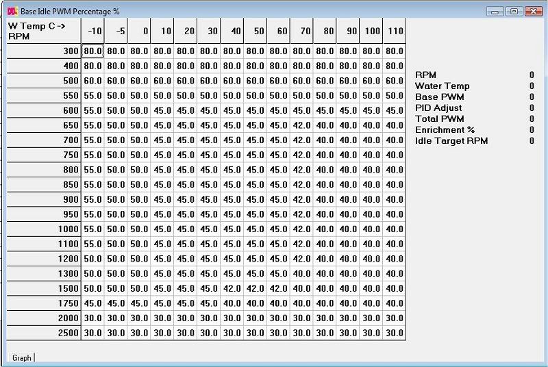

New standalone installed with a fresh wiring loom, made by yours truly :-) Took ages and my back kills!
It's a DTA S80 and it really is a nice piece of kit. Software and hardware both excellent and it runs like stock, well, better than stock actually. I binned the GM MAP sensor and went for an AEM 3.5 bar pressure transducer and it's super smooth. Just as responsive and smooth as mass air, but without the hassles of air flow limitations :-)

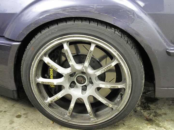

Got some new rims aswell :-)
Driveshaft shop stage 2.9 axles, good for 475whp.....should be enough :-)

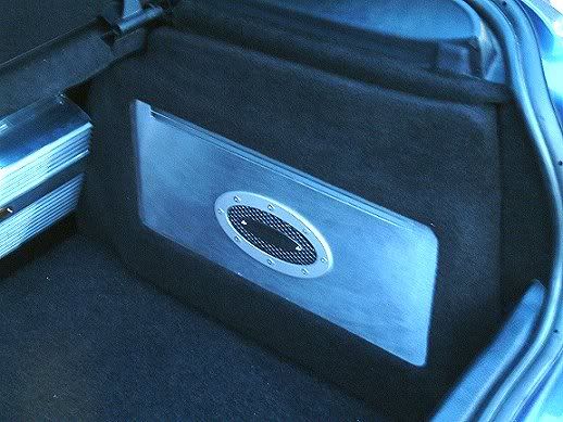

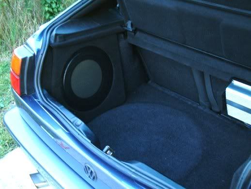

And I redid the boot arrangements - properly this time, LOL! Just need to make a false floor to cover the remainder of the boot and it's done :-)

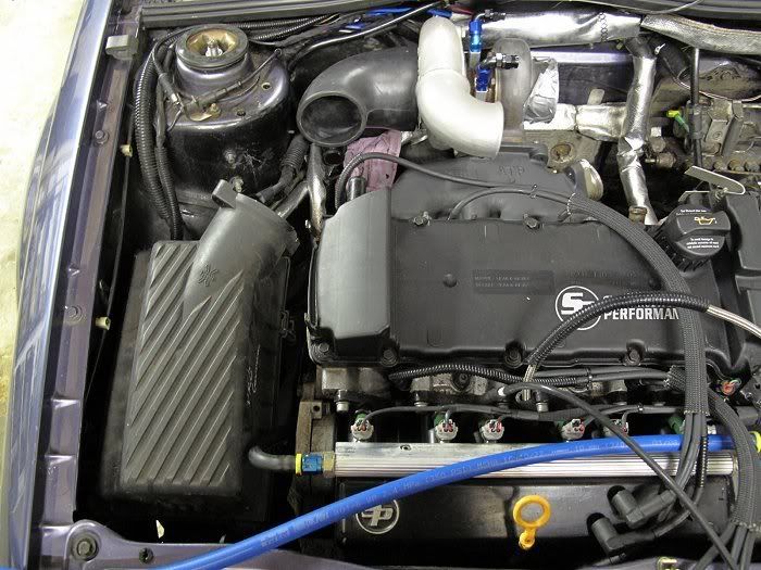

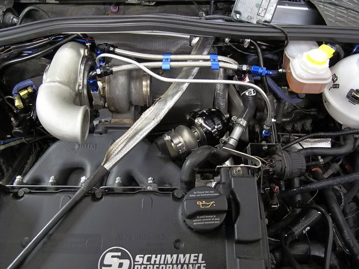

Few updates.

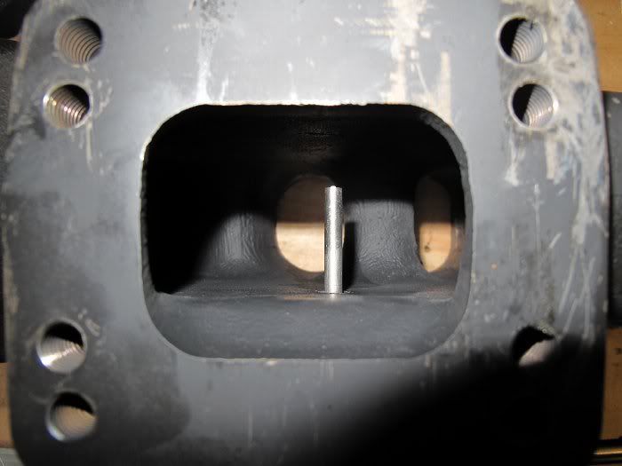

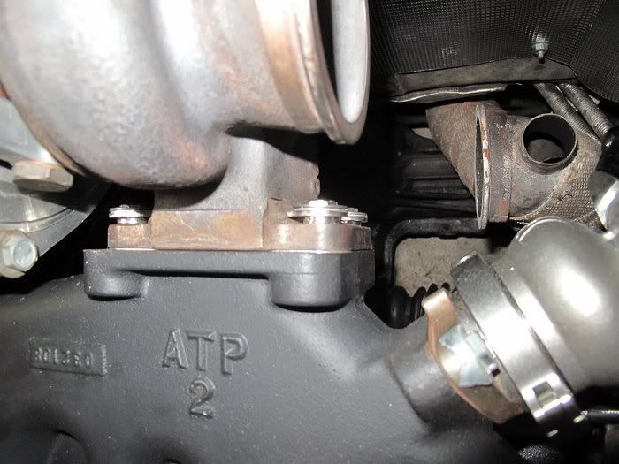

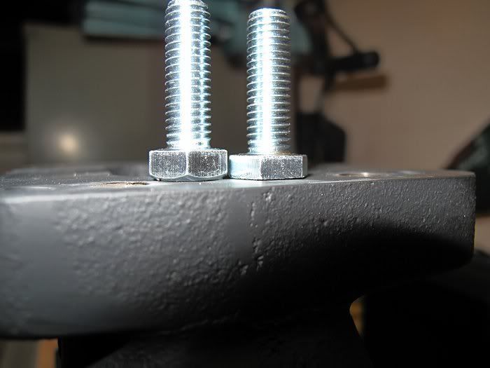

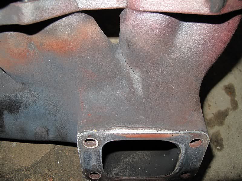

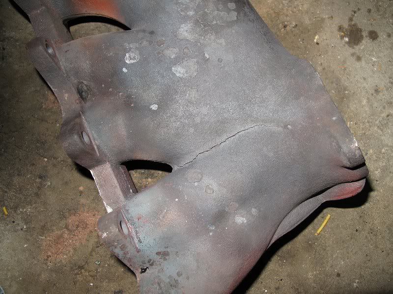

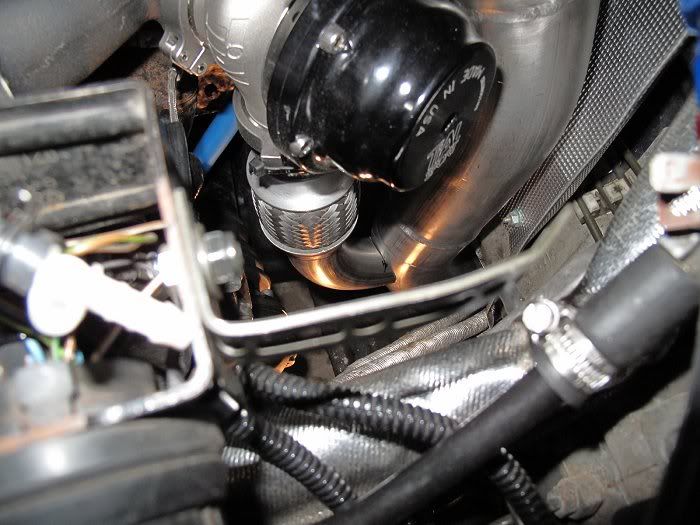

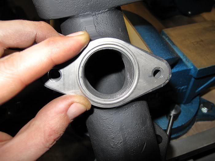

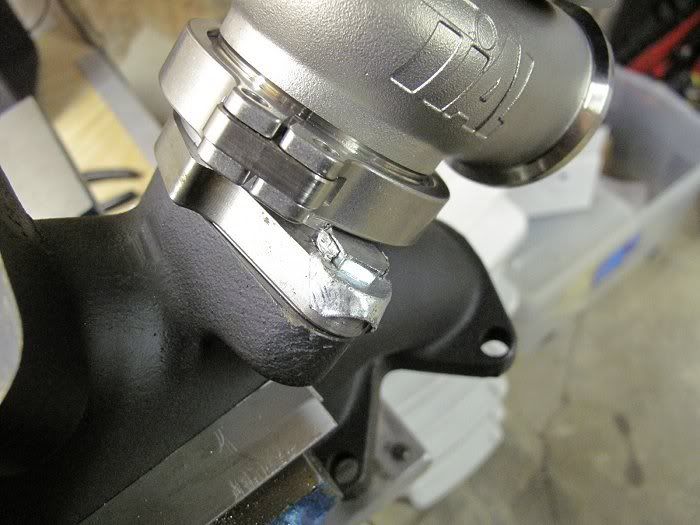

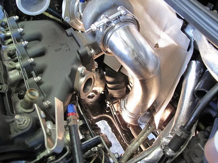

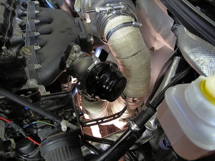

My second Spa manifold is royally f'cked, so that's going in the bin. Cracked right round.

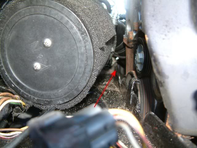

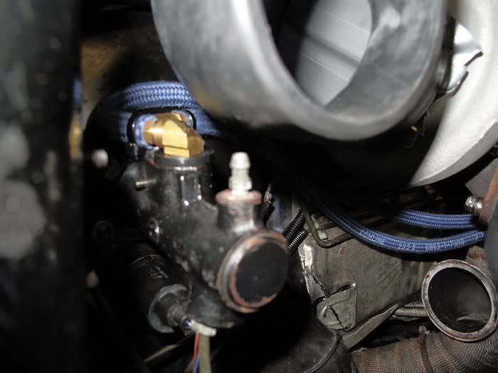

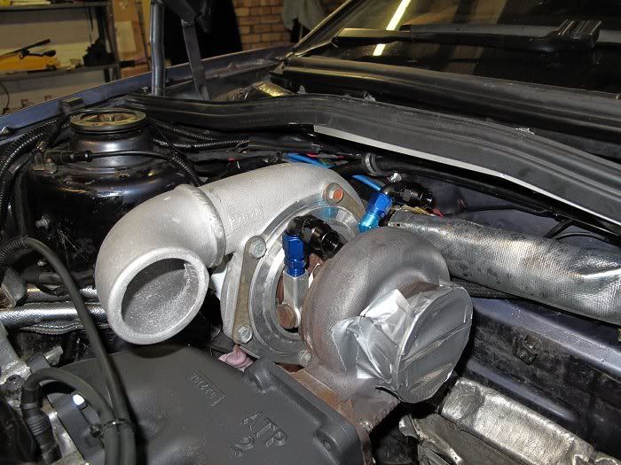

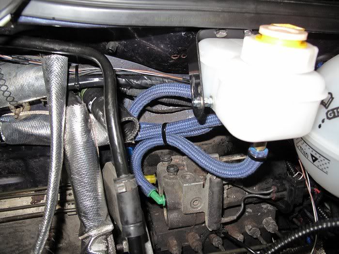

For those who want to know why the ATP manifold doesn't fit, here's why, the brake pot gets in the way....
The compressor butts up against the servo hose and loom too, although a smaller turbo won't do that. I'm using a TO4S housing which is pretty big.

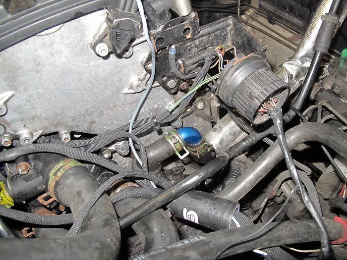

Not to worry though cos both issues are easy to rectify. Simply take the brake pot off completely and relocate it next to the expansion tank and run hoses over to the master cylinder. Can't see that in this pic, but you can see there's plenty of room once the brake pot's been moved....

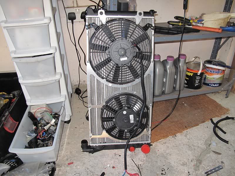

Also fitted a new rad with uprated fans.
And a MK4 Golf header tank, which is LOADS better than the corrado one!!

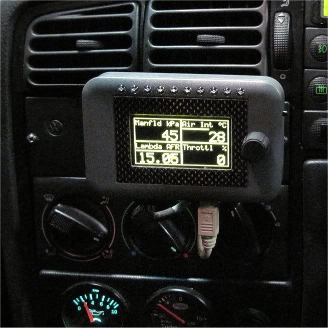

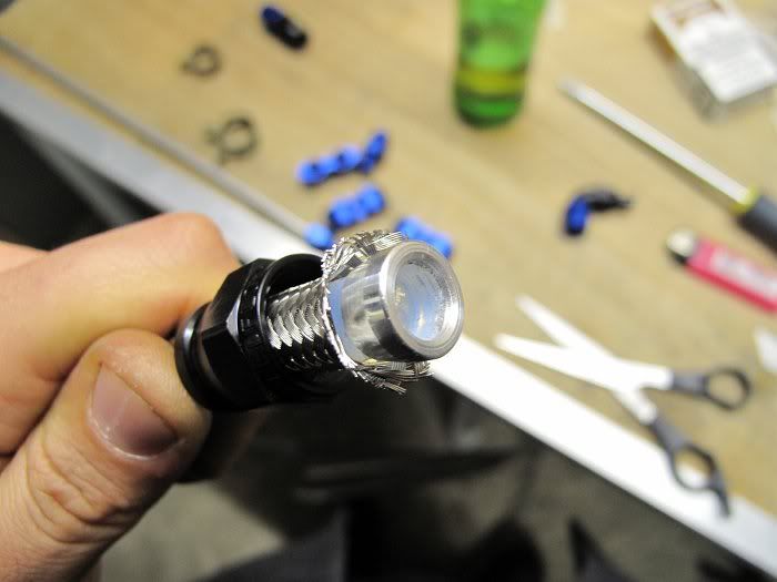

And I've also rigged up a neat little display to read important engine info. It can display everything the ECU can pump down the serial cable.....manifold pressure, water and air temp, oil pressure and temp, fuel pressure, volts, throttle position, injector duty and pulse width, transient fuelling, cold fuelling percent, air temp compensation percent, you name it, everything!

I also deleted the aux water pump. I observed what it actually does when the engine was off by pulling a couple of hoses, and not a lot is the answer. I know of a few other people who've binned it with no adverse effects.

I'm using ATP's 38mm to 44mm adapter. The hole in the manifold is pretty small, even for a 38mm, so I gasket matched it.
That's better!
I made some lock washers and trial fitted the TIAL 44mm.
Not much room for a bolt head with that adapter, so you need to shave down some M8 x 25mm bolts.....
Next I drilled and tapped a thread for a 1/8 NPT EGT probe....
And the probe slots in (from underneath) like so....
The probe sits about 2" before the turbo and in the middle where all the exhaust ports converge...

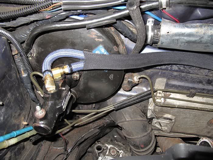

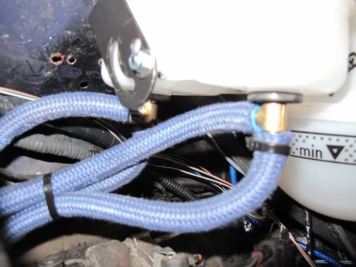

Using some fittings I had laying around, I chopped off the lugs from the stock resevoir and grafted them on for a factory tight seal.
Make sure you use proper hose that's brake fluid resistant. I lagged the hoses in a special abrasion resistant covering in case the turbo contacts them.
There's about 2 cm clearance around the turbo for the hoses, which if you have uprated mounts should be plenty....
This was a bit of a ball ache getting the lengths right for clearance and to avoid rubbing related damage. Plus you have to keep the hoses above the Master cylinder level to prevent air locks.....
As hard as I tried, I couldn't find a 4 outlet resevoir, so I had to T off the 2 outlets into 4....
And here it is, complete and of course, lagged with heat sleeving for good measure. I'll be using a motorbike resevoir in the wiper area for the clutch....

Whilst waiting on those, I thought I'd bolt the turbo on. I used Stage8 locking bolts which seem very nice, only time will tell if they hold the turbo bolts still!
I also started making up the oil and water lines.
I couldn't get the hardlines I wanted for the water due to supply issues, plus you need an expensive tool to debur and flare the ends to 37 degrees, so I used PTFE lined braided instead, which can handle 230ish deg C, so should be OK. PLEASE do not use rubber hoses, they just harden, perish and then split very quickly! I speak from experience!
The turbo will have a jacket on it when I'm done for further protection.
I did go hardline on the oil though as it's a critical feed. All the fittings come from speedflow and they flared a metre of -4 hardline for me and fitted the sleeve nuts.... oh and I made a heat shield to protect the brake lines etc.
The braided fittings are a peice of cake, no special fittings needed. These are -6 size and here's how you assemble the lines...
Unscrew the nut off the end to reveal the sleeve collet thing....
Slide the black nut over the hose and then pick the braiding with a small screwdriver so that it pulls away from the inner liner and trim off the spikey bits, then slide on the collet....
Push the other end of the fitting into the collet and then tighten the two halves together with the appropriate size spanners or a vice....
Top Tip - When cutting the braided hose, wrap it with some masking tape and use a junior hacksaw and the end will be neat and easier to assemble ;-).
And here's how the hardline works.
You slide your sleeve nuts on first, then flare the ends to 37 degrees.
These fittings are expensive and may seem over kill, but trust me, money invested here will save you a lot of grief in the long run :-)

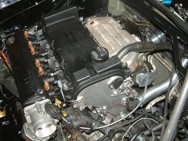

In an attempt to modernise the engine and make it better to drive, I've had my Schimmel intake modified to take a Bosch direct to manifold MAP sensor. It's also an air intake sensor too, so makes things neat and compact.
I've blocked off the servo outlet on runner 6 as I prefer to take a servo vac feed from the whole plenum. The silver sensor is for my boost gauge...
Denso 1220 500cc injectors, the best bar none. These instantly transform the VR6's idle. Totally smooth and rock steady :-) They're from the 2009 Mazda RX8, which I've had adapted to fit a VR6.
And here you can see the injector loom I made for the DTA S80, again sleeved in abrasion resistant sleeving :-) ....

Made a bit more progress....
Downpipe's coming together. This is the shape you're aiming for with the ATP. From the top, I used a tight 90, 30 degree section, then a 90 degree and finally a 3" Ilok flex. All from Jetex.
Since it's impossible to fit the flex on the vertical (wastegate gets in the way), next best thing is mounting it at 45 degrees above the front ARB.
The pipe to bulkhead gap is bigger than it looks, there's about an inch, which is plenty with uprated engine mounts...
Hi temp oil drain hose from ATP. I'm draining back to the block for easier driveshaft clearance.

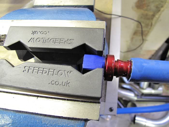

Here's a tip for fitting JIC push hose fittings. I'd get some plastic vice jaws from Speedflow. They hold the fitting tight and protect the delicate anodised finish. Warm the hose in boiling water for a minute and put some fairy liquid on the barbs. The hose will then slide on easily and save you a lot cursing!!
Factory air box is a goer. I'm happy with the way the fuel reg and fuel hose fit around it. Just need to find a rubber bellow to fit between the airbox and intake pipe and the job's a good un :-)
Even with the big SX regulator, you can still get the airbox lid off for filter changes as if it were a standard engine :-)
I kinked the hose 90 degrees under the intake pipe to give a bit of flex when the engine moves back and forth, again, just like the stock hoses ;-) I used stainless hose around there because it's quite close to the manifold. I don't trust rubber and heat when dealing with 5+ bar fuel pressure!.
Getting there, slowly, but surely!

Got the last bit of welding back from my mate last week ago and looking good so far.
The wastegate dump pipe is done and he's got that in for welding too, but these are the construction pics.
I just used a little piece of straight, a 1.75" flex and a 90 degree. If using the Tial 44mm WG, you'll need 1.75" bore pipe and if you're using the 38mm, you need 1.5" pipe.
Once you're happy with your angles and how the dump pipe butts up against the main downpipe, you need to make a hole in the main pipe. I couldn't find a nibbler tool strong enough to cut through stainless for reasonable money, so I had to do it the tedious way.
You don't want to know how many drill bits I got through doing this. Motto - don't buy cheap drill bits!!
Nice welding isn't it? :-)
Then you obviously just file it all out smooth.

Airbox is finished. The ATP rubber inlet isn't much use, so I had to make something up with bits of silicon I had laying around and I'm happy with how it all sits.
It's too rigid though, so I'll need to find a rubber coupling to ensure the airbox stays still when the engine rocks back. I've looked at an Audi R8's rubber coupling and it might just be do the job, so I'll order one.
Should get the next bit of welding back next week sometime hopefully and the downpipe is practically done, just needs a couple of lambda sockets etc.
Just the one update. Downpipe is almost complete.
My welder's current welding on the lambda boss and the other side of the flexi and it's done! :-)
Another minor update.
The Audi R8 rubber intake bellow fits like a glove :-) Really happy with how that fits. Not bad for £14!
Most of it is over the metal intake pipe, so shouldn't collapse under boost.
I've also derestriced the airbox by removing the front and upper snorkels. I wanted to use the upper snorkel but it reduces down to 2.5" inside the box, so a bit restrictive for turbo use.

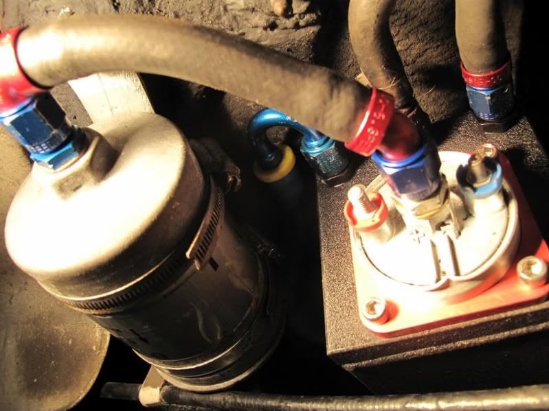

I imported this bracket for the Bosch 044 pump from 034Motorsport which looks nice. I painted the base of it and the pump with smoothrite to stop them corroding over winter.
Just a couple more bits of exhaust to weld up and a new boost pipe and it's nearly there :-)
I need it back on the road, I miss the acceleration. Every car I drive feels dog slow compared to a VRT!
OK, my welder had a spurt of enthusiasm last week and I've managed to make some good progress this weekend.

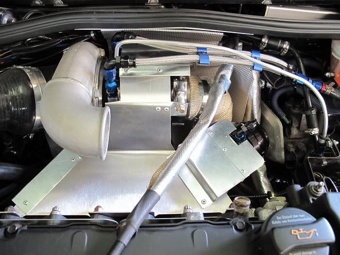

Downpipe lagged, wideband fitted and then thrown onto the car -
The ATP heatshield is rubbish, doesn't shield anything and sits too close to the manifold, so I modified it, LOL! Notice also the wastegate fitting. Rubber or silicon vac line just isn't going to last for shit with all that heat, so that and the dump valve are plumbed in with -4 braided teflon. The other benefit of hard line wastegate plumbing is no 'balloon' effect of the line, so it should spike a lot less than normal.
Anyway, the shielding looks a bit heath robinson, but rather that than melted ancilleries -
All done :-) Just got to plumb in the Bosch 044 and it's ready to fire up!
Looks a bit industrial and not a whole lot different from before, but fingers crossed, it'll be a lot more robust this time round!

The original Setrab chargecooler rad was a tad small I thought, but worked well. I've replaced it with a LHD air con radiator and that's dropped temps a fair bit due to the larger cooling area, plus it all fits neatly being a VW part :-)
The flow has slowed down a bit due to the restriction of the rad, but I'll get a beefier pump!
Ford Duratec idle valve added, SX fuel reg deleted and stock regulator added plus some minor tidying up :-)
To balance the pleasure, I had some pain a couple of weeks ago when some silly woman turned into me as I was overtaking her. Should be getting the wing and wheel sorted through the insurance fairly soon.
Roll on winter and some nice cold turbo air! :-)

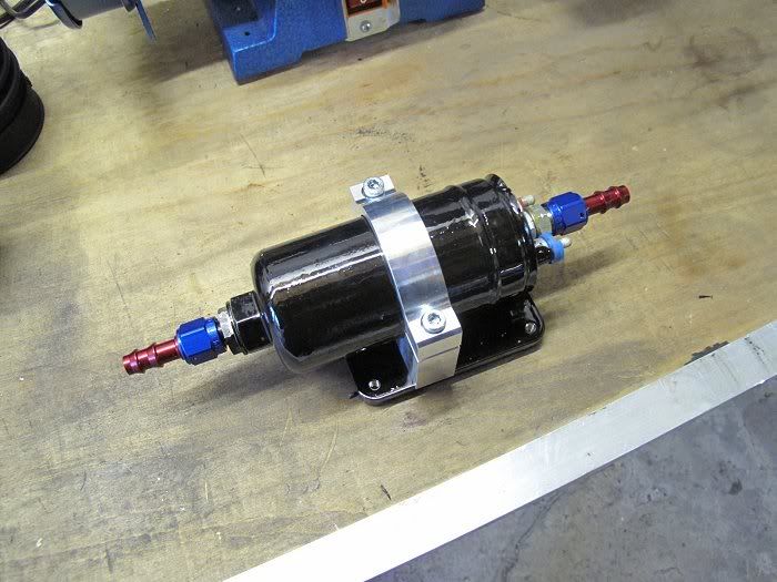

044 pump holder and 1.5 litre surge tank in one unit. As the pump is submerged in fuel, it reduces noise considerably!
More pics to follow when it's fitted to the car.
Have ordered some Bosch EV14 550cc injectors too as it's time to turn the boost up :-)
http://www.sprayitracing.com/52lb%20Bos ... edance.htm
All done. Pretty straight forward to install and noise wise, it's about the same as an old K Jet MK1 or MK2 that's got a tired pump. Can't hear it all when cruising, just a buzz/whine at idle. Loads quieter than the normal mounting method :-)
Next on the list is to fit these 550cc Bosch EV14 injectors. Easily the best injectors on the market today...
..and here's why. They atomise right off the tip for a super fine spray :-)

After a short while I discovered ATP's uprated oil drain hose isn't so uprated after all. so out with the good old hard line again :D

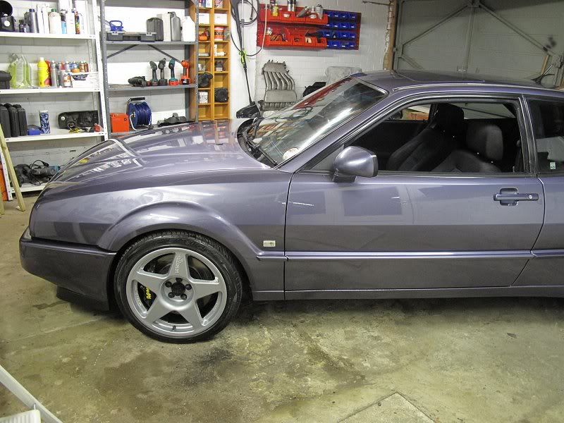

As it stands currently, 02/10/10. Just had it's winter wax. Cut back with G3, then a layer of Collinite 845, followed by a layer of Collinite Marque D'Elegance. Wheels have had 2 layers of 845 then 2 more layers of Collinite 476. I like Collinite because it's perfect for lazy bastards like me, lasts for ages :D
Slightly blurry and pants pic (I'm no David Bailey!!) but the motor in it's current spec. Standard VR6 idle valve is a complete and utter pig to drive with a standalone, but I got it there :D Hats off to the people at Bosch who got it spot on with the factory ECU :salute:

General Engine Settings
This is where you tell the ECU your crank type, coil type, rpm limit, etc etc. The basic vital statistics of the engine in other words!
Startup fuel (aka Crank fuel)
All petrol engines need a good slug of fuel to get it started. Here is where you set it :D These bunch of numbers throw the motor into life just as quick, if not quicker than the stock maps.

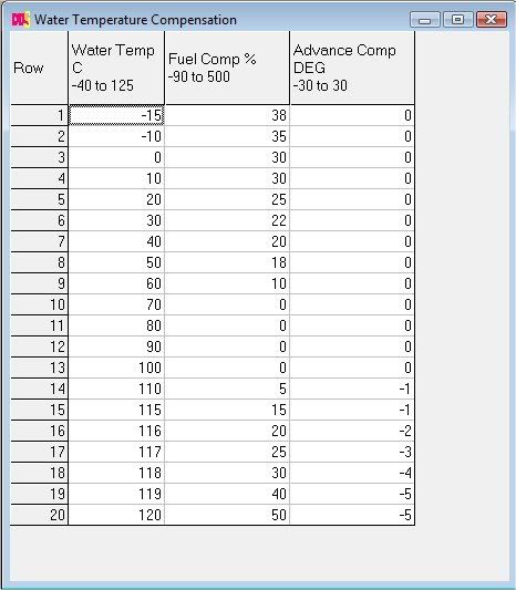

Water temp compensation
Think of this as a choke :wink:
Air temp compensation
I won't bore you with Boyles law, but the basic rule is for every 10 deg C increase in air temp, oxygen content reduces 3%. 3% less oxygen needs 3% less fuel, but I find the VR6 is quite sensitive to this. Instead I find pulling timing works better. Due to the shared cylinder head design and associated temps, it needs a decent amount of fuel when hot, so I shoved Boyle's law :lol: A normal two head V6 would work better with Boyles law.
Main fuel map
This is the main RPM v TPS (Throttle Position) fuel map. You can also set it to be RPM against load (MAP) but I'll go into that later.
Fuel curves should match torque curves :wink:

Ignition Advance
Ideally this needs to be set on a dyno. Chiefly because ignition advance gets to a point where advancing it achieves nothing. There's no point in running mega advance if all it does is max out the knock sensors. But these settings work beautifully with the VR6 :D
Again, where boost is concerned, timing needs to come down in boost to prevent det. Det, or Detonation / pinking, is where the fuel explodes instead of burning in a controlled manner. Det is what puts holes in pistons!
Battery Compensations
Because battery voltage affects injector and coil performance, we have to alter the inj PW and Coil dwell accordingly so that when fans kick in or headlights are switched on, the engine doesn't run lean.
E85 Ethanol
E85 (15% Petrol, 85% crop derived ethanol) is the future of petrol engines. Here are the compensations required to run E85 and any concentration of E85 and petrol.
Sequential Injection
Here are the Seq settings. Sequential fires the injectors in sequence with firing order, so 1, 5 , 6, 3, 4, 2. On part throttle and idle, this is far more efficient than batch fire (continuous injection like 16Vs). Once you get to full throttle and high rpm, the intake valves are opening and closing far faster than any injector can keep up with, so the DTA also includes a full 3D Injection Angle table, which I won't go into here :D . This is what the cam sensor is for on the stock engine and why you lose so much power when the cam sensor is dead and when the intermediate shaft timing is screwed up.
Throttle Transients
Think of TT as a flick of fuel to fill in for a sudden opening of the throttle. Just like carbs from the good old days, injectors need time to open and close and opening the throttle quickly can cause a lean condition. The DTA includes hot and cold tip in to fine tune these situations!
Closed Loop Lambda control
What about lambda control? I here you cry. Well, the DTA has that covered too and supports both narrow and wide band and up to 30hz refresh rate, which is plenty fast enough. All the over run and some of the idle parameters are set here too, aswell as a log of fuel corrections.
Full lambda targetting too :D You feel your engine runs better at specific AFRs than stock, well, here's where you set that!!

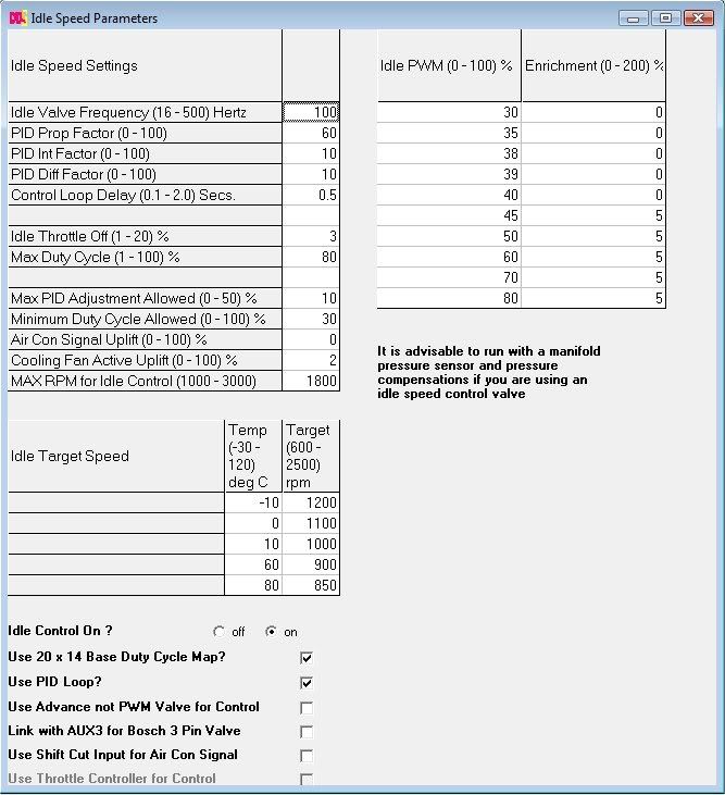

Idle control
Believe it or not, a stable idle speed is one of the most difficult areas to tune on a petrol engine. On a diesel it's p1ss easy as they have no throttle. RPM on a diesel is directly proportional to air drawn in and fuel metered. It's very different with petrol engines!
I managed to get the stock VR6 idle valve to work with the DTA and here are the settings. You also need a 1N004 diode across + and - of the idle valve and 80% max PWM, 30% minimum.
Idle 20x14 PWM table....
As I say, this is just the tip of the ice berg. Mapping is not difficult. If you want any advice or on site help with standalones, PM me :D

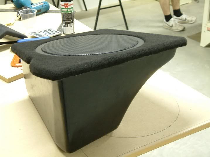

And whilst I'm in the mood for bigging myself up..... :D

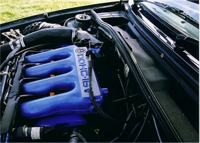

Here's my old 16V MK2 turbo. It was a beast :D

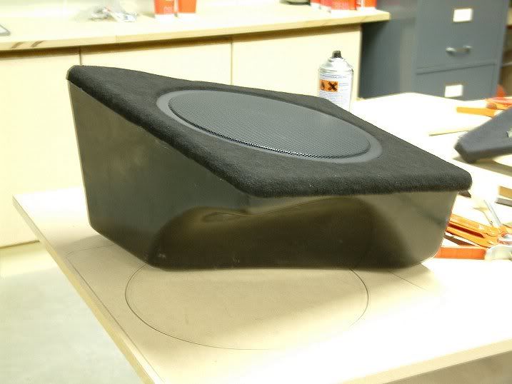

I also designed the Corrado Sub box and amp panel....

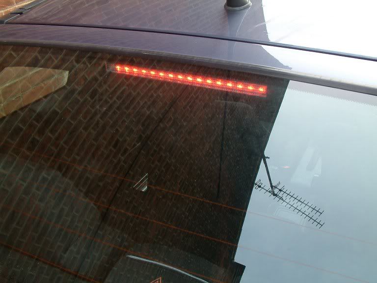

Not to mention the first to go OBD2, first to do a 3rd Brake light and so on....
