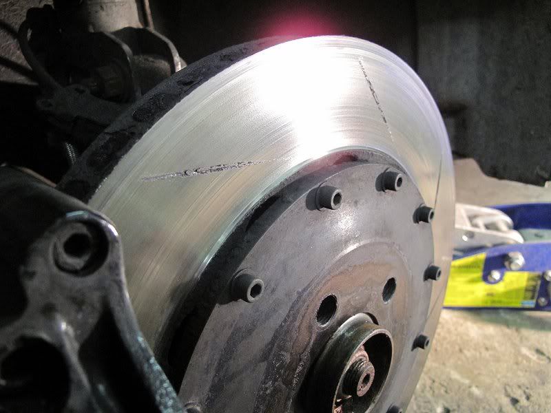

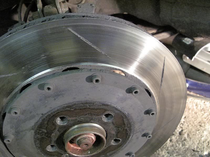

Kevin Bacon 5 Posted November 24, 2010 My AP discs are just about dead after 4 years and 50K+ miles. They're currently 24mm thick (28mm new) and you're supposed to replace them at 27mm :lol: They've put in a damn good service life and are still warp and fade free. Amazing brakes, I've been super impressed with them :salute: The poor old things practically have no grooves left :lol: This coincides nicely with fitting my Winter wheels, which necessitates the fitment of weedy 288s, so APs off for now and I'll get them spruced up ready for next summer. I refurbed the Speedos Mic_VR sold me (cheers chap!) with the factory correct silver paint and had them fitted with Continental TS800 winter tyres. My fingers still ache from all the sanding, but they came out OK I think :D The theory is all these edges in the tread blocks flex and bite into cold surfaces and snow etc. They're also soft and stay soft as the temp drops. I hope they work! I was going to fit them tonight but the rigid pipe to flexi hose connection has rusted solid, so I'm going to have to make up a couple of new lines :bad-words: . Got the stuff to do it, just need buy a brake flaring tool from somewhere for the weekend. Quote Share this post Link to post Share on other sites

StormchargedVR6 0 Posted November 25, 2010 Nice work on the speedos mate, those discs have seen some heavy use :lol: Think you have a shock going back to standard brakes :shock: Quote Share this post Link to post Share on other sites
