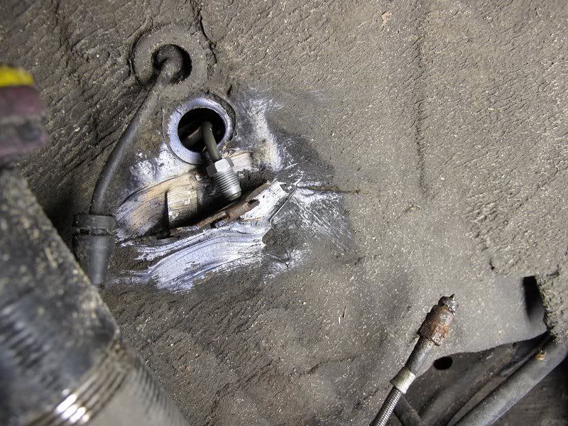

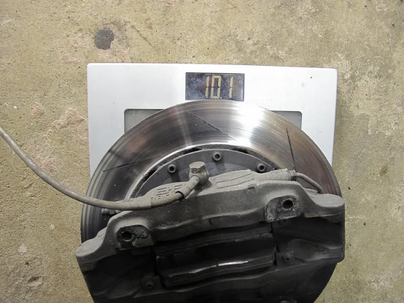

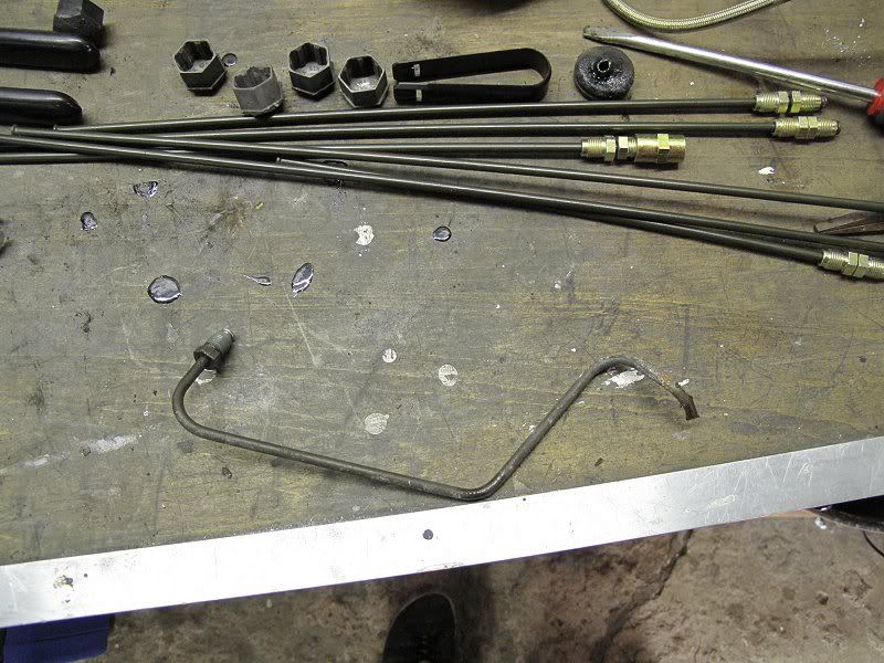

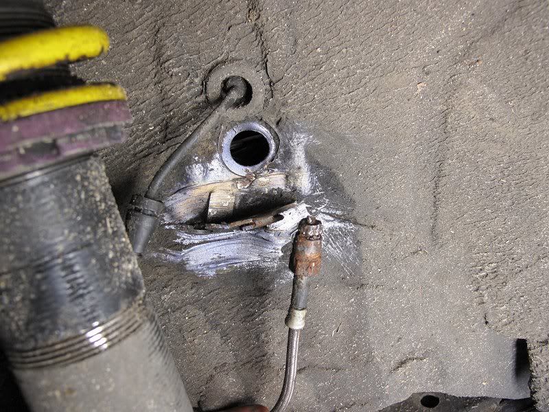

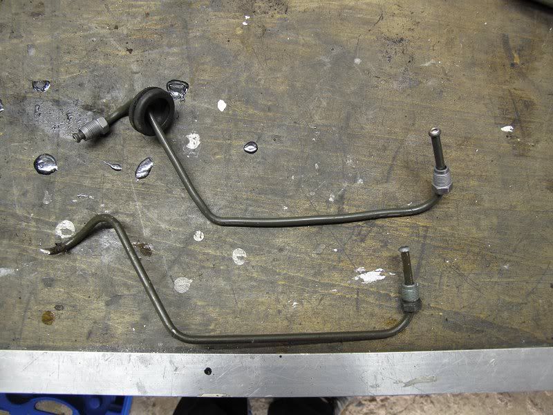

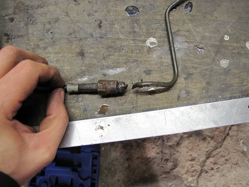

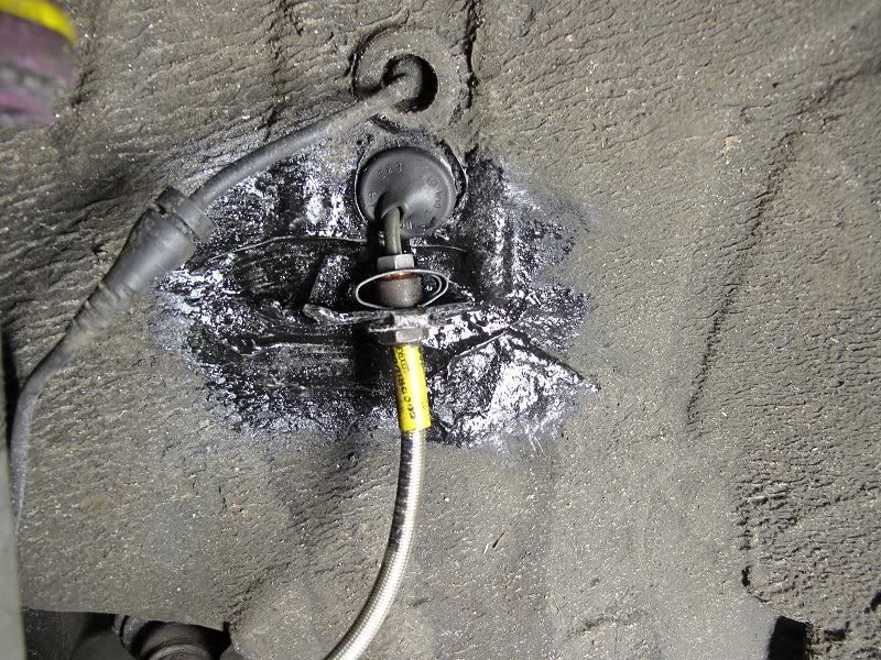

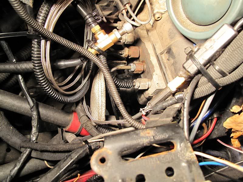

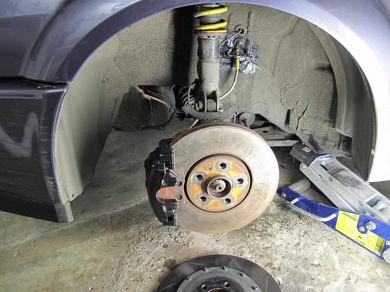

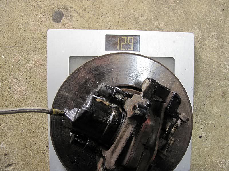

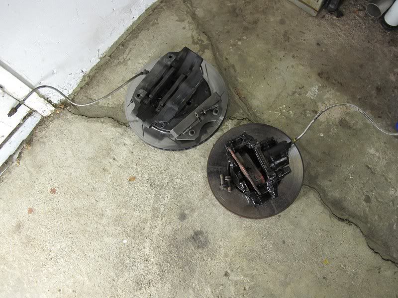

Kevin Bacon 5 Posted November 26, 2010 OK I know I should be out on the beers on a Friday night, but as my C is a daily, I had to crack on with the brakes. Just in case something goes t1ts up and I need to get some bits tomorrow! As it happens the first new pipe went rather well :D OK, so here's the usual Corrado problem. The Flexi hose rusts solid onto the rigid line. Which means you have to snip it off and make a new line. Typically, my first crack at brake line fabrication has to be a stumpy one with loads of awkward bends in it!! Even with the right tools, it still took me over an hour to copy the line. Glad I'm not paying someone to do this!! Looking good here.... And also at the ABS pump... Job done :D Sexy APs off, 288s on... 330mm AP next to 288s And just for cracks, check this out.... AP 330 weight in KG.... And the lardy 288s... I'm hoping the driver's side will let me off with having to make a brake line tomorrow, in which case I'll be trying the winters :D Quote Share this post Link to post Share on other sites
CazzaVR 0 Posted November 26, 2010 That's some weight difference... mind you, most of the AP disc is worn away :lol: That's a tidy wheel refurb, there Kev- lookin' factory-fresh! :) Quote Share this post Link to post Share on other sites
pete_griff 0 Posted November 27, 2010 glad to see you're getting there. if you want to make a good job then brake lines are such a fiddly PITA aren't they! i hate doing them! still, there more you do, the better you'll get. have fun doing the really short rear line that goes from the bias valve to the nearside of the rear beam; it's only about 100mm long and you basically have to bend it back on itself. that's a bending tool job then finish it off with hands and hope you don't kink it! that one will probably be a pig with steel lines (sorry to break the news! that said the cupro nickel aren't loads softer than steel...) let us know how you get on! oh, have you had your bias valve off before??? if you're doing the rears then i would buy a new bias valve and bolts - they are always corroded solid onto the bolts. i had to slice right up through mine with a 9" angle grinder (and cutting through ally isn't fun!), then hammer a wedge in to remove the last 5mm "slice" left on the car and even then it took some shifting... you have been warned!!! (top tip, no doubt teaching you to suck eggs, but copper grease the new bolts when you put them on with the new bias valve, then you won't have the galling and corrosion problems in future :) ) Quote Share this post Link to post Share on other sites
pete_griff 0 Posted November 27, 2010 how did you do yours by the way?... i like to flare one end then copy as much of the line as i can and then chop it to length flare the other end last. i found that if you try and get it exactly the same length to begin with and flare both ends then bend it to shape something always (inevitably) goes wrong! Quote Share this post Link to post Share on other sites
wy906 0 Posted November 27, 2010 Love it RE: AP vs 288 weight difference. :D Quote Share this post Link to post Share on other sites
Jim 2 Posted November 27, 2010 Heh... you'll probably crap yourself the first time you go out for a drive after putting the 288's back on because they'll be so schitt compared to the AP's. I know every time I drive my 2.0 16v with the 280mm's, I come down the bottom of the road and begin to slow down and think there's something wrong with the brakes, cause the 288's on the VR feel SO much better. Quote Share this post Link to post Share on other sites
