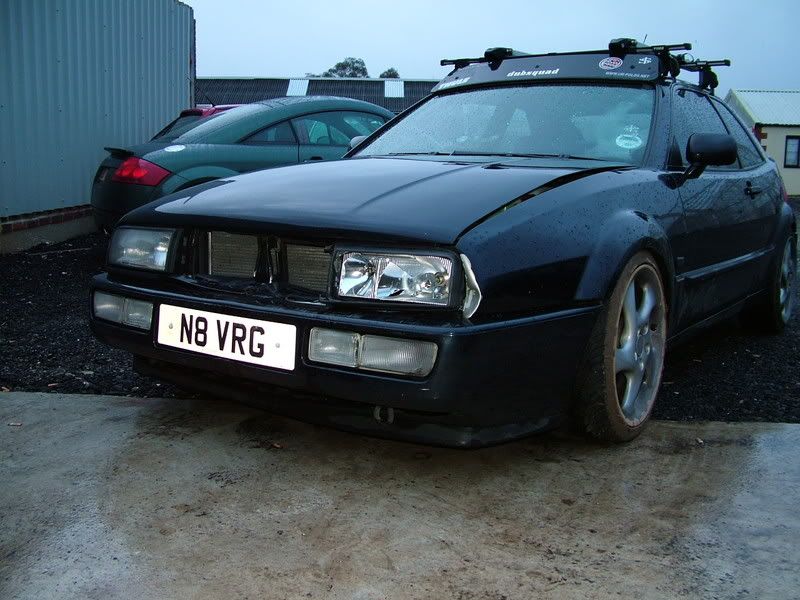

TheWizardofOdds 0 Posted December 21, 2010 I had an accident 3 days ago about half three am in severe ice and snow conditions on the way to work. Approaching a relatively gentle left hand bend and the back end lost grip and the car went 360 degrees hit a fence, hedge and wall. You wouldn't think the car has been off the road to look at it but on closer inspection underneath where the splitter(?) is, there's a fair bit of damage with the metal pushed right back, the steering is very heavy to maneuver left or right. Luckily I had my seat belt on and am OK but got a fright as the car went in to the opposite side where the oncoming traffic, which is usually heavy goods, wouldn't have seen me until the very last minute. I know we all have a go at times about the build quality of these cars but the front end took a hell of a lot of punishment and there isn't a scratch at the bonnet etc. where other cars might well have crumpled. The insurance company are collecting the car today, although they haven't inspected it yet it looks like it's odds on to be a write off. I take it they'll offer me a desultory sum if this goes to settlement? 119k on the clock with the car not exactly in showroom condition. :( Quote Share this post Link to post Share on other sites
Toad 0 Posted December 21, 2010 Hopefully it's just bumper, rad support panel etc. The power steering cooler is in this area so you might have crushed it resulting in the heavy steering. Get some pics of the damage up, & good luck! Quote Share this post Link to post Share on other sites

jamiehamy 0 Posted December 21, 2010 If you can get pics, will give us an idea how bad it might be. I've fixed things that looked awful, but actually were not. The main thing to find out is if the chassis legs are bent. If they are, it's going to be tricky tho. If not, it's all like a big mecano set. Where are you in Scotland? I'll be bored between Xmas and New Year anyway, so could lend a hand if not too far :) Quote Share this post Link to post Share on other sites
Kevin Bacon 5 Posted December 21, 2010 Doesn't sound too bad as everything at the front is replacable and unbolts, but have a look under the airbox and battery. If these chassis legs are buckled, forget it. Take the money and run! Quote Share this post Link to post Share on other sites
