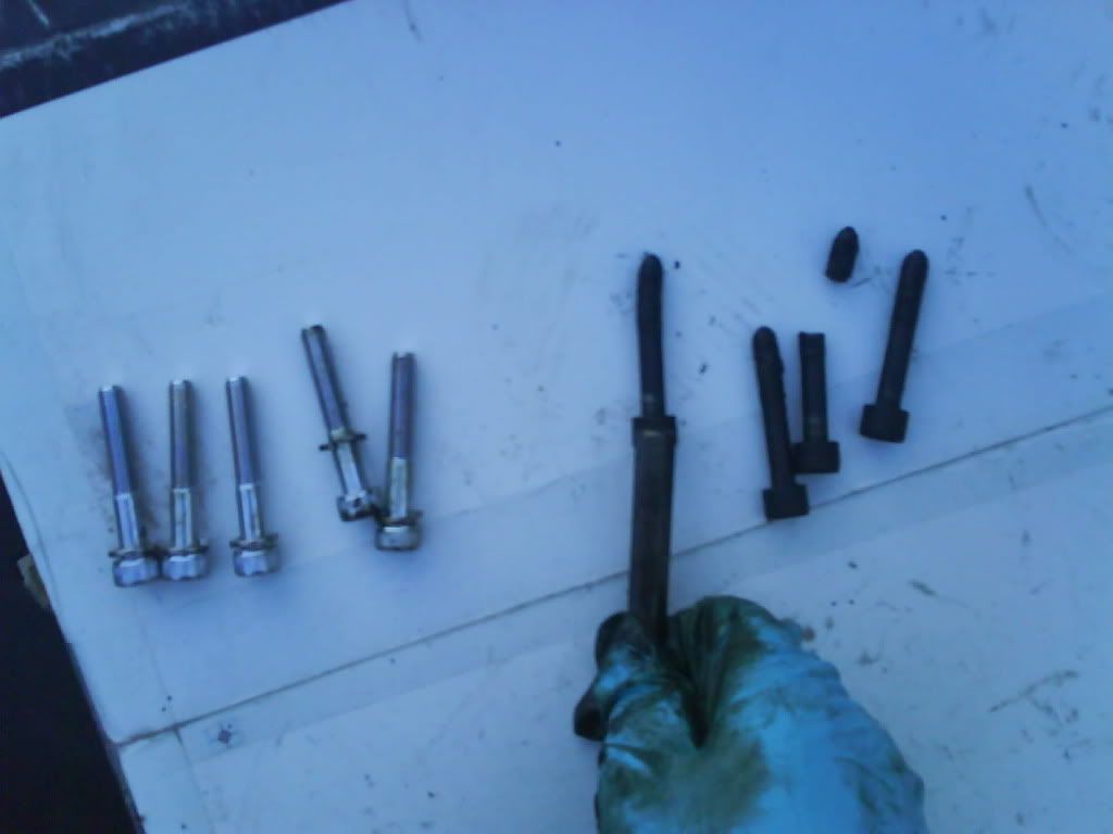

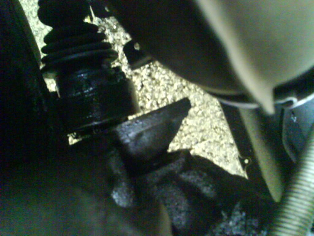

Swompy 0 Posted March 29, 2012 Well it looks like more than just a simple job of bolting it back on :( Need a new flange and inner CV. :? I'll let the pic do the talking!! [ATTACH=CONFIG]57461[/ATTACH] [ATTACH=CONFIG]57465[/ATTACH] Nothing is ever simple Quote Share this post Link to post Share on other sites

Swompy 0 Posted April 1, 2012 Well the car is now fixed :cheers: Big thanks to Graham for offering to come down and give me a hand fixing it (in others words I was stood there watching). Specially coming down so early on a Sunday. Put another drive shaft on with new CV joints too just be on the safe side. After we (he) got it off we found what caused the problem. Looks like the CV joint had disintegrated/exploded as the casing was broken into peaces and all the ball bearings were missing, which caused the bolts to de-thread the flange. As all ways the car does a "proper job" of destroying itself! Im sure there should be bearings in there :scratch: :camp: [ATTACH=CONFIG]57645[/ATTACH] Going to spend the day putting the new wheels on and putting the interior back in, so lets try again for next Sunday now. Quote Share this post Link to post Share on other sites
