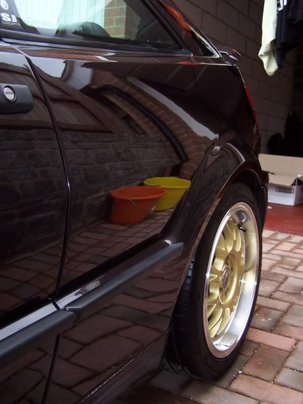

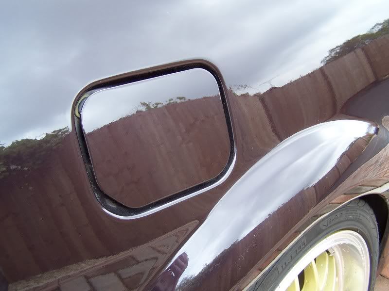

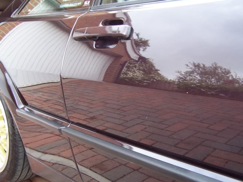

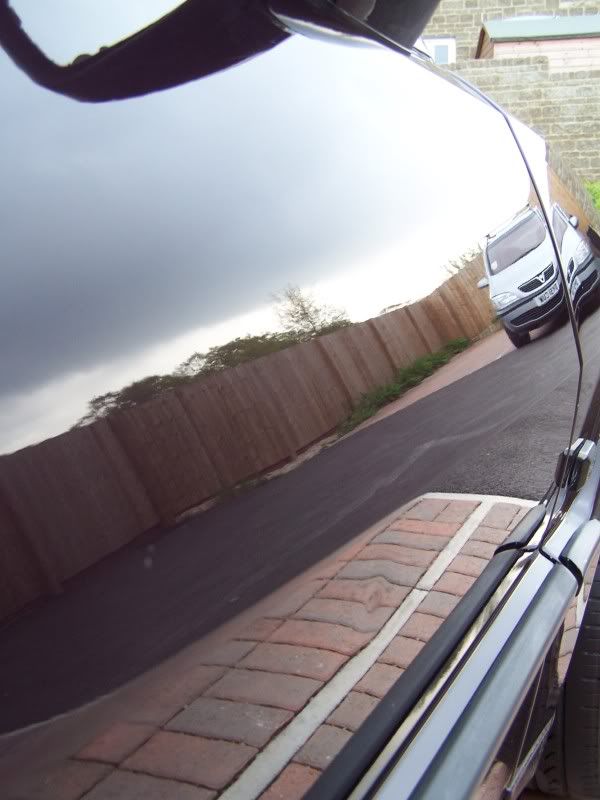

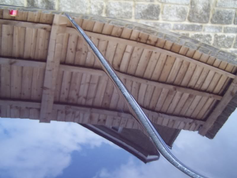

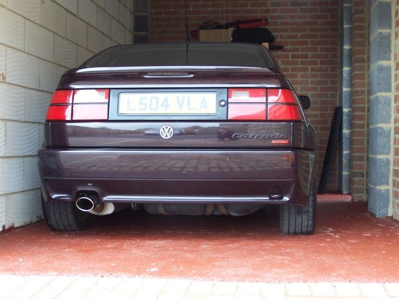

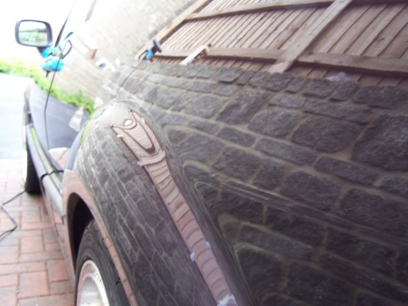

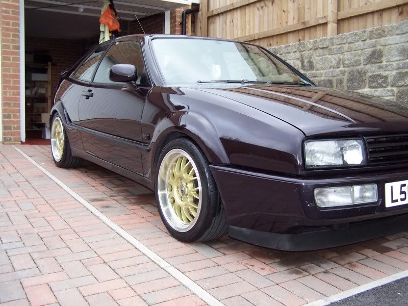

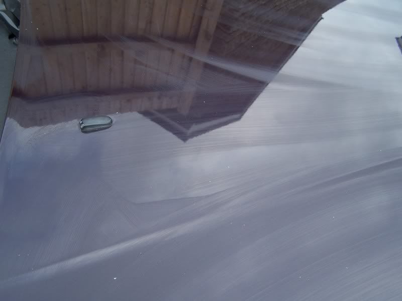

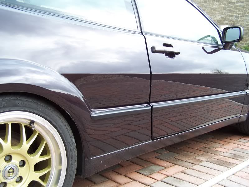

Swompy 0 Posted May 28, 2012 The results after I hand polished the whole car After some Poorboys - black hole Sealant on and waiting for it to cure And the results after 2 coats of Collinite 476 and a soft Turtle wax Tucked up ready for the long drive the next day This pic just goes to show how useful the two bucket technique is as the orange bucket is the wash bucket. Quote Share this post Link to post Share on other sites
vornwend 0 Posted May 28, 2012 Looks really good Jake. Will have to pick your brains on polishing when you're at Volksfest Quote Share this post Link to post Share on other sites
lilfuzzer 1 Posted May 28, 2012 nice dude what polish did you use with the machine polisher? Quote Share this post Link to post Share on other sites
Swompy 0 Posted May 28, 2012 Thanks guys :) I used meguiars speed glaze and finishing pad. The lightest cut combo I could use as I know the paint work isnt think so didnt want to take too much off. And as I was packing the polisher up I noticed it has a speed setting on the very bottom. So I done the whole car on speed setting 1 :bonk: might of had better results if it was on a faster setting. O well next time I will find out. Quote Share this post Link to post Share on other sites
lilfuzzer 1 Posted May 28, 2012 Na looks nice always tempted on a machine polisher Quote Share this post Link to post Share on other sites

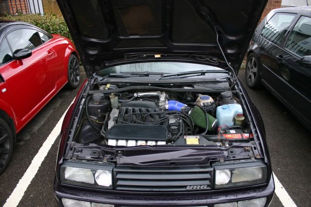

Swompy 0 Posted July 1, 2012 Im pretty gutted by the bhp tbh, might have to get it on some different rollers to see if it gives a similar result. I defo need to get the induction sorted. I have a bmc to put on but not sure if I want to or not as I think it might restrict the engine and make me loose more power. ( a skyline today did a before and after with a similar kit and lost 30bhp with it fitted!!!!!) I have some pipping I can use for a cold air feed but think I need to do a bit more than cold air ducting. Any suggestions? pic to give you an idea of the space I have to play with Quote Share this post Link to post Share on other sites
captainredeye 0 Posted July 1, 2012 Could you move the battery then shield the area off from the radiator to give you space for some cooler air to be sucked in. I was wondering when you were going on The rolling road love to know what mine is putting out or isn't. Quote Share this post Link to post Share on other sites
bristolbaron 11 Posted July 1, 2012 Ah, where was the rolling road bud? Wouldve loved to have brought mine along! Quote Share this post Link to post Share on other sites
Swompy 0 Posted July 1, 2012 It was in Gloucester Baz. Forgot to say I got my cloths, thanks for that :D I want to move the battery but dont know how much work is involved. Quote Share this post Link to post Share on other sites
swampy 0 Posted July 1, 2012 I'd certainly be looking at getting more cold air to the filter, can you duct some in from the bumper?? As for battery relocation, it's not hard to do is there anything else fitted to the battery box to stop you moving it?? I have supplied a few kits for French cars and on e38 for doing it, new power cables, earth cables and a junction box. Then need a battery box for the boot to secure the battery in Quote Share this post Link to post Share on other sites
20vtvw 0 Posted July 1, 2012 that tourque is great! have you had it mapped yet? bhp on these with a map is usually only 220ish so if yours isnt mapped its not too bad ,i have moved my battery to the boot and was very easy to do,do that then cold air feed ,not long now before my dbp 24v will be on the road... Quote Share this post Link to post Share on other sites
Swompy 0 Posted July 1, 2012 I'd certainly be looking at getting more cold air to the filter, can you duct some in from the bumper?? As for battery relocation, it's not hard to do is there anything else fitted to the battery box to stop you moving it?? I have supplied a few kits for French cars and on e38 for doing it, new power cables, earth cables and a junction box. Then need a battery box for the boot to secure the battery in I am looking into getting more air to it, my friend is giving me some ducting pipping. Only problem is the rad is right in the way as well as the battery. Only place I could get decent air flow is if I stick the ducting under the rad but then its pretty much on the floor then. So the best option is to move the battery either to the other side of the engine bay or the boot. I had a power lead for my sub attached to the battery and thats it apart from the usual stuff How much are the kits? that tourque is great! have you had it mapped yet? bhp on these with a map is usually only 220ish so if yours isnt mapped its not too bad ,i have moved my battery to the boot and was very easy to do,do that then cold air feed ,not long now before my dbp 24v will be on the road... I am really chufft with the torque graph nice and steady curve. Every one there was surprised at how quick the torque came in and how well the engine held the power. It does have a map on it but cant remember what one, but I think it only changed the throttle response and not much els. They guys there said it was running rich too. :scratch: I just cant work out why its made less bhp when it has de-catted exhaust system, map (of some sort) and the induction cone. I'm starting to think the map might be the culprit now! Quote Share this post Link to post Share on other sites
swampy 0 Posted July 1, 2012 Price on the kit depends in what parts you want, battery cables, earth cables , junction box etc for a full set up your looking around £60 Im not that clued up on the car, the lower lights can you remove the inner passenger one and get a duct in there to scoop air up to the filter?? Once the battery is removed of course Quote Share this post Link to post Share on other sites
Swompy 0 Posted July 1, 2012 once the battery is moved I'm sure there is space to get ducting there. Even if I have something like this once the battery has been moved I think it would make a big difference http://www.ebay.co.uk/itm/VW-Golf-mk4-A3-Air-intake-heat-shield-open-cone-shield-cupra-/130720488964?pt=UK_CarsParts_Vehicles_CarParts_SM&hash=item1e6f8c5e04 Quote Share this post Link to post Share on other sites
swampy 0 Posted July 1, 2012 Yes that could help, or something along those lines BUT I'd be looking at something made from plastic and then covered in that silver heat protection stuff to reduce the temps I prefer to use a standerd air box with a panel filter,y 406 v6 is running circa 220bhp with just a free flow exhaust and panel filter , now has a few more mods Cold air feed from front bumper, custom ground earthing kit Ptfe gasket on throttle body and inlet manifold Tb has being opened up and the majority of the step to the butterfly removed Tb and inlet manifolds all port matched Car certainly feels quicker , need to get it on the rollers and hope to see around the 230bhp mark Quote Share this post Link to post Share on other sites
