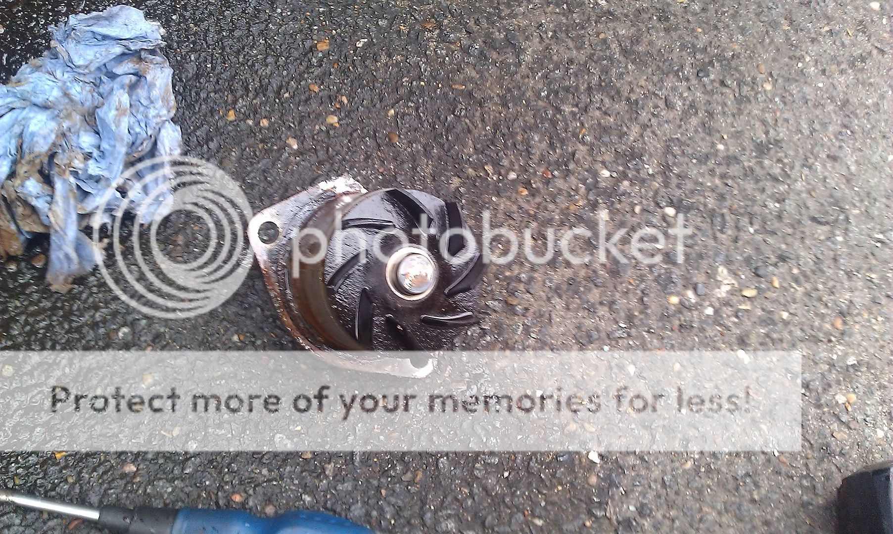

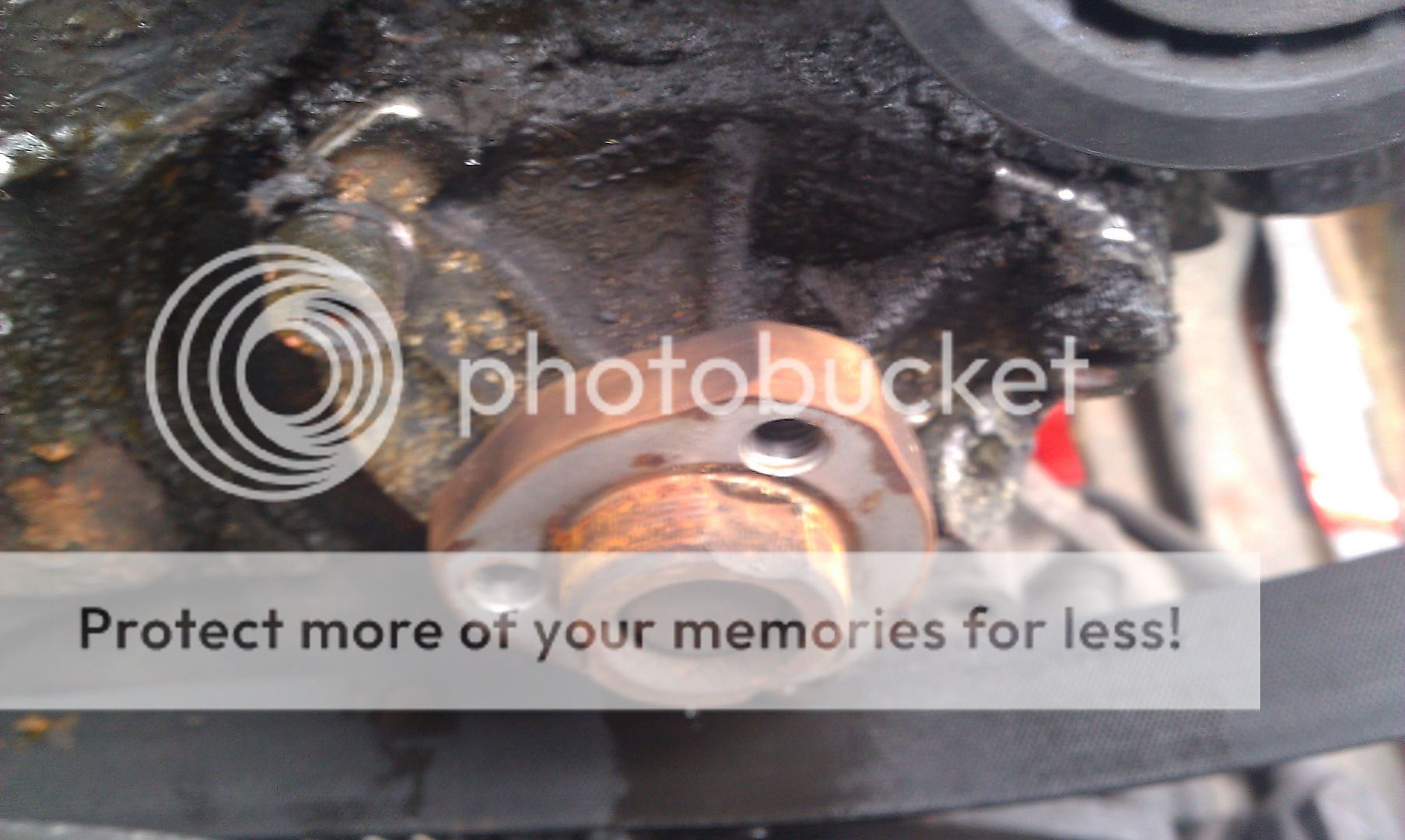

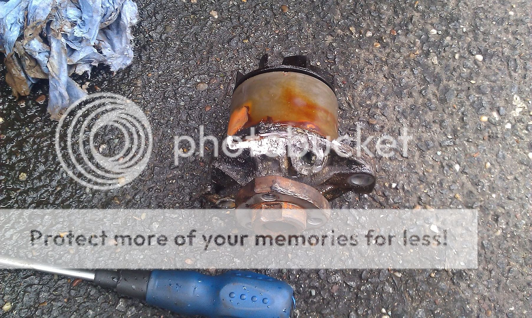

tony_ack 0 Posted March 26, 2011 I had a revalation whilst lying in bed this morning - it dawned on me that the car was leaving the water patches on the driver's side, and not on the passeger side, which was where the radiator leak was. The plan today was to clean the car and then head off to my folks, before heading to Wales on Monday on holiday. I thought I'd better check to see where the leak was coming from, just to put my mind at ease. I noticed the patch was under the water pump, and the frame under the water pump was dripping. It all makes sense now - the leak which I assumed as a weep of oil on the driver's side of the engine, was actually a mix of coolant and grime. The squeak of the belts and pulleys was probably the coolant interfering with the operation of the aux belt. I quickly realised that the car would be lucky to make it to my folks' 50 miles away, let alone a 500 mile round trip to Wales. I had to cancel my plans. A nice relaxing day in the pub with the family and friends would give way to a day at the lockup yet again. I headed to GSF as soon as it opened for the pump, and opted for the more expensive of the two on offer. I checked and it had a metal impellor. A VW one would have been better, but options are limited on a Saturday morning. Once at the lockup, I checked the water again - it had used half a litre in about 10 miles - it was getting worse. I wasted no time stripping down the front end again - I decided to change the radiator at the same time. It's amazing how easily it all comes off when you know where all the bolts and screws are, and you don't have to deal with seized bolts. 30 minutes later, I had a naked VR With the radiator off, it was pretty easy to spot the damage. Other than this the radiator was fine, such a shame that it's scrap now Next I turned my attention to the water pump. I did the front mount last week, so the bolt for that came out easily. The rear mount was a bit more tricky. I took the airbox and pipe off for easier access, but I didn't have an extension long enough to clear the bay. Luckily I had just enough room to crack the nut loose, and with a little more perseverence, it was off. I jacked up the engine to give me access to the water pump. Out in the open, the leaks were all too obvious. The pulley came off easily enough, and the bolts for the pump weren't a problem. However then I hit my first problem of the day - the pump had somehow managed to seize itself into the block! I tried to get a hammer and chisel behind it to chisel it off, but just ended up breaking the pump casing. Next I tried cutting into the casing to get better leverage, but soon realised that wasn't going to work. Finally I decided to throw caution to the wind and just hammered away at the pulley bracket. Slowly it started to tease out, and eventually it was free Old pump The impellors were pretty good given they were plastic, and given the condition of the rest of the pump New pump now ready to go on I slipped a little bathroom sealant onto the o-ring just to be on the safe side. The pump in, bolts in, pulley on, belt on. Next I put on the new radiator - really straight forward, and it even came with the top elbow which I wasn't expecting! I also fitted a new VW fan switch. All went on okay (except I forgot to put the fans and rad cowling on the first time - d'oh!), and I was ready to start filling. Again, I put in about 2-3 litres of water first to make sure it was all leak free under normal pressure. Then I topped up with a couple of bottles of G12. Time for the big switch on! She started fine, and I let it run to temperature, while bleeding the system. Thermostat came on as normal. The fans were a bit late again, kicking in at about 100 degrees but I put this down to air in the system while I was bleeding. I had the radiator box under the car to collect any leaking coolant, and checked it when I switched off the engine. Not a drop!! Hurrah! Bleeding the system under Bentley's watchful gaze.. I put the front back together in no time, even put a bit of copper grease on the bumper bolts this time, and torqued them according to Bentley. She drove home fine. The whistling seems to have gone too now (I cleaned the belt and pulley while doing the water pump). Hopefully the cooling saga is now over! Quote Share this post Link to post Share on other sites

tony_ack 0 Posted March 28, 2011 Aide - I'm starting to think that the tensioner is fine now the water pump is fixed.I think the coolant was getting into the pulleys and belts causing slippage and squealing. so far the tensioner has been quiet since the water pump was done. I had considered just changing the bearing, but would have replaced the whole thing at the right price. £120 is not the right price though so I'll opt for a bearing replacement if it does need changing! VR_owner - Like most jobs on the Corrado, it could be really easy, but then you're stuck if you come across a seized bolt. When I took it all apart the second time,it took me about 30 minutes, as I knew where every bolt and screw was, and they all came out easy as they'd been out the week before. The first attempt took about 2 hours though, and to be honest I still didn't hit any major problems. The biggest two dangers with the job are the radiator bolts into the slam panel seizing/shearing, or the bumper bolts seizing. I was lucky with the bumper bolts as it looks like the bumper was replaced recently, but on both MK2 Golfs I've had, which has the same bumper set up, I've run into problems. For the radiator bolts, a dremmel will be useul to cut the bolts off if they give you trouble, and new bolts are pence from VW For the bumper bolts, I would soak them in WD40,or even better - Plusgas the night before to give them a chance of coming off. I have a 4 foot long 1/2" drive breaker bar to get the bolts loose, and a set of Irwins on standby. The biggest risk with the bumper is snapping the captive nut on the bumper bracket that the bolt screws into as you'll then need to access the nut while it is sill in the chassis leg. Once the rad bolts and bumper bolts are out, you're pretty much home and dry! Quote Share this post Link to post Share on other sites
