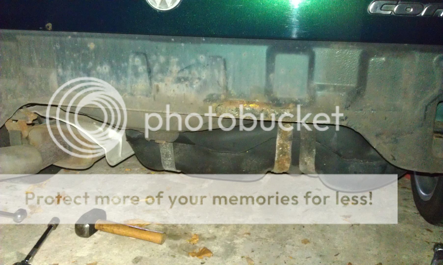

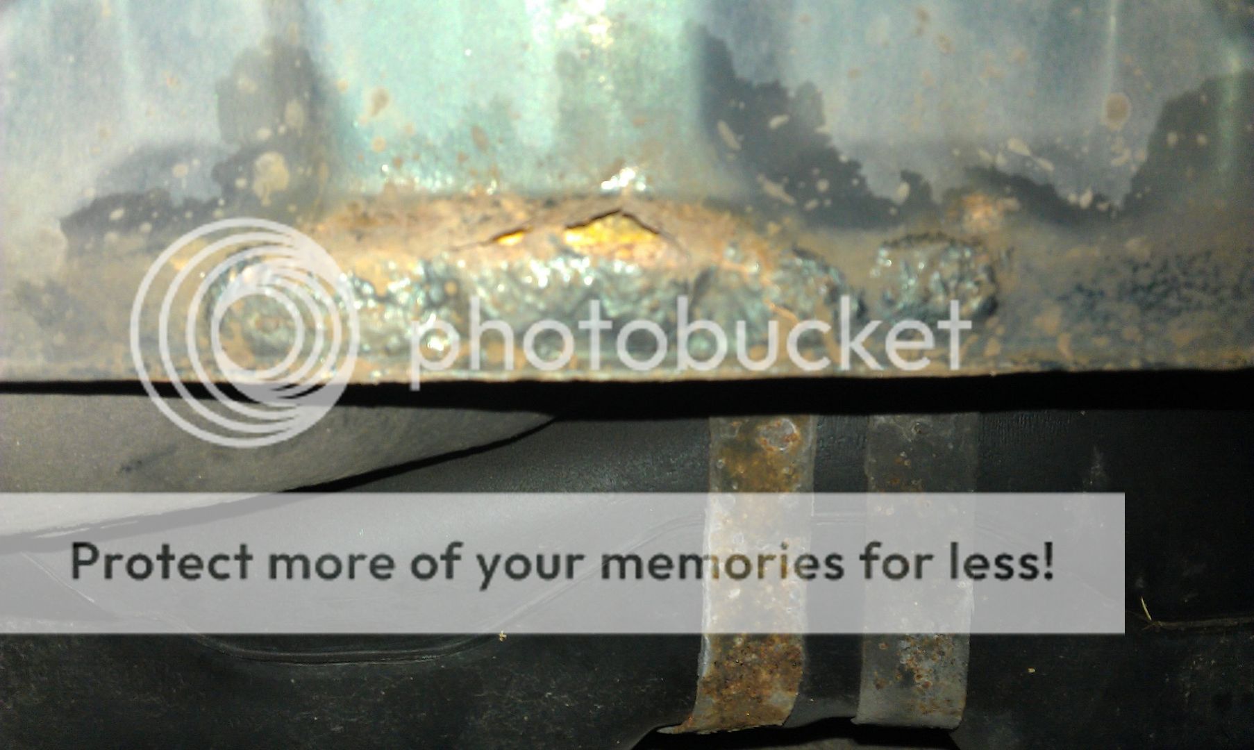

tony_ack 0 Posted December 5, 2011 More rust found at the weekend. To be honest, it's a rust hole that I knew about, as I'd already found it from the inside of the boot, but I guessed it would be a good idea to get the rear bumper off and have a proper look at the back panel. Like the rest of the car, the back panel is in decent condition (except for the hole). There is a fair sized bubble on the right rear quarter under the bumper, and a couple of rust spots on the visible part of the back panel, but they appear to be isolated. Not too sure what caused the rust hole. It's on the seam, but in a bit of an odd place, so I suppose it could be put down to bad sealing at the factory? The rust hole is going to be repaired at the bodyshop with some new metal to be welded in. Quote Share this post Link to post Share on other sites

VW_OwneR_85 2 Posted December 5, 2011 (edited) mine was going in that area but a little to the left but no where near as bad as yours, seems like i got it just in time, aww edit, no it didnt lol thought it was in a different place, lol where you have that little bubble to the left of the vw badge, mine also had that which turned into a 10p hole also along the lower edge thats where i had slight surface rust comming through which sanded out a treat. Edited December 5, 2011 by VW_OwneR_85 Quote Share this post Link to post Share on other sites
tony_ack 0 Posted December 5, 2011 Damn I'll get the bodyshop to look at the rust spot near the badge too in that case! To be honest, it was one of the bits that was going to be sorted anyway... if they have to do some welding near the seam, then it shouldn't be too much hassle if they have to weld a bit under the rust spot. Looks like it might be a back panel respray thoguh :-( Quote Share this post Link to post Share on other sites

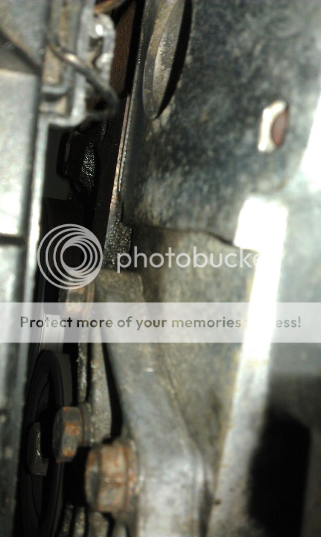

24V Renshaw 0 Posted December 11, 2011 Its often one step forward two steps back with a rado, but i always look at is as three jobs done in the end :) Is the leakage not from the rocker cover gasket? It's common down that side of the block... Jay Quote Share this post Link to post Share on other sites
tony_ack 0 Posted December 11, 2011 Here's a pic, but it is quite hard to see down there with a camera I don't think it's from the rocker cover gasket - it just doesn't seem to be coming from there and it was replaced with a VW item about 6 months ago. The only other thing could be the water pump, but it was done about 8 months ago. Perhaps (wishful thinking) it is old leakage from before the rocker gasket was changed? There are absolutely no other signs of HGF, though looking at the invoice for the chains that were done about 30k miles ago, there is no mention of replacing the head gasket which is ominous. That said, I don't think it'll be on its original head gasket at 222000 miles Quote Share this post Link to post Share on other sites
fla 9 Posted December 11, 2011 looks like a previous mechanic did not clean up properly. Could also be an oil drip from the PCV valve, or the flexi from the air filter. Wipe it up and see if it comes back Quote Share this post Link to post Share on other sites
24V Renshaw 0 Posted December 11, 2011 I reckon thats left overs from the rocker cover gasket. As suggested, clean it up a bit and see what comes back. This is the reason while I had the chance when I had the front end off I cleaned the block up etc.. Had an oil leak over the last couple of days and could smell it burning on the exhaust, but the actual source was the oil pressure switch on the front of the block, would have been very hard to tell if it was all filthy still. Jay Quote Share this post Link to post Share on other sites
