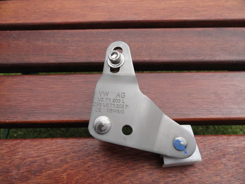

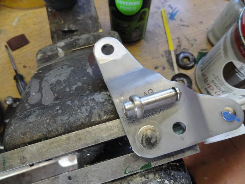

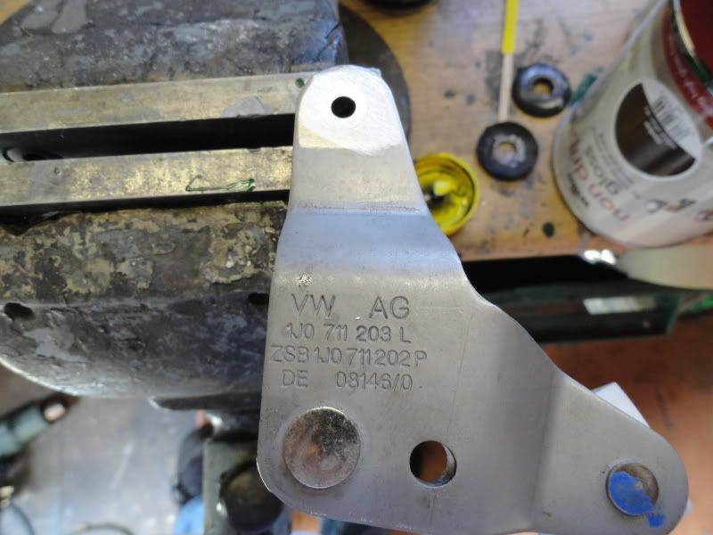

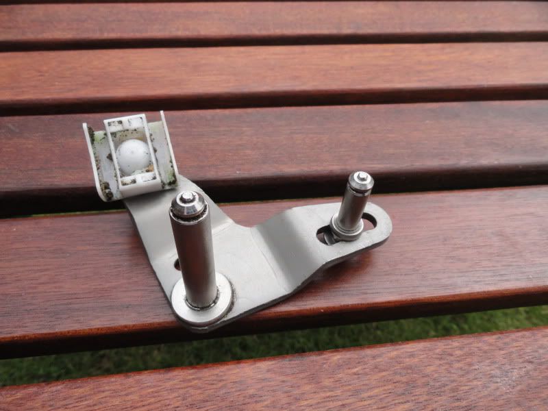

steveo29 0 Posted November 29, 2014 i found mine was too far travel side to side heres what i did to make it ajustable grind off the weld so you can remove the pin drill down the pin so you can tap threads into it file a slot where the hole was- bingo ajustable side to side movement Quote Share this post Link to post Share on other sites
Sean_Jaymo 0 Posted November 29, 2014 You've done a neat job with that! Quote Share this post Link to post Share on other sites
