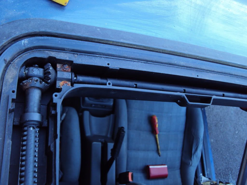

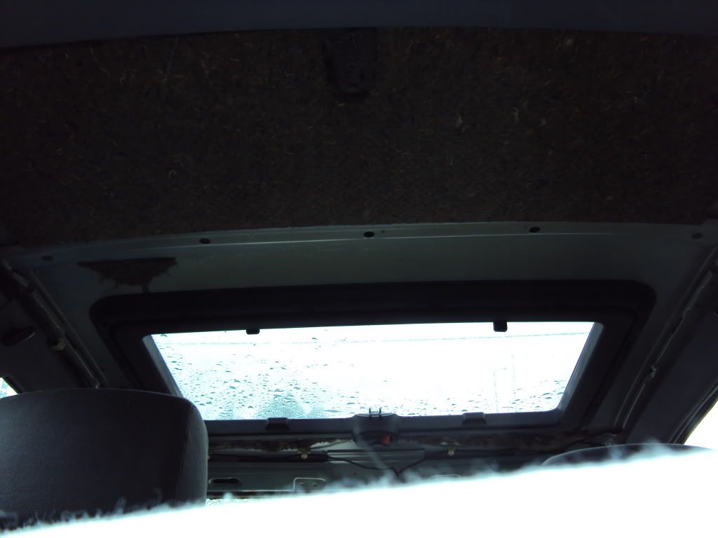

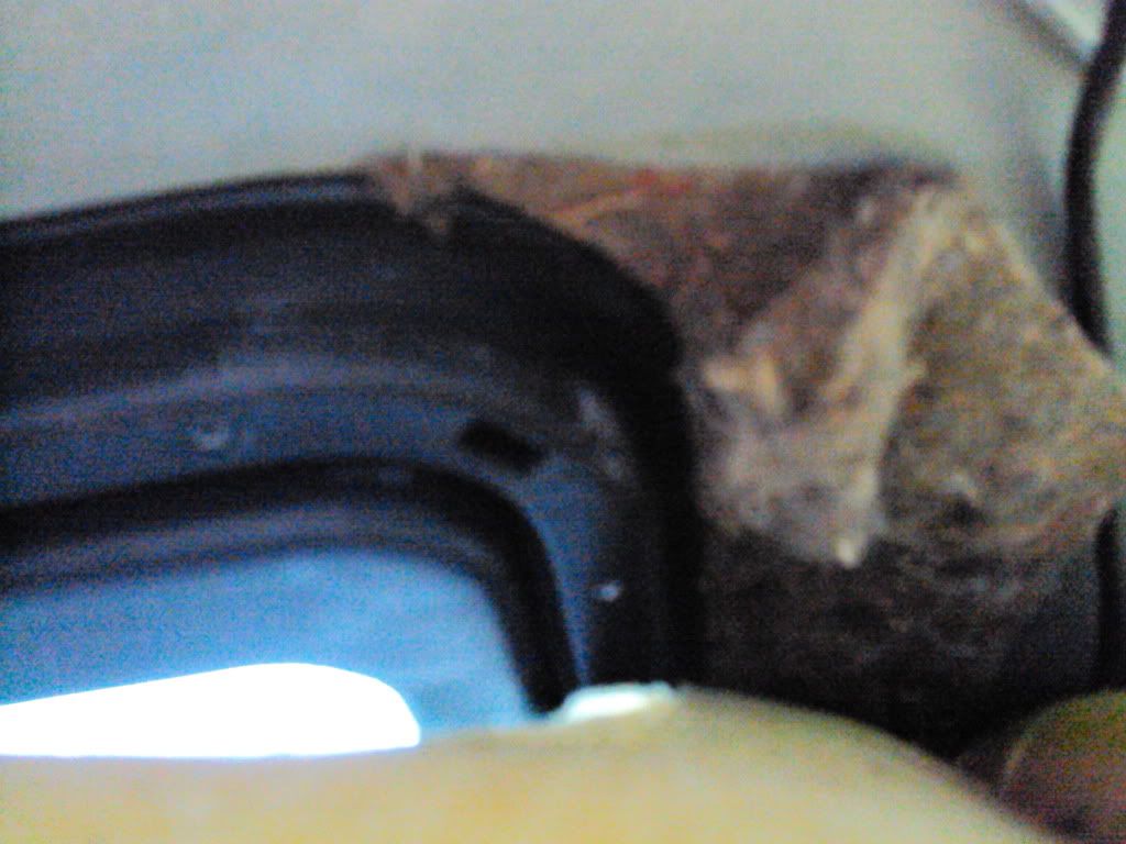

j90ny 10 Posted June 11, 2011 Thanks for the reply. Here is the front drivers side under the headlineing And heres from above i took the mech out thinking that there would be a hole underneith but nothing :shrug: (sorry for the size and quality it was getting dark) Quote Share this post Link to post Share on other sites
Yandards 0 Posted June 12, 2011 The drain holes can be seen from the top of the sunroof cassette looking down and you will find them in each corner as already mentioned. Wire coat hanger or some air pressure usually shift out the obstructions. You will find the other end in the front wheel arch behind the liners and the rear ones live at the leading edge of the rear bumper, just look for black rubber rubes. Quote Share this post Link to post Share on other sites
j90ny 10 Posted June 12, 2011 Sorry to sound stupid as hell but what bit is the sunroof cassette ? Also i have given the whole sunroof a good clean out with the air line. Thanks for the help so far though Quote Share this post Link to post Share on other sites

j90ny 10 Posted June 12, 2011 Ah dragon green thats excellent when i get a chance i will get the bumper off and have a look. Ive got the headlining out now would they not run along the top there ? Thanks jon Quote Share this post Link to post Share on other sites
