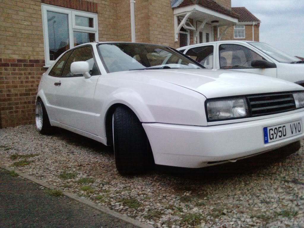

Swompy 0 Posted July 1, 2011 Looks good any info on it Quote Share this post Link to post Share on other sites
robrado974 1 Posted July 1, 2011 Always liked the c in white , looks really nice as swompy says ,get some more pics and info up . Quote Share this post Link to post Share on other sites

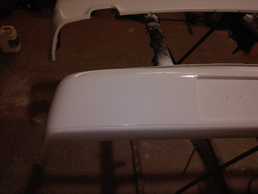

VW_OwneR_85 2 Posted July 1, 2011 looks nice m8 :) im liken the bumper, what have you done with your indicators? Quote Share this post Link to post Share on other sites

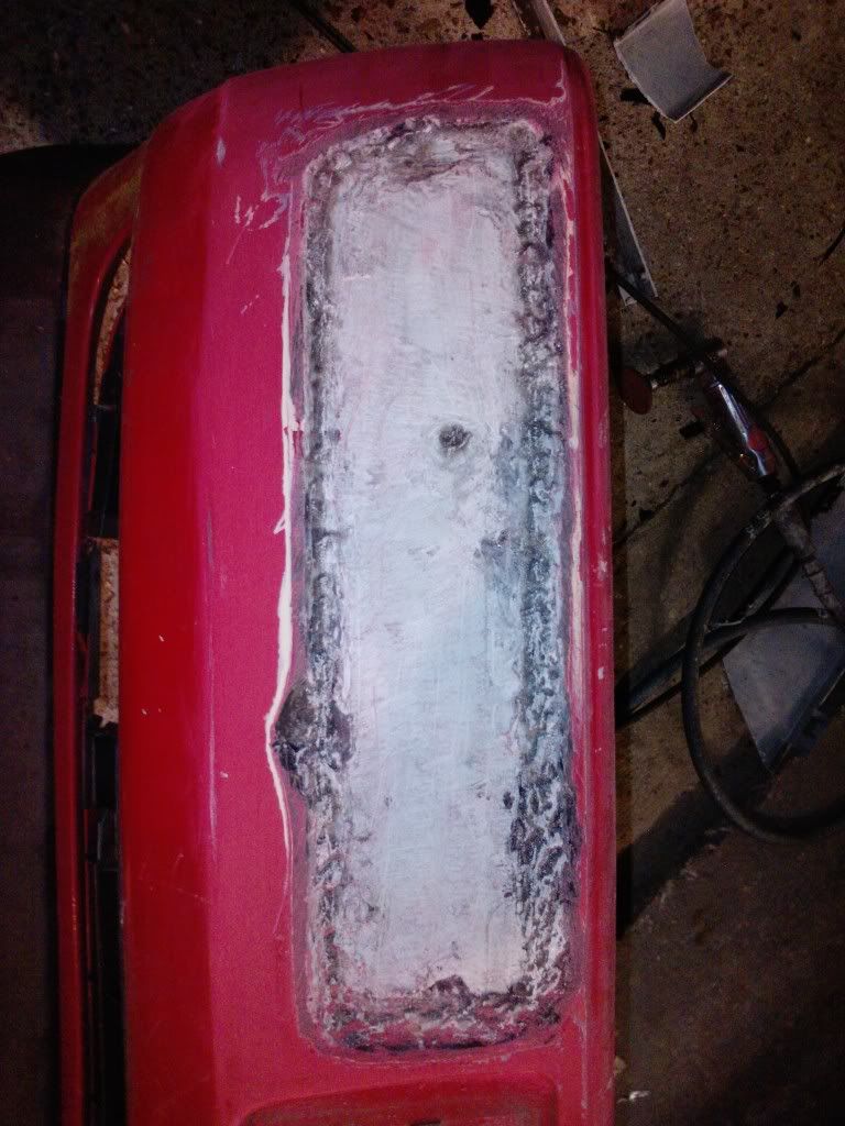

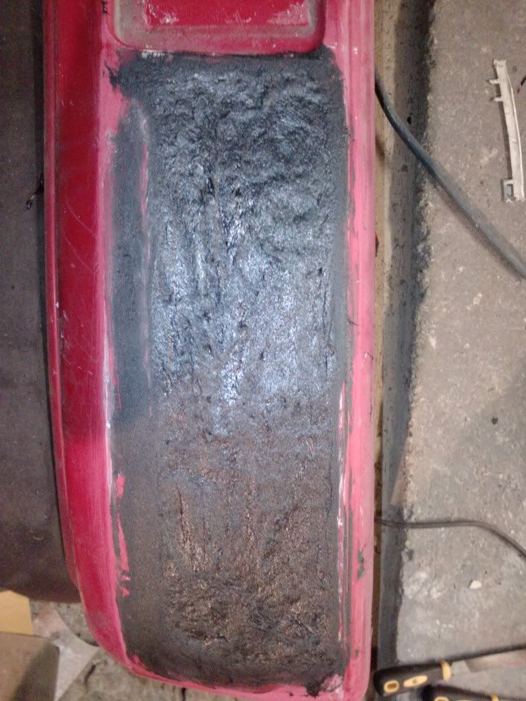

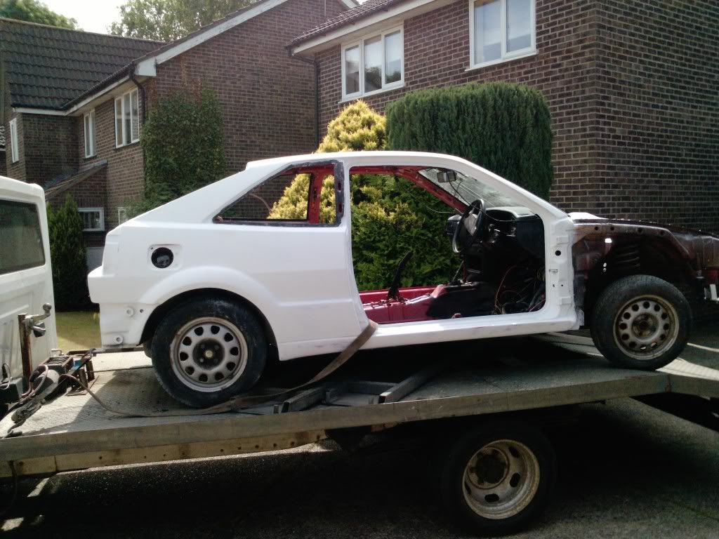

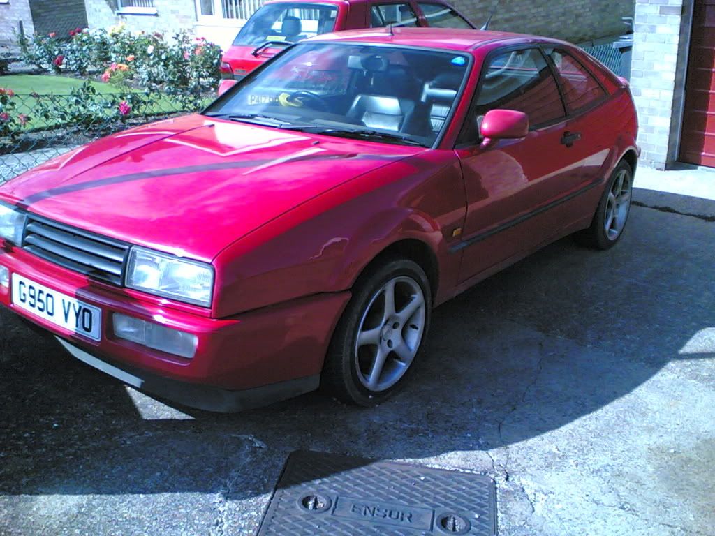

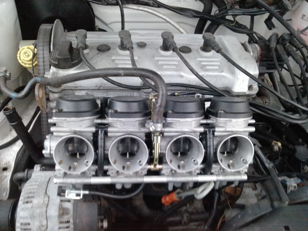

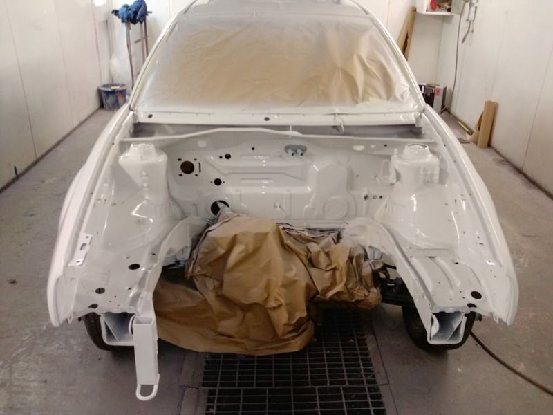

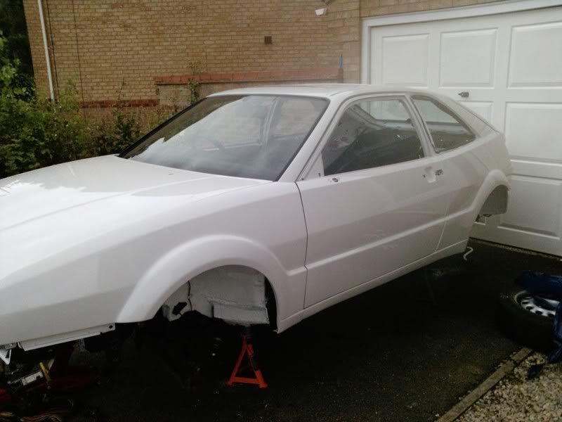

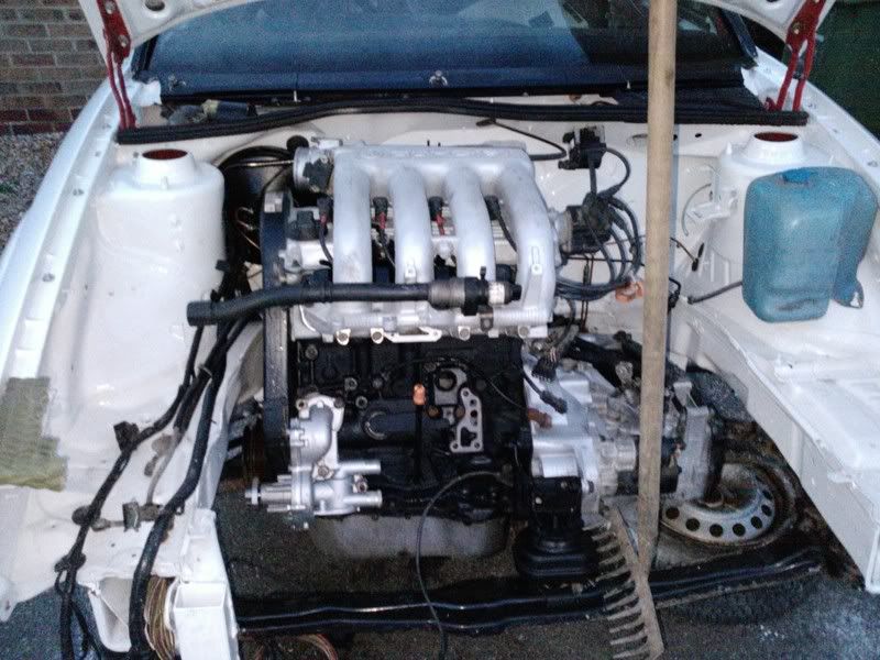

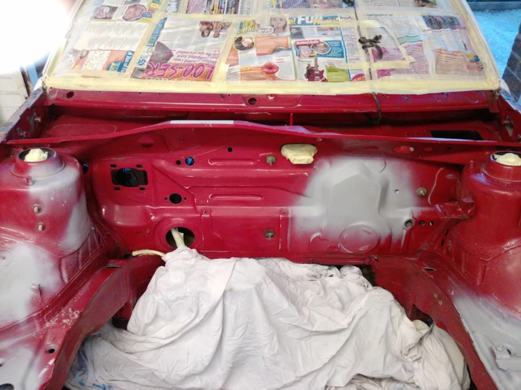

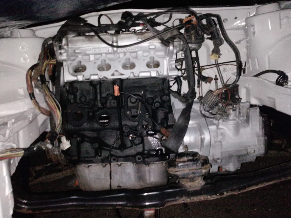

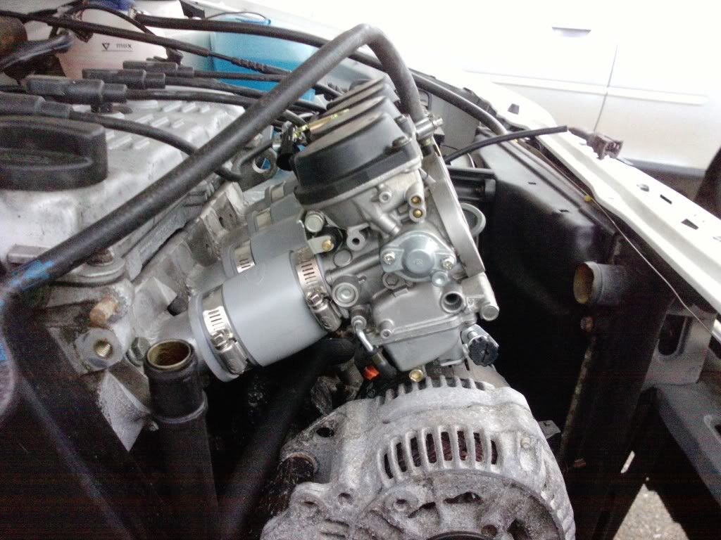

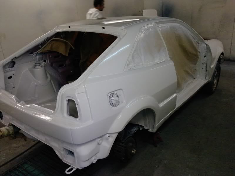

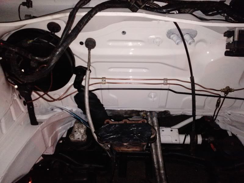

chrisb2.0 0 Posted July 1, 2011 thanks for the comments guys heres a rundown of what the c has been through its started life as a red kr corrado about 1 year ago then i started too rip it apart and start the build i was lucky it came with full leather interior which was a good start it was stipped down to a shell with the glass out for a full respray i plastic welded parts into the bumper to smooth of the front indicators then plastic filler then some primer i then got it back to my drive where i got all the pannels back on and started the rebuild process i sourced an abf engine with everything to go with it ecu wiring keys etc and put it in and got it all running i also had to get the corrado vr6 wings for the wide track and a vr6 buldge bonnet so the engine would fit. i then got board of the engine and wanted something different so i: i aslo got wide track running gear of a mk3 vr6 and the 288mm callipers and carriers with all new goodridge hoses and drilled and vented ebc discs. it got an mot as of last week and is now on the road to got to get on the rollers see what the carbs can do? as for the front indicators there led strips in the headlights now just to hide them. Quote Share this post Link to post Share on other sites

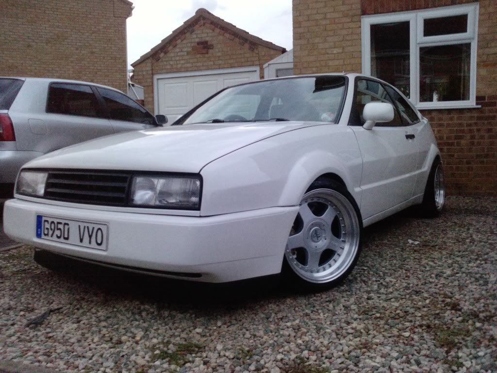

Swompy 0 Posted July 2, 2011 Wow defo a proper sleeper now. I like it :D Quote Share this post Link to post Share on other sites
krishen 2 Posted July 2, 2011 Very nice. Are you going to spray the bonnet hinges? Quote Share this post Link to post Share on other sites
CazzaVR 0 Posted July 2, 2011 Good work- looks stunning! 8) Quote Share this post Link to post Share on other sites
daves16v 1 Posted July 2, 2011 Agreed - total dedication. Quote Share this post Link to post Share on other sites
odub 0 Posted July 2, 2011 this looks great, keep at it Quote Share this post Link to post Share on other sites
v8rumbler 0 Posted July 2, 2011 Wow that looks great. White is the new black you know!!! Sent from iPhone 4 using Tapatalk Quote Share this post Link to post Share on other sites
