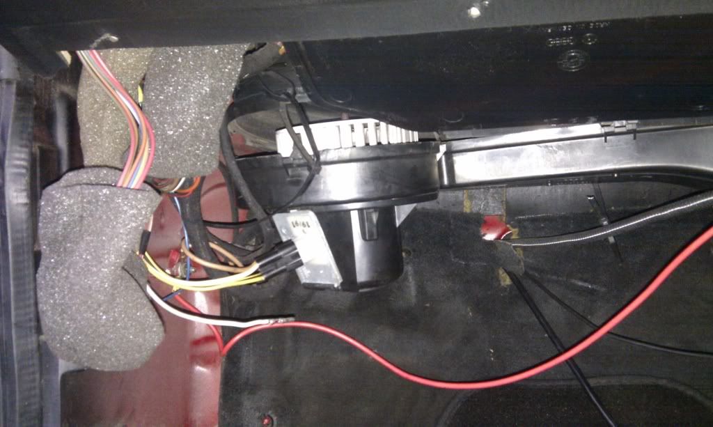

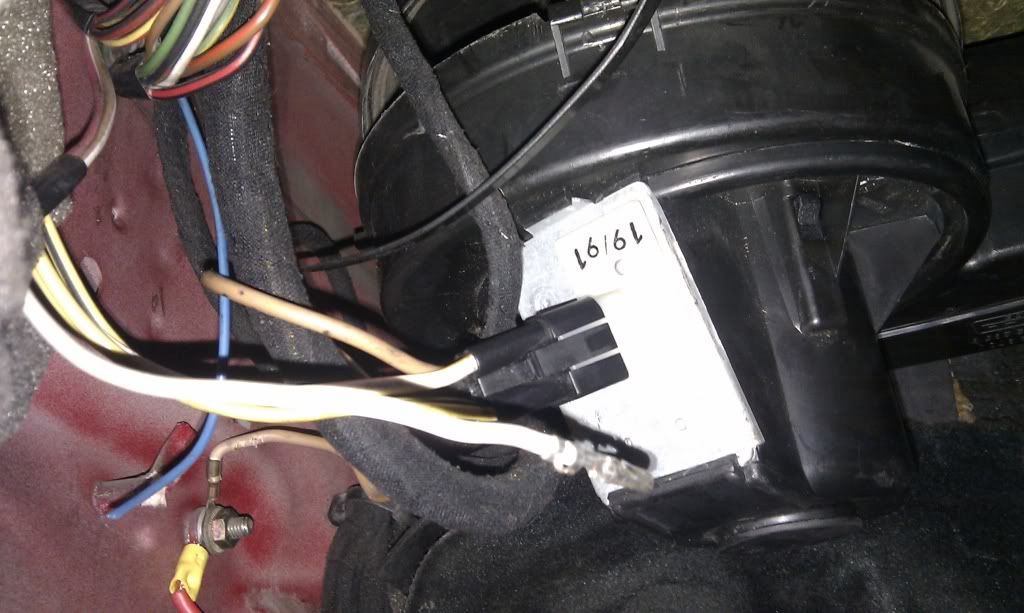

t700bes 1 Posted August 2, 2011 Wahoooo its fixed.. I took some photos so i'll post tommorrow, but the plug that goes tot he motor is a bit crap and wasn't on properly (its cracked). I black taped it on properly.... and also black taped a loose earth that was freely wigling around behind there... :) 1 new fuse, it didn't blow :) Quote Share this post Link to post Share on other sites

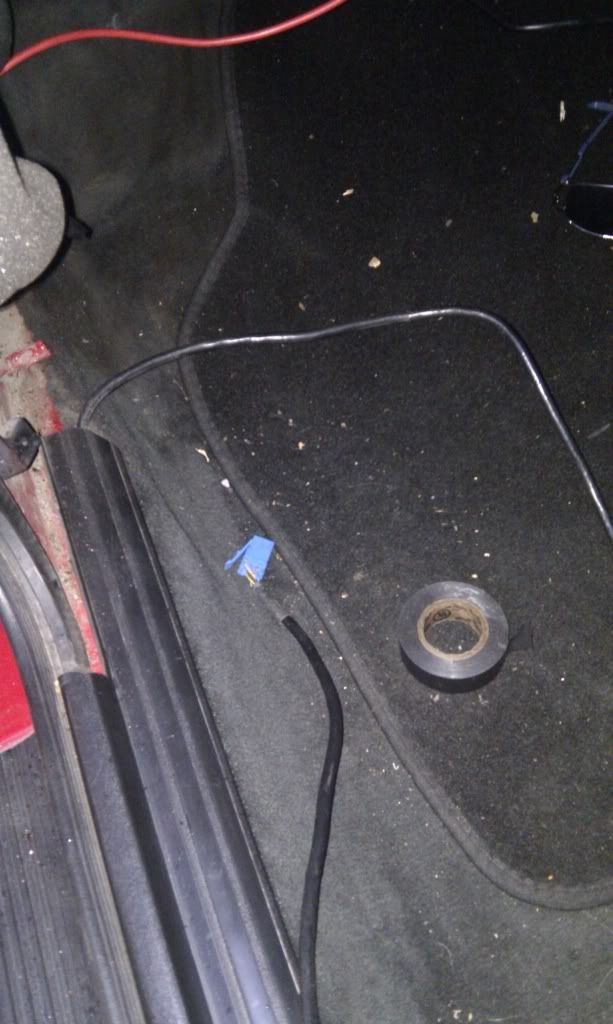

t700bes 1 Posted August 3, 2011 Its still not very warm, and not very powerful on the blower, so it might be worth replacing the motor and the heater matrix at some point :) ---------- Post added at 10:08 AM ---------- Previous post was at 09:47 AM ---------- Bodged!!! ---------- Post added at 10:09 AM ---------- Previous post was at 10:08 AM ---------- So i've cleaned up the terminals and taped the blower up to there is no gap... I did find this cable, and I don't know what it is or where it goes (it comes from the back of the car down the drivers side door Quote Share this post Link to post Share on other sites
