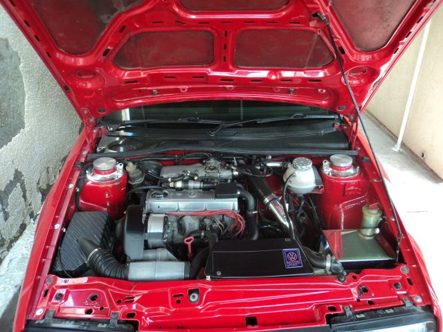

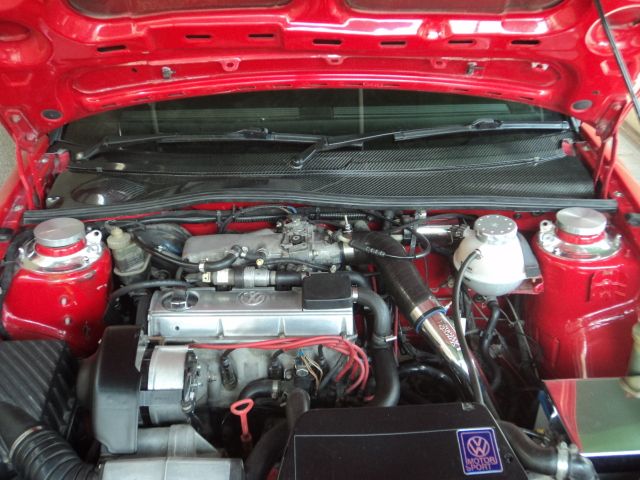

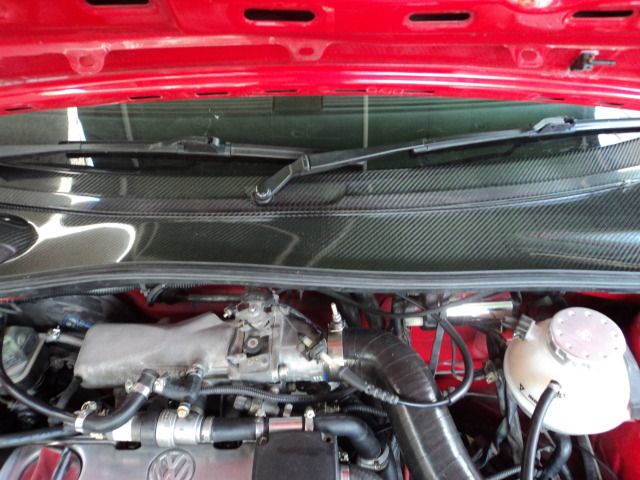

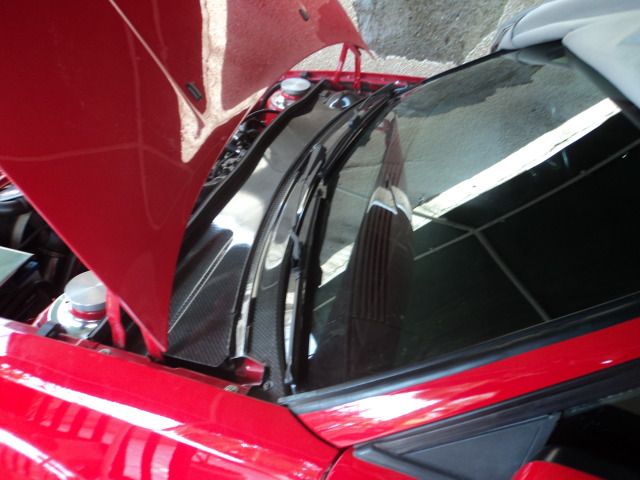

dragon green 6 Posted March 4, 2012 Fitted my c/f screen scuttle and my c/f & Kevlar raintray, The scuttle doesn't need much explaining,just make sure you have some of these at hand, Part number 535881089 Raintray isn't so straight forward,but not difficult, the wiper bracket needs slightly modifying as Eddie has shown The cover over the heater motor needs adapting,I did this in situ ! Before After The raintray now fits,to keep it in place I cut some of the clips in half and fixed the tray ready for the rubbers ! A few pics all put back together, No grinding of the scuttle panel to get your TT wipers to fit,unlike the originals ! They are top quality components,they fit very well. And they not only tidy up under the bonnet,but are functional as well. The only problem I had is the bonnet earth strap wasn't long enough in its original fitment.! Really pleased with mine,sorry about pics,blame it on the inclement weather ! Quote Share this post Link to post Share on other sites

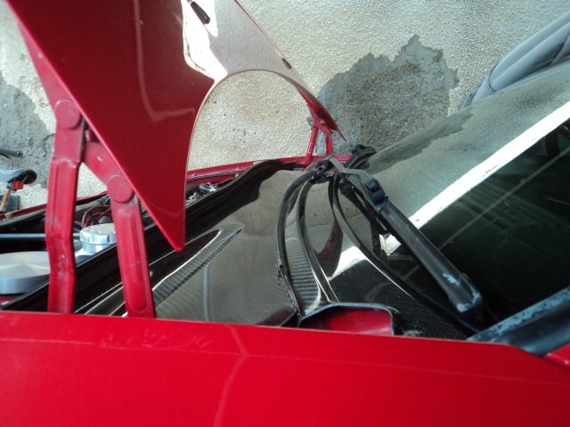

Stonejag 10 Posted April 1, 2012 (edited) Well, my windscreen trim fit fine (though the top edge doesn't sit very flush with the screen), but the scuttle cover just won't go :( I can only get one of the rubber trim pieces on as the curvature of the panel is totally wrong - the rubber isn't strong enough to hold it into place against the natural curve of the fibreglass. Here's the left side as it wants to sit with the lower rubber trim fitted: and the right side: If I apply pressure the right side matches up closely enough that the rubber trim piece holds it together: ...but the left side is way off! Attempting to squeeze the gap shut just makes the fibreglass squeal so I stopped - felt like the lip at the edge was going to snap off. Is there something obvious I've done wrong? Not at all impressed as it stands so far :( Stone Edited April 1, 2012 by Stonejag Quote Share this post Link to post Share on other sites
dogger 10 Posted April 1, 2012 Look at Bryan's post earlier. Dragon Green. Use the metal clips that were originally on the OE windshield trim and cut the extra tab off. Slide a few of them over the two lips and than slide to rubber seal over. You might need to open up the seal more by using a flat head screwdriver. Did you grind the corner of the metal wiper bracket? Eddy.h posted a pic on this thread earlier showing where it needs to be trimmed. ---------- Post added at 6:28 PM ---------- Previous post was at 6:26 PM ---------- dragon green said: Fitted my c/f screen scuttle and my c/f & Kevlar raintray, The scuttle doesn't need much explaining,just make sure you have some of these at hand, Part number 535881089 Raintray isn't so straight forward,but not difficult, the wiper bracket needs slightly modifying as Eddie has shown The cover over the heater motor needs adapting,I did this in situ ! Before After The raintray now fits,to keep it in place I cut some of the clips in half and fixed the tray ready for the rubbers ! A few pics all put back together, No grinding of the scuttle panel to get your TT wipers to fit,unlike the originals ! They are top quality components,they fit very well. And they not only tidy up under the bonnet,but are functional as well. The only problem I had is the bonnet earth strap wasn't long enough in its original fitment.! Really pleased with mine,sorry about pics,blame it on the inclement weather ! Read please... Quote Share this post Link to post Share on other sites
Stonejag 10 Posted April 1, 2012 dogger said: Read please... There's no need for that thanks, I did read it. You can tell I ground the wiper bracket down because the area that doesn't fit is on the opposite side! I rerouted the bonnet ground strap to give more clearance. I don't have many clips, how many do you recommend to keep the windscreen trim in place? I used six or so because without them it wasn't sitting right. Quote Share this post Link to post Share on other sites
ZNick 0 Posted April 1, 2012 (edited) Stonejag said: There's no need for that thanks, I did read it. You can tell I ground the wiper bracket down because the area that doesn't fit is on the opposite side! I rerouted the bonnet ground strap to give more clearance. I don't have many clips, how many do you recommend to keep the windscreen trim in place? I used six or so because without them it wasn't sitting right. ^^3 clips ;) Fitted the upper rubber seal too today You have to open it up a bit (the rubber seal) in order to fit ;) Edited April 1, 2012 by ZNick Quote Share this post Link to post Share on other sites
dogger 10 Posted April 1, 2012 I can't tell that you ground it from your post, sorry. From your one picture showing the side with the wiper motor sitting up it appears that you didn't grind the bracket. It should not require 6 of the clips to hold the windscreen trim to fit. 3 or 4 at the most if you place them spread out. 3 of the clips should be perfect for holding the two flanges together. One in the middle and one on each end. Quote Share this post Link to post Share on other sites
