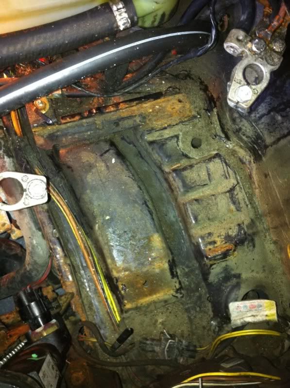

24V Renshaw 0 Posted September 18, 2011 So I have started to strip her down and was pleased to find the battery tray was solid and only needs some minor treatment. I am thinking now that while the car is not my daily and I have the chance I am going to whip the engine out and clean and tidy the whole bay. Then when it's back in and the car is a daily driver I can just slowly refurb and replace all the easy to access parts. Battery tray.... Jay Quote Share this post Link to post Share on other sites

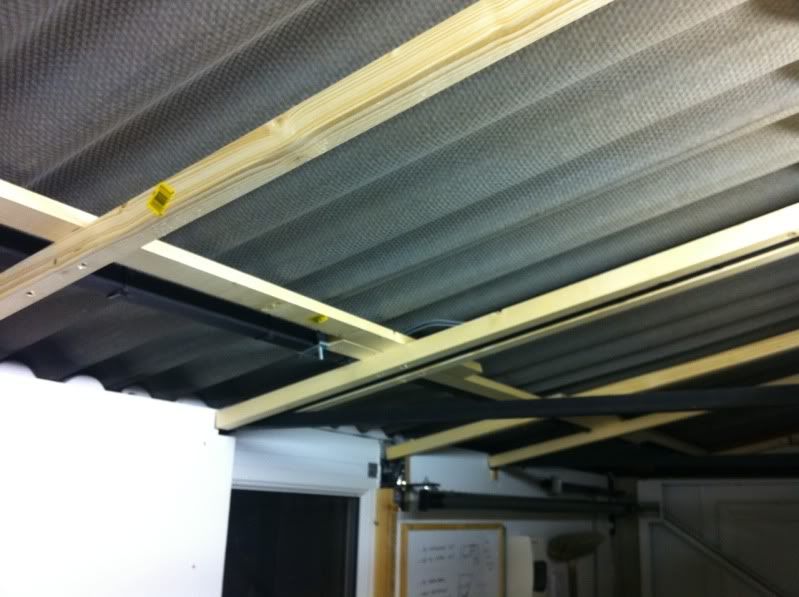

24V Renshaw 0 Posted September 19, 2011 LOL. Yeah, well I guess I don't see it as a big job any more really. Contemplating installing the initial parts of the climate control system while its all out aswell, just so I have the hard bits done before its mobile. Jay ---------- Post added at 12:45 PM ---------- Previous post was at 12:44 PM ---------- RW1 said: Yes, been using one for 12 years (same one). Runs on a plug-in socket timer. On M - F when I'm not in the garage. Off at Weekends when I'm in & out doing things. Starts being used when the cars come off the road in October and run it until end of April. Set in the corner to blow exhaust air along the gap at side of car / wall. So air is circulated. On some days, its so dry it takes your breath away. Mine doesn't work down past 5'C as it uses a cold plate to take out the mositure. If the garage is cold, the air won't condensate. Brakes remain rust free. Cars drive like the day they were put away. Also painted the garage walls with outside masonary paint and the floor with concrete sealer + garage floor paint. That cuts down a lot of moisture retention. Sit the tyres on kitchen coarse fibre carpet tiles as garage floor paint sticks to hot tyres. Store the dehumidifier water for windscreen wash and coolant changes as it has no "additives" like tap water. Cars also "dock" into charger points and have on board quick connections linked to the battery. . I have done similar by sealing and painting the floor and also lined all the walls, but its the roof where it condensates a bit when I get a warm/cold cycling with the heater on in there in the winter. Think the de-humidifier will sort that out. Jay Quote Share this post Link to post Share on other sites
RW1 0 Posted September 19, 2011 Quote but its the roof where it condensates a bit Ah, a concrete prefab garage with a tin corrogated roof I bet. It may not stop that. Better to insulate the metal roof. It will always condensate. Better to paint it with loft insulation material so as the cold metal surface is hidden from the mositure in the air. That way the moisture in the air remains airborne until the de-humidifier is able to extract it. Roof is acting on the same principle as the dehumidier cold plate. . Quote Share this post Link to post Share on other sites

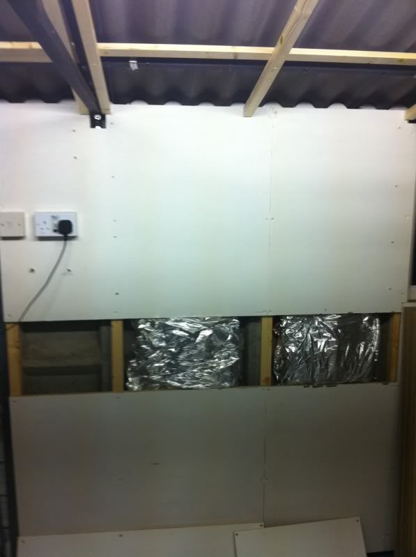

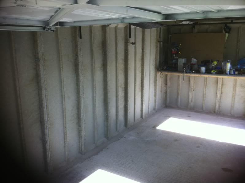

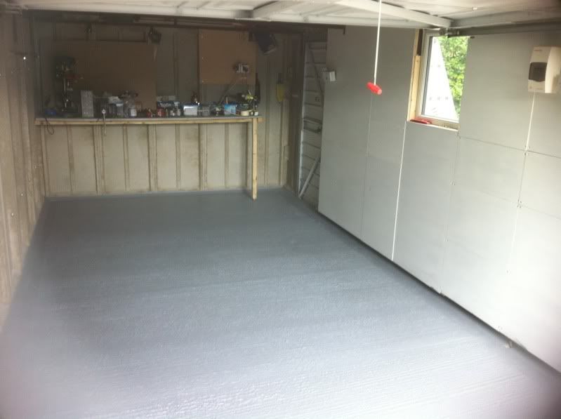

24V Renshaw 0 Posted September 26, 2011 Update: The focus for the next few evenings is to provide the C with a comfy warm and dry home for both being worked on in the winter months, but also for overnight parking. Having started with a basic concrete prefab garage, I had already painted the floor and panelled out the Walls with loads of battens and free 15mm chipboard for which I have a unlimited supply. But it is not enough, so this weekend I picked up a load more wood and 12 rolls of "space blanket" insulation. I have started feeding the space blanket in behind the wooden wall panelling and am just over half way so far. Hoping to finish this by the weekend and finish off painting all the panels White to brighten everything up. Also started to batten out the ceiling, so I can board out up there too. On the car front I have replacement front indicators and aerial (cheers Andy) and a replacement front slam Panel in dark burgundy pearl (cheers Paul) and can't wait to get the car in the garage to start work next week. I have given myself the deadline of the rolling road day at the end of November to have the car road worthy and sorted... Jay Quote Share this post Link to post Share on other sites
