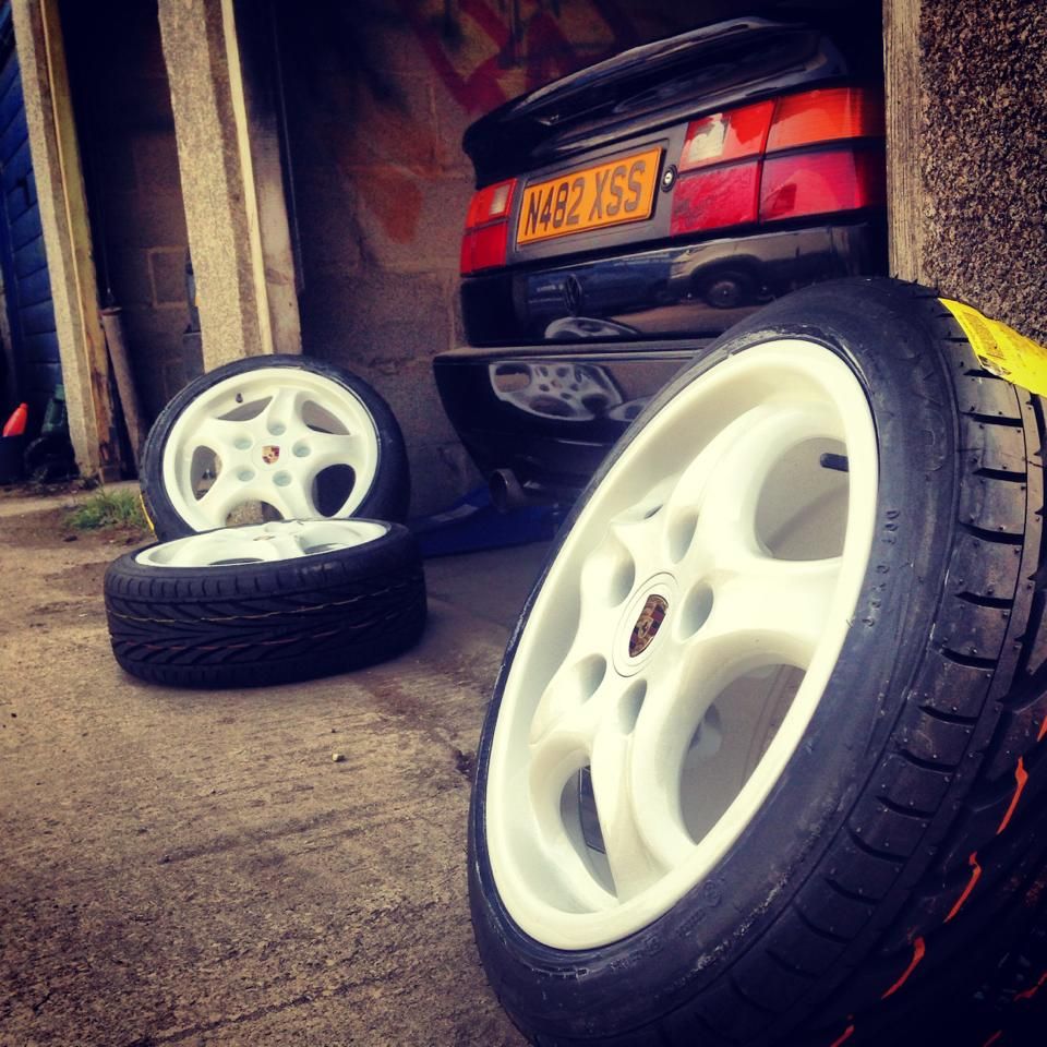

The wheels are ready.
My man at OBD-Works is doing a few bits tonight then over to his unit for some serious goings on! more to come!

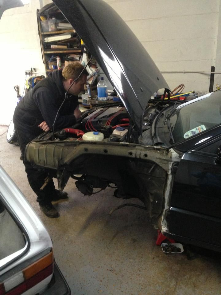

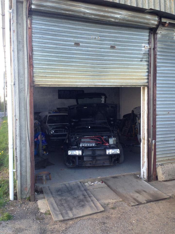

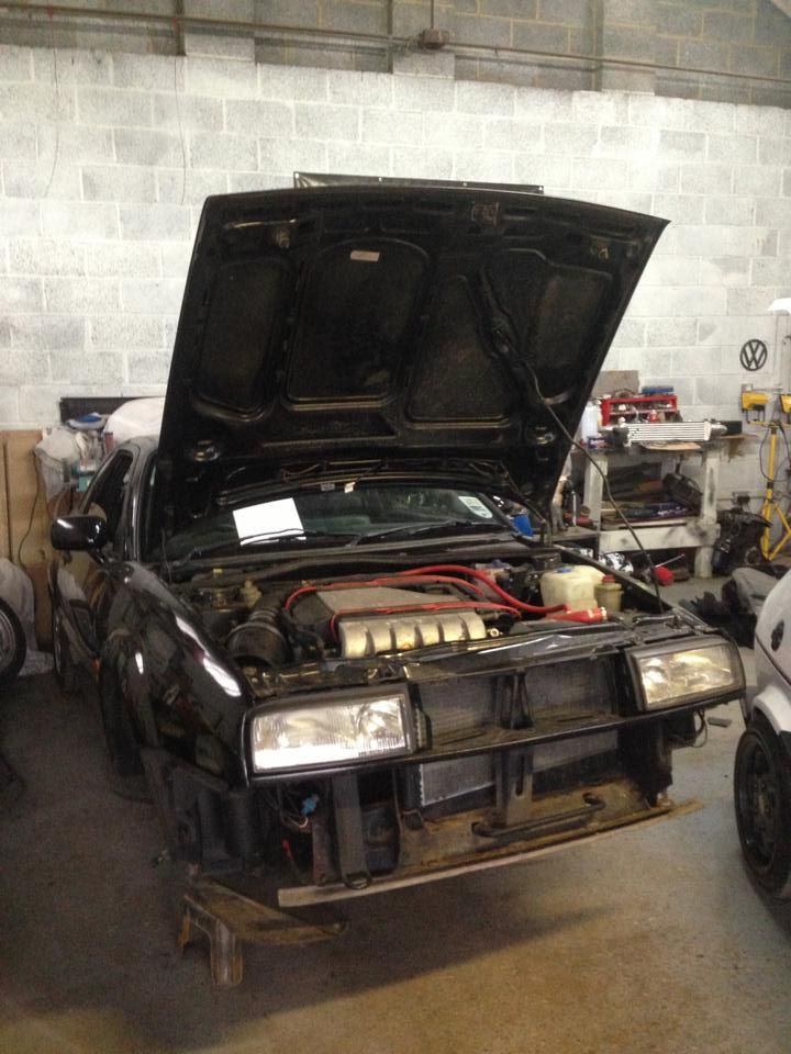

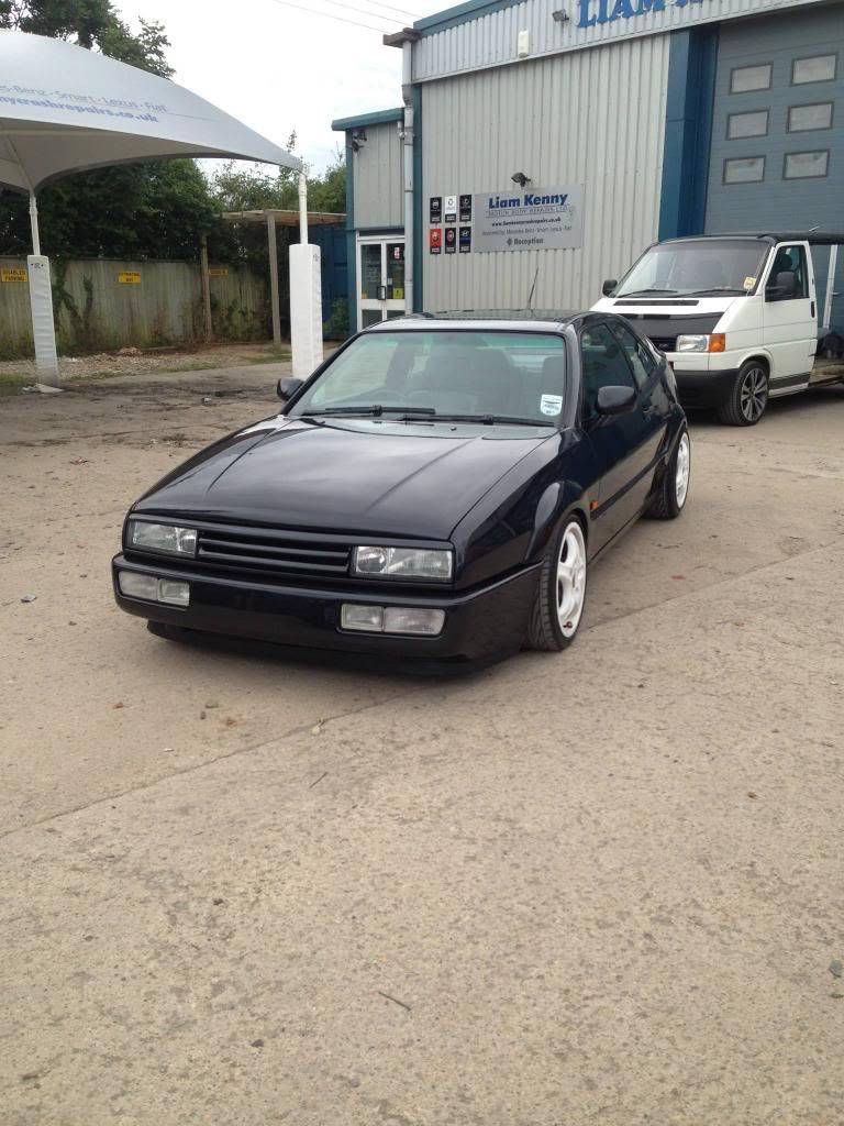

Finally making some good progress! its all coming together, Literally! To update.
Fitted:
Fully Polybush kit.
Mk4 Golf rear callipers
Full Braided brake line kit (complete flush and re-fill on fluid)
New top mounts
New track rods
New lower arms
Sourced a new Wing
Sourced a new bumper, (Big thanks to Twin45 for both)
A lot of wire tidying
New ball joints
New drop links
Still more on the list but that's where we are so far.
Few pics below taken over the last week or 2. All work done by OBD-Works, as always a fantastic service. Highly recommended check http://www.obd-works.co.uk

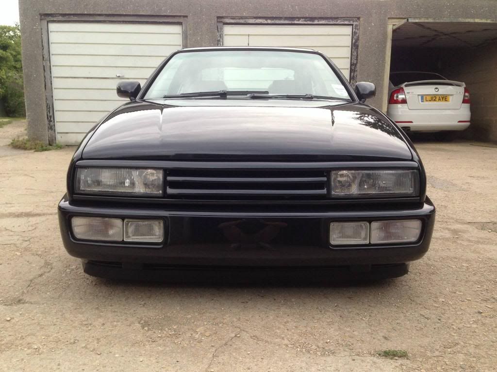

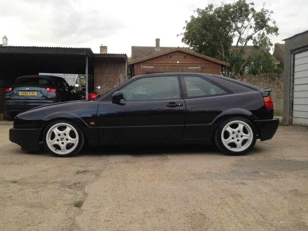

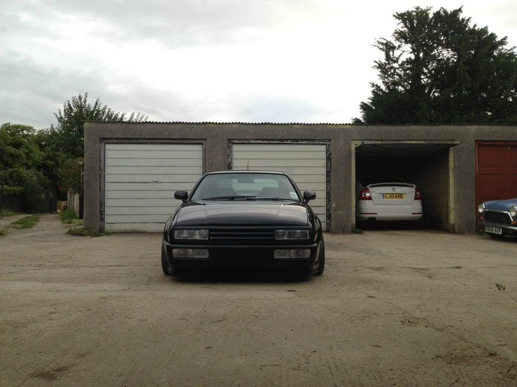

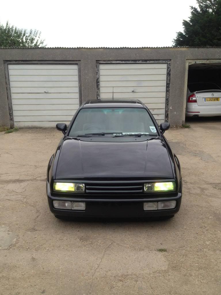

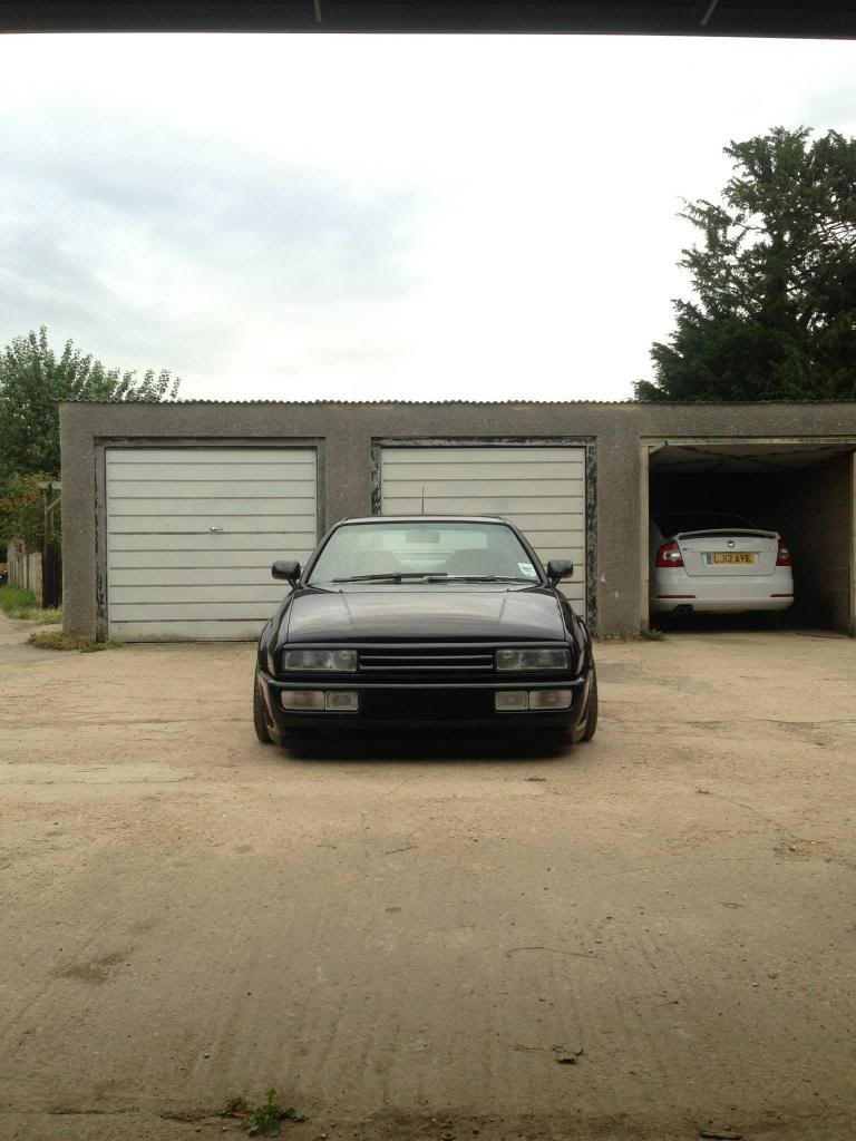

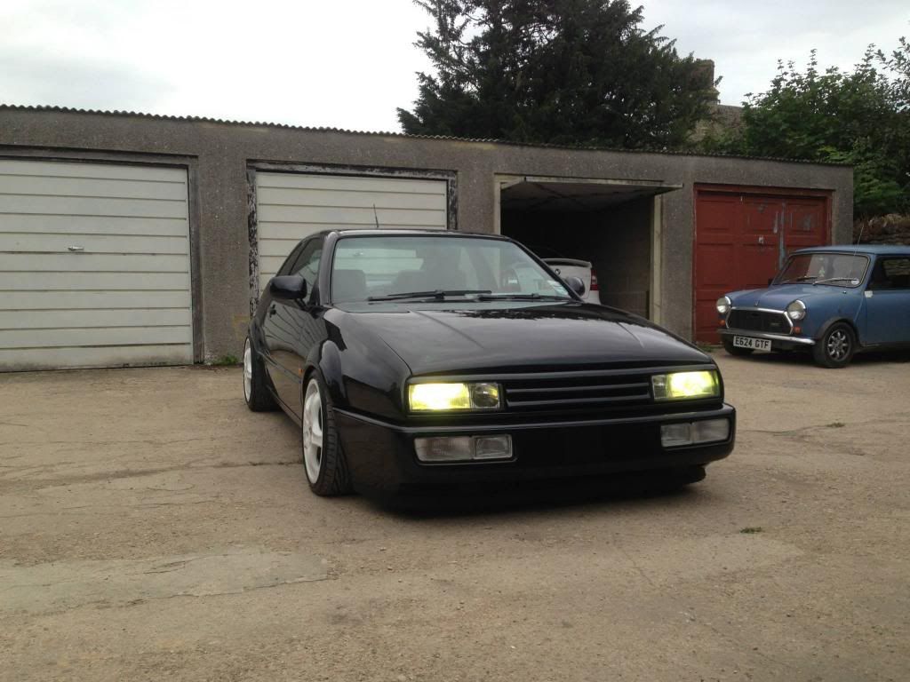

New Wing/ Bumper sourced and fitted. Wiper conversion and everything else now complete. Lowered roughly another 35mm, This is how she is currently sat. All arches rolled flat and pulled out a tiny amount to ensure no tire to arch contact.
To all who haven't, I cannot justify what a difference the poly kit made. Handles incredible and just the general solid feel of the car is so reassuring.
Together with the majority sub-frame replacement, the KW V2's and the braided brake lines/calliper upgrade (and disks pads etc), it has created a serious cornering machine. Currently confirming last few bits the paint man, Fingers crossed my next update will be baring a fresh coat!
Peace

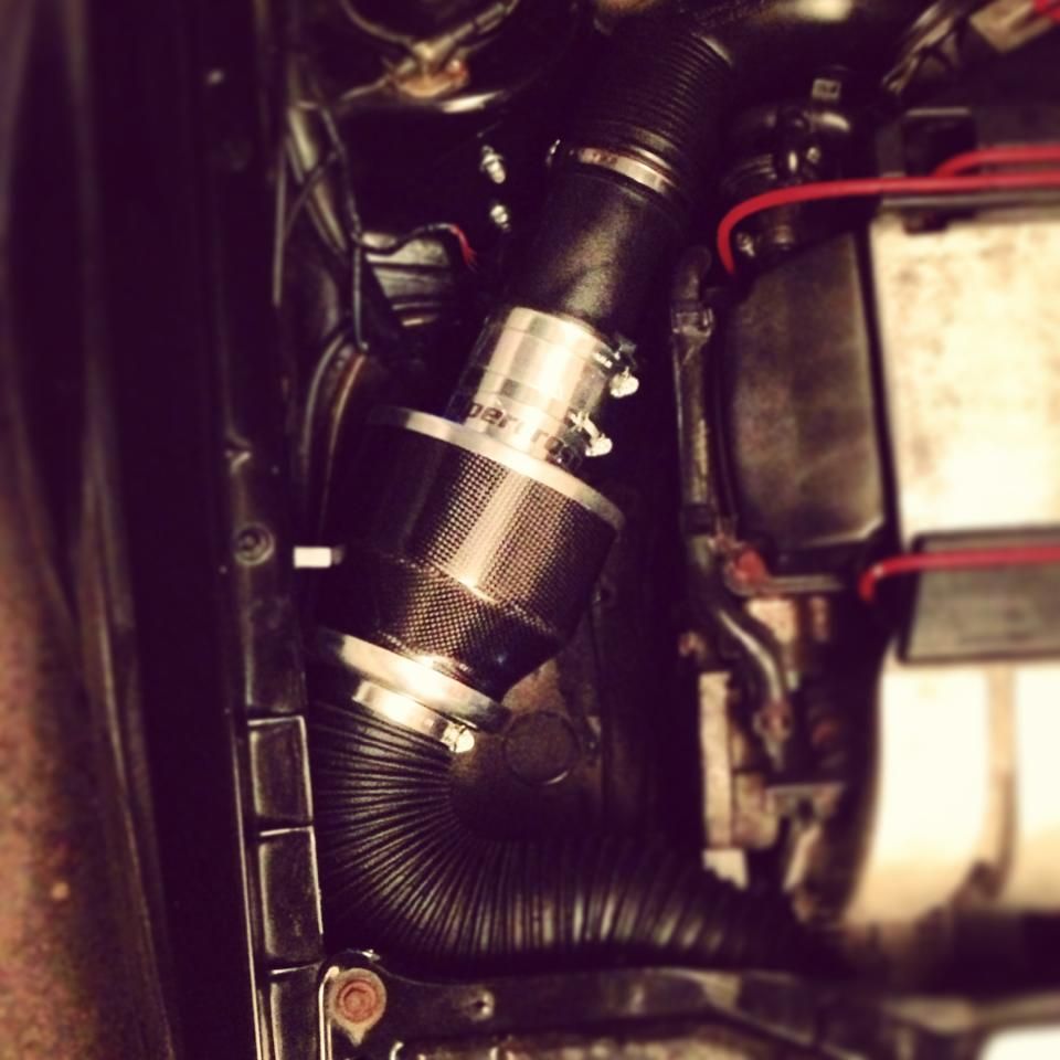

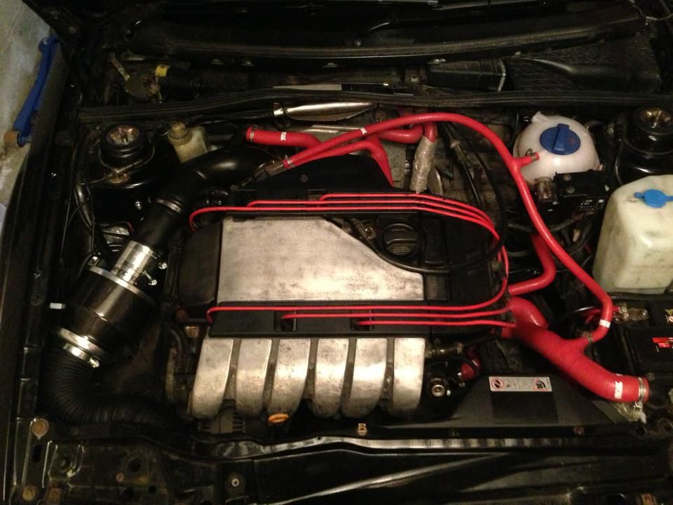

This arrived at the shop saturday.
( Pipercross Viper )
Fitted Saturday Eve...
Seriously amazed at the difference running a DECENT Carbon fiber intake with a cold air feed has made, Changed the "ZORST" tone, Engine notes, Overall power delivery.
used to die off around 5 and a half k, Now Power keeps on coming right to 6 - onwards, Really impressed with the results. I know its £200 for an induction kit, but I could not recommend it enough. (also helps getting it all at trade price)
PLEASE EXCUSE the state of my bay at the moment!!!!! :(

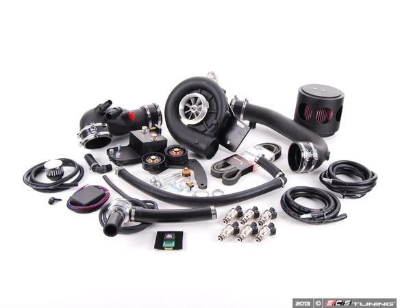

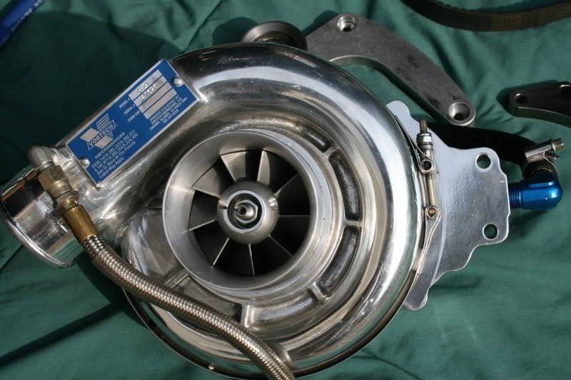

So after searching and searching the web for a supercharger kit, I gave up, so just went for it, Ordered a Vf-engineering Vortech stage 2 supercharger kit from the states, came to $4600 to my doorstep, should be here in about 5-6 weeks, WATCH THIS SPACE!
Went for the polished finish! Will also be taking out the engine and tucking/cleaning/spraying the bay up.
This also means my BRAND NEW, Pipercross viper induction kit will be up for grabs soon, so if anyone wants to call first dibs let me know.
With all that's been done im expecting to hit over the 300bhp mark, time shall tell. I AM VERY EXCITE!

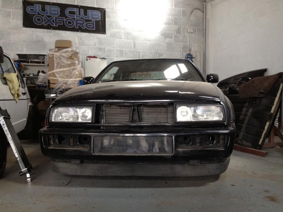

Just one from Wednesdays Dub Club Oxford meet,

Do those kits just 'bolt straight on' then?
How many English monies is that ??
Very nice :) Hope you bring this along to another Midlands / Warwickshire meet in the future - would love to have a look around it!
  Endeegee said:
I'd be interested in your Induction kit. :thumbleft:
Ill make sure you have first dibs man, ill let you know a figure when she comes up for sale, probably just be what i paid for it (trade) so like £150 but ill give your a definite price when the charger arrives
  Benjevw said:
Lucky b^stard!!
Well, apparently, the price reflects how much work and design goes into it to make sure it fits perfect, kit includes a stupid amount of parts, from bigger injectors, to stage 2 ECU Chip, to new oil circuit, it looks the nuts, and should be for the price. est BHP 280 onwards, on a standard OBD1. let alone my engine.
Works out at around £3000 GBP, and when u consider i have seen people buy second hand superchargers, just the charger and the brackets, for the £2k mark, its not bad at all.

Yes Clumpy, Exactly that, im just going for it, Now its a Cat D its value is only to me anyway. They are porsche wheels yes, Porsche cups to be precise, staggered fitment 9's on the rear et70 and 7's on the front et40, Sat on 40mm spacer/adaptors all round. Please be aware, the wing is still grey on one side though, and overall body work is not the greatest, wanted it to be perfect for nationals day, but once again, unforeseen corrado issues have prioritised

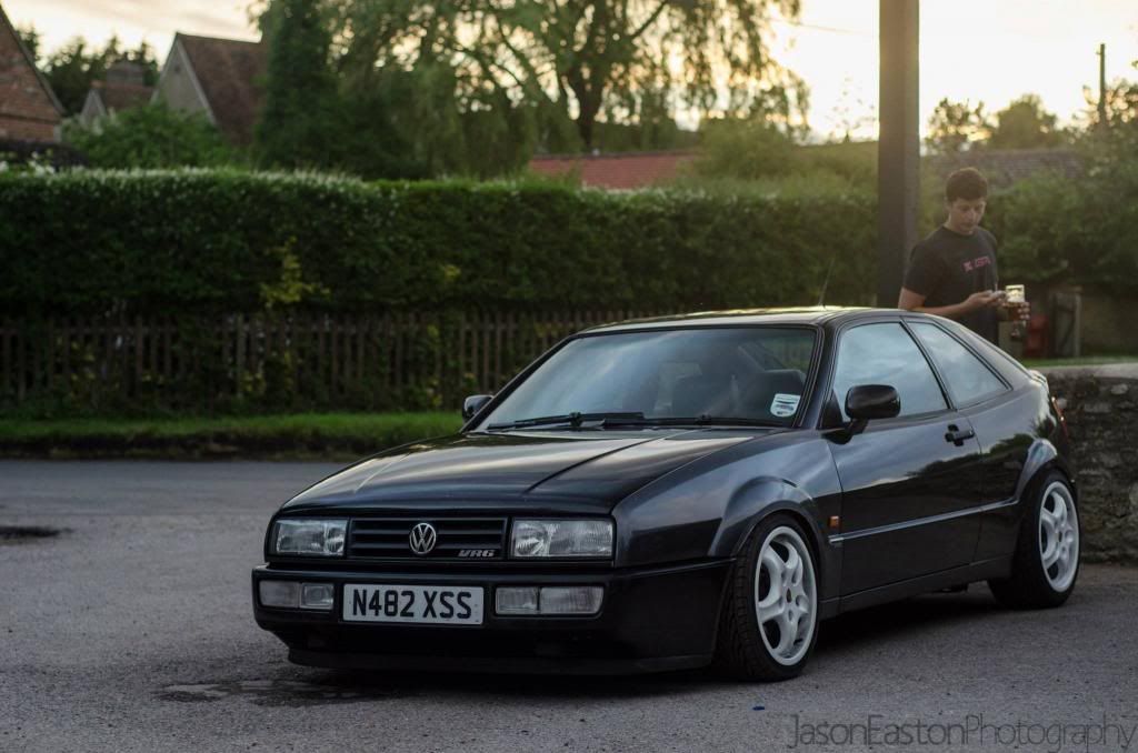

Since i brought the car almost 2 and a half years back i have been waiting for the day i could respray her. We finally got there! Over the moon with it, and had so many long awaited bits touched up as well.
NEST UP, Stage 2 Competition Clutch, Competition Clutch Flywheel, then take out the engine, fit it all, and the supercharger kit (arriving tomorrow)then spray the bay, tuck all the loom, put the engine back in then off to longlife for a full custom manifold and zorst system.... So thats, Engine rebuilt, body resprayed, subframe replaced, 99% of the rest of the car replaced and upgraded, so NEXT up i shall start thinking about interior.... got some serious plans!!!!!

Very nice indeed! Did you manage to get it done for a good price? Was it a glass out respray?
was £1700 including colour code and fit the reiger grill, smooth the recess and delete all wholes, Inside door shuts, treat all rust areas (inside door shuts) I said to the guy there is £300 in it on top if he gets it bang on and he did. didnt take the glass out as its not easy on the rado, but took the majority of the panels (bonnet, bumper, wings etc) off and all the rubbers, roof strips and similar. He did a fantastic job and turned it round in 4 days. What happens when you go to a through and through VW enthusiast, he was as excited as me about painting it. haha
