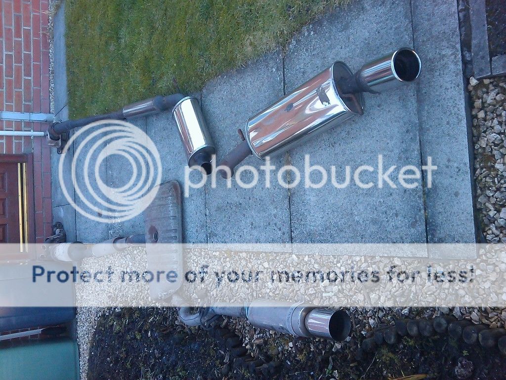

cptkirk 10 Posted February 19, 2012 ive got the new system on today and by looking at the standard system they must be poor Quote Share this post Link to post Share on other sites
MurphG60 0 Posted February 19, 2012 There designed for a good all round system also mostly made cheaply to keep costs down Quote Share this post Link to post Share on other sites

cptkirk 10 Posted February 19, 2012 hopefully the stainless system will last long tiime Quote Share this post Link to post Share on other sites

cptkirk 10 Posted February 20, 2012 |^^^how much!!! only got this sytem because the old one was gone..it had been repaired at some point... i just cant understand how the large box would make the gases flow nicly...no lamba on mine eva?? thought it would have one Quote Share this post Link to post Share on other sites
