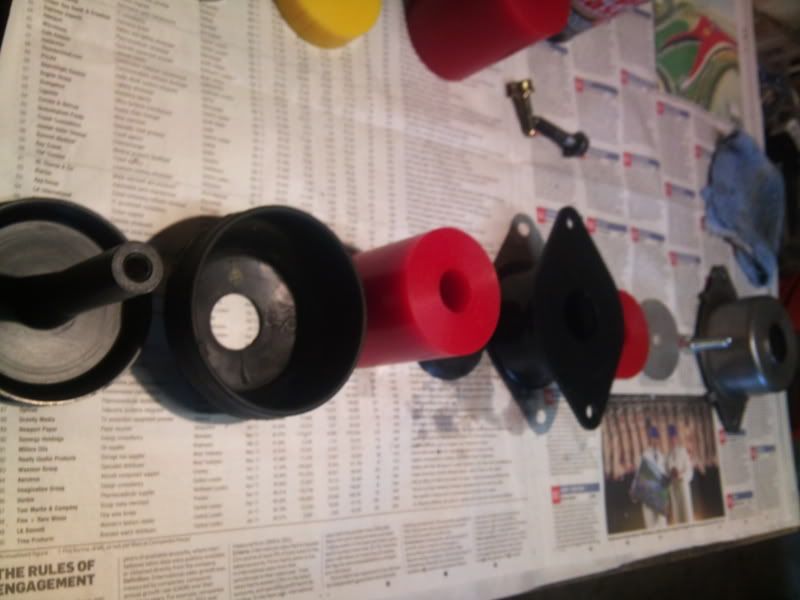

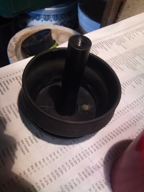

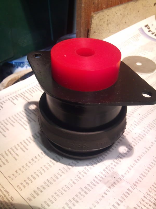

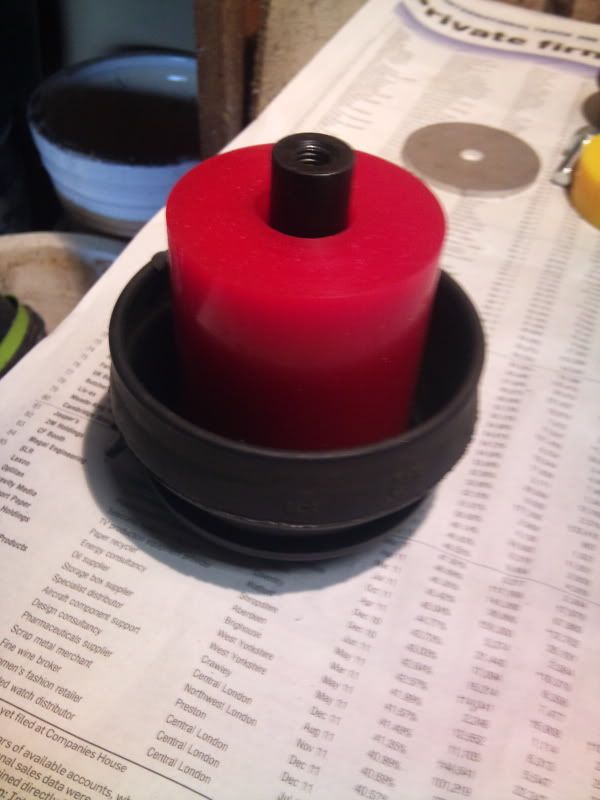

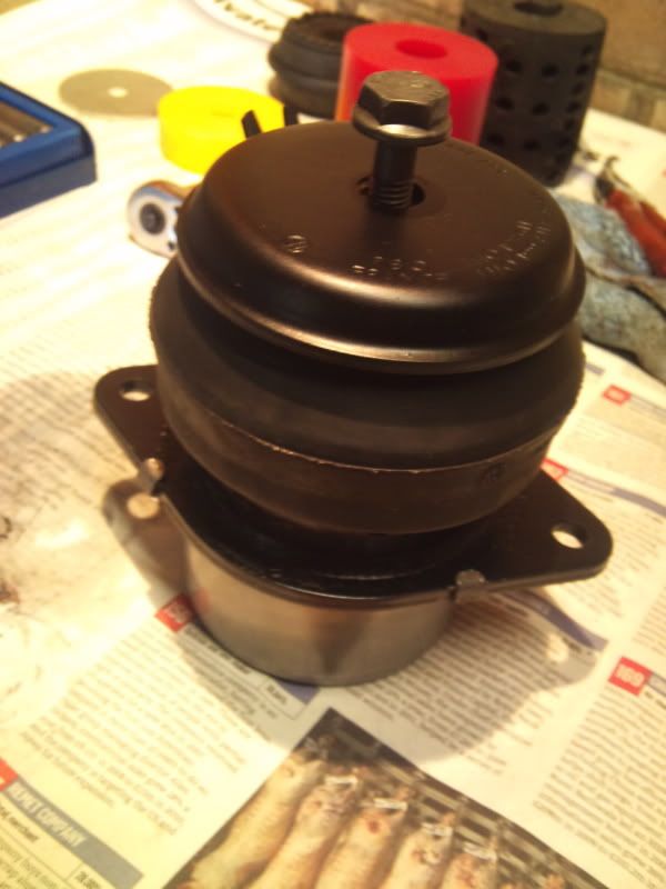

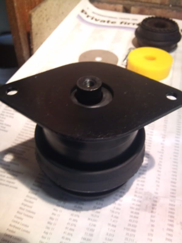

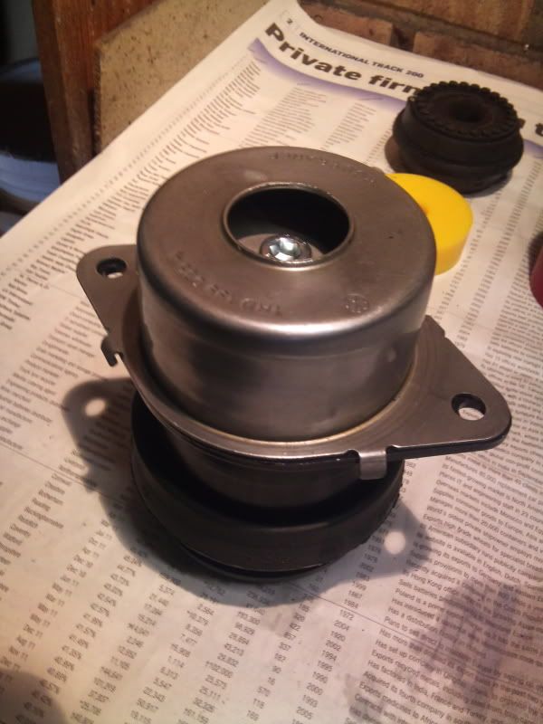

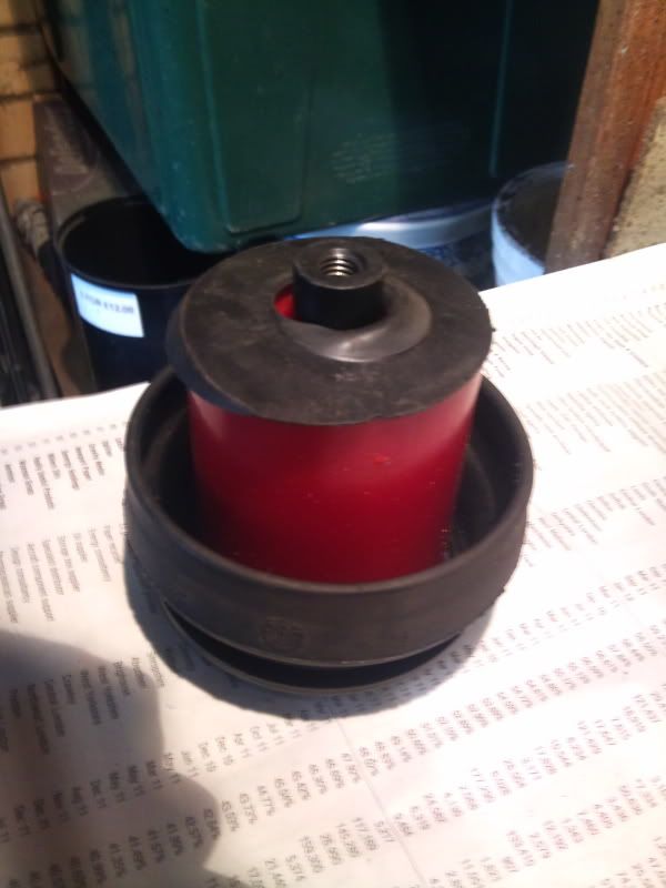

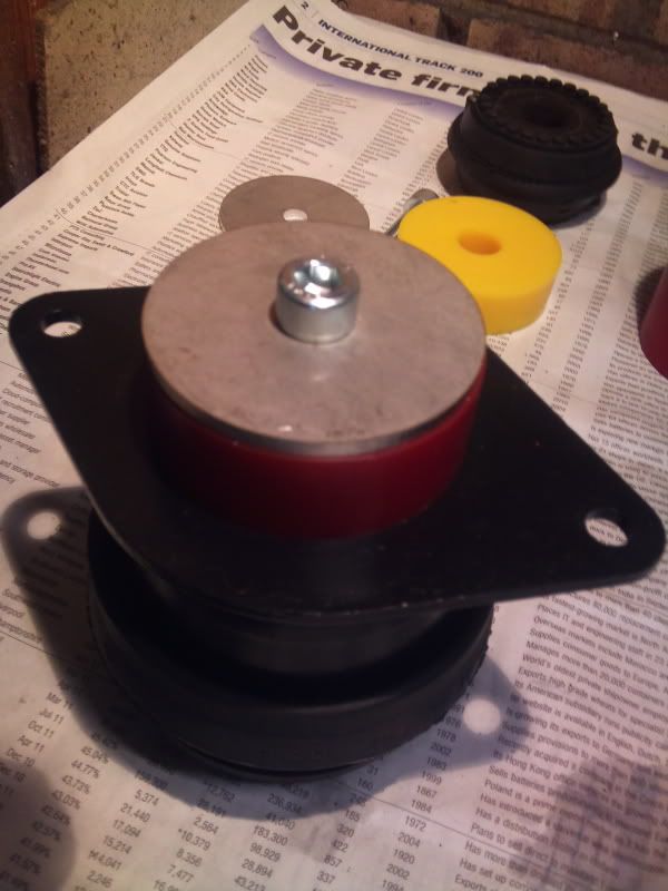

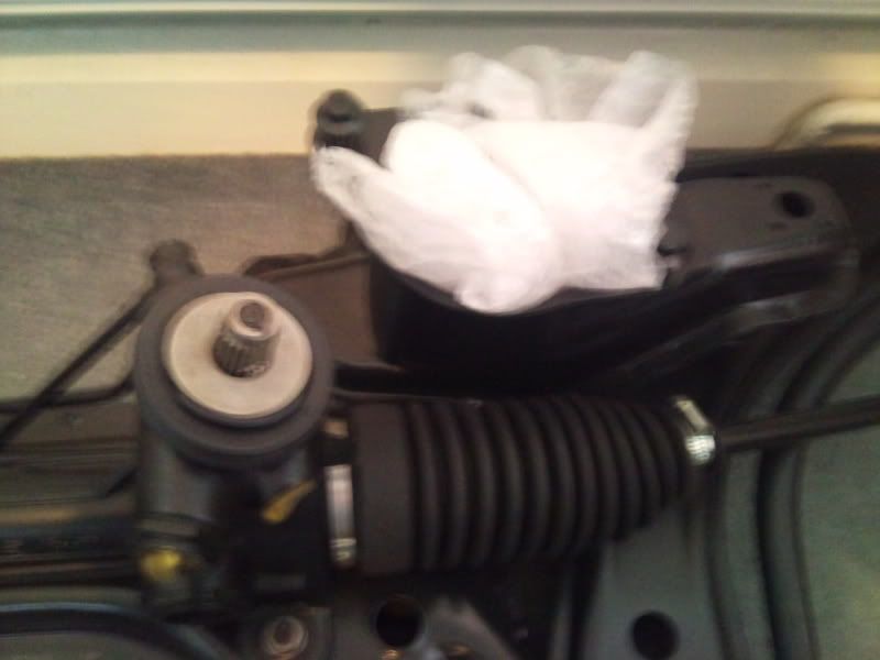

Jim Bowen 1 Posted July 14, 2012 lol, that other set must be floating around a warehouse somewhere. Just been out and made my mount up Old mount rubber vs new poly bush Parts in order to build up mount Rubber cover goes into metal cap bit Bush goes on Little rubber bit? Metal bit on top Smaller mount on top of that Fit metal disc and bolt Cap with the tabs goes on top (bend tabs back around) Mount turned correct way up, should look like this Going to stick it in this hole Going to refit subframe next weekend i think, need to do the schutz/underseal this weekend now :D (got no excuses) Quote Share this post Link to post Share on other sites

Stonejag 10 Posted July 16, 2012 24V Renshaw said: Oh balls! I tried so hard to make sure all of them were complete. I will stick one in the post, but i am on holiday in Cornwall till Sunday, I'm afraid. Don't worry, from my experience it always happens to one of them :) Not in a great rush so when you get back is fine. I could be being dense but isn't this a pic of the front mount? In which case it wants the yellow small mount on, not the red one...? Stone Quote Share this post Link to post Share on other sites
Jim Bowen 1 Posted July 17, 2012 Hope mine is the rear. Not taken front off yet, the one by the rad. Sent from my X10i using Tapatalk 2 Quote Share this post Link to post Share on other sites
24V Renshaw 0 Posted July 17, 2012 That's definitely the rear mount, it probably looks odd as it hasn't got the lower section on it in that pic. Jay Quote Share this post Link to post Share on other sites
