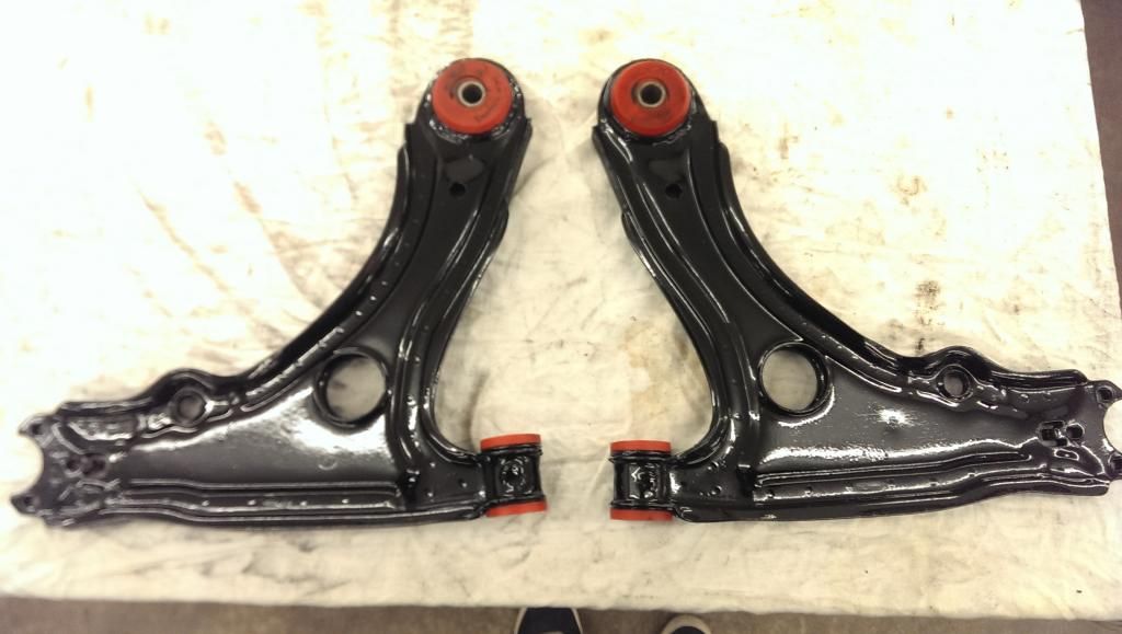

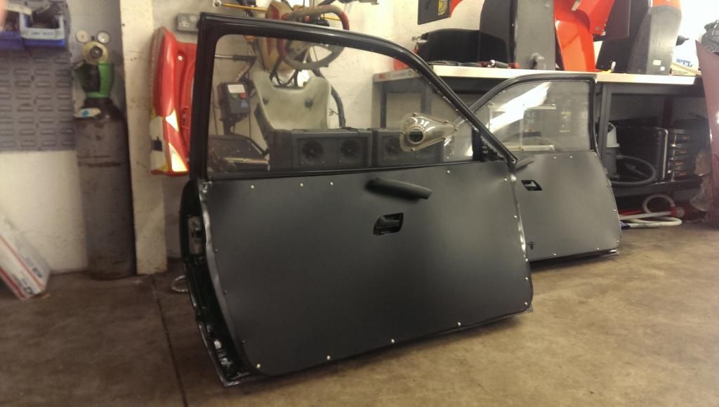

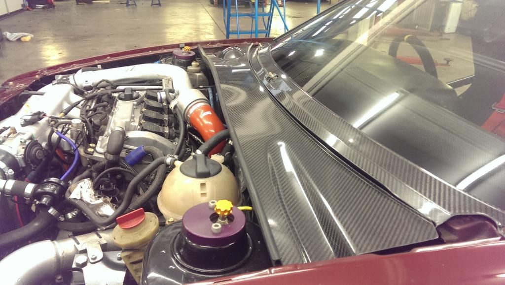

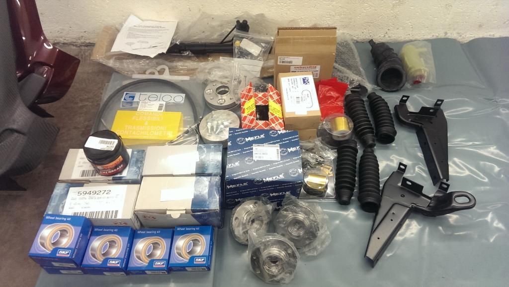

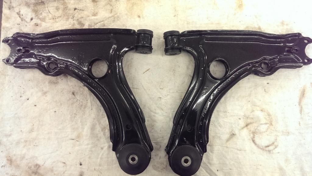

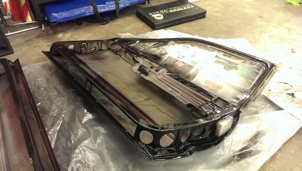

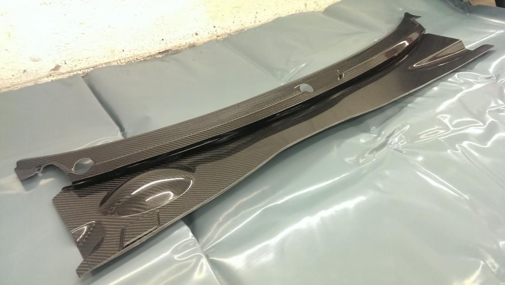

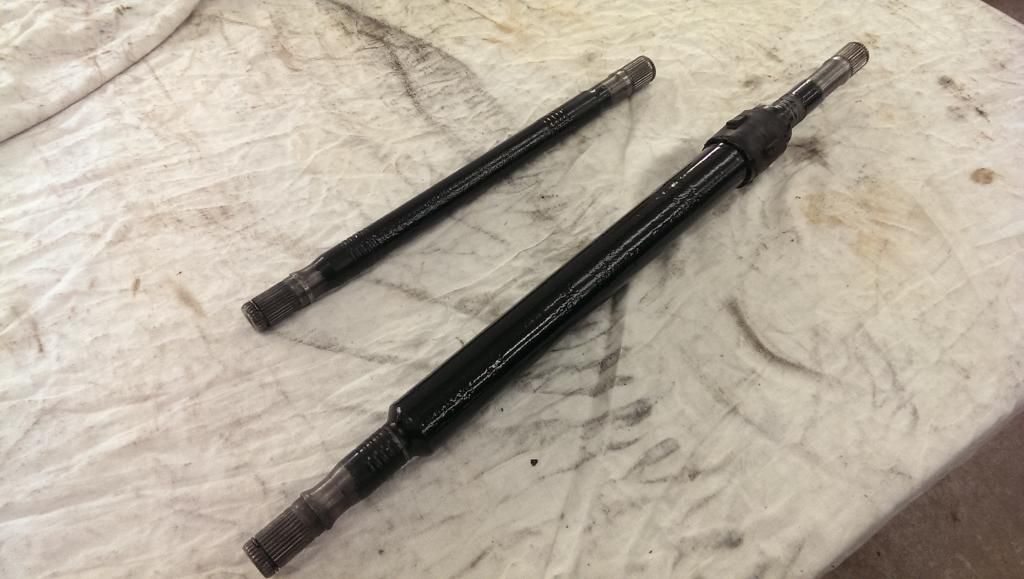

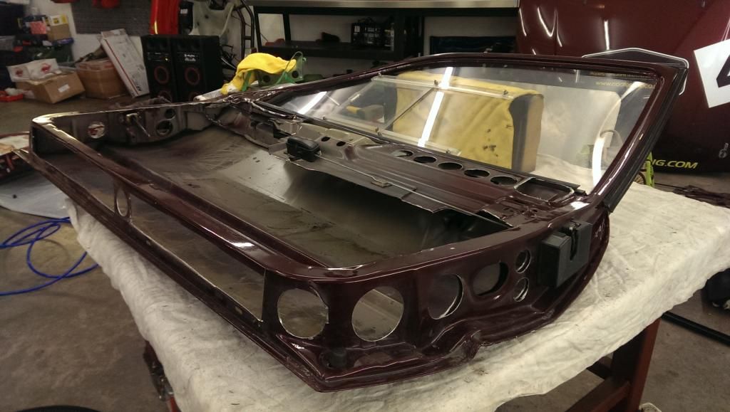

HummuH 10 Posted January 12, 2015 Wee bit of an update: After butchering the doors which took quite a bit of weight out they were still pretty heavy. Picked up a cheap and cheerful hole-saw kit and went to town. Things were starting to get a bit "floppy" in places so had to be careful to retain some structure and keep the door rigid. Doors finished: Wishbones tarted up: Sub-frame given some tlc after attack from the angle grinder: Drive shafts balanced and painted (badly): New wheels: New steering rack: Some Carbon: Lots of bits to fit: New brakes hopefully incoming next week so can get it built back up again. Quote Share this post Link to post Share on other sites

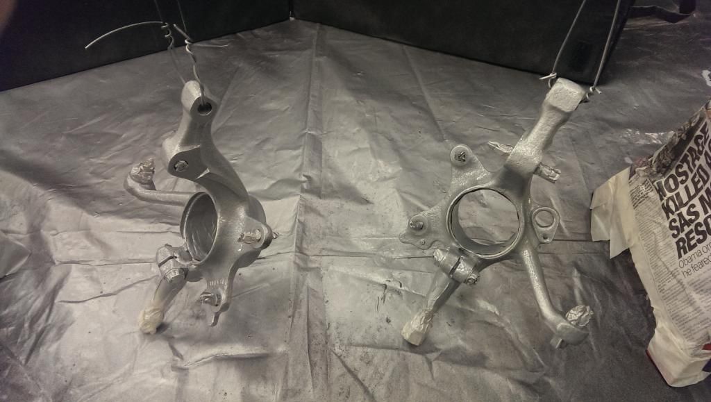

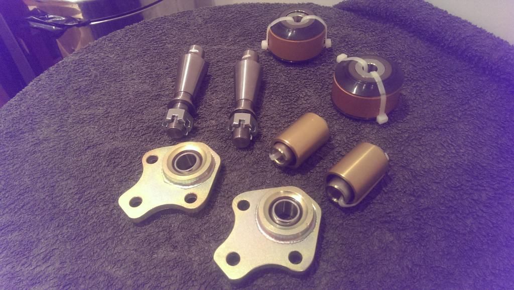

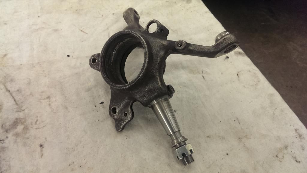

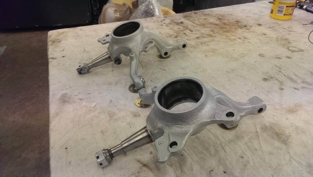

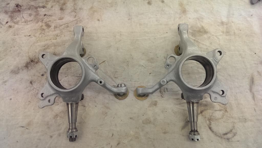

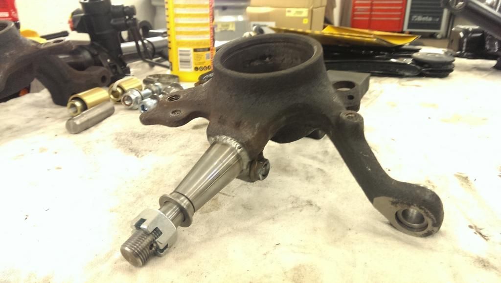

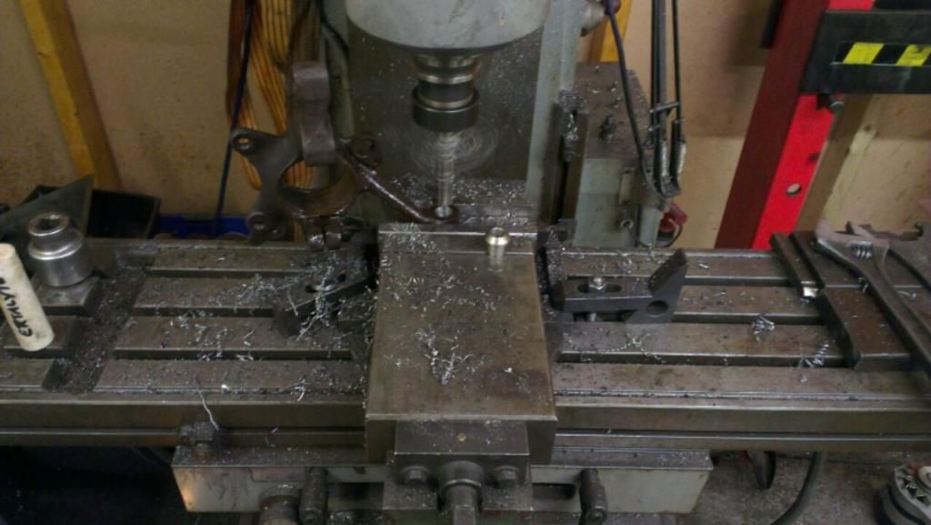

HummuH 10 Posted January 19, 2015 Got a bit more done over the weekend, feels like making progress now. Tom and Scott at Brayon Classic Engineering welded some ball joint extenders to the hub carriers and drilled out for new Track Rod Ends. Then they got it. Why haven't I discovered a wire brush attachment for angle grinder until now? Got the Powerflex Black bushes in now. Did a test fit of the rain cover. Needs a bit of trimming and some clips but should look good. Quote Share this post Link to post Share on other sites

mic_VR 3 Posted January 19, 2015 Man I wish I could get some of those extenders for a VR Quote Share this post Link to post Share on other sites
HummuH 10 Posted January 19, 2015 Man I wish I could get some of those extenders for a VR Might be worth speaking to Jarrod at SCCH. There can't be that much difference between 4 and 5 stud to get them to work is there? Quote Share this post Link to post Share on other sites
mic_VR 3 Posted January 19, 2015 The ball joints connect in a completely different way on the VR hubs unfortunately. They're bolt through rather than pinch bolts so you'd need a way of getting around that. I think the question has been asked before a few times Quote Share this post Link to post Share on other sites
HummuH 10 Posted January 19, 2015 The ball joints connect in a completely different way on the VR hubs unfortunately. They're bolt through rather than pinch bolts so you'd need a way of getting around that. I think the question has been asked before a few times Didn't realise that, thought the hub carriers would be largely the same. Quote Share this post Link to post Share on other sites

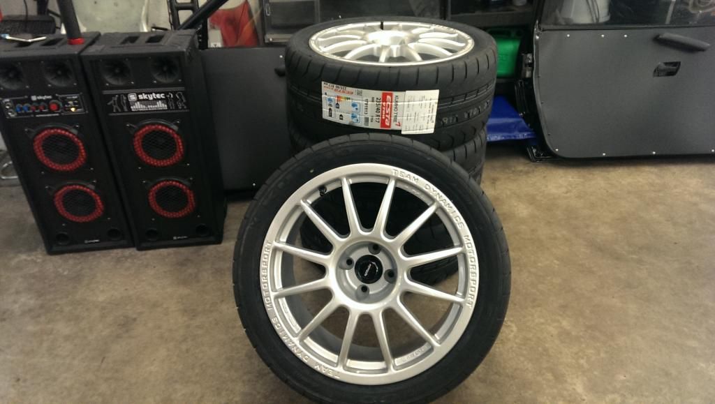

HummuH 10 Posted February 2, 2015 Got a wee bit more done over the past week. Getting the subframe back on proved challenging with the car on the ground but with the help of the trusty Dremel and Scotty "Hammer" Watkins lying underneath the car for four hours we got there eventually. We could then get the wishbones back in (was the spacers on new wishbone bushes that were causing us the hassle) and get the front end built up again. Gave us a chance to see how the new ball joints and Track Rods would come together. Still all needs tightened up but other than having to chop some threads off the rods, all went together fine. Took some time out to get the new tyres on the new wheels, will be interesting to see if some extra width on the tyres helps or hinders lap times. Ran out of time so couldn't get the new brakes installed but had a good rummage through to check all was good and present which it seems to be. Should have that done by end of week then off to the body shop she goes! Quote Share this post Link to post Share on other sites
coullstar 0 Posted February 2, 2015 AP's...nice. What offset are the wheels? Quote Share this post Link to post Share on other sites
HummuH 10 Posted February 2, 2015 AP's...nice. What offset are the wheels? Plenty! ET20 with 20mm spacers so basically running 0 offset. Could be great, could be a disaster, time will tell. Quote Share this post Link to post Share on other sites

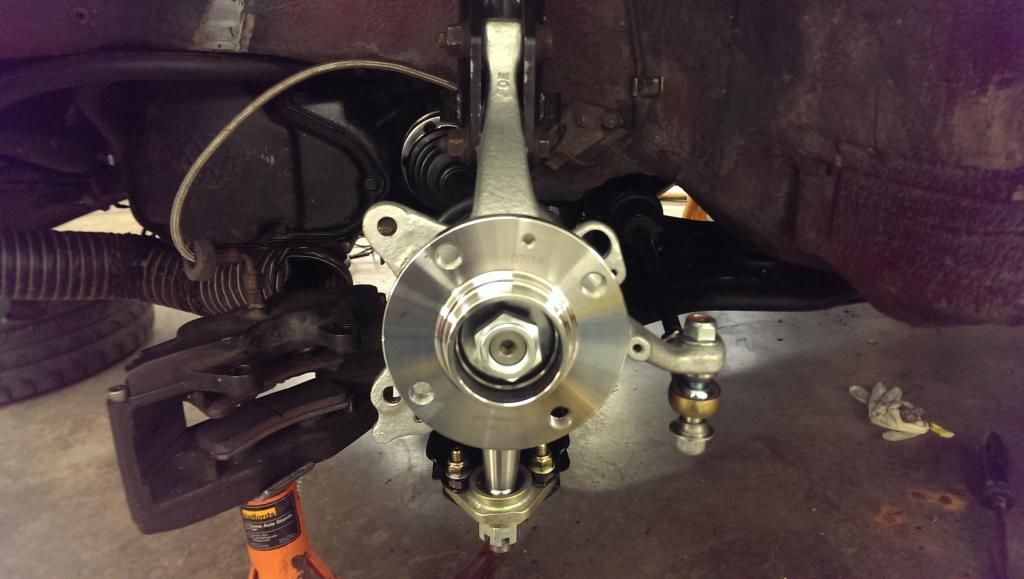

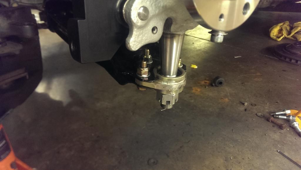

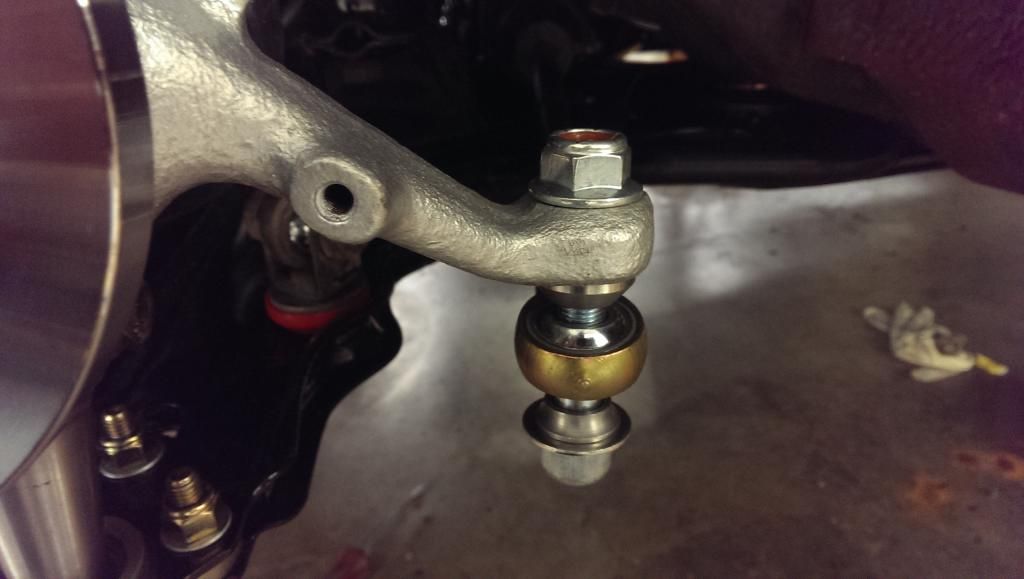

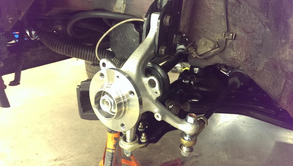

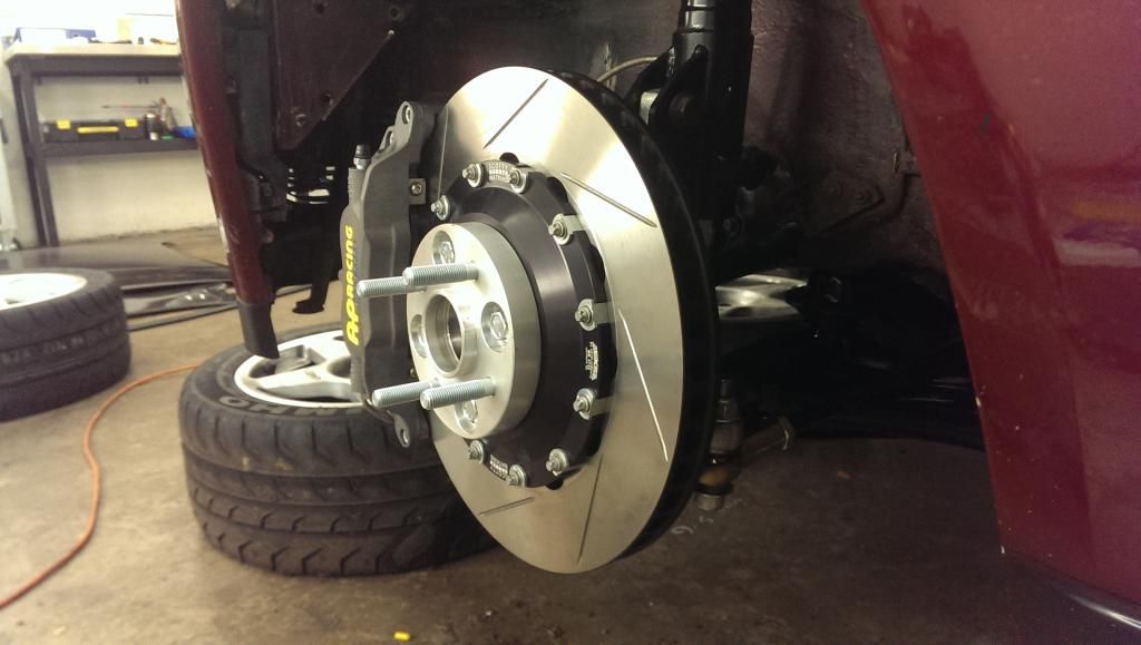

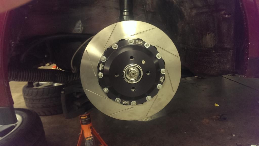

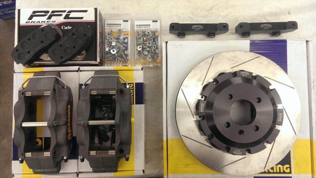

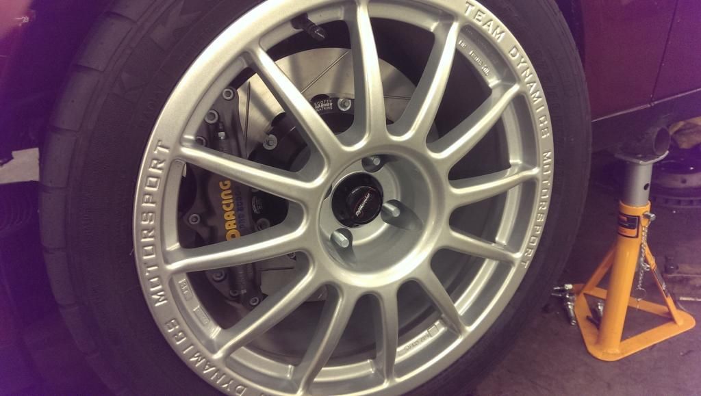

HummuH 10 Posted February 9, 2015 Got some more work done before the car was dropped off at the body shop at the weekend. First up was a trial fit on the brakes. We had changed quite a lot with new ball joints and steering arms etc, so we knew the general geometry/clearances were going to be very different. So, we built the brakes up and got them on the hub. Needless to say, wasn't plain sailing! What I had overlooked was that the ball joints were very different. As you'll see in the image below they are hexagonal in shape at the end and stick out past the sleeve where as the OEM ball joints simply have a circular sleeve round the joint itself. With the drop pins they also now sit about 3 inches lower than before. What this meant was that on full lock, the inner face of the disc was fouling the ball joints. This made Scotty happy as the solution to the problem was to grind down the ball joints, gulp! Plenty of clearance now though: So, got the brakes fully installed and test fitted a wheel, all looking good. With the new wheels and spacers on there's a bit of poke out of the arches as expected so hopefully the new arches will fit well without being too extreme. Also got the new tailgate fitted before she was packed off. Hopefully 3 to 4 weeks then in for the new livery/wrap. Quote Share this post Link to post Share on other sites
mic_VR 3 Posted February 9, 2015 Amazing work, again! When I fitted my AP's I had to grind down the OEM ball joints...... still fouls slightly on lock but the car is pretty low.... Quote Share this post Link to post Share on other sites
