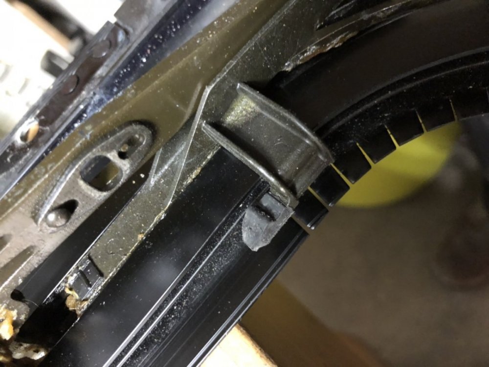

Two of these hooks is what it holds onto. Break the plastic on the inner panel that attaches to these and it’s game over for your panel.
That's got me nervous now! haha.
