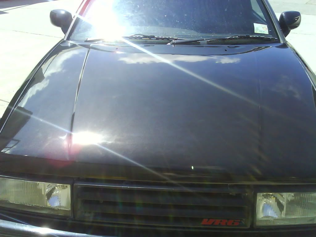

aide 0 Posted May 16, 2013 True, you have to get stuck in, check out vrowner85 thread to see someone whose home sprayed to a decent standard. Yeh live in Belfast, I'm a blow in, moved over in 2005 :) Quote Share this post Link to post Share on other sites
ger040 3 Posted May 17, 2013 True, you have to get stuck in, check out vrowner85 thread to see someone whose home sprayed to a decent standard. Yeh live in Belfast, I'm a blow in, moved over in 2005 :) i have just seen the work you have done to your own car very nice and all to an excellent standard !! Quote Share this post Link to post Share on other sites
