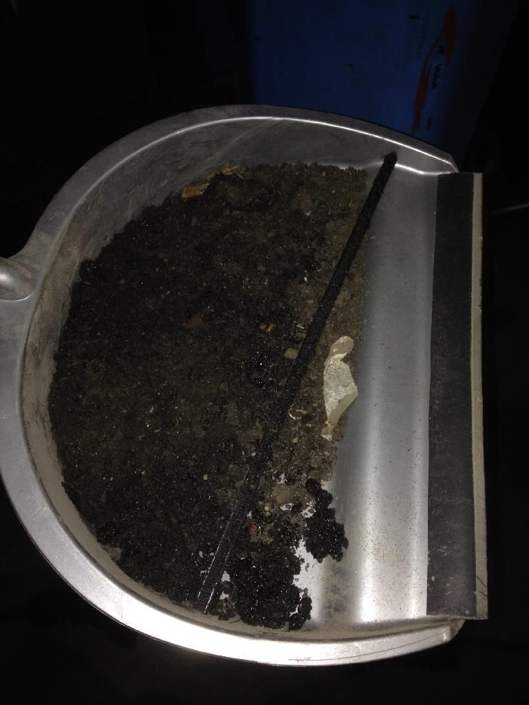

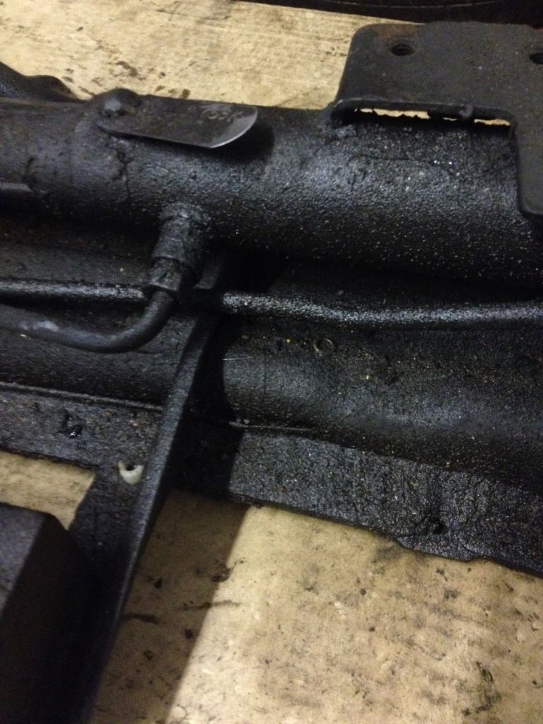

Finished uni early so went up and dropped the subframe off the Corrado. It's literally caked in oil :(
Think will get a steam cleaner on it to try and get most of it off!

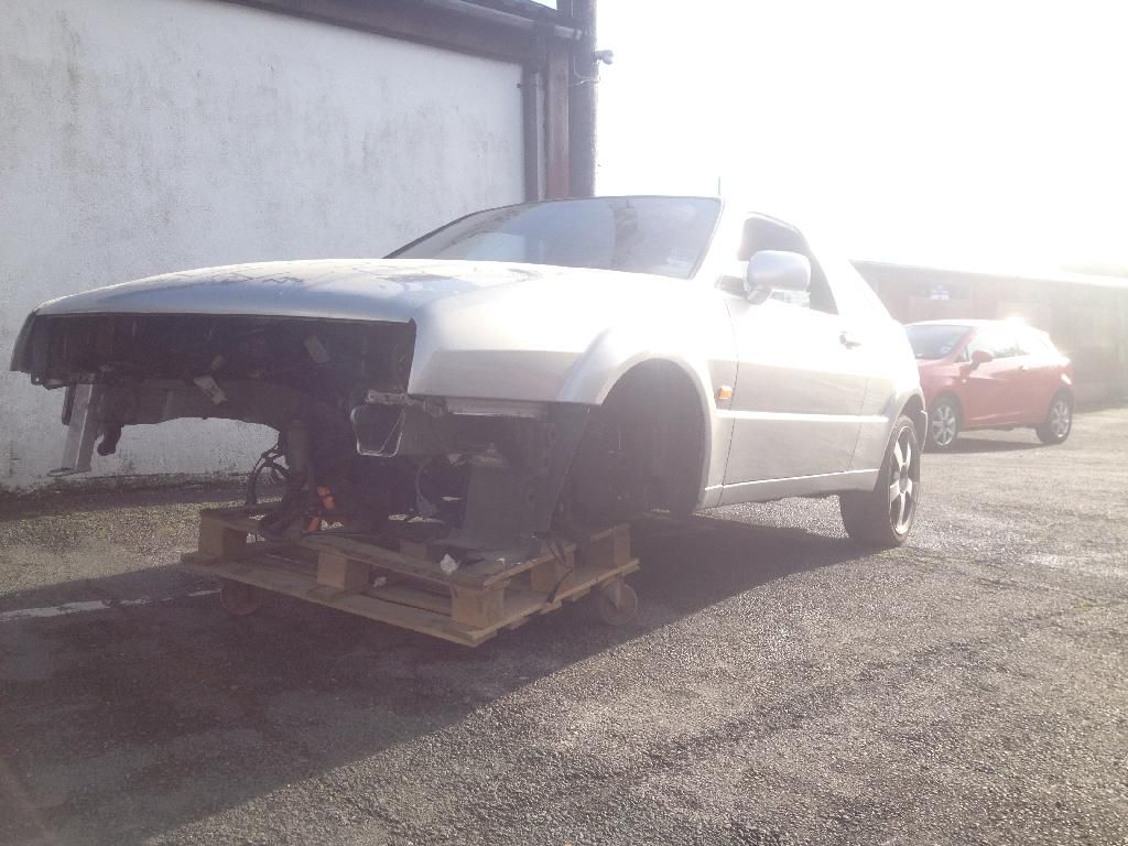

So I've been pretty slack with updating this thread, and with Uni and all I didn't do much in September! However end of october I moved units into a larger one with a couple of friends and have started to crack on with the Corrado (finally).
As I had binned the wishbones and trackrod ends etc, I had to use a crate with trolley wheels on to move it to the new unit! Fortunately it was only around the corner, however we lost a wheel in the process :lol:

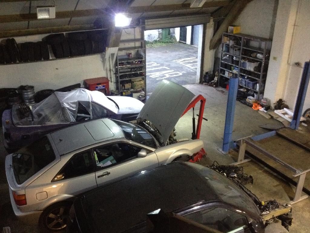

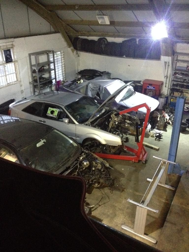

So we moved into a slightly bigger unit with a 4 poster ramp and compressor which is handy. Also we now have a work bench/station which makes life much easier than before!

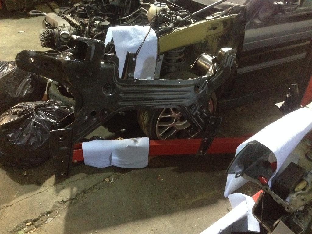

Removed some other bits and bobs before dropping the subframe again, ready to give everything a clean up

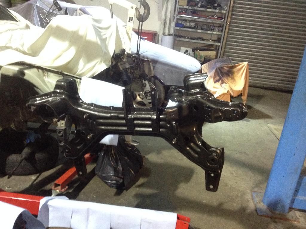

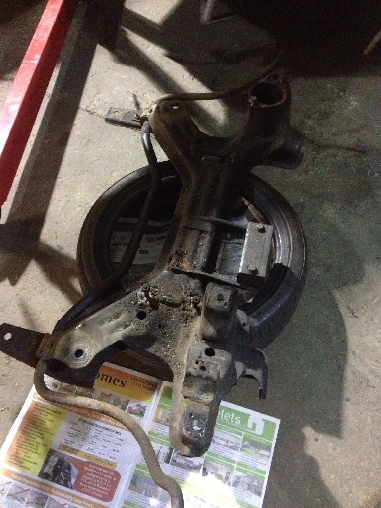

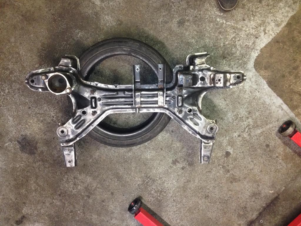

State of the subframe:

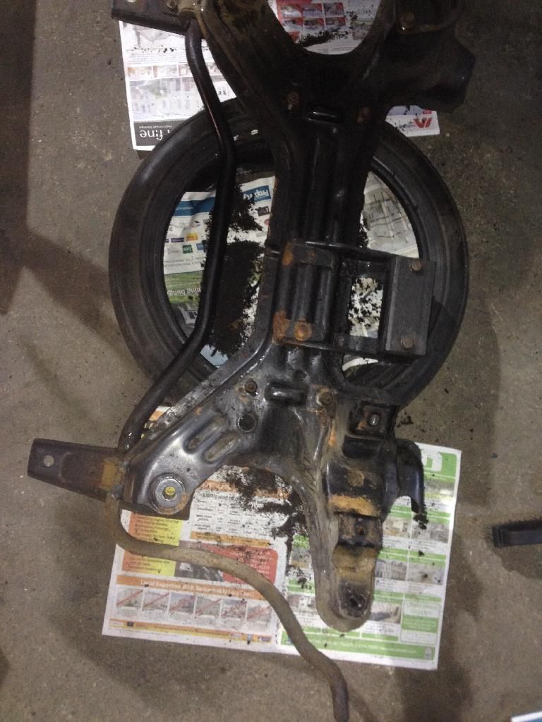

And after scraping off one side of crap.....

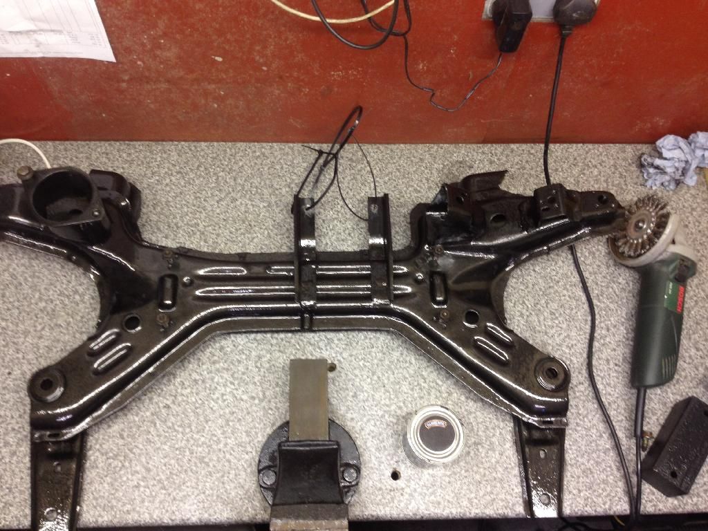

Used a grinder with a wire wheel attachment to get rid of all of the rust that I could, then got around to painting it with hammerite today
I also did the same to the front mount bracket.

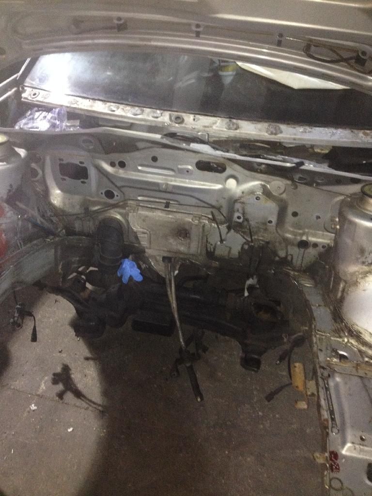

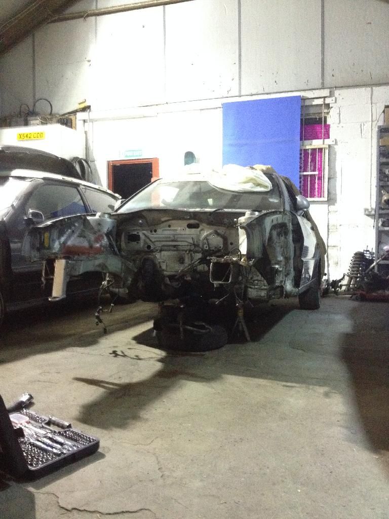

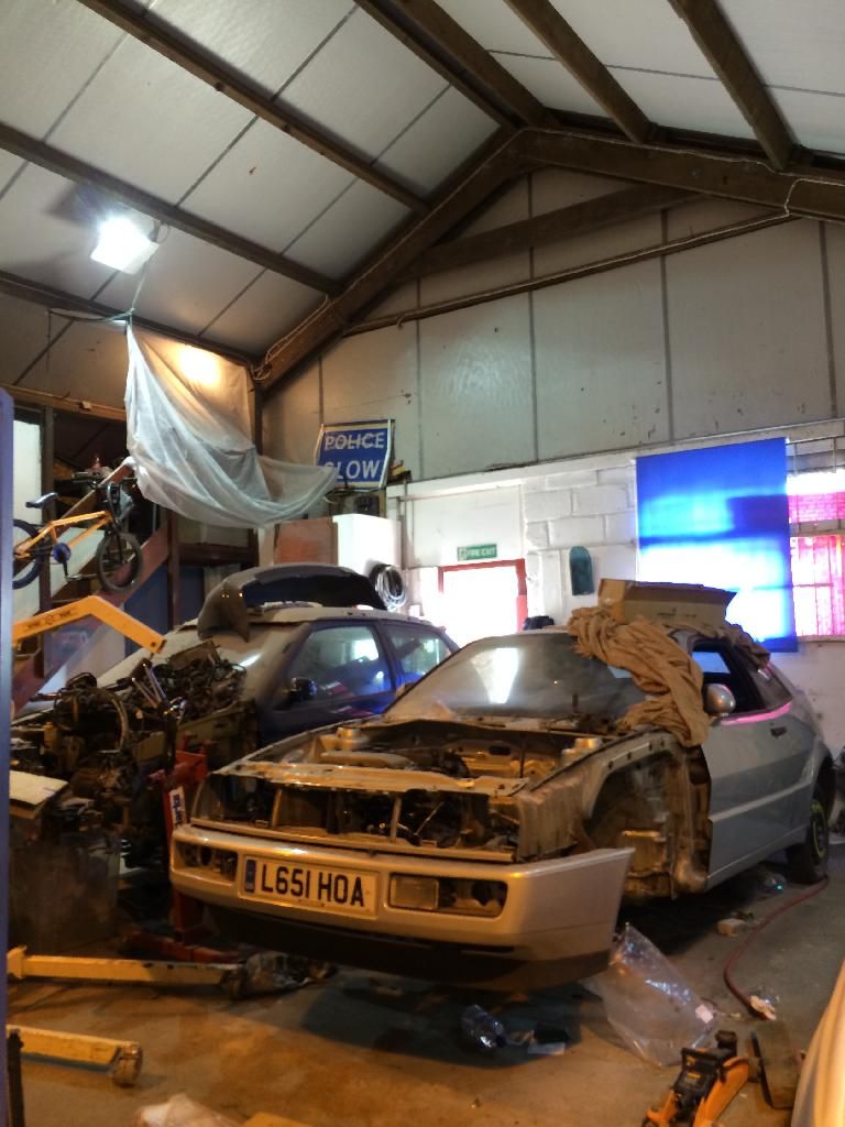

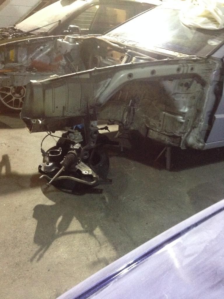

Anyway I got around to removing both wings and bonnet and started to wire brush down the wheel arches
Got the engine on the stand, need to strip the rest down, fit some new parts and paint the block.

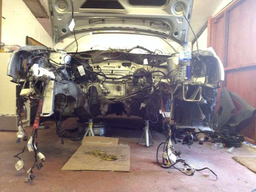

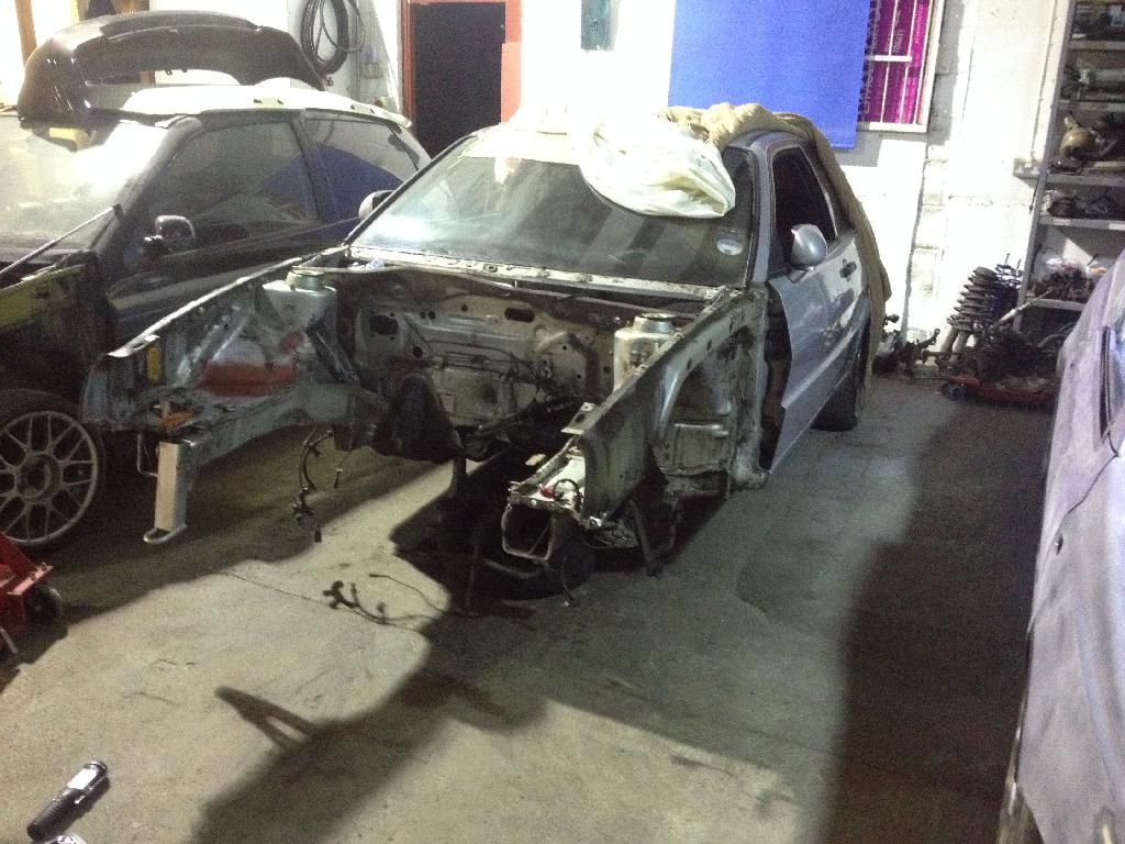

Since the last pictures of the bay I have removed everything apart from the rear two brake lines. I've started using solvents to brake down the rest of the crap in the bay, most of one side is done just need to do the other side now. Then I can get around to removing the rest of the seam sealer, deleting some things and filling up some holes in the bay :)
Making a start on the wiring next week. Need the windscreen taking out so I can sort the rusty windsreen panel too, though if it's too bad will get it cut out and replaced!

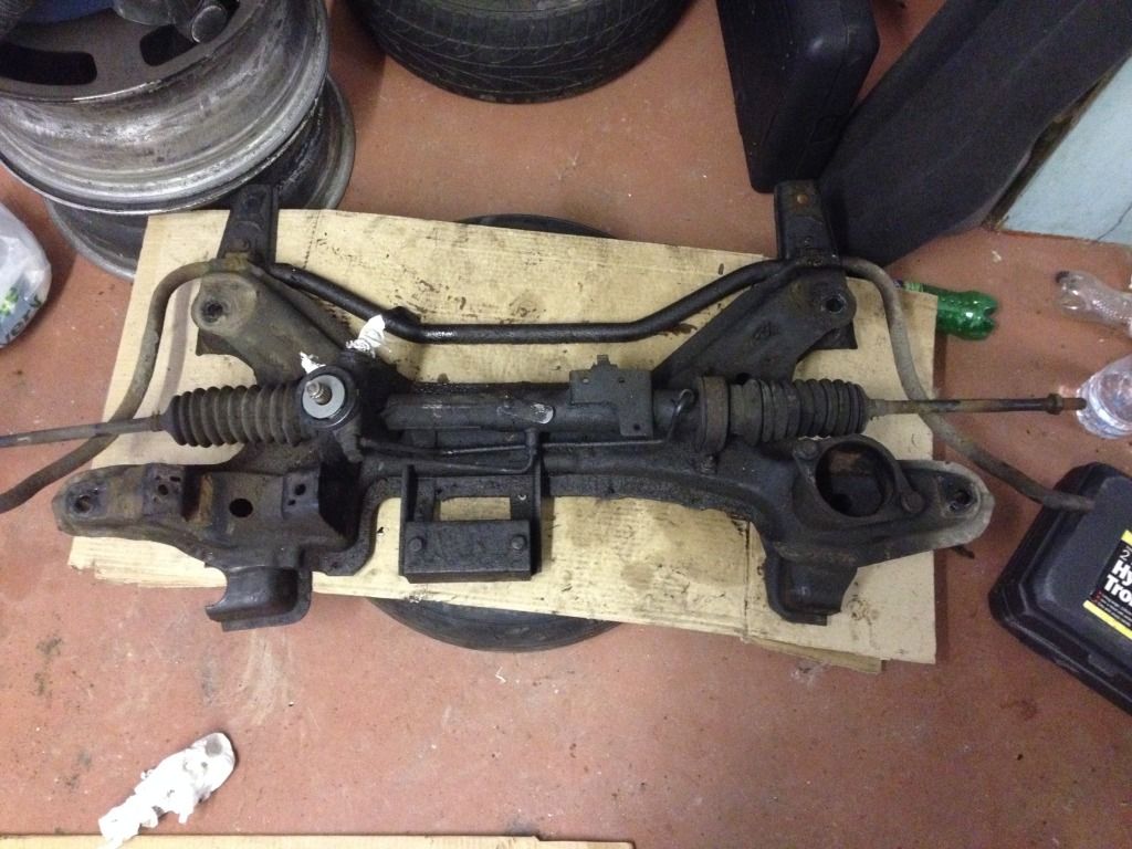

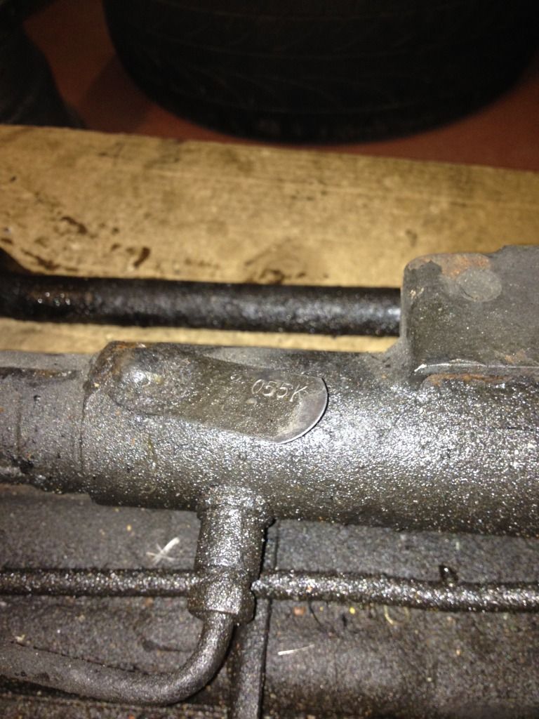

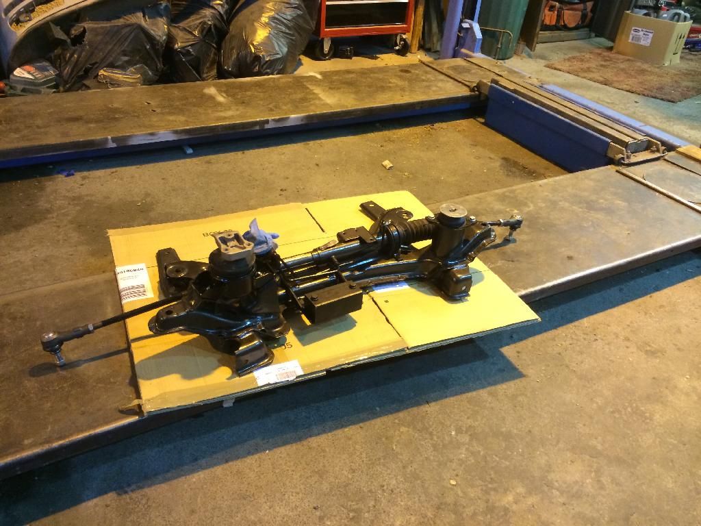

Picked up some parts the other day. Got new wishbones, track rod ends, steering boots, ball joints etc. Have stripped and painted the anti-roll bar, subframe and in the process of doing the steering rack. Should have some new pictures early next week :)

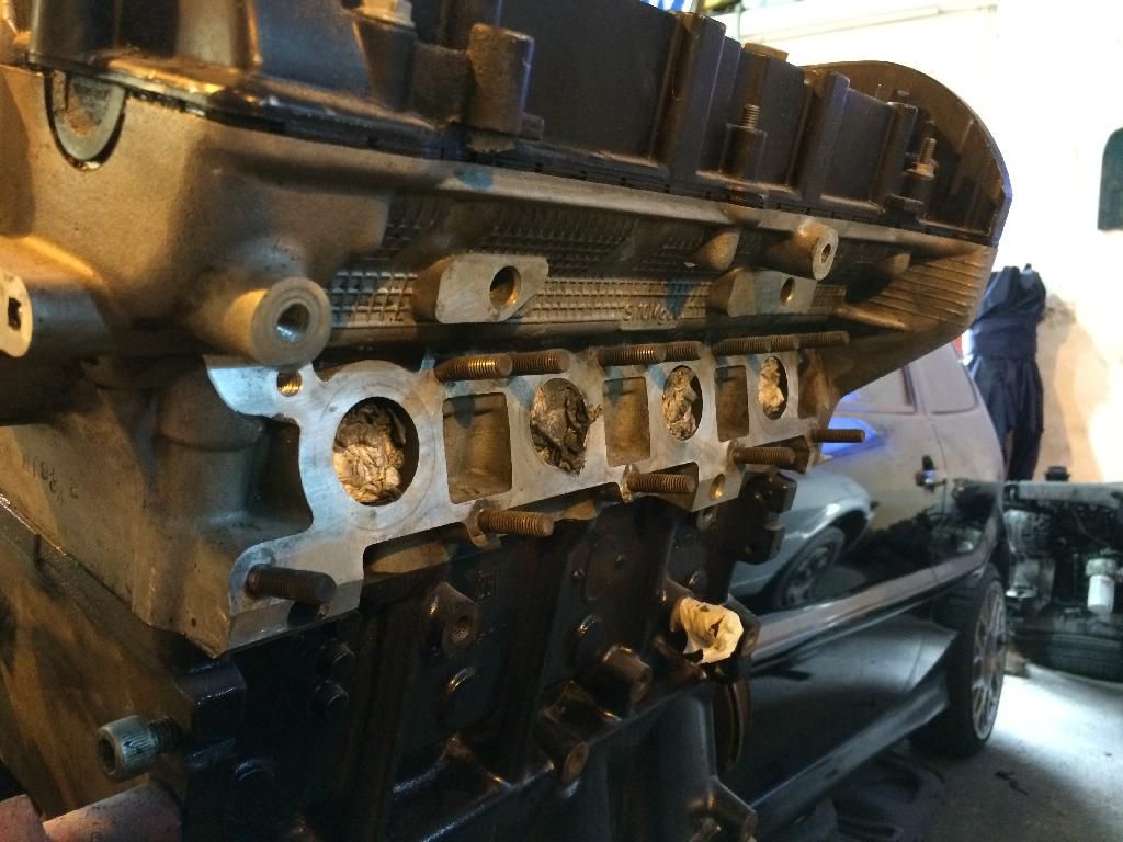

Since the last update, I have stripped the rest off of the engine, painted the block, painted some engine parts, replaced seals and put most of it back together. I've also removed a snapped exhaust stud, replaced it, cleaned the surface up before putting a new exhaust gasket on and the manifold and turbo back on.
I've ordered a new clutch and downpipe this week and have been slowly picking up more and more parts as the weeks have gone on. The subframe is all back together now with new engine mounts, wishbones, anti-roll bar bushes, steering rack bushes, track rod ends and ball joints. I've bolted this back on (using all new bolts which I got last year) and chucked the engine to trial fit mounting the intercooler and look at where i'm going to be mounting things, to see if any brackets need to be made up etc.

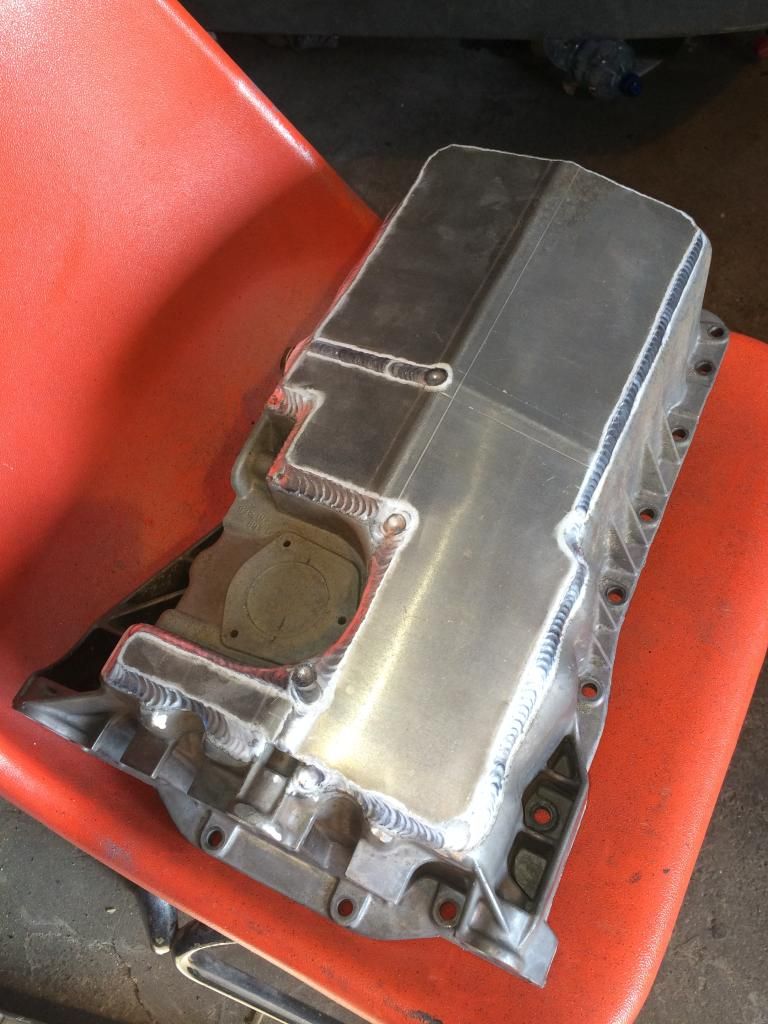

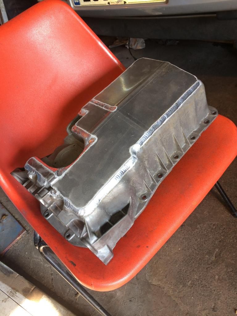

Got my sump back from the guys (Chris and Darren) over at Mr B's Bandies! It's been reinforced with a 4mm steel plate, looks fantastic and amazing work done by them! I've included a link to their facebook page if anyone needs something made up (they do a range of work there, so drop them a PM if you need something done to a high standard! Based in Plymouth). Here's some pictures

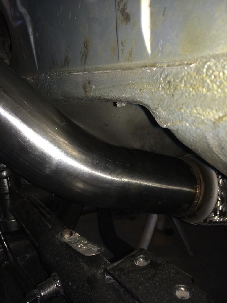

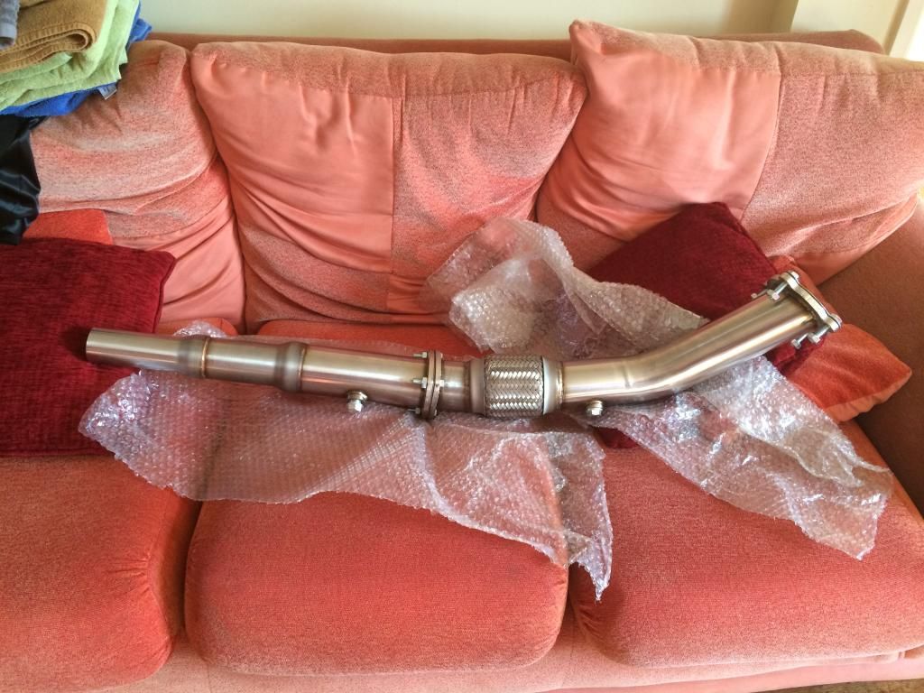

I also bought a downpipe from "turbo revs". I wasn't sure whether or not to get this, I was originally going to go with a trackslag one, suggested by Mr Rich! However for £86.50 delivered I ended up going with this one after hearing quite a number of good reviews from people.
However only problem was that it was sat on the Corrado's Bulkhead..... Fortunately another message to Chris and Darren at Mr B's Bandies and they have sorted that right out!
This have given me much more clearance, so thanks again guys!

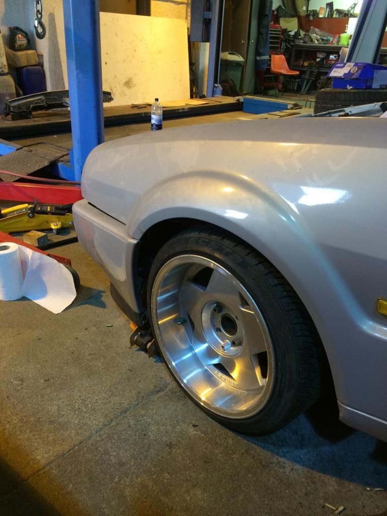

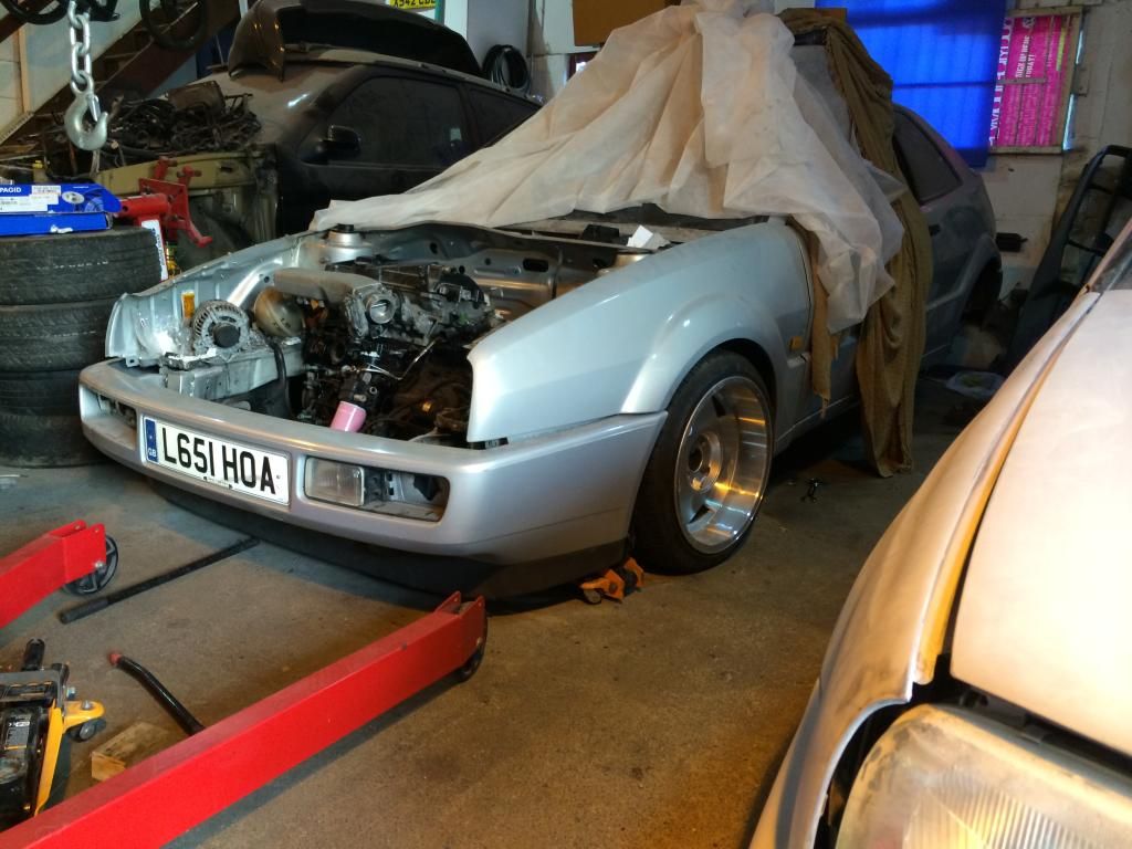

Playing about today:
Needs a bit more lowering, hopefully once the rear is off axel stands it should sit a bit better!

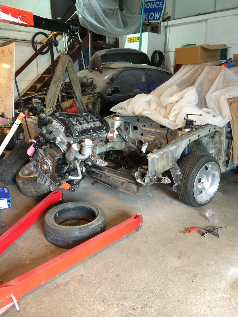

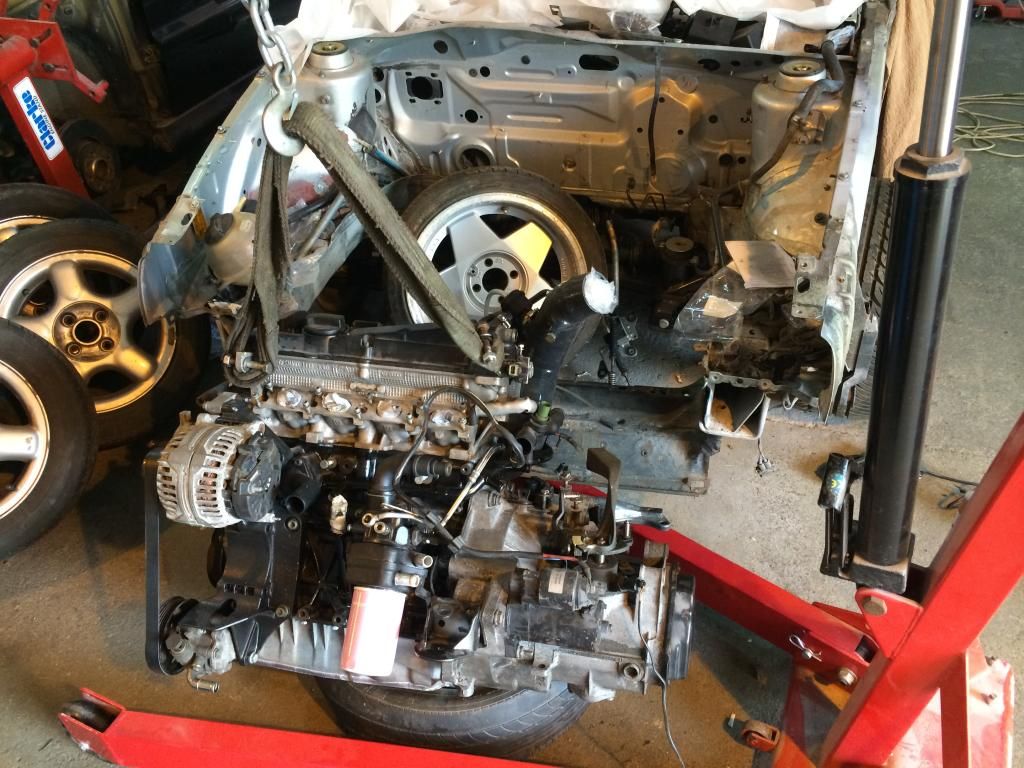

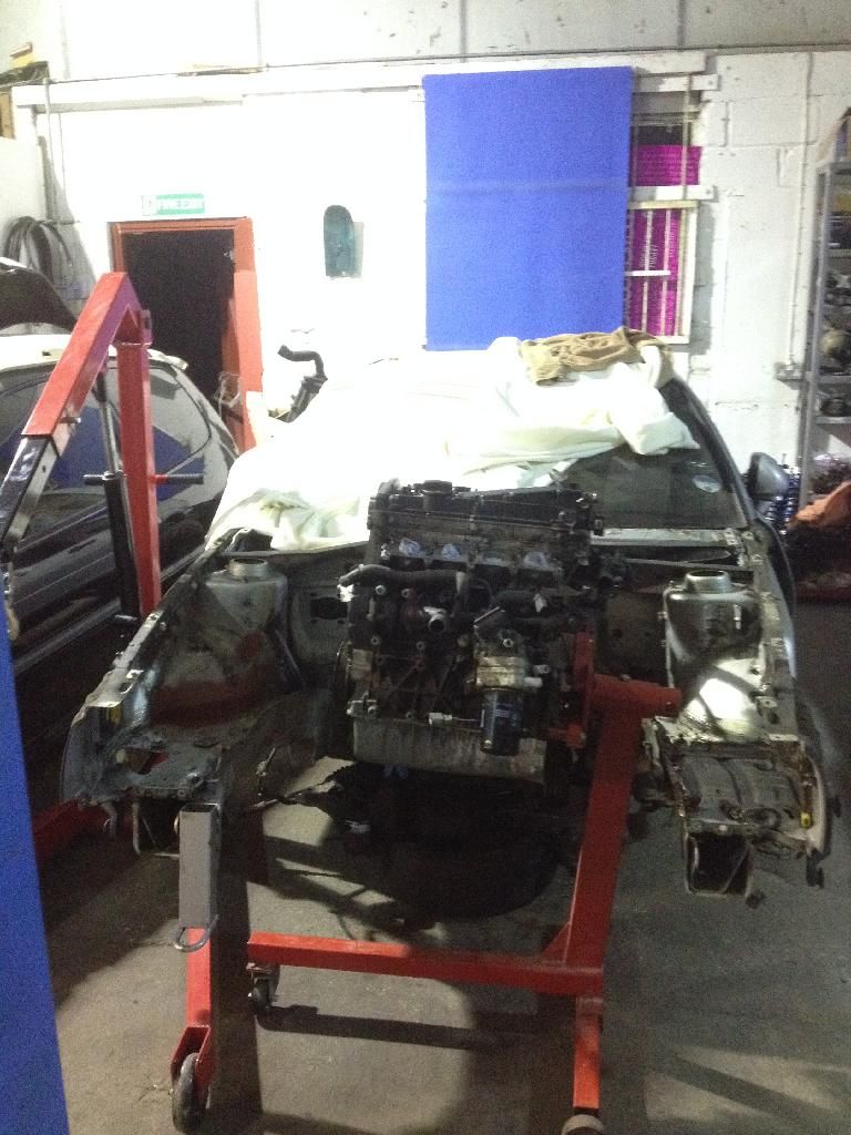

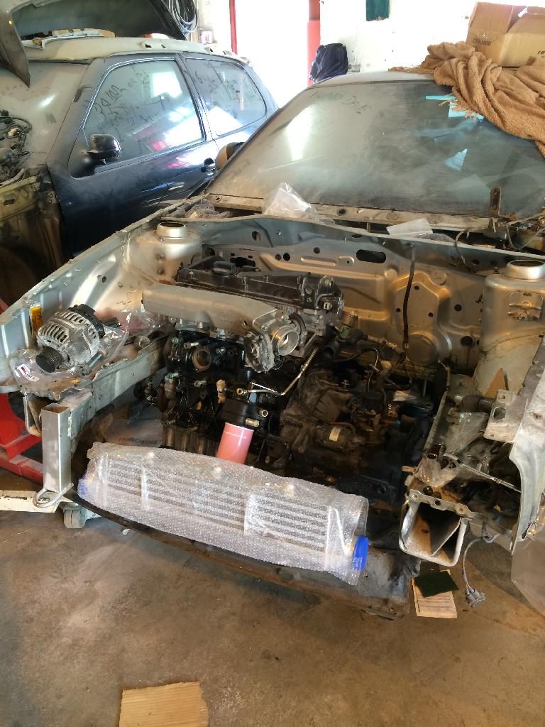

Took the engine back out last week. I've now decided to do the engine bay next year when I take the Corrado back off the road to have it fully resprayed! This means I can start putting things back in and getting it ready.

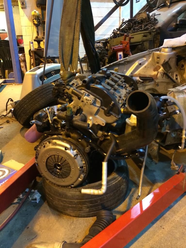

I've fitted the sump, thermostat, seal and housing, flywheel, new vr6 clutch, gearbox, intake pipe and most of the ancillaries to the engine now. All I need to do is swap the rocker cover over and fit a new gasket, put on the new inlet manifold gasket and bam manifold, then fill it up with oil and that's the engine done!
I decided to use the Corrado's 2.0l 16v gearbox for the time being. I was going to use the diesel box that I got from Spuey, but decided against it for now.

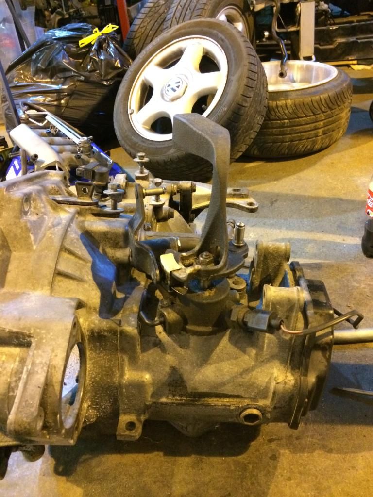

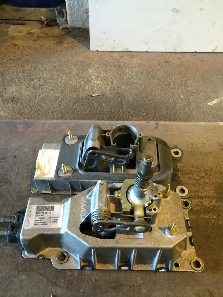

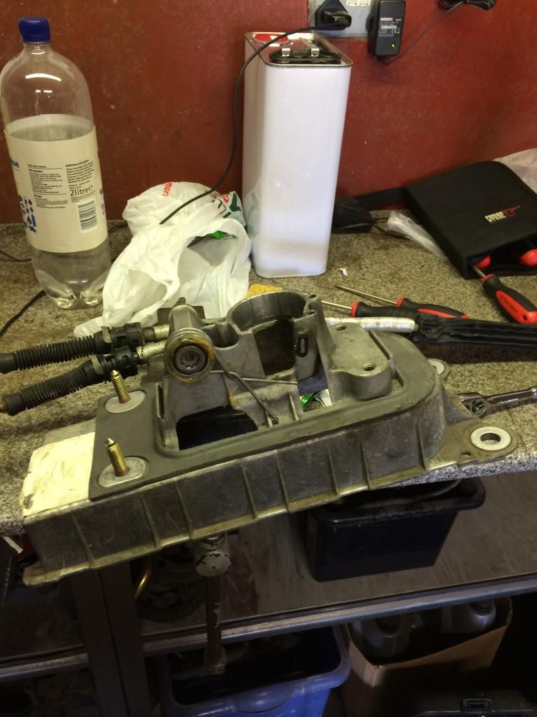

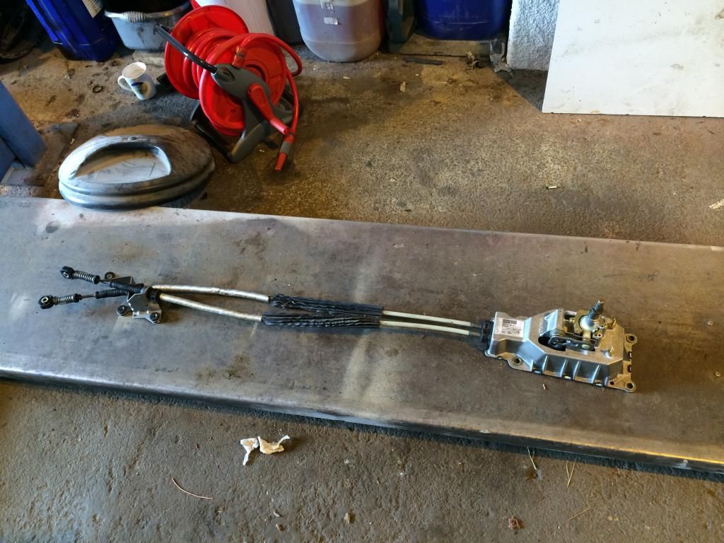

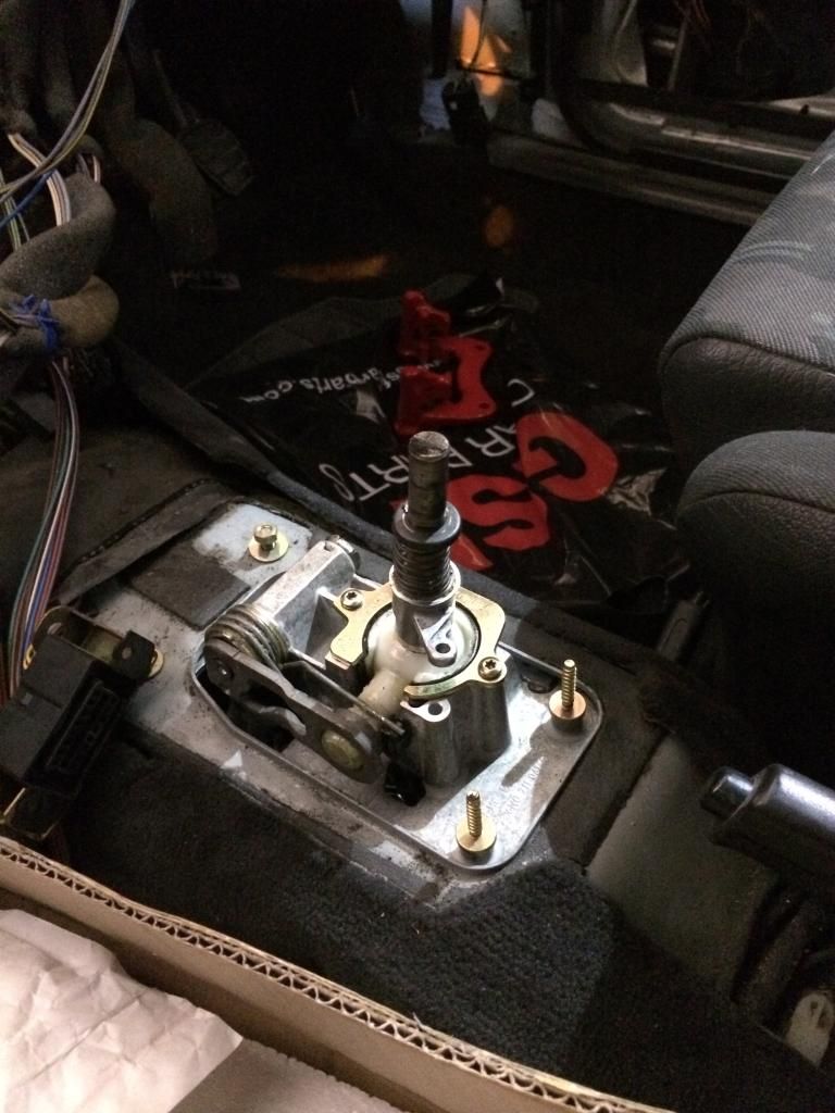

I've also upgraded to the mk4 shifter setup. This was mainly due to the fact that the Corrado gear shifter was a bit broken and felt a bit ****.... Anyway, I had a go at mocking up the mk4's shifter tower in the Corrado's tunnel, but to get it to fit properly i'd have to do a bit of cutting and drilling, which I didn't really want to do as I wanted to keep it original and have a nice fit....
Therefore, I ended up buying a 6n polo diesel shifter housing, baseplate and selector arm.

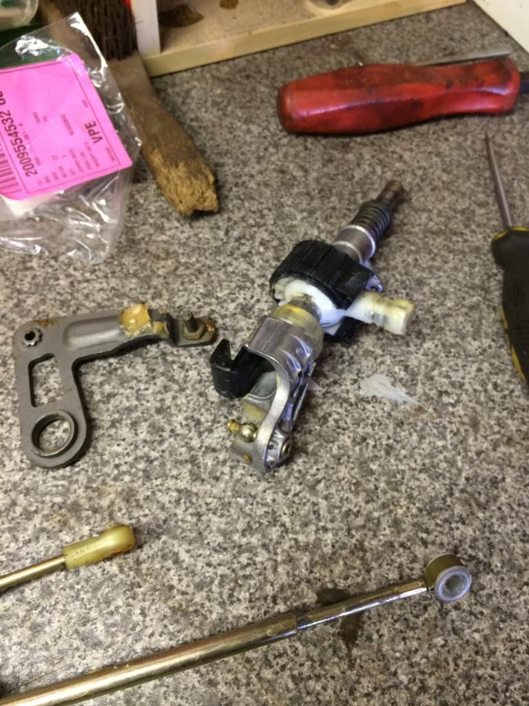

Was surprisingly simple to fit...I took apart the mk4 shifter, cleaned all the crap out from the ball and mech and regreased everything ready to go into the 6n polo diesel housing.

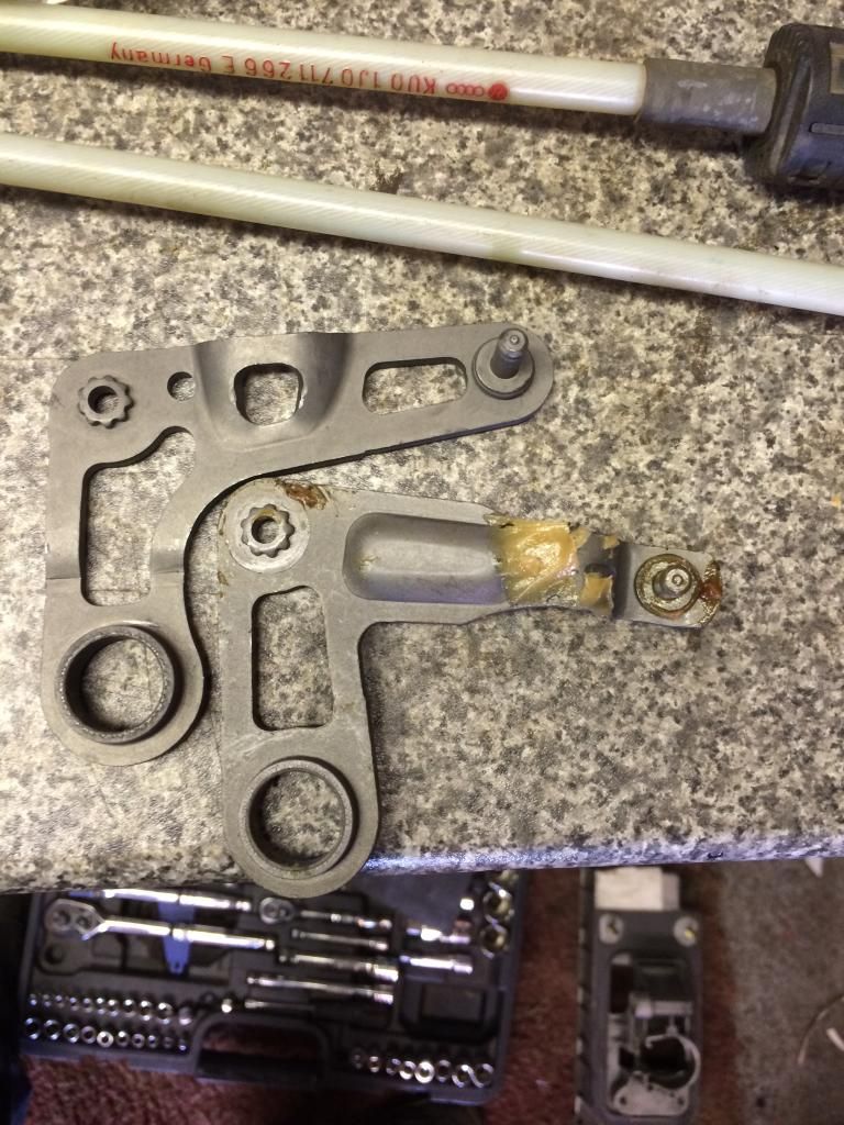

The selector arm is slightly different between the two setups
Finished product
It fits exactly as the corrado shifter does and bolts straight up, so i'm happy with that.

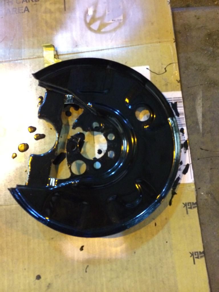

They aren't great but I'm not gonna take the rear axel off until next time the Corrado's off the road, so will re-do most of the rear end and bushes then, I'll also then buy brand new protectors.
Whilst taking the stub axels off, I binned two little protectors that you have to take off before taking the stub axel bolts out....they were pretty perished...however apparently they are needed and now you can't buy any new from vw, so unsure what i'm doing with that atm!
They're these if anyone is wondering / can shed light on whether they are absolutely neccessary? ( 191 501 639 B)
I've replaced all of the stub axel bolts too as they were so rusty they rounded pretty instantly. Luckily managed to hammer a 14" 6 point socket on to them to get them out.
