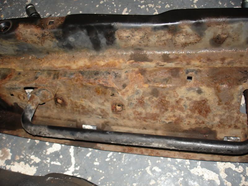

Dec 1 Posted August 30, 2007 Nice work! That front panel should be repairable, as most of it isn't structural anyway! Mine looked something similar. I just used a wire brush + sandpaper to strip it all back to bare metal. Gave it a few coats of rust proofing, and then three coats of black hammerite. One question though!......Is that a coolant pipe that runs through the front panel? I don't have one there on my early valver, so was just curious! :lol: Quote Share this post Link to post Share on other sites
mrbeige 0 Posted August 30, 2007 Nice work! That front panel should be repairable, as most of it isn't structural anyway! Mine looked something similar. I just used a wire brush + sandpaper to strip it all back to bare metal. Gave it a few coats of rust proofing, and then three coats of black hammerite. One question though!......Is that a coolant pipe that runs through the front panel? I don't have one there on my early valver, so was just curious! :lol: Cheers dude, I'm glad that the front panel is rescuable(sp?)! That pipe comes from the power steering pump, and I'm guessing it is a means to cool the fluid down, although, I can't see it having much effect! Quote Share this post Link to post Share on other sites

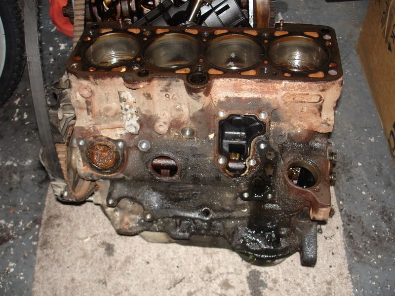

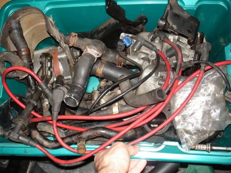

mrbeige 0 Posted September 5, 2007 Made a little more progress tonight..... Engine number two.....stripped block down, just need to get the pulleys off, but leaving them to soak in WD40 over night.. Bores look in good nick too :D Pretty sure you can still see the honing marks Hmmm loads of 2e parts.... And loads of 9a parts.... Quote Share this post Link to post Share on other sites
mrbeige 0 Posted September 6, 2007 I offered the 16v head up to the 2e block and drops on, no problem the two locator pins are even in the right place!. The only thing I need to check is; the 2e pistons don't have any cutouts to clear the inlet valves. Are the valves likely to hit the pistons? Quote Share this post Link to post Share on other sites
Toad 0 Posted September 6, 2007 They should be fine. The 2e pistons are slightly shorter as the combustion chamber is in the block rather than in the head as seen on the 16v. You should notice that at tdc the 2e pistons are slighty lower than those on the 9a. Admittedly I just made that up in my head, from things I may or may not have heard, so you might want to test it. :oops: Glad it's all looking good mate. have been really impressed with the engines I've stripped. VW certainly made the 4 cylinder units well. Quote Share this post Link to post Share on other sites
mrbeige 0 Posted September 6, 2007 They should be fine. The 2e pistons are slightly shorter as the combustion chamber is in the block rather than in the head as seen on the 16v. You should notice that at tdc the 2e pistons are slighty lower than those on the 9a. Admittedly I just made that up in my head, from things I may or may not have heard, so you might want to test it. :oops: Glad it's all looking good mate. have been really impressed with the engines I've stripped. VW certainly made the 4 cylinder units well. I'm not too sure about the TDC between the two, I'm pretty sure they both come up to the 'deck' of the block. Is the 2e head flat, Tom? As far as the design of the 4-pot blocks, the two I've got seem pretty solid. Quote Share this post Link to post Share on other sites
Toad 0 Posted September 6, 2007 I will tip it over and take a poke round it tonight mate. The pistons on the 2e are quite dished aren't they? Quote Share this post Link to post Share on other sites
mrbeige 0 Posted September 6, 2007 I will tip it over and take a poke round it tonight mate. The pistons on the 2e are quite dished aren't they? Yeah they are, but around the circumference of the piston they are quite raised. Check the pic above ^^^^ Quote Share this post Link to post Share on other sites
