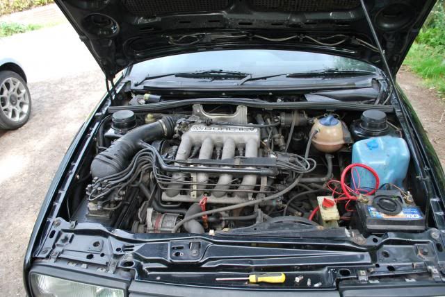

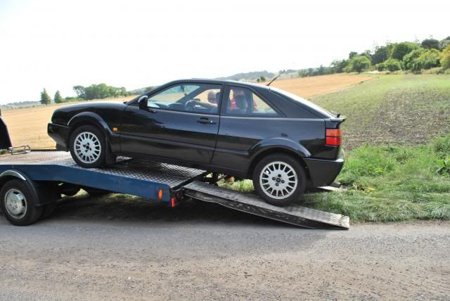

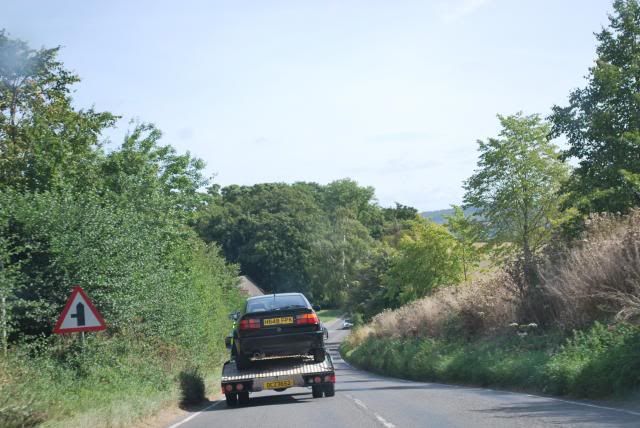

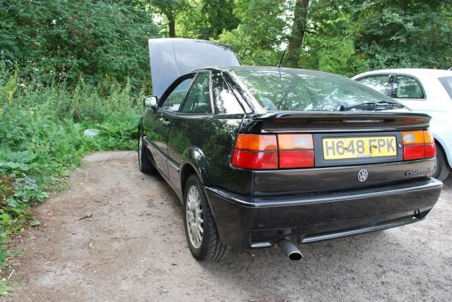

Martin_B 10 Posted September 1, 2013 Hello all! Made a newbie thread last week - i'm new to Corrado's - been an avid owner of MK3 Polo's since 2006 and can also be found over on Club Polo as a staff member/moderator. Wasn't looking for a Corrado specifically, I was looking to replace the Polo - with another Polo but a Corrado came up for sale on eBay around 10 miles from me and I went to view and subsequently made an offer and bought the car! It was owned by a lad since July of this year, he couldn't afford to put any money into it and his dad wanted the garage back. Previous to that it was used daily for 3 and a half years by another owner. The MOT lapsed 10 days ago and I took ownership of it today. It's booked in for an MOT on Tuesday... Looking forward to establishing if it needs work doing and/or being able to start driving it! It's pretty clean and solid on the exterior, no rust or rot from what I can see - which makes a change to Polo's of this era! Interior-wise, it needs trim and I could do with a new drivers seat, or, a new interior but i'll see how I feel once Tuesday has been and gone. Engine seems fine - the idle screw on the throttle body was wound fully in and was idling around 500RPM, I adjusted to around 900RPM - is this the correct procedure or should I have adjusted it a different way? The Corrado is fairly standard bar an uprated headlight loom. The backbox is from an Audi apparently. Can anyone confirm if a Scirocco backbox will be a direct replacement? Anyway, time for some pics: Quote Share this post Link to post Share on other sites
paddy26 3 Posted September 1, 2013 Best of luck with the car. It looks nice and original. Those alloys are starting to grow on me. First mod should be lupo/tt wipers. The originals aren't very good. \Paddy Quote Share this post Link to post Share on other sites

GrahamU 6 Posted September 2, 2013 good looking car, enjoy it Quote Share this post Link to post Share on other sites
DiamondTony 10 Posted September 2, 2013 Good call with the idle mate, 900-1000 is ideal for a valver. Mine doesn't idle properly so I've had to up it to 1100rpm on idle, drives a treat though. They're pretty slow when accellerating from 1000-3500rpm, but after 3500 they take off and scream! They love being driven. Looks tidy mate, enjoy Quote Share this post Link to post Share on other sites
davidwort 0 Posted September 2, 2013 CO needs setting at idle first (long hex key into top of metering head) before using the idle speed adjustment screw to tweak the rpm, need this done on a gas analyser to get about 1-2 % CO, but you can do it quite well by ear, i.e. when it runs smoothest. Ideally a new set of injectors is required to get a really good idle on a 16v, after 100K the injectors get worn and don't spray nice and evenly, particularly at idle (cleaning won't recover them). Correct Idle should be in the range of 950-1050rpm Quote Share this post Link to post Share on other sites

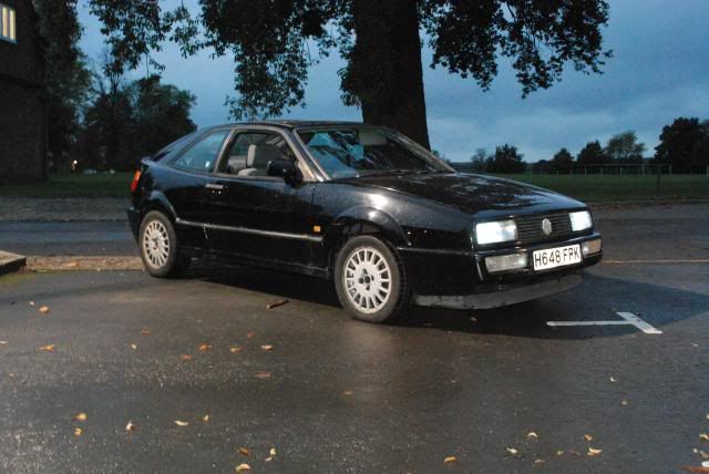

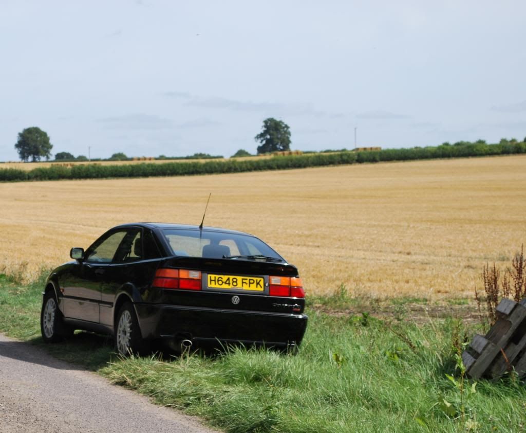

Martin_B 10 Posted November 1, 2013 Sold my Polo this week and taxed & insured the Corrado today. Went for a quick spin before dinner and took a few snaps. Can't believe how planted you feel on the road, makes a nice change from a mk3 Polo! Got a misfire when booting it in 2nd/3rd it feels like it's holding back; a bit jerky - think it's from being stood up since the beginning of September and getting a bit damp etc. Will probably get new cap & rotor arm over the weekend and also I think old fuel isn't helping either! Hoping to clean up my black seats over the weekend and collecting my new black doorcards this eve from work! Quote Share this post Link to post Share on other sites
marshole82 0 Posted November 6, 2013 Really tidy mate, needs picks of the interior changes though. I had a valved a few years back and have missed it ever since - not the quickest thing in the world but I challenge you not to smile when its on full chat :D Quote Share this post Link to post Share on other sites

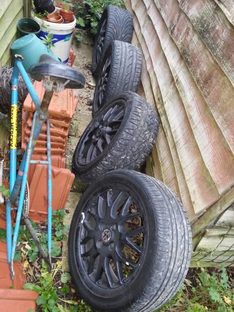

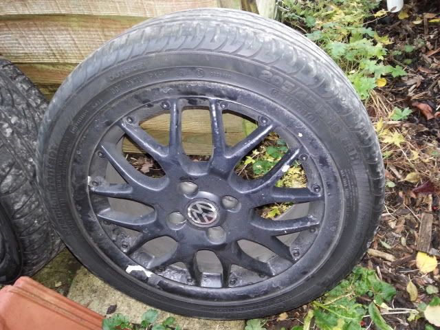

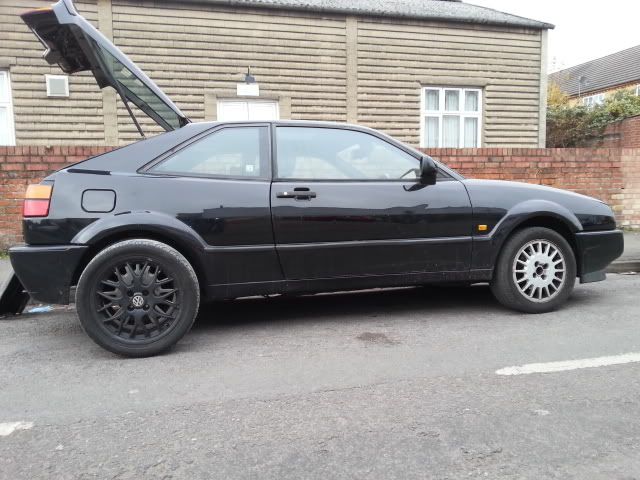

Martin_B 10 Posted November 24, 2013 Cheers chaps - will give her a good run and see how she fares, since i've had her on the road and using more regularly she's getting better! Collected said wheels this morning - plans are to strip the tyres and paint the wheels silver/dark silver in the new year. Quote Share this post Link to post Share on other sites
marshole82 0 Posted November 24, 2013 Certainly an improvement on the standard sebrings, agree with ditching the black on black though, good shout Quote Share this post Link to post Share on other sites
