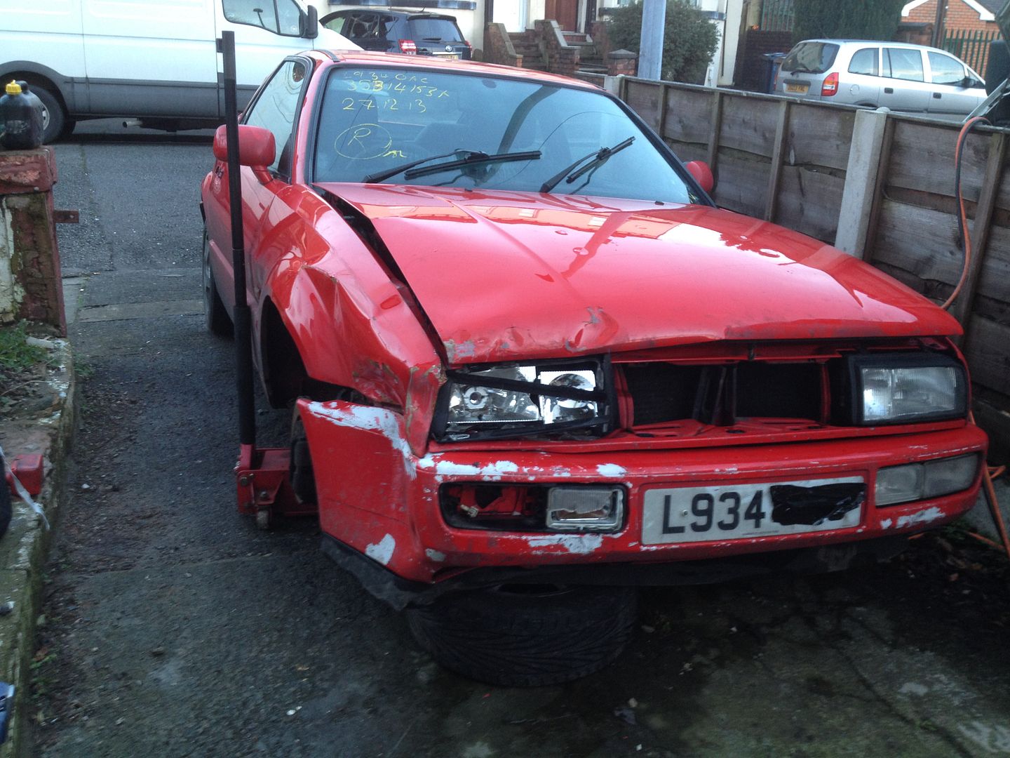

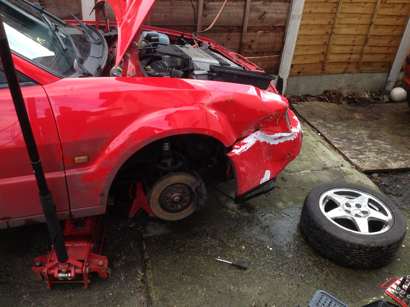

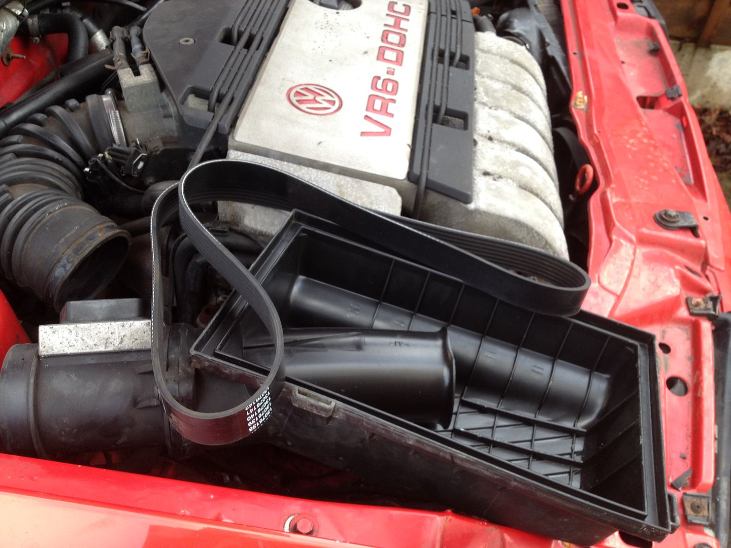

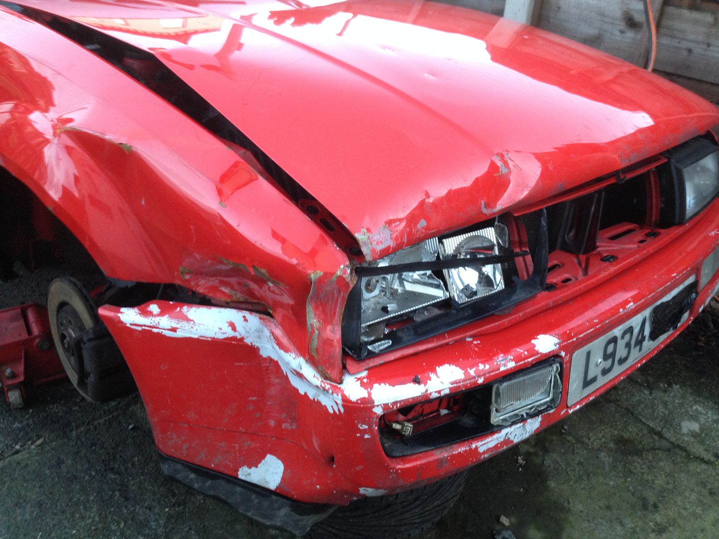

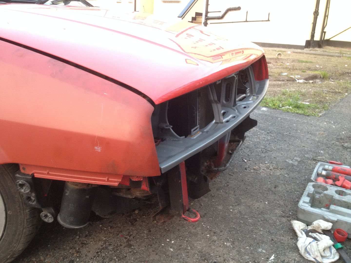

Hi guys, I bought this VR6 on Copart the other day that had a light right front damage. Its a 93 L reg with 195k on the clock in Flame Red. By the looks of things, the car looks like with Toyo tyres all round and has Weitec suspension as well. When i bought the car, i didnt know how much mileage the car has as the battery was flat and there was no way in the bonnet as it was jammed from the crash. A small introduction with a lump hummer and the bonnet released. I then found out that the auxiliary belt had snapped and got caught in the tensioner.

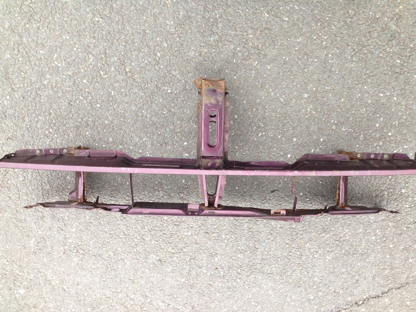

I made a trip to Derby yesterday to pick up some replacement parts and picked up a service kit. I bought a bonnet, driver's wing, slam panel, bumper, headlight and some other little bits. The wing needs painting as well the slam panel but its in purple and its a bit crusty in places so needs sand blasting.

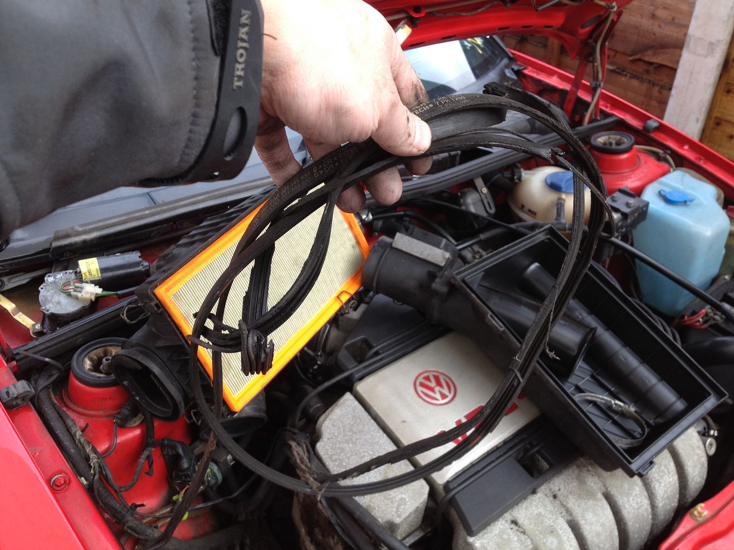

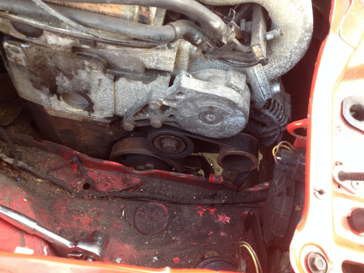

I got started today and first thing on the list was to put the belt on. The old belt had got caught in the tensioner and this is how it looked:

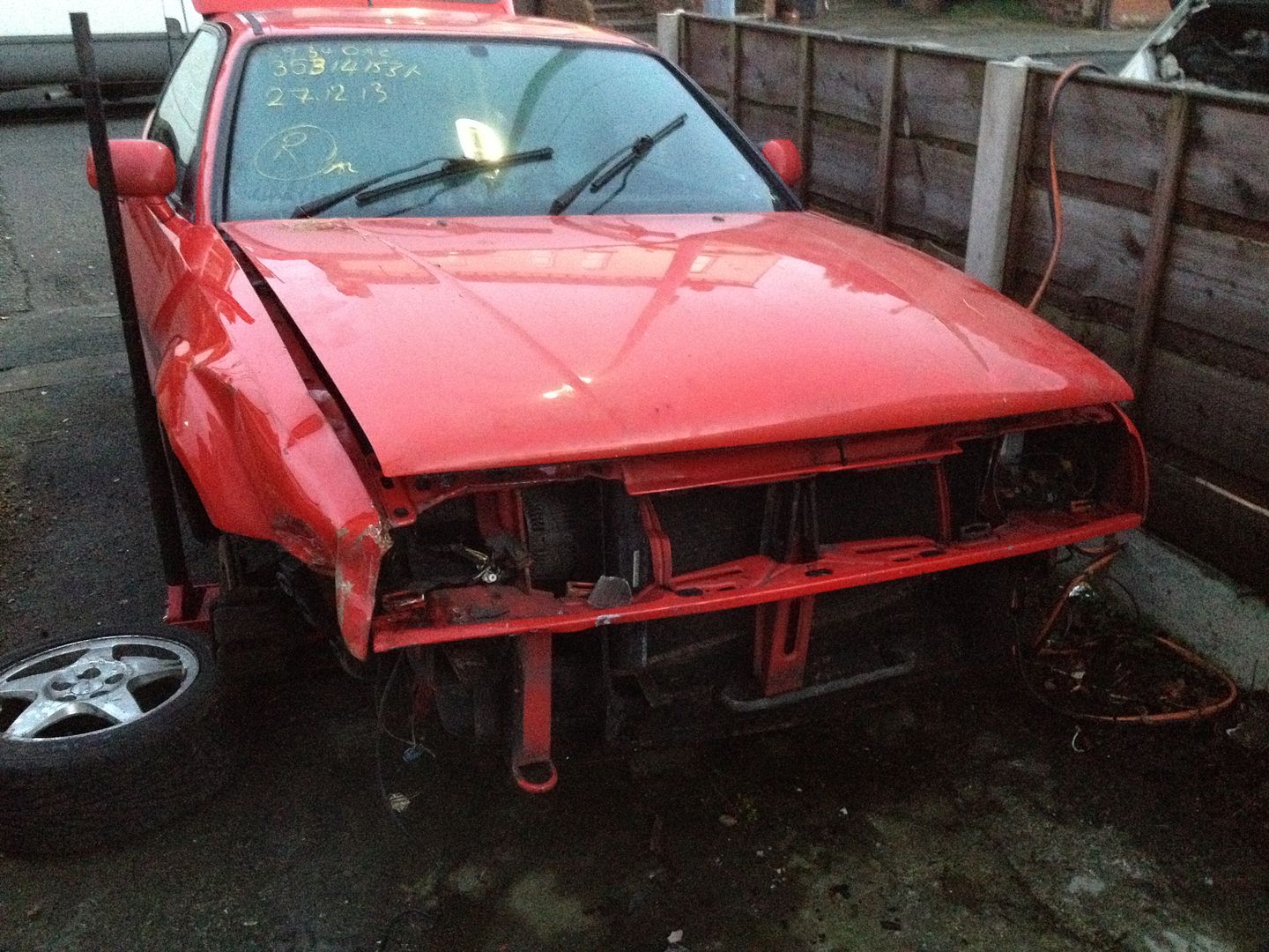

Before it got dark i changed the bonnet, took off the wing and slam panel:
My camera wouldn't flash so i couldnt take any more pics so y plan is to get the front inner arch pulled out, so some painting and get the car upto speed, will keep you all posted.

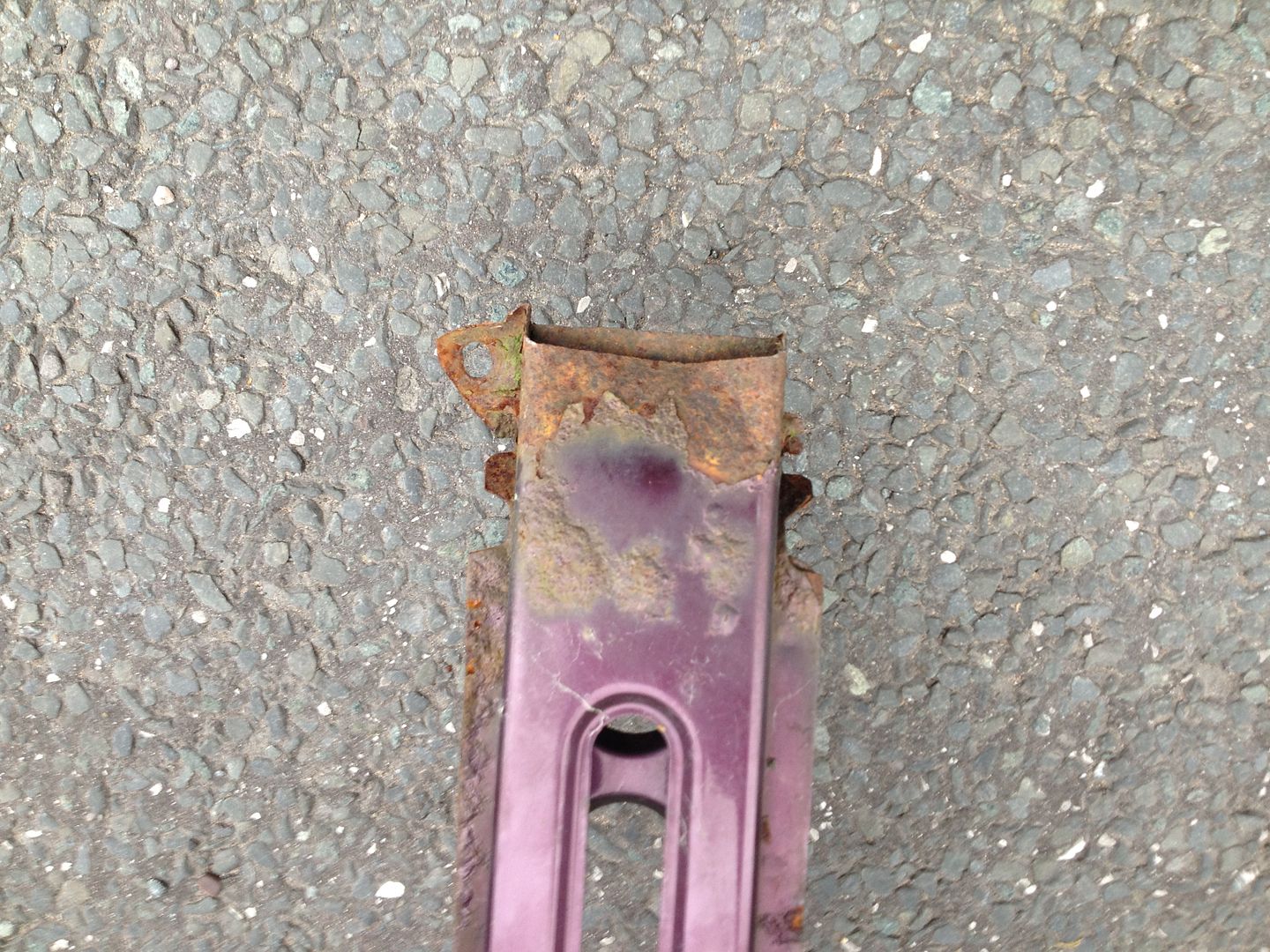

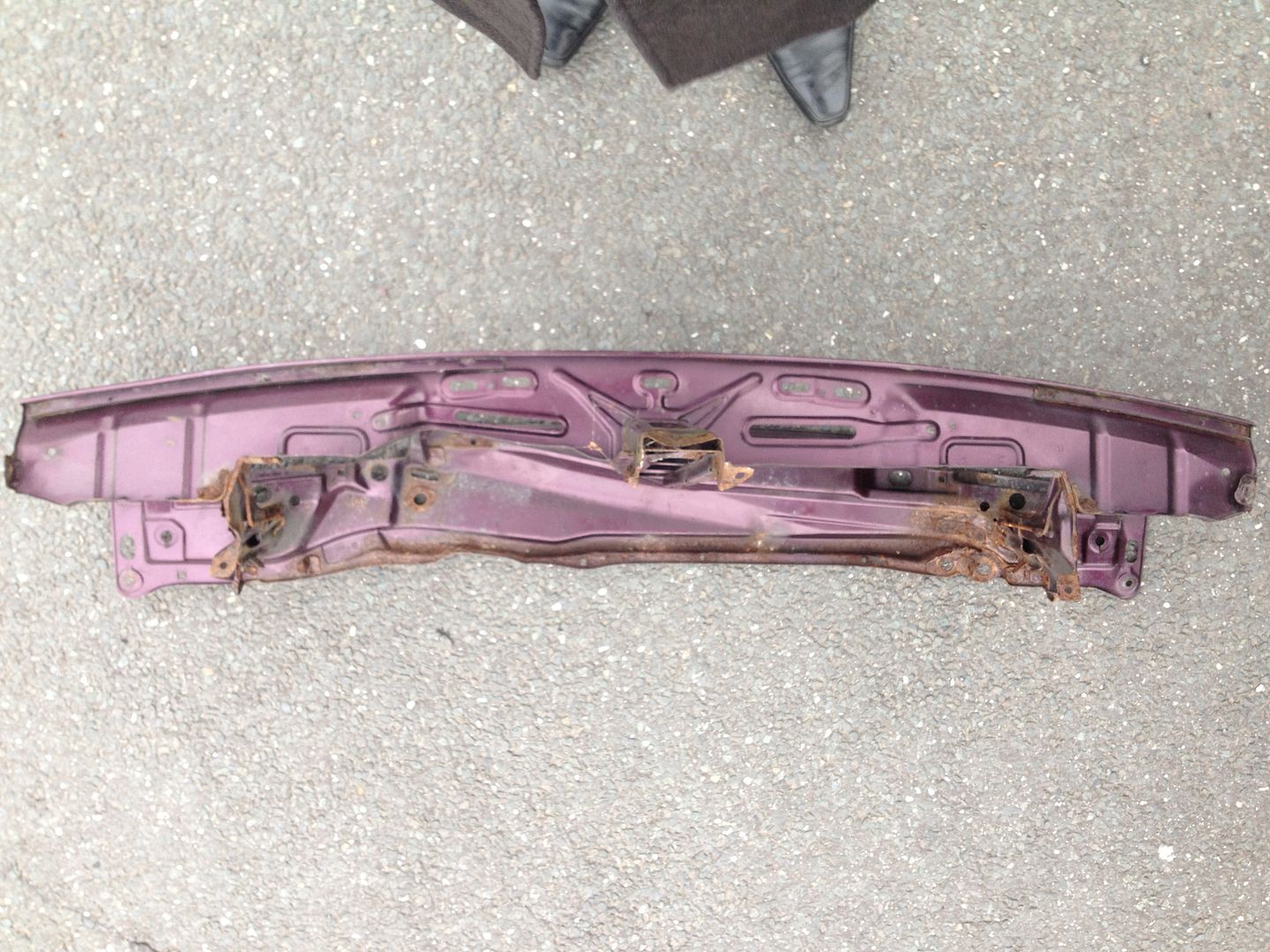

The front panel i picked up the other day was grubby and scabby so i decided to stripped down, get it sand blasted and a lick of powder coating. Will cost me £80 but at least i know that it'll stay rot free for a while.

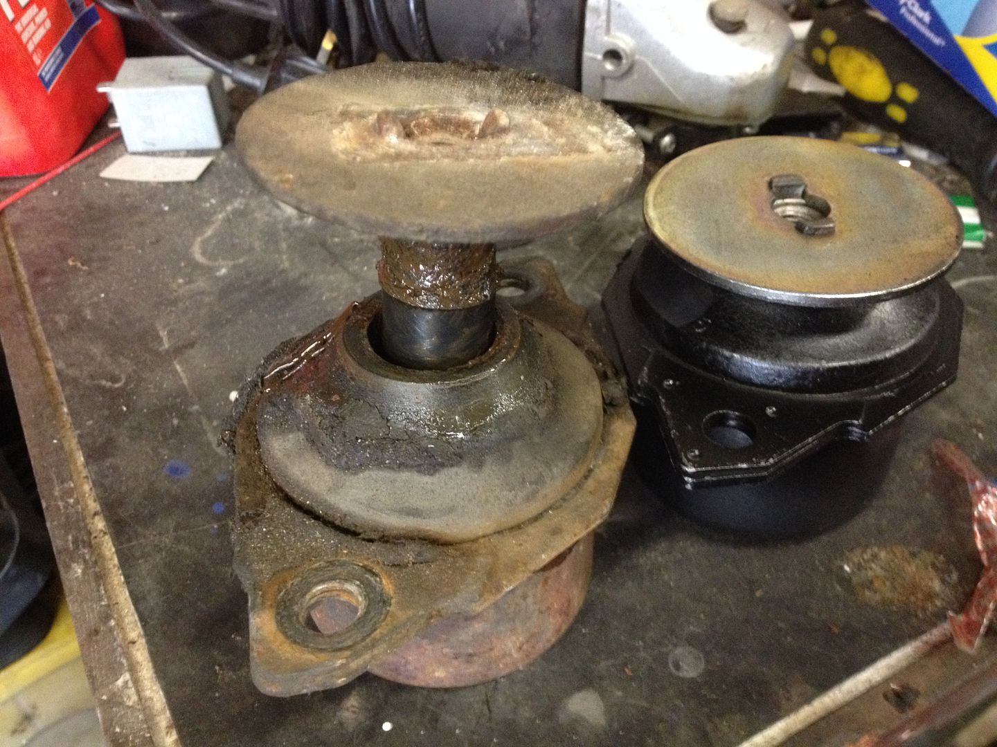

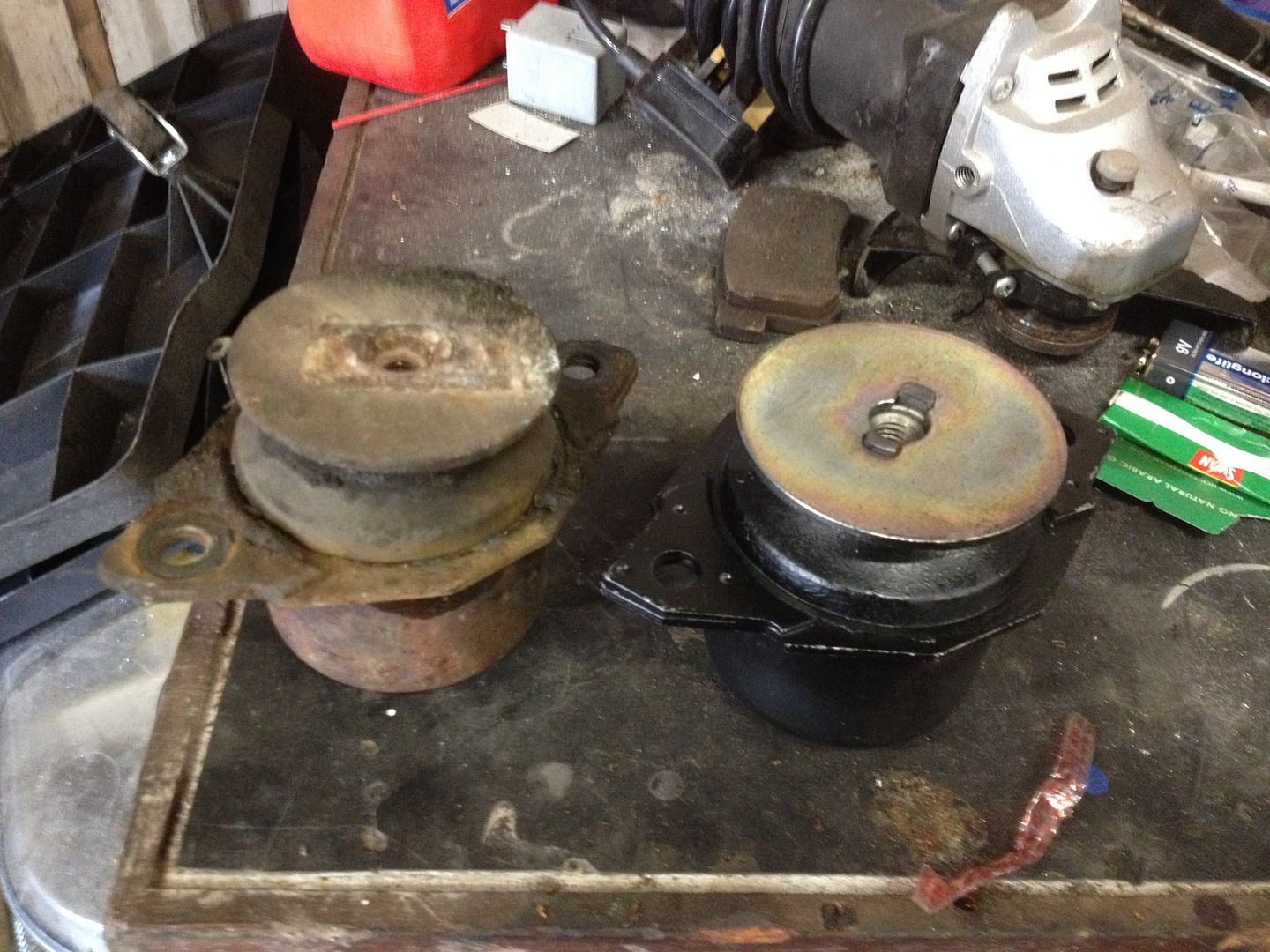

Sorry in the delay in getting an update over to you guys. I've had a change in working career so its been all over the place lately. I got the front panel sandblasted and it cleared out all the corrosion but the panel wasn't as clean as i first thought but it will do as something to use. I bought new engine mounts but the front was fine as it was a poly bushed but the rear one was goosed and needed replacing.

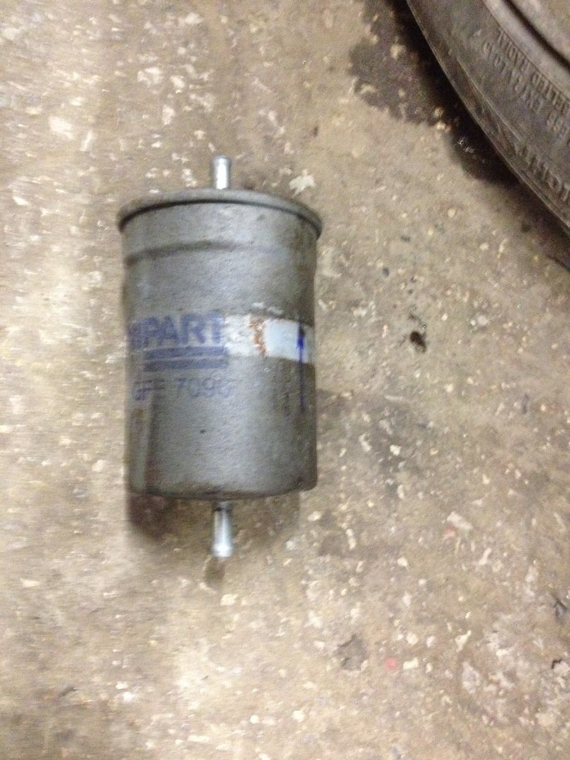

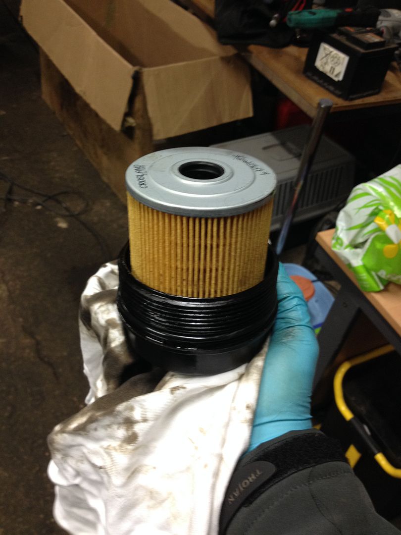

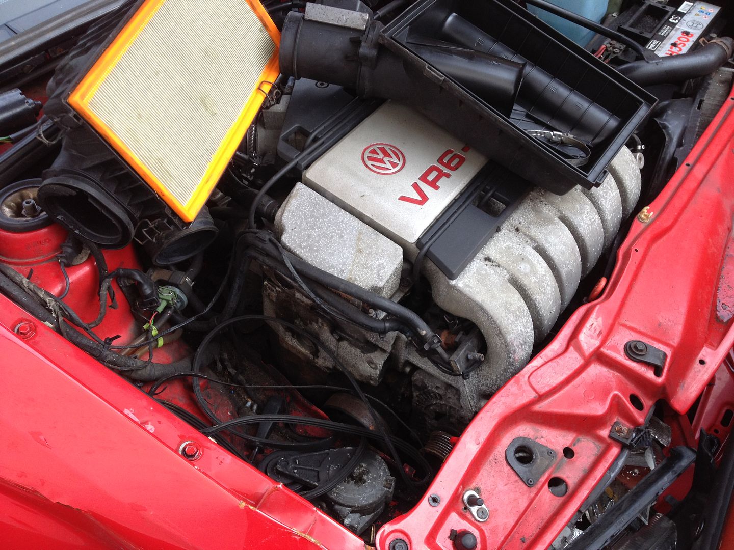

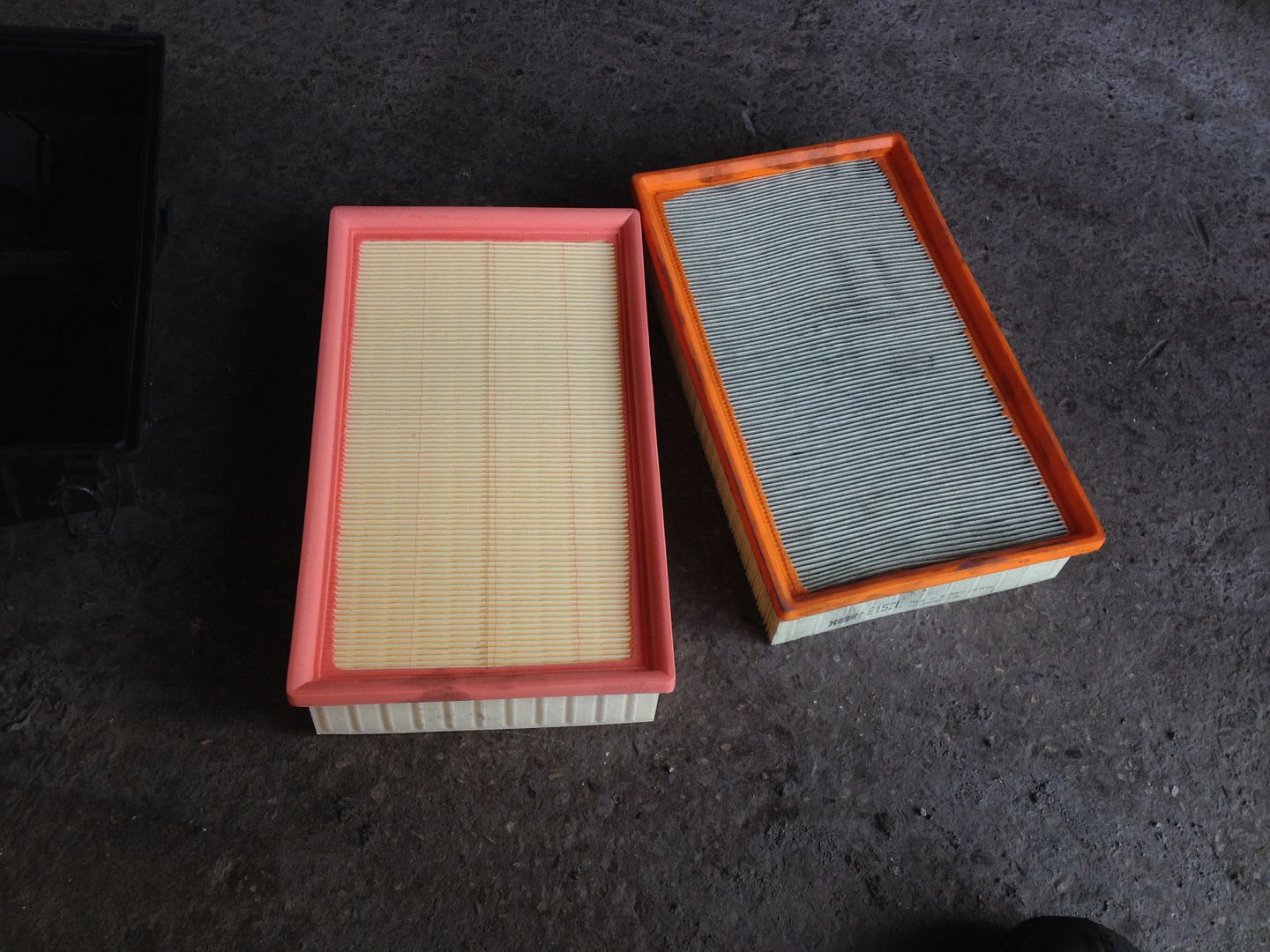

I gave it a good service, the oil didnt look that old but i thought i would be nice to treat to it to so fresh stuff:

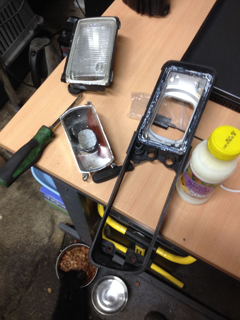

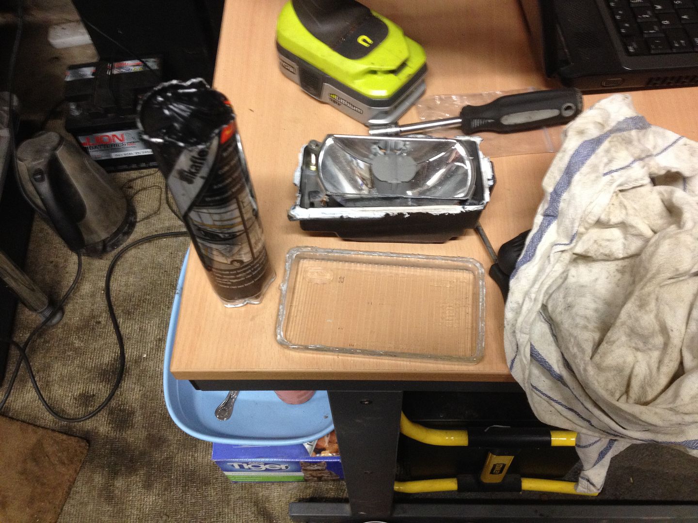

The driver's side fog light had snapped so i manage to take 2 bad ones and make one good one:

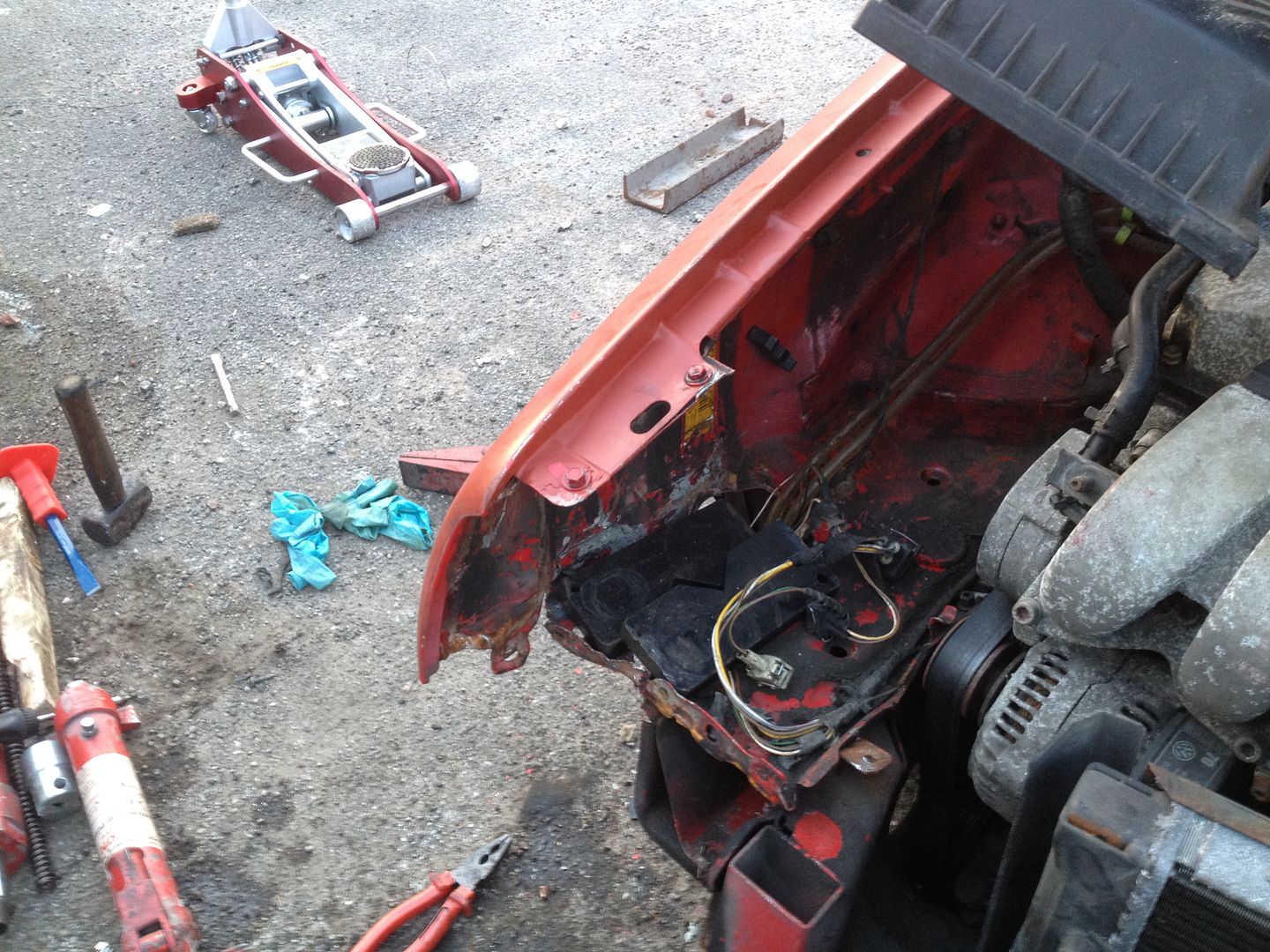

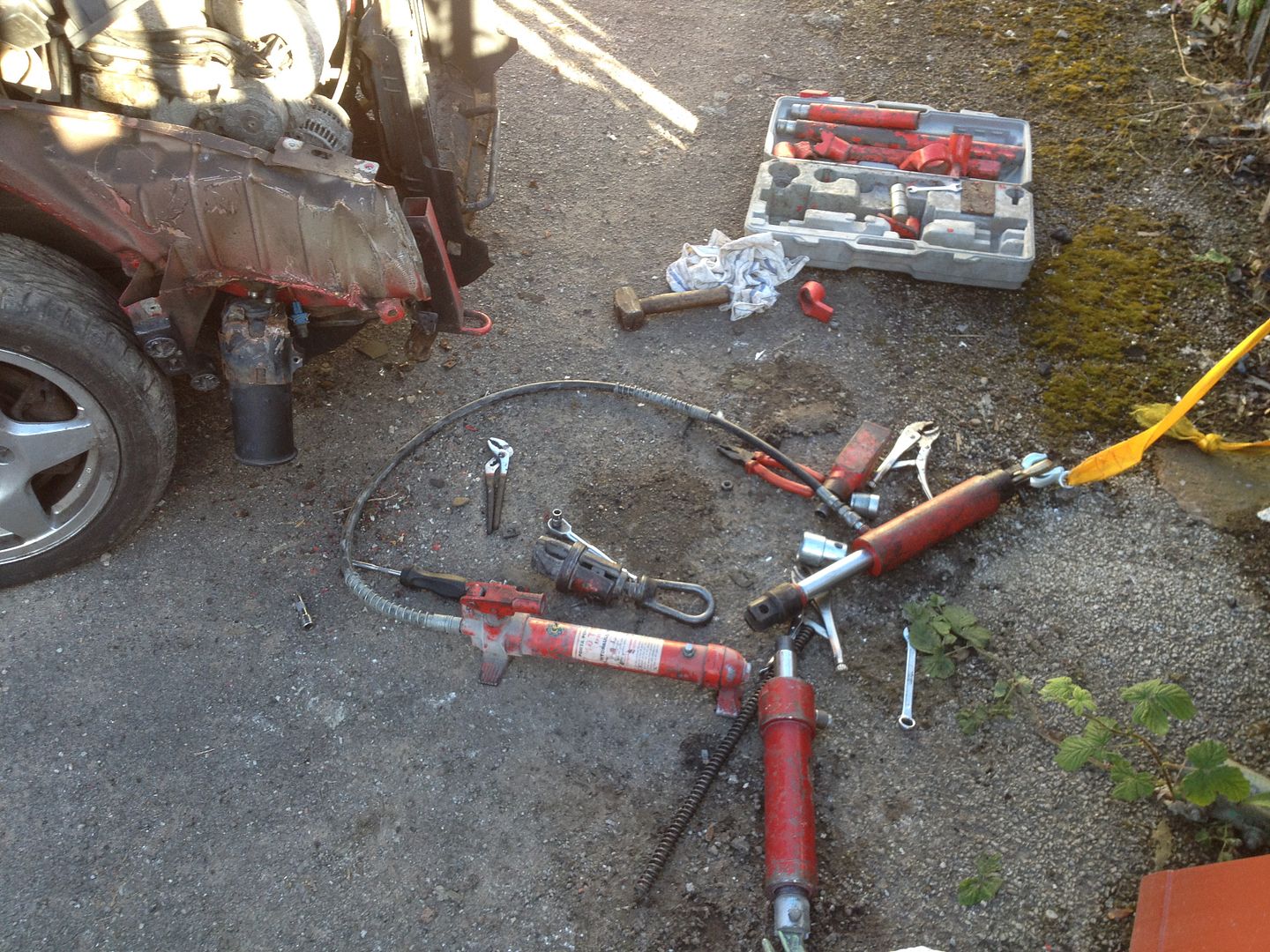

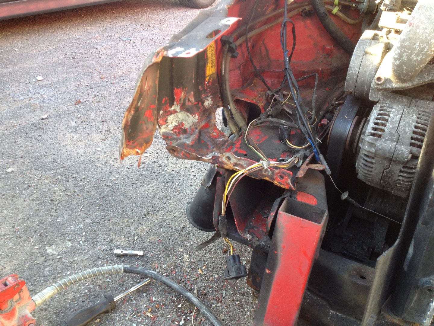

Yesterday i managed to get the body puller off my friend and started to hammer, smash and pull the inner wing out. Before it got too dark i managed to get it to a point where it could pass and it all lines up but i need to pull it out abit more as i'm not completely happy:
