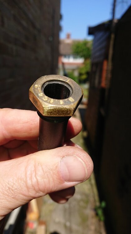

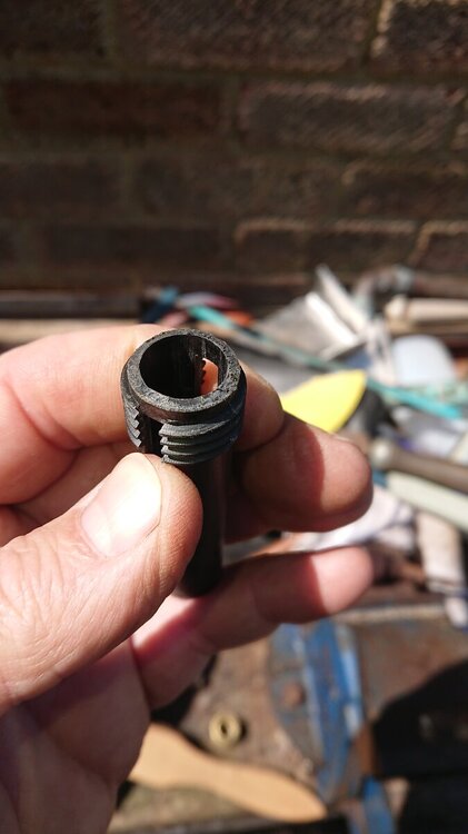

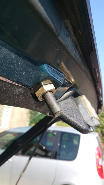

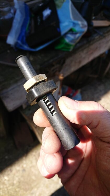

colinstubbs 0 Posted May 27, 2023 Fixed mine today, the flange had snapped off, doesn't look oem but I don't care!! I cut down a 15mm brass water pipe fitting, having checked clearance with blu-tac(!) and screwed it on with some Araldite Steel epoxy. I added a pond liner rubber gasket under the brass nut, seems to work a treat! Quote Share this post Link to post Share on other sites
fla 9 Posted May 27, 2023 Creative solution, good stuff. Quote Share this post Link to post Share on other sites
Cressa 45 Posted May 28, 2023 Great fix. Paint it black and no one will ever notice 😂 Quote Share this post Link to post Share on other sites
fendervg 33 Posted May 29, 2023 VW Classic Parts still have the boot popper and the rubber bump top - got some last year. They don't have the square plastic nut though, you'd need to use your old one if possible - but the usual break point is where the plastic lip is attached to the plunger - once that snaps the plunger won't stay put. Quote Share this post Link to post Share on other sites
