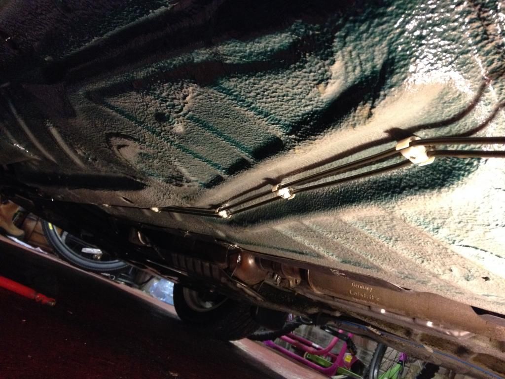

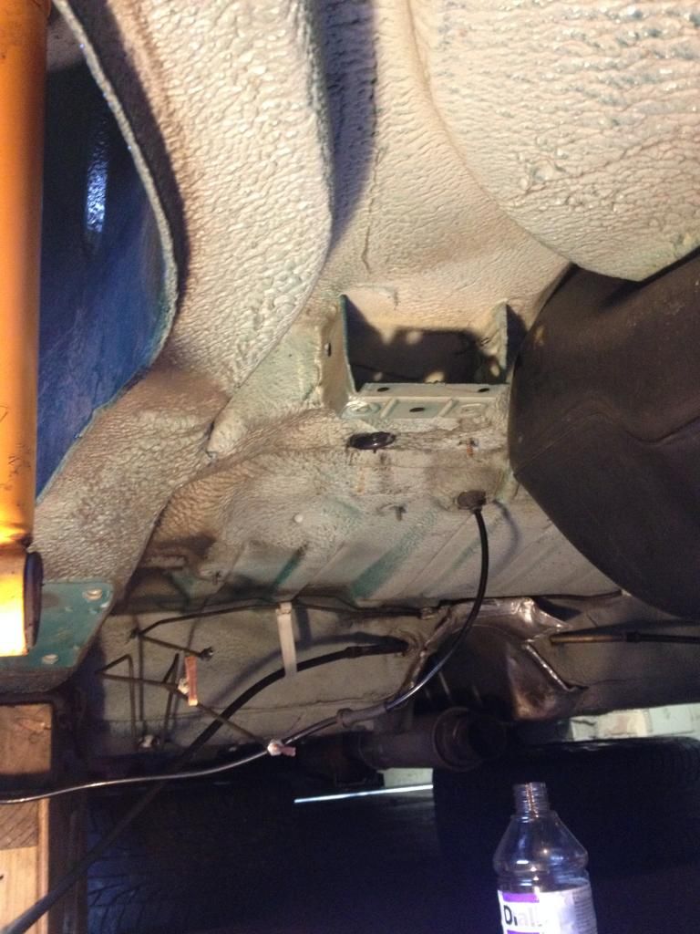

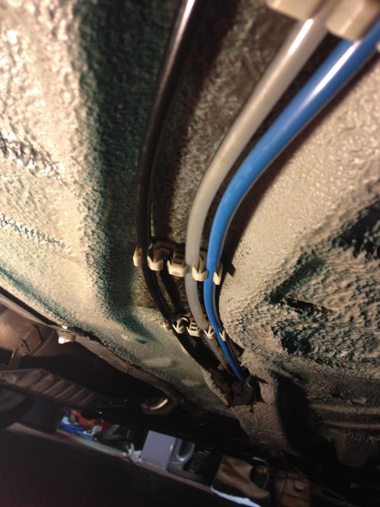

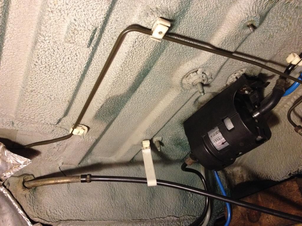

ChrisL 20 Posted September 1, 2014 Had the old faithful toothbrush out giving the underneath a quick clean, not that it really needed it and quite amazing for a 19 year old car before (just round the fuel lines really): And afterwards: And a general floor pan shot: Also, my mates son is a sign writer so got some show plates made up: and fitted: And first VW show with the storm at E38 this weekend resulted in this: The car won 'best standard' category at E38 2014, really pleased I wasn't sure about edition38, i'd been about 8 years ago and wasn't impressed and thought it would be full of new cars on air. How wrong was I, it was a fantastic show, more mk1's, mk2's I'd seen anywhere and the standard was unreal(and that is an understatement). The dutch cars where something else completely with a crazy level of detail. The E38 crew where also spot on, didn't think they would give a standard corrado the time of day but they wanted to know all about it. Couldnt recomend it enough and will be back next year! Quote Share this post Link to post Share on other sites

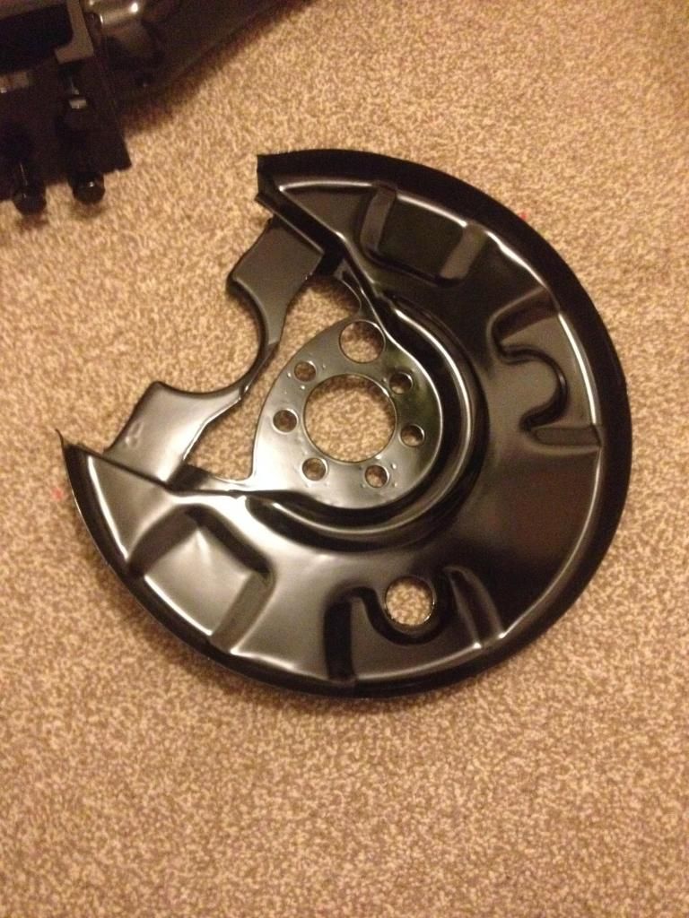

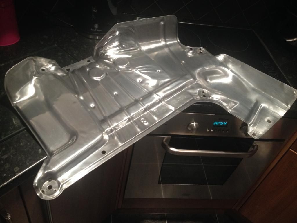

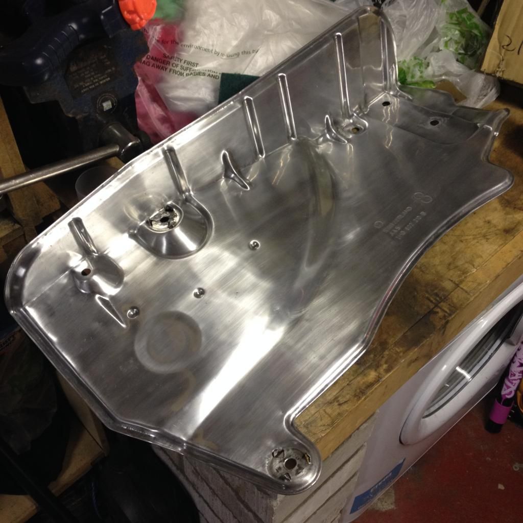

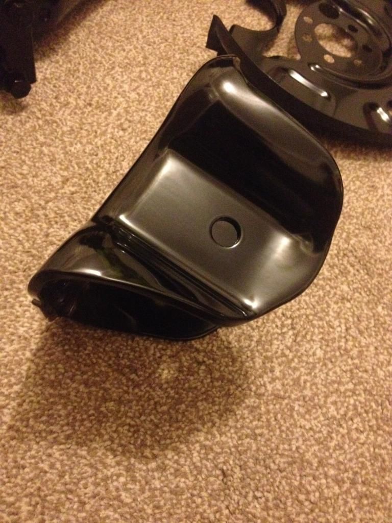

ChrisL 20 Posted November 23, 2014 Not updated this thread for a while but I've been doing bits on the car ready for next year. The beam, exhaust and heat shields are all off and doing a bit of cleaning and refurbishing. The heat sheilds have been pretty time consuming, I started with 2000grade dry, then same again wet, then onto 3000 grade paper and then a metal polish. I wasnt sure what the finish should be on the shields but finished with scotchbrite to put a bit of grain down. Look pretty OE though: Close up. I was in 2 minds with the beam because it was in amazing condition for its age but had a couple of marks that I wasnt happy with, so this has been painted (not powder coated): Brake back plates: Suspension brackets: Amazing paint finish but.......... Its too shiney for OE so its gone back to be repainted again! So just this to clean now, again not bad for its age. Quote Share this post Link to post Share on other sites

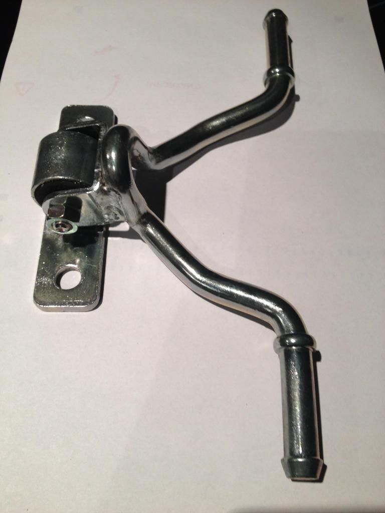

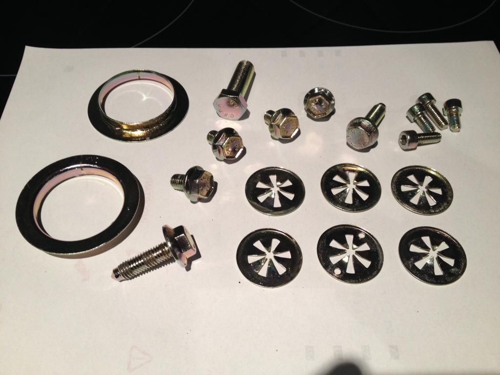

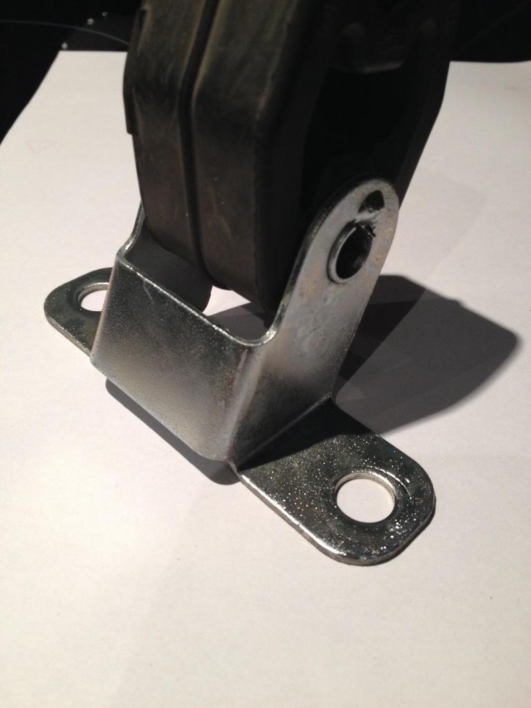

ChrisL 20 Posted December 16, 2014 It's e coated from factory bruny. Still looks immense however it's done!! Checked out the e coating but the guy's said its just a primer and would need overpainting anyway so had it all re-painted in a more satin finish. Happy now as i spent some time in my local VW dealers laid under a new Scirocco, the salesman thought I was nuts!!! Anyway, little update. Cleaned all the floors now and its come up perfect Had a few parts plated ready for the rebuild. Exhaust hangers heat shield clips, hanger bolts and a few more bits plated yellow: More updates soon. Quote Share this post Link to post Share on other sites
KipVR 1 Posted December 17, 2014 Looking good! Are you doing the handbrake guide tubes that go through to the cabin? They are fairly easy to get out. VW (and every other oem) use plain ecoat on most steel pressed/fabricated parts, and will have a minimum salt spray hours durability. Wishbones, sump, rear beam, cross member etc are all plain e coat, no paint. I'm not criticising your choice though, paint will last much longer!! Quote Share this post Link to post Share on other sites
ChrisL 20 Posted December 17, 2014 I would like to do the handbrake guides but didn't want to have to strip all the interior out. How do they come out please? Quote Share this post Link to post Share on other sites
